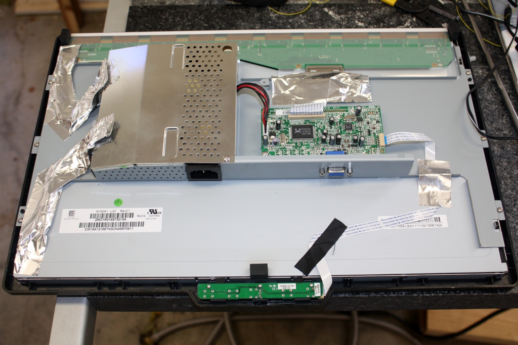

    Step 1 was to open the monitor up. This ended up being more difficult than I had expected. Like so many monitors of this size it's held together by plastic tabs around the edge. But these tabs were very difficult to pop open. I ended up making a few minor scratches in the plastic as I pried it apart.

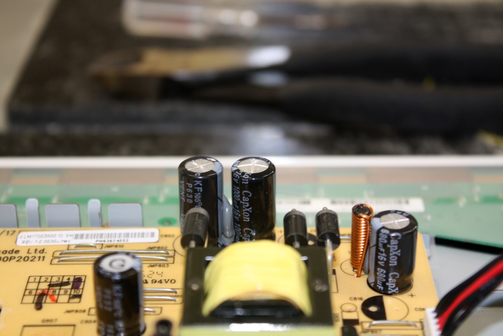

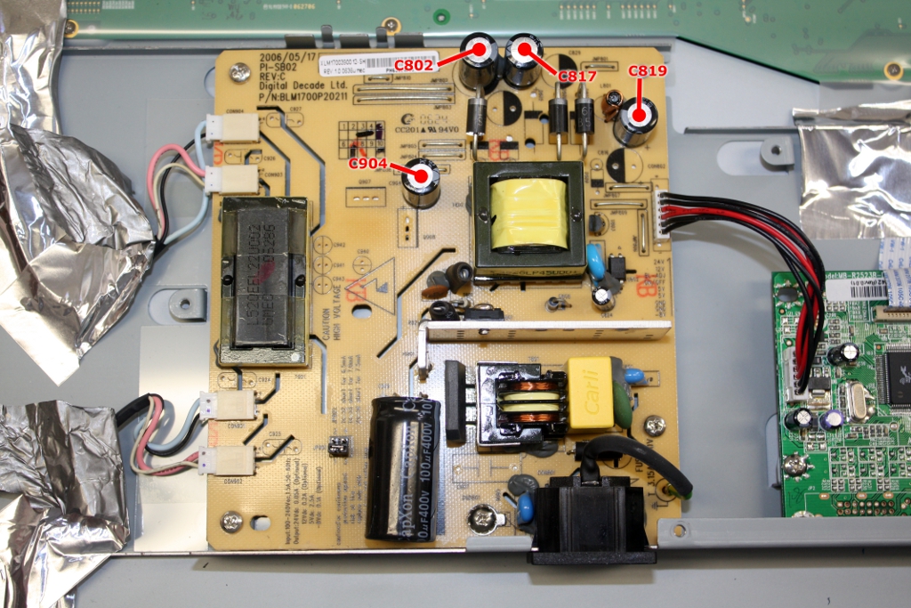

    Once open the monitor looks like every other monitor, the video board is on the right and the power/inverter board is on the left underneath some metal shielding. After I removed the shielding I immediately noticed a bulging capacitor. I ended up replacing the following 4 capacitors:
    C802 470uF/50V
    C817 1000uF/16V (obvious bulge on top)
    C819 680uF/16V
    C904 220uF/50V
    After acquiring the replacement caps I began the repair. I removed each capacitor, soldered in the replacement, and then tested the old capacitors using my multimeter. I know, I should probably test them first that way I don't replace good caps, but I figure caps are cheap and I'd rather not have to repair this monitor a second time. So I just went ahead and replaced all four. Unfortunately, my capacitor tester cannot handle electrolytic capacitors above about 500uF, so I could only test two of the capacitors. Here's what I found:

    After soldering in the new caps the monitor works perfectly! So for less than $5 and about 5 minutes of actual work time I have a working widescreen monitor. Thanks to all the members on this forum. Everything I've learned reading other posts helped this repair to go smoothly.

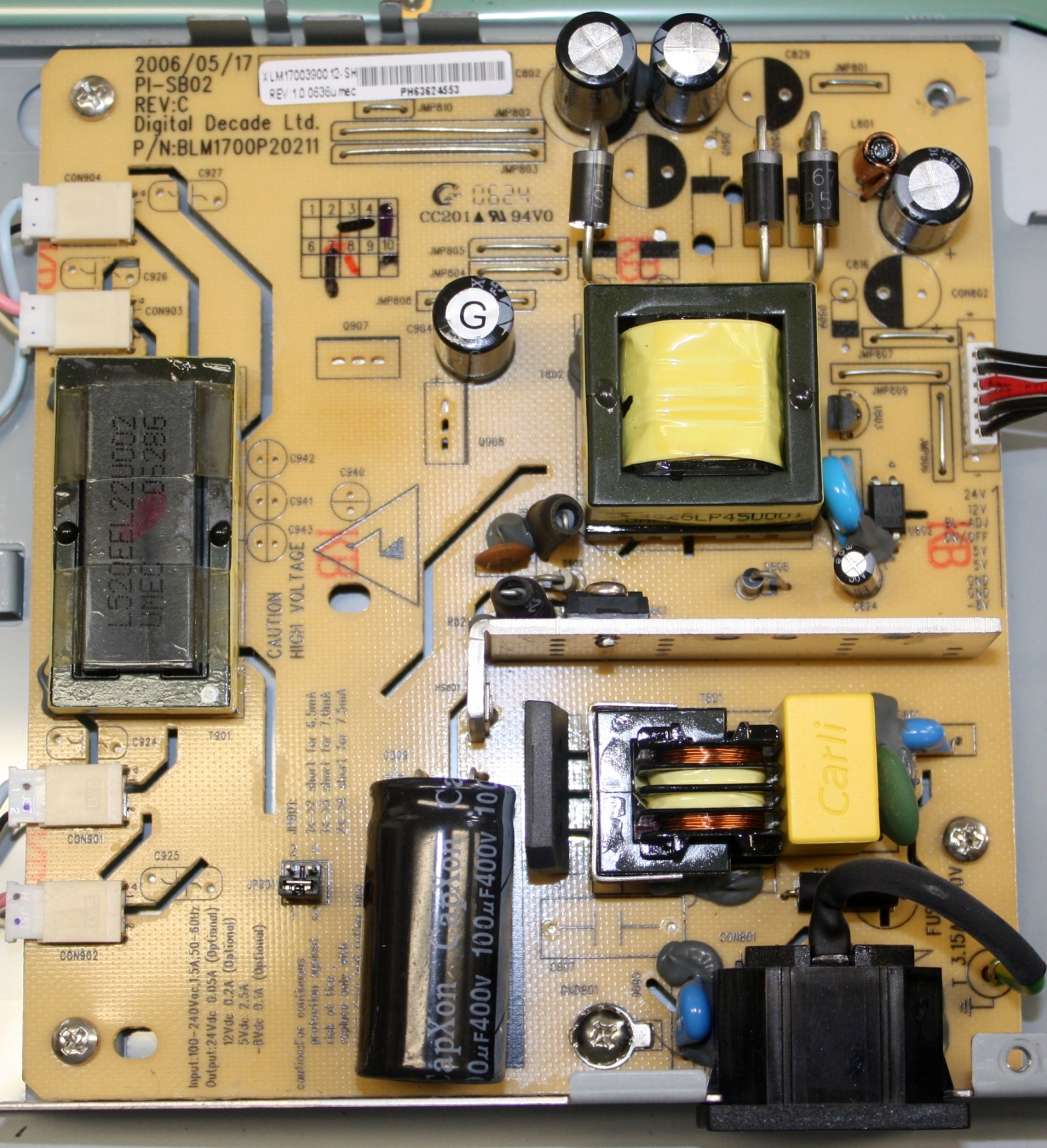

            I wanted to post a followup with more information. On retiredcaps suggestion I went ahead and replaced cap C824. I also recently built the Blue ESR kit, so I went back and tested all the caps I removed. Here's what I found:
            Location | Rating | Measured Capacitance | ESR | Comments
            C802 | 470uF/50V | 433uF | .04 | Low capacitance but ESR was fine, possibly dying
            C817 | 1000uF16V | na | 1.3 | High ESR, bad cap
            C819 | 680uF16V | na | .03
            C904 | 220uF50V | 219 | .06
            C824 | 10uF50V | 9.5 | 2.5
            Also, all the original caps were CapXon brand, known to cause lots of problems. Again, I hope this info helps someone else.
