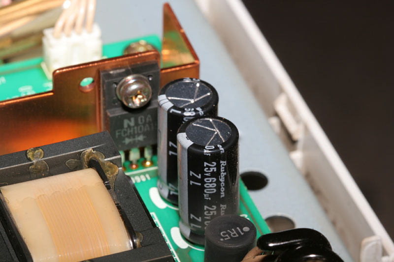

                Rainbow; All Eizo monitors I have seen uses Rubycon caps, don't tell me they have begun using crap too?

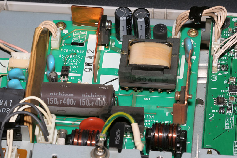

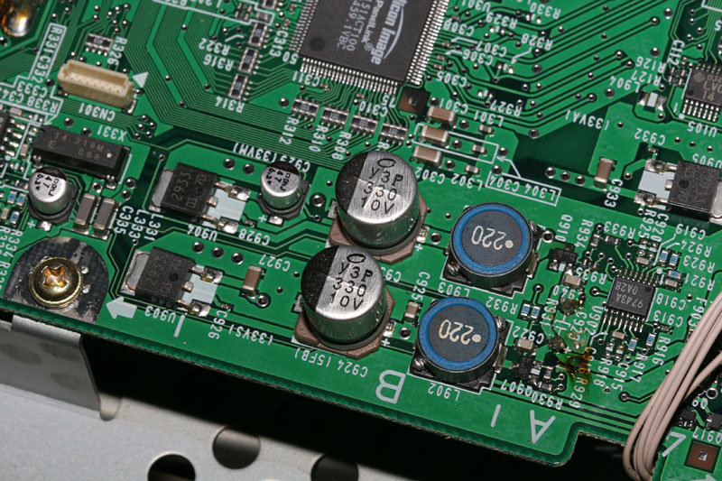

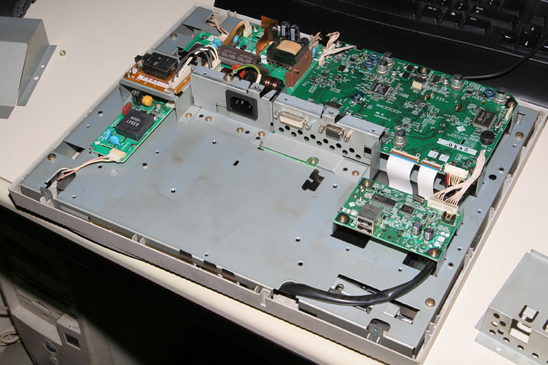

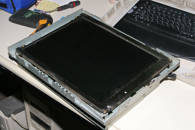

                    here's some pics for those interested to see what is inside. Per was right, Rubycon ZL, YXG and Nichicon. The panel is mitsubishi. The unit was purchased Feb/01 with 3 years guarantee. I got it apart no problems but aborted at the point of opening the screen because i thought i should read how to do that, it was not clear.
                    overview of rear of unit with cover and stand removed

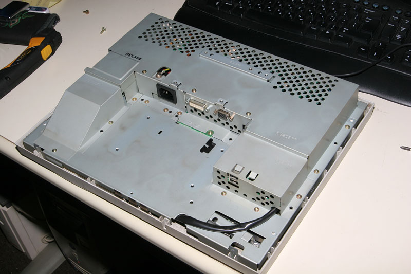

                      Re: Eizo 15" TFT Dim
                      internal covers removed
                        screen from the front side with cover removed

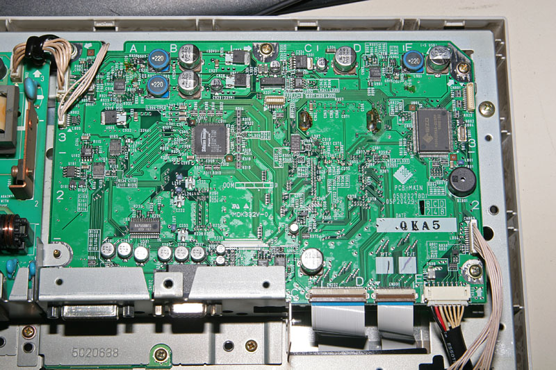

                          main pcb

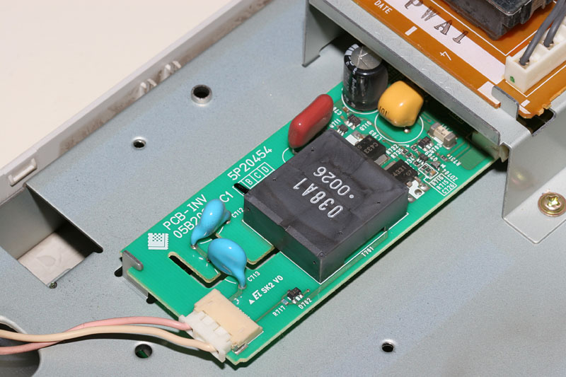

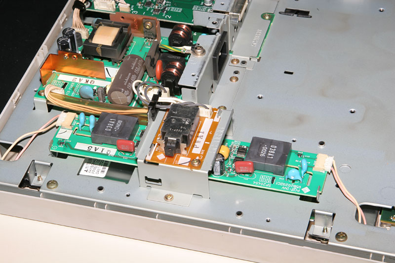

                            inverters for the 2 tubes (top and bottom)
                              close up of an inverter
                                internal power supply

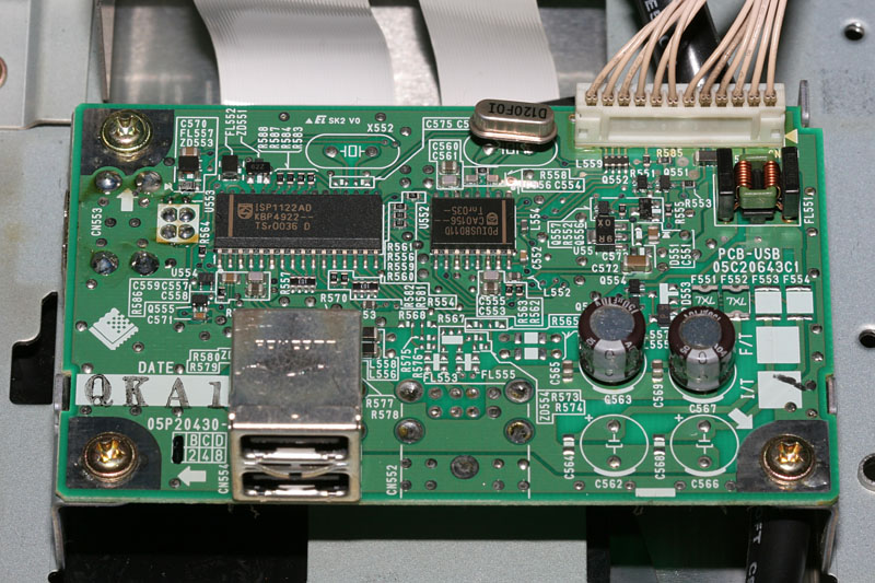

                                  usb hub
                                    rubycon zl in psu
                                      nichicon chip type smt on main pcb

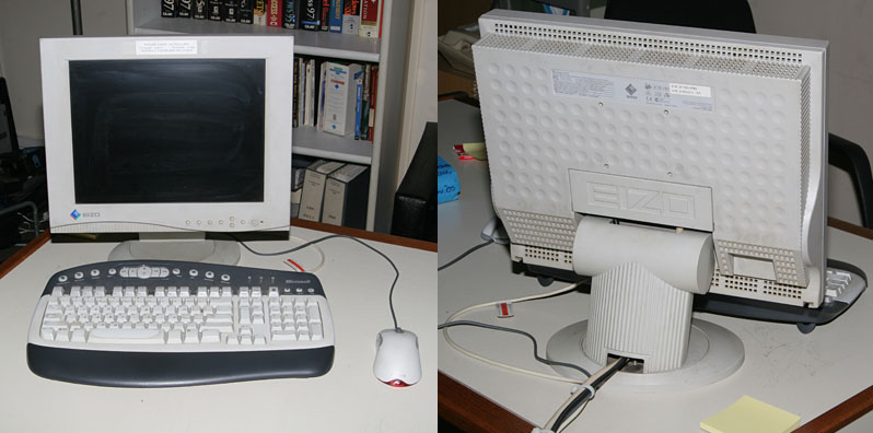

                                        front and rear, reassembled.
                                        KC8 : thanks for the advice about jkl lamps and the inverter test. the lamps are not pink though they are just dim, especially at startup where they appear brighter to the left side. I guess they will start turning pink after some more months.
