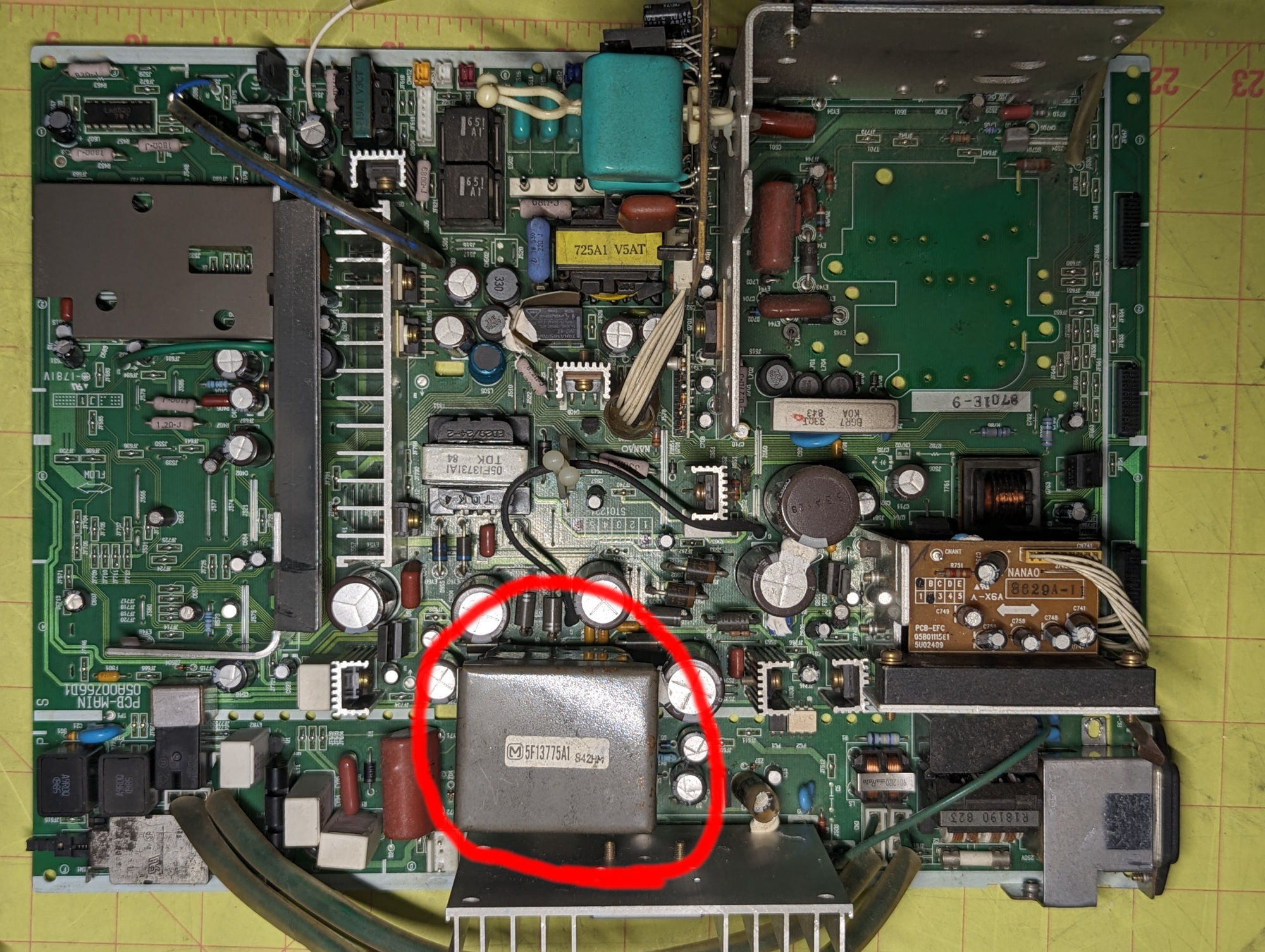

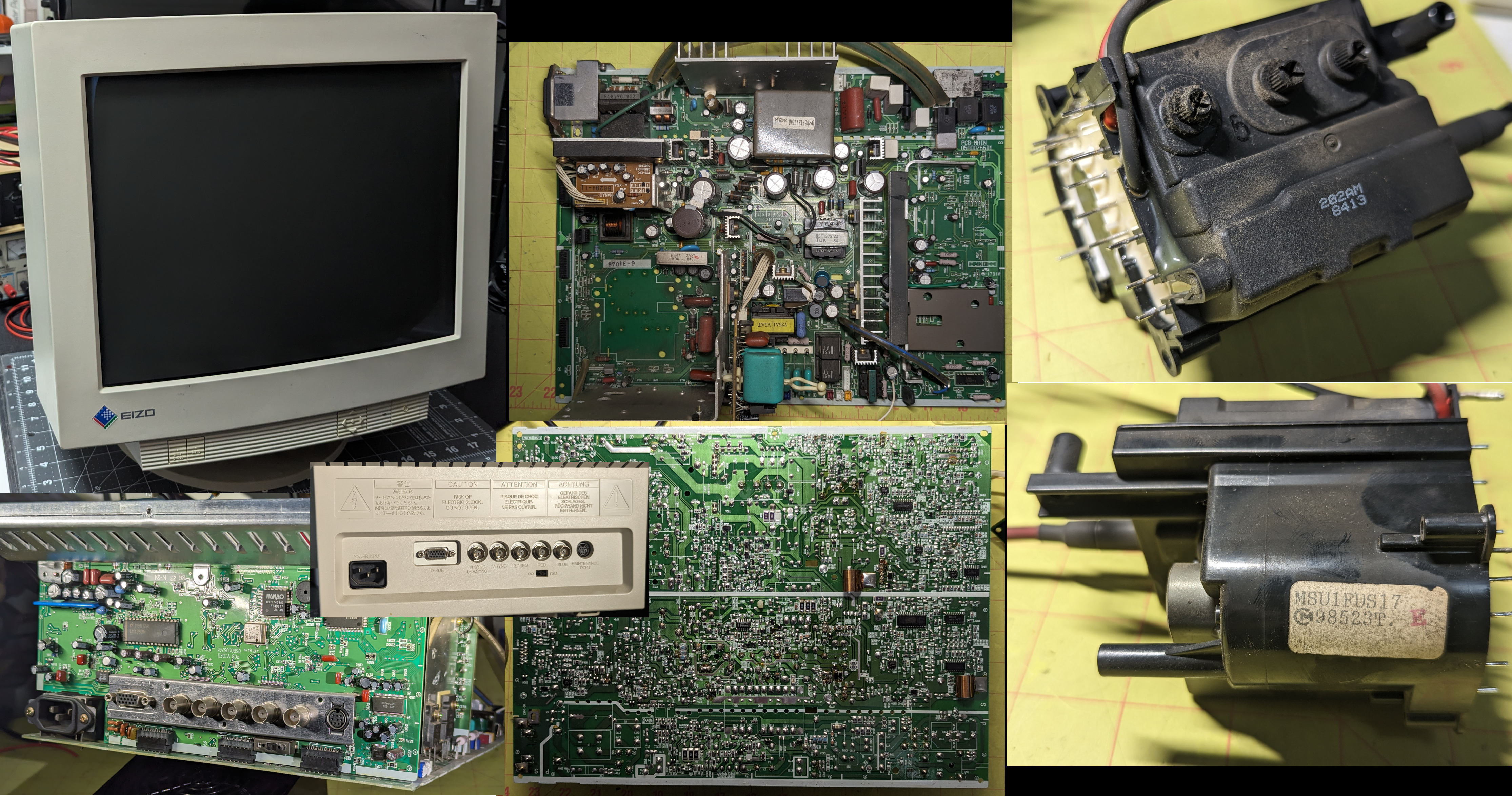

    I just saved this magnificent RGB input Eizo Flexscan TX-C7 MA-791 from the local e-waste...good news, the tube works and the board looks great...the bad news, it sounds like the flyback is shorted. (Turns on...perfect picture...systemic high voltage crackling heard while the picture flickers...then it blows the 5A fuse in my isolated A/C power supply.)
    Anyone have any leads on possibly finding a replacement? (photo shows the flyback model numbers)​

    Photo...

      And according to this site, an equivalent FBT might be the HR46290.

          As I mentioned, it is making high voltage crackling, arcing sounds coming from all parts of the monitor, but I'll definitely check the degauss relay.

            reminds me of a 14" VGA monitor I fixed years ago... there was a hole in the FBT that leaked HV out the side to the closest chassis ground, wicked spark... I stuffed it with plastic and it insulated enough for the crt to work... hah.
            hmm that fbt looks similar to one i pulled from a 17" crt I drop cracked... wonder if i still have it...

                Nope, sorry to get your hopes up, it's different though reminiscent...

                            OK, hold up a bit... I don't see a main input cap on the primary side, so this doesn't look like a conventional switch-mode PSU.
                            What happens when you plug in the monitor directly in the wall without the isolation PSU? Do this with the monitor's flyback installed. If there's a fault, let the fuse on the monitor power board handle it. I just want to make sure we are not chasing a "ghost" problem with the isolation PSU not being able to handle some kind of a high startup current that the monitor may normally have. If the fuse on the monitor board blows, then we know something needs looking after.
                            The PSU primary looks like some kind of a LLC / oscillator type found in electronic halogen lighting transformers, so not sure how that should act up with a fault on its secondary side, if there is one at all. I do see two optocouplers, so there is definitely some kind of regulation/feedback/protection going on. Might have to find a service manual for this one...

                              Thanks for the suggestion. I did try powering it up directly off the wall circuit, and the onboard fuse near the mains input did blow rather spectacularly. I saw the optocouplers. I've tested the relay that crosses the two board sections out of circuit and most of the other psu components. They've all tested good.
                              I'm still looking for a service manual.
