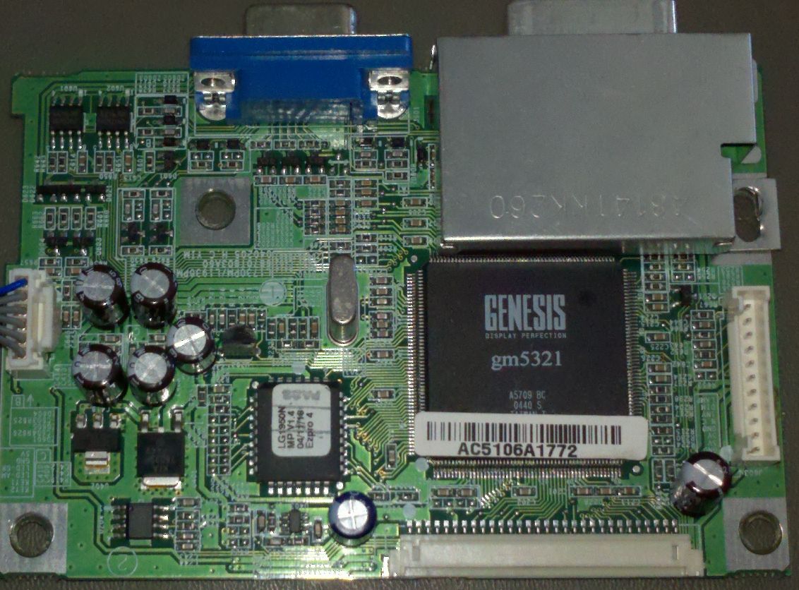

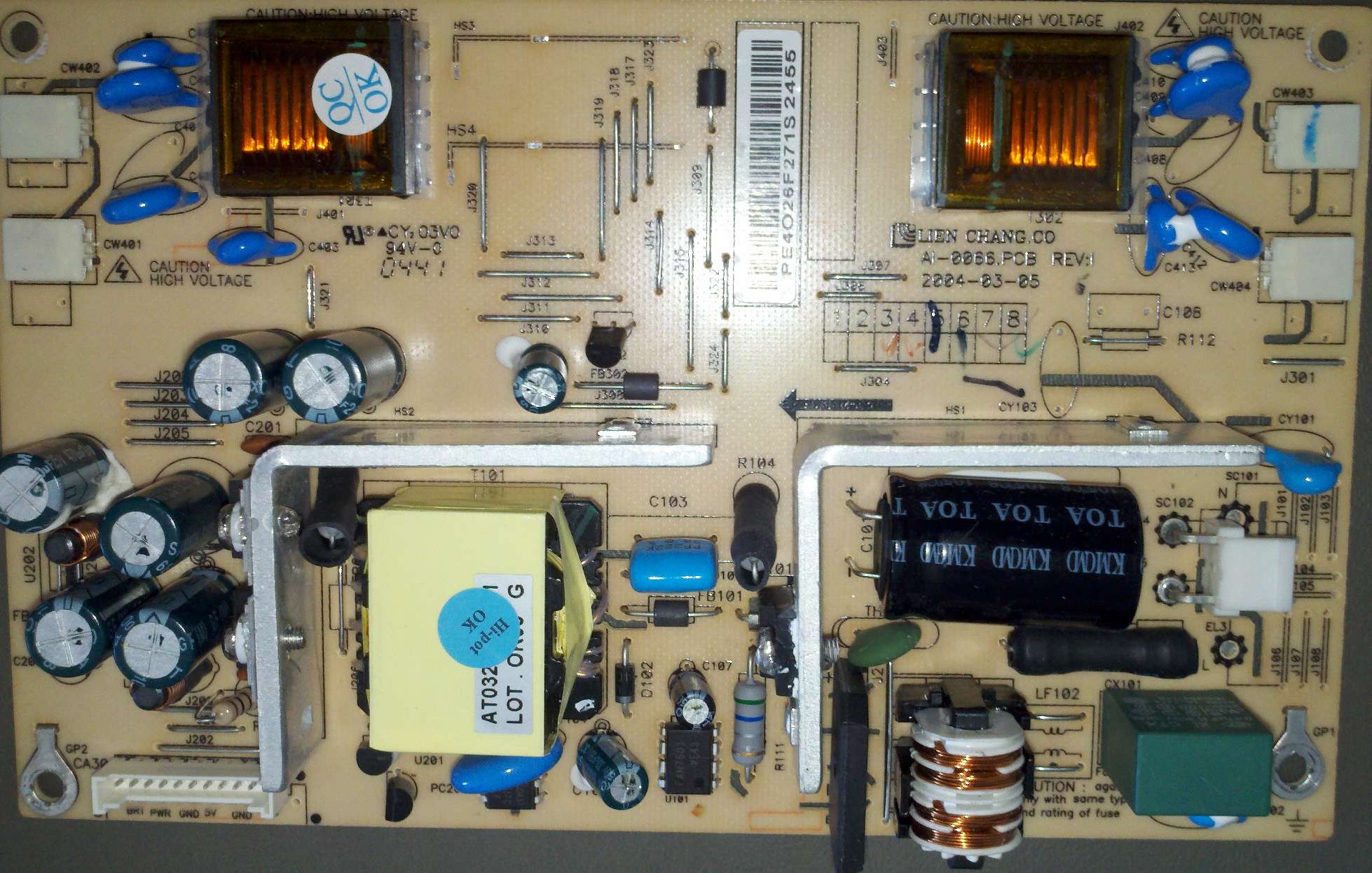

    Gateway 19" Flash
    No idea what the model number is, the back is lost for now. I didn't take it apart but wanna put it back together working
    Anyway, what I know: It generates 5V and 14.5V.
    The 14.5V should be 12V.
    It isn't the CCFLs, cause it won't work with 4 known good CCFLs
    It flashes on when plugged in, then goes off. The power led flashes at the same moment the screen flashes, but goes out. After going out, it does nothing, even when pressing the power button.
    None of the large caps are bad. Removed and tested them.
    Haven't tested the smaller caps.
    The secondaries on the transformers booth read 1.8k.
    No bad diodes or FETs.

    Oh yeah, and on the video board, U401 puts out 3.3V and U402 puts out 1.8V

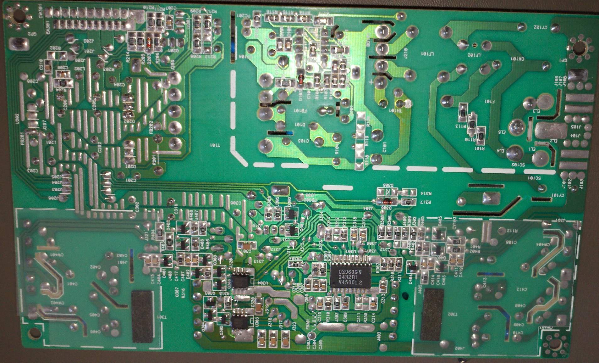

      Try checking the two surface mount mosfets on the power board, U303 and U304 for shorts.

        Did you test both capacitance and ESR on the caps? They look like Samxon GF series. If correct, they don't have the greatest reputation with forum members here.
        I believe 14.5V DC is okay and will measure 12V DC once the backlight comes on and stays on (i.e. there is a load).

          U303 and 304 no shorts
          I did test the capacitance and ESR. They were fine.
          I checked the smaller caps, and esr doesn't check out. It's C109, next to the transformer with the HiPot Ok sticker (bottom right corner of transformer). Could that one be an issue? It's 33uF, 50V, and I don't have a 33uF at 50V. I have a 47uF 35v... Not sure if I could get by with that...

            The 33uf appears to be a cap for the startup circuit. Since you are getting the 5V and 14V outputs, that means the power supply portion is up and running and the caps are doing their job.
            If you connect the monitor to a working computer and point a flashlight at an angle towards the LCD screen, do you see a faint image of the desktop? If yes, then the inverter circuit could be at fault.
