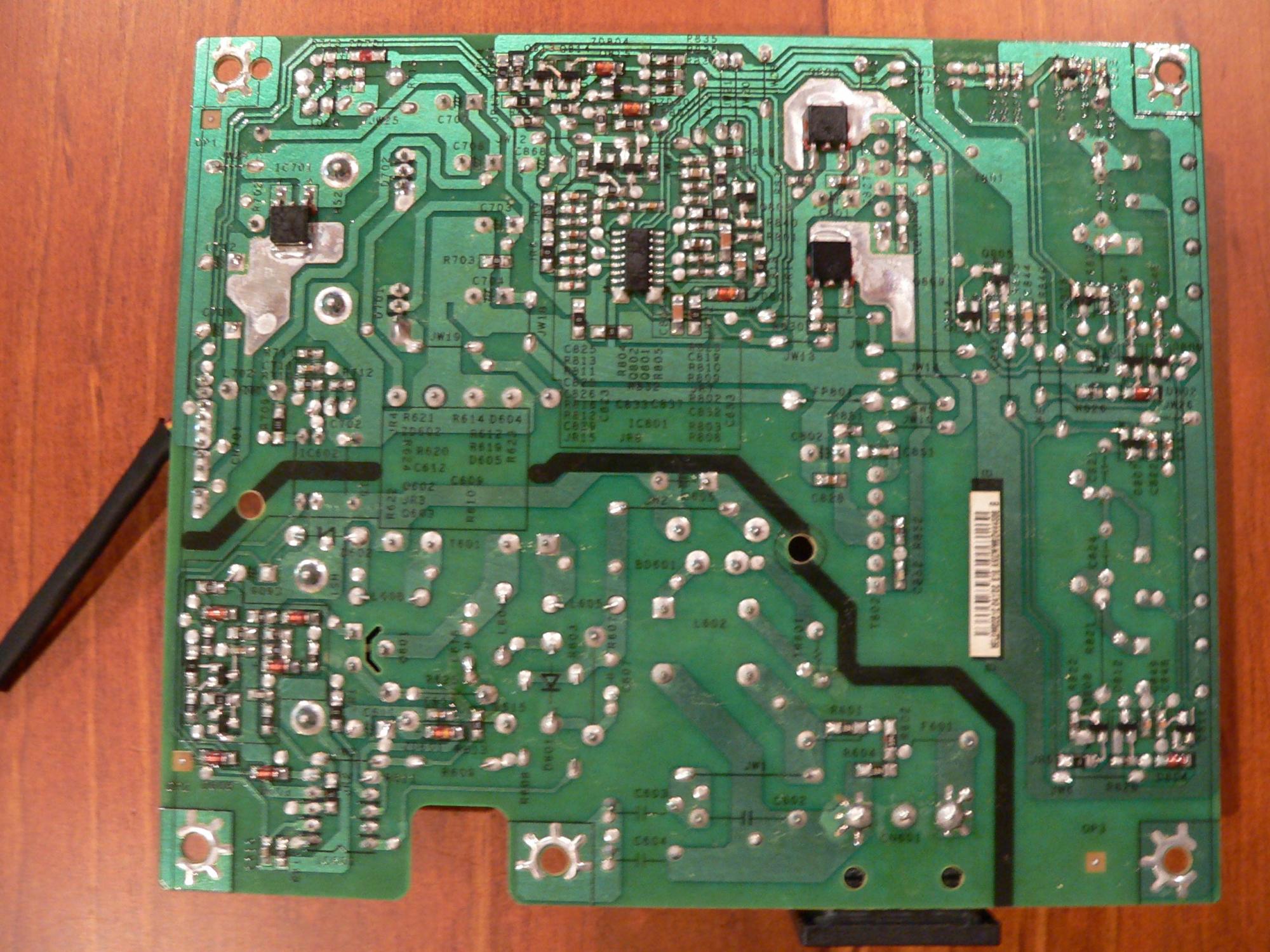

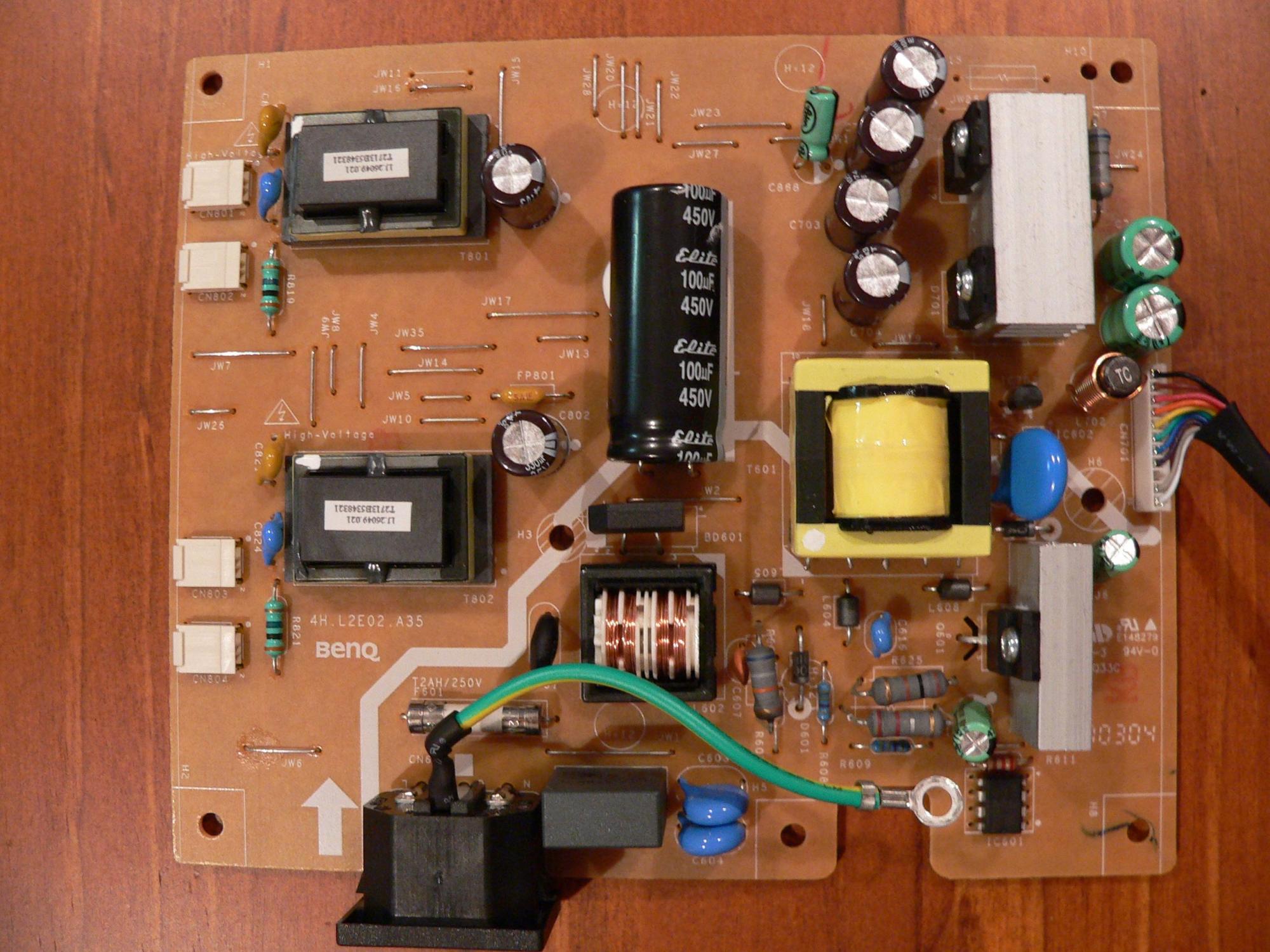

    I have attached a front and back photo of the PSU board for reference. The part number of the PSU baord is 4H.L2E02.A35.
    The supplier of the replacement PSU boards gave instructions for disabling the protection circuit on the PSU which I did not think was such a great idea. I guess this activates when the CCFL is faulty and I am wondeing if that is what is happening in this situation since two replacement PSU boards both have failed.

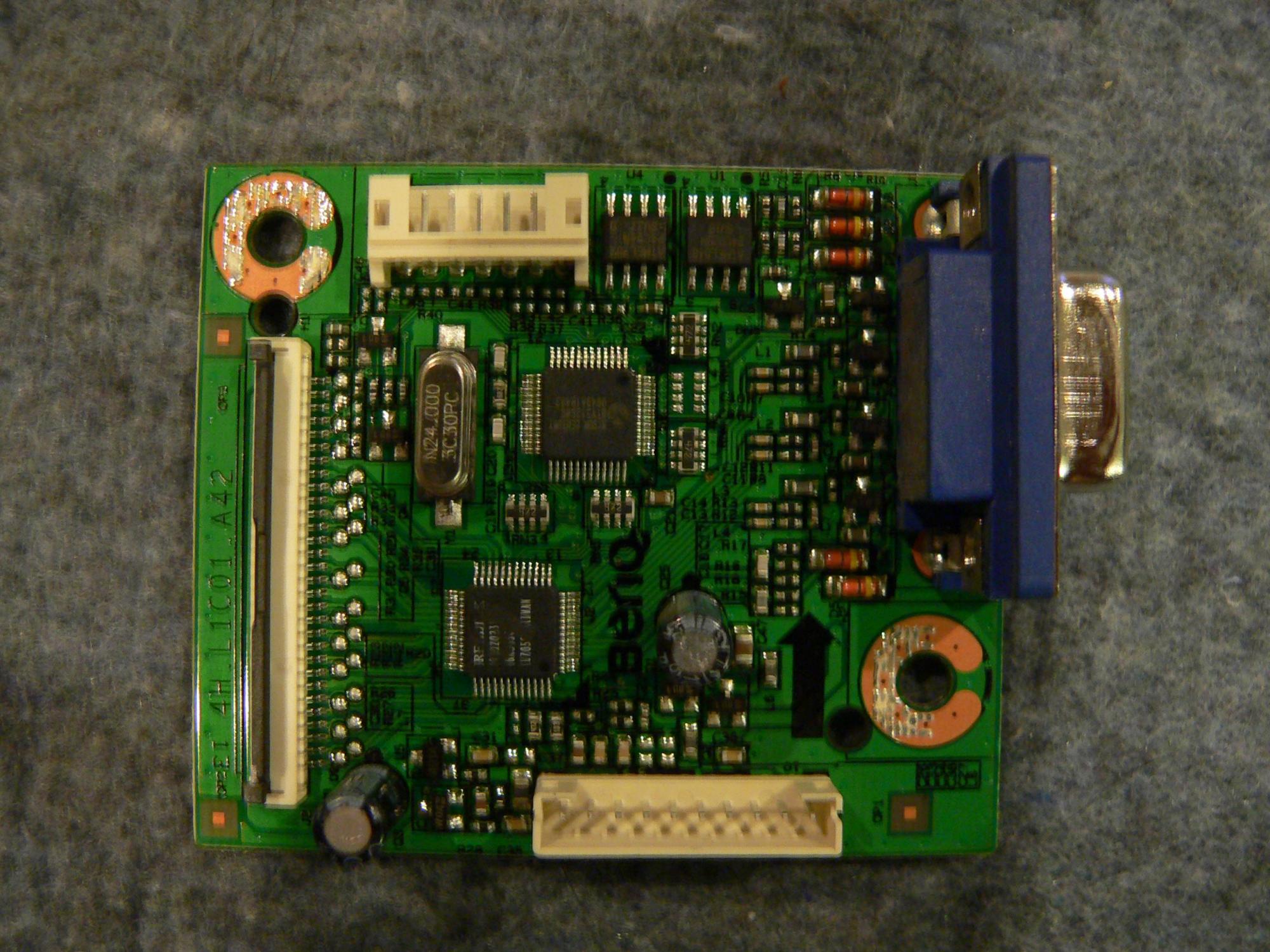

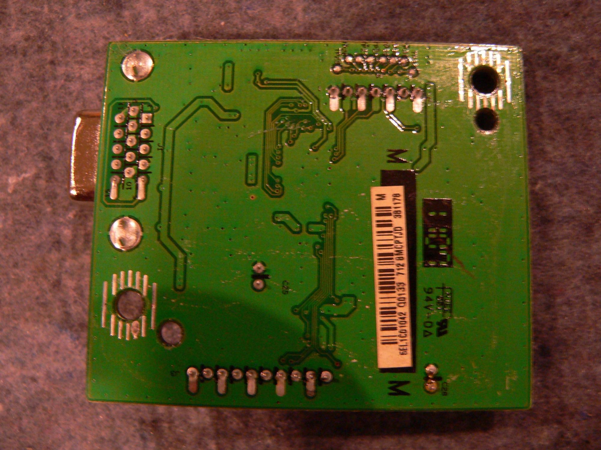

      I have attached photos of the logic board but I would have thought it strange for this to be an issue if the 1st replacement PSU ran the monitor for around 40hrs before failing. I find it hard to suspect any other component of the monitor is faulty because of this fact. I guess I am making assumptions here and if there is one thing I have learnt about technology that is not to assume anything.

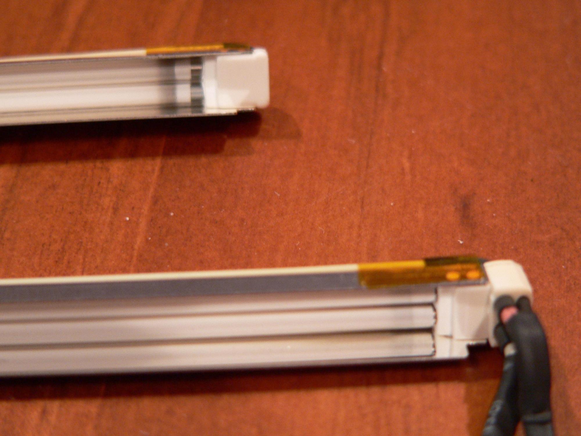

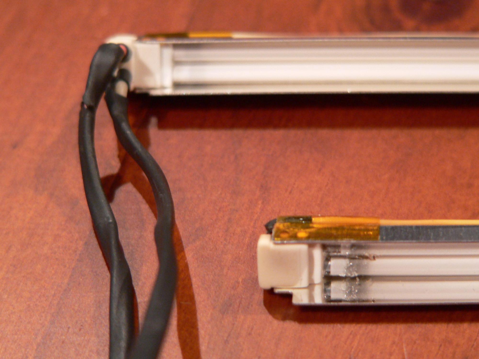

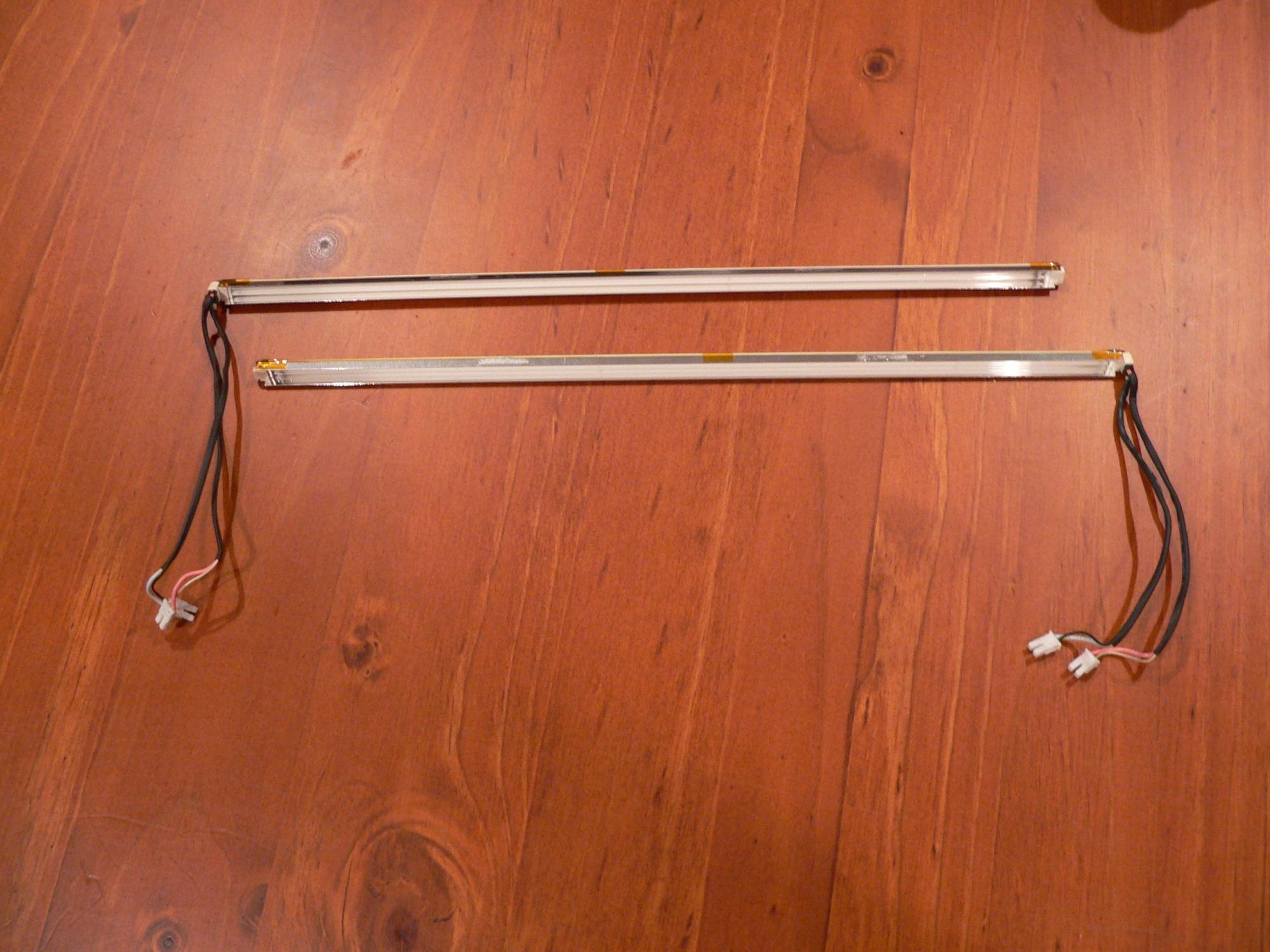

          I checked out this thread (https://www.badcaps.net/forum/showthread.php?t=7565) and then decided it would be a good idea to get a look at the ccfl tubes in my panel.
          See attached photos.
          I have noticed that they have a small amount of blackening at the opposite end to the leads which I am guessing is not good.
          So can one faulty tube cause the whole inverter for all 4 tubes to shutdown? - because that would explain my issue - and hence the PSU suppliers protection override might be a sensible troubleshooting technique. Doesn't explain why the latest replacement will run the tubes for 20mins when its cold however whereas the other two PSU will only run for 2sec or so.
          Question from here is there any technical way to test the tubes to determine if they are faulty without any specialised equipment for this purpose?
            Re: Benq FP71G+ Q7T4
            Your tubes are on their way out and yes this would cause your problem ,
            as you have them out you can plug them into the psu and fire it up but be careful and watch them they wil probably flicker or show a slight pinkish hue
            You say you have another panel what model monitor was it from
              if they have a slight pink-ish tint when lit up cold, they're on their way out.
              the more pink-ish it is, the worse is the condition..
              worst i've seen so far was a pair of CCFLs that lit up bright red.
              came from an industrial monitor.. no shutdown feature on the inverter.. it just runs them into the ground no matter what..
              edit: 2nd pic, lower pair: actually looks like the CCFLs are cracked?!
                Just had a closer blown up look and still not sure if they are cracked but would def say they need replacing

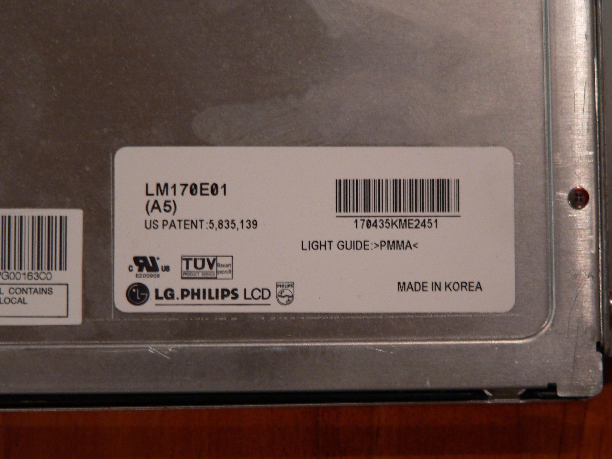

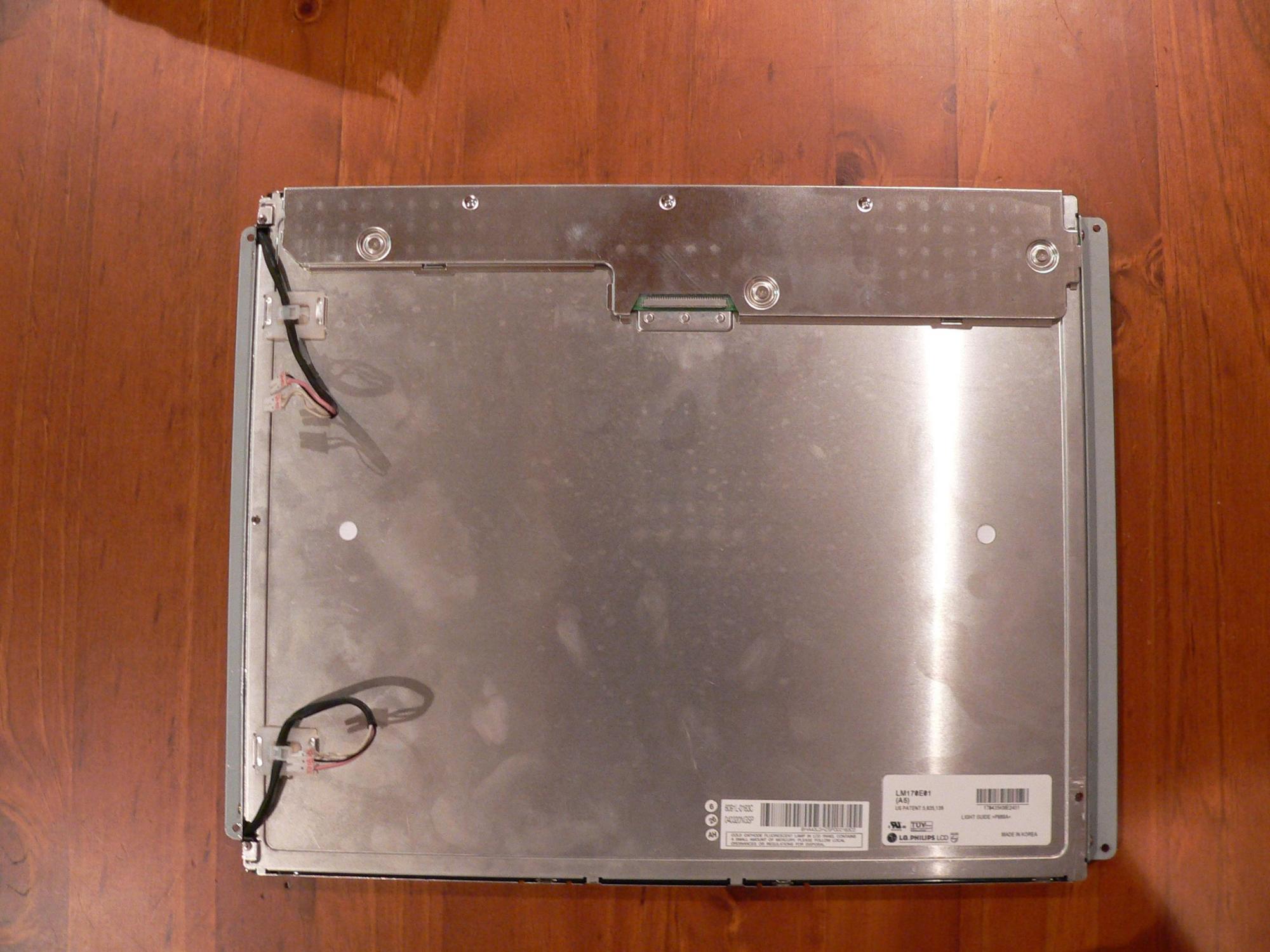

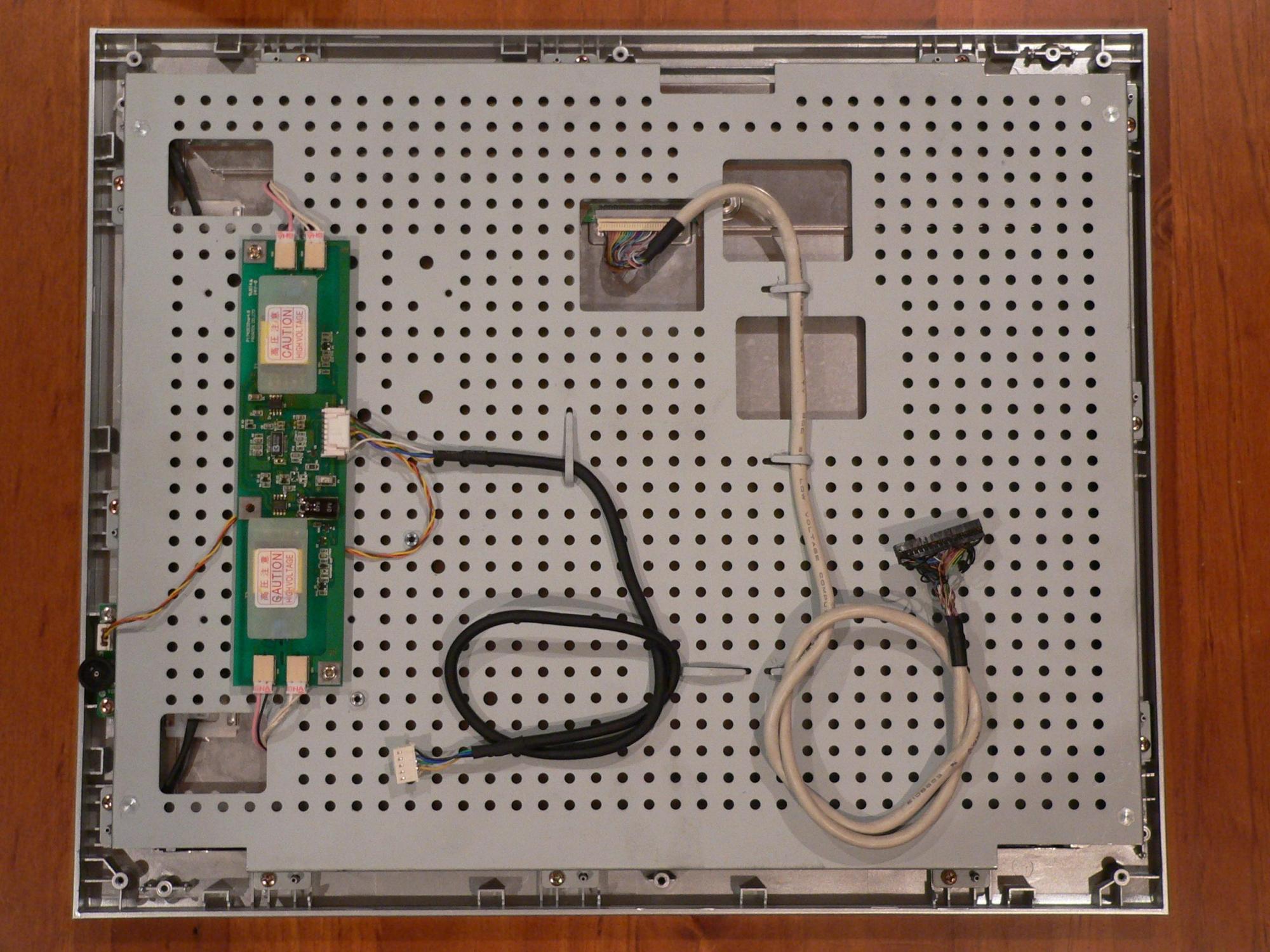

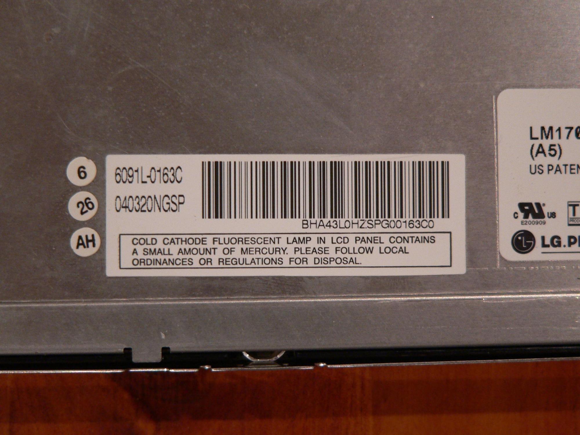

                  The other panel that I have is a LM170E01(A5). There is also another barcode with number 6091L-0163C and 040320NGSP on it and a ccfl warning.
                  The ccfl high voltage leads are the same on both this panel and the BenQ monitor panel.

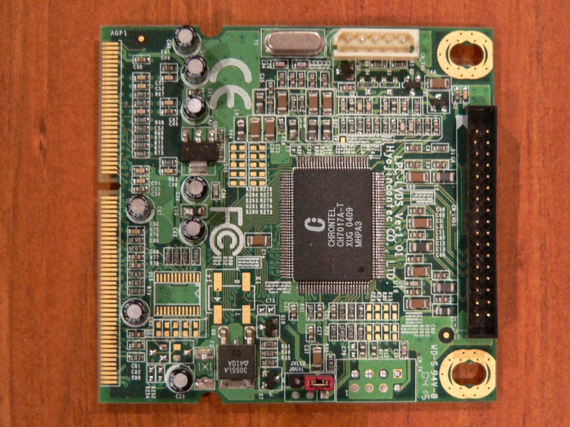

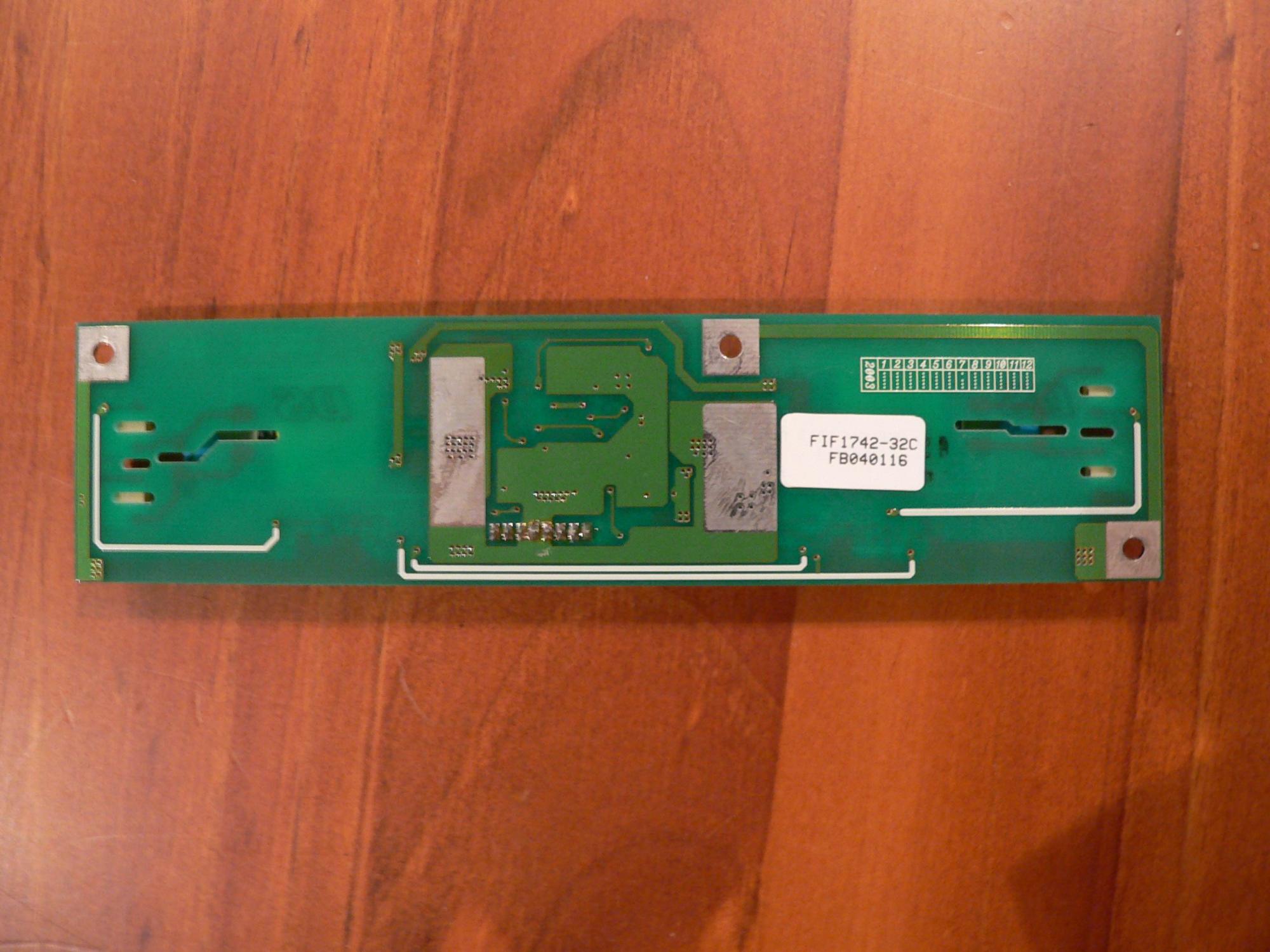

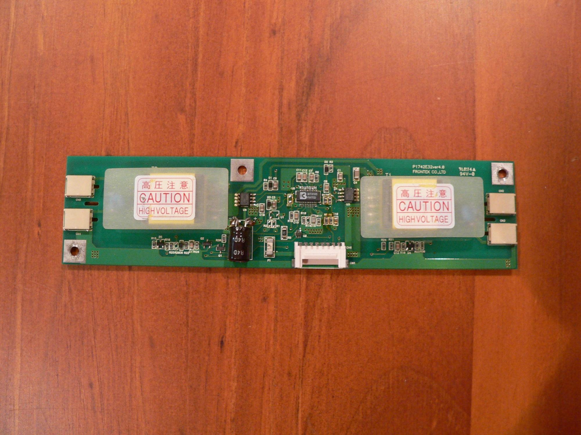

                  The panel comes from a kiosk PC which had a bad mainboard. The mainboard was not repairable easily and no spares were available (it was only a celeron anyway) The panel was driven by a custom mini-PCI board (might be AGP actually). The panel itself is fine but I don't have any logic to drive it. It has a custom inverter with part number FIF1742-32C and FB040116 on it.
                    Post a pic so we can see it
                      Here are the pics of the spare display panel I have. If these ccfl tubes are compatible then it might be an easy way to test.
                      Also if anyone can identify the controller PCB or know of any way I can drive this panel feel free to chip in. I do have the mainboard it plugs into but there is nothing relevant on it really. The socket it plugs into is labeled AGP1. The mainboard is a LPC-845G. (Not looking to fix it as the main body of the kiosk has been ditched)
                        Well i would suggest you hook this panel up using the guts of your benq .
                        It looks like there are side rails on the screen if they come off would it fit inside the case of the benq if it does give it a try looks like it would run video as well but if not will run as a tester to see if it shuts down.
                        If the video board wont connect it wont matter as long as you have a vga connection from a comp to it it wont go into no signal shutdown and see if it runs .
                        But i am pretty certain its the lamps that are at fault on your other screen .

                            I know how I hate finding a forum thread with a reported problem but no followup result so:
                            I would just like to report that it was indeed the tubes which were crook. I was able to obtain some replacement tubes from eBay which fixed the problem.
                            I would however say that if you are considering doing this get the tubes with the cables attached as soldering very thin CCFL and associated wires is a hassle and its very easy to snap them.
                            You do however need to be careful as the rubber endcaps do differ slightly between display panel parts and this may be a reason to get the bare tubes so you can re-use end caps.

                              Hello, i have a LCD Monitor BENQ FP92W Q9W5 and my screen got brooke, i find another screen but i forget how can i connect the high voltaje lamps 4connectors to the electronical Benq 4H.L2E02.A35. There are 4 connectors CN801, CN802, CN803, CN804 and i do not remember where to put cable with pink/white and lightblue/black. Tanks
                                Pictures of the board? There is are two lamps for the top edge of the screen, and two lamps for the bottom edge of the screen, each lamp has two wires so you just treat each lamp as individual. The two lamps for the top can go into any one of the two lamp sockets close to the top edge of the screen, same for the two sockets for the bottom edge of the screen.
