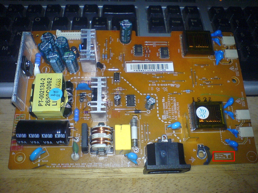

                edit: PSU in mine is a LIEN CHANG (?) (*click*)
                and this is what i mean by the XP style no signal message box:

                  Resolder the inverter transformers, lamp coupling caps, all those jumpers, and the two DIP FETs.
                  On a 17" HP, I resoldered the whole board. This sat in my closet for a few years, and worked for a few hours after I took it out. Then intermittent brightness pulsation, sometimes the top backlight was a different color/brightness from the bottom. After 20 minutes, it got so bad, it would only work for 10 seconds with each power cycle. Not the caps. This unit had jumpers for *everything,* and all over the inverter, cracks in the lame excuse for solder. When the tuning caps across the primaries of the inverter tx's started to lose connection, the inverter PWM must've sensed the excessive voltage. It would've eventually ate the inverter transistors, a-la EFP172.
                  Did it work after resoldering? You bet.

                      @ kaboom: Is that really a HP PSU? Coz it sure looks like the one i have in my LG. Complete with similar markings on the transformer, dozens of jumpers and all.
                      @ Scenic: I have a similar check cable screen on mine. I've also seen this type of menu and info screen on Samsungs. I guess it's the same HongKongFlyApart company - (c) Toasty - who makes them.

                          Re: LG Flatron L1950S - advertised as broken but...
                          That *is* your LG. I just put a red box around 'PB Free Solder.'
                            Just read the above posts again - it's Scenic's LG. I didn't remember posting pics of mine - and indeed i did not.
