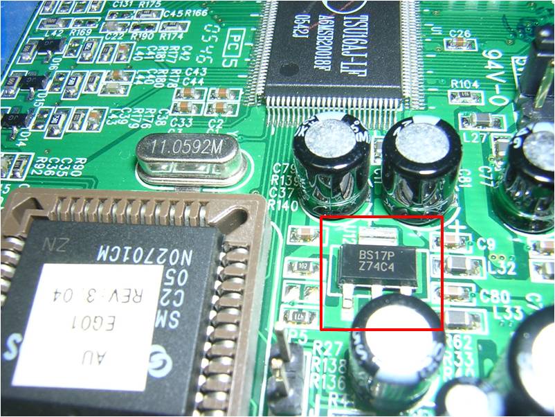

    I am working on a monitor VT17W7X and i need help identifying a replacement part and where to find datasheet.
    Can anyone help?
    I am enclosing a pic of the device.

    I guess, it it AIC1117ACY (SOT-223) voltage adjustable version, used to supply 1.8V.
    and seem to working fine from voltage measured in your other thread.
    2) Markings: BS17P, Z74C4 (could not find datasheet on this one):
    Pin1: Measured 0.606V DC
    Pin2: Measured 1.87V DC
    Pin3: Measured 5.06V DC
    datasheet =>

      On my working monitor I was measuring 2.5 volts on the center pin on the bs17p regulator.
      I know I checked more than once. The only thing that was not hooked up was the LDVS cable to the LCD panel. I have another working logic board is there anything else I could check to help narrow down the problem.

        This data sheet shows a fixed version, and one is 2.5 volts
        http://www.datasheetarchive.com/Inde...A00426185.html
        Whatever I do, I consider it a success, if in the end I am breathing, seeing, feeling and hearing!
        • POM_MJ
          • Aug 2009
          • 228
          Re: Help identifying replacement part
          Yes, there're fixed versions and adjustable version to be used in different design.
          but for Welchs101 question and his thread, it's adjustable version I thought.

            how to know if its a fixed vs adjustable? I have no idea?

              fixed ones usually have the output voltage in the model number... like "1117A-33CT" ... the -33 indicates 3.3V output voltage..
              same thing for -18 (1.8V) and -25 (2.5V)
              edit: in turn, some adjustable ones have a model number ending with -ADJ. Not all of them though..

                in my opinion,
                for fixed output voltage version, pin1 is always 0V (ground), pin2 output the fixed voltage, pin3 input.
                for adjustable version, pin1 is not 0V (0.6xxV as your measured) because it's pin function to adjust output voltage.
                (see the datasheet for more information).

                  not sure what to order. I guess there is no way to find the datasheet for the actual part..........am i going to have to buy both and try them both out?

                    You've been given the datasheet link, and now I've attached it here. Read it.
                    It IS the datasheet for the part. Read it. Page 2.
                    Absolutely correct.
