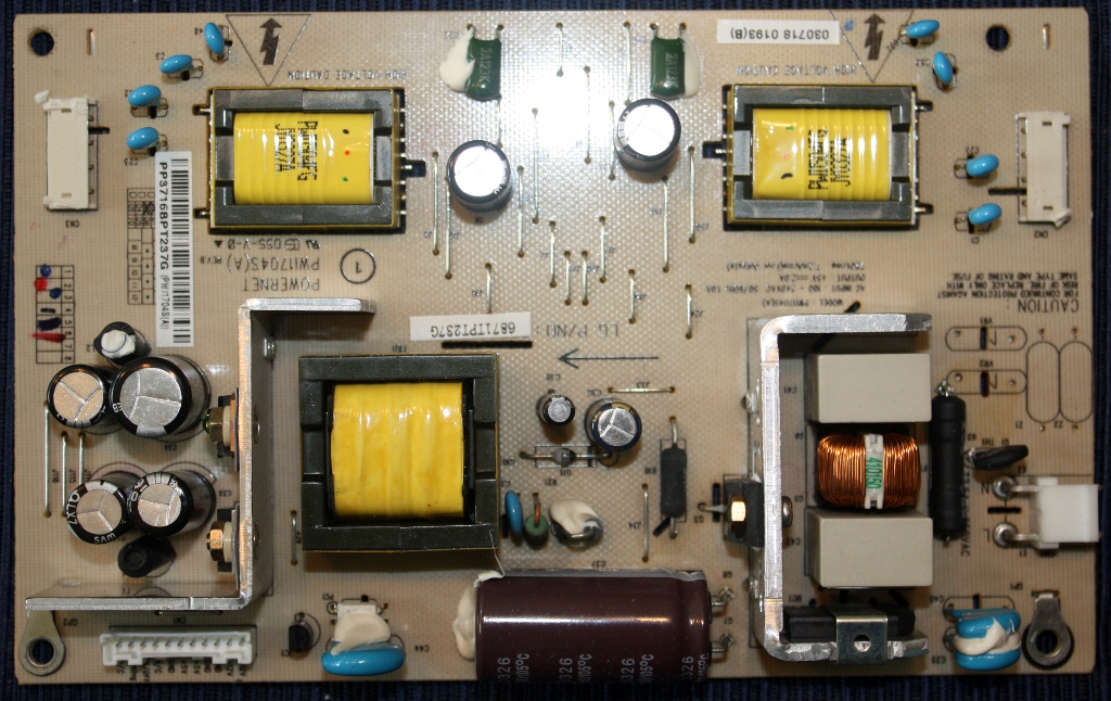

              Yesterday the parts arrived.
              I put in the new 27K, 3Kv (blue caps) and I also removed old solder from the transformer and kinda cleaned it up a bit. THen i resoldered the transformer (the one in the inverter section).
              AND IT WORKS! I have had it on now for about 20min and everything seems fine.

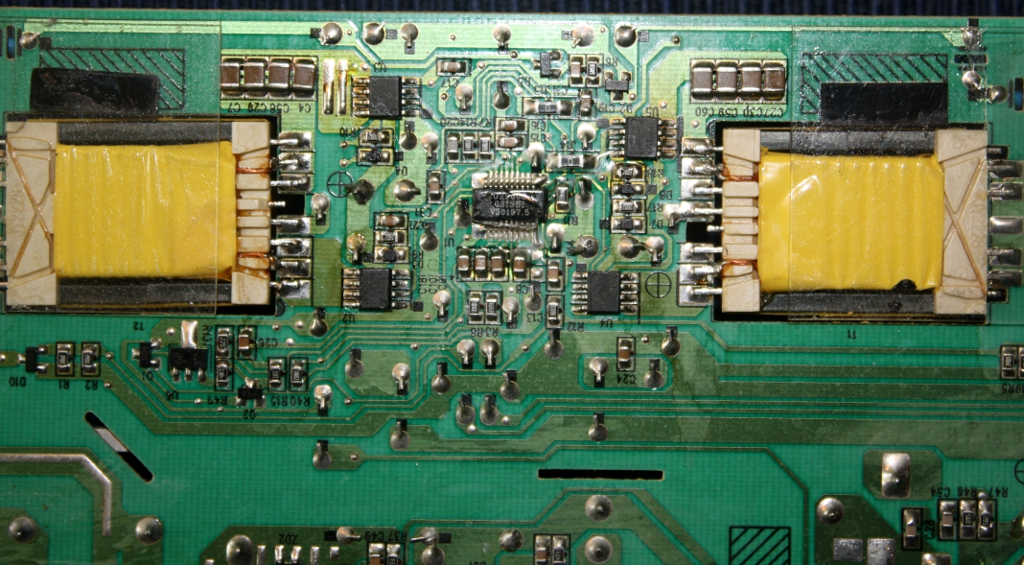

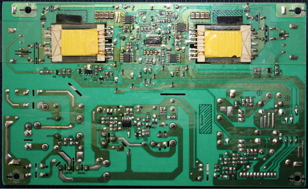

                                        I finally got a chance to snap some pictures of the power/inverter board. Although I'm not pleased with the quality, I may take them again. In the meantime, here's the front and back of the board, plus a zoom in of the inverter section.
                                        I have already cleaned up the solder around the inverter transformers. It didn't fix the problem, but it looks much better than it did.
                                        In between the two inverters are 4 mosfets (datasheet is located earlier in this thread). I'm by no means an expert when it comes to testing components like this. I set my multimeter to diode and tested these four chips. All four chips test exactly the same. So my guess is the mostfets are fine. I may go so far as to probe the "gate" lead during power on to see if I have a signal.
                                          1) I usually check mosfets for shorts by doing the following
                                          Identify the part number and search for its datasheet. Once you find the datasheet, the pins will be designated source (S), gate (G), and drain (D). It will probably be documented as S1, S2, G1, G2, D1, D2.
                                          Simply test
                                          a) black on pin S1- red on pin G1 - record ohms
                                          b) black on pin S1- red on pin D1 - record ohms
                                          c) black on pin G1- red on pin D1 - record ohms
                                          Repeat for the "2" pins. That is S2-G2, S2-D2, G2-D2.
                                          Any reading under 30 ohms suggests a short.
                                          2) Did you check the inverter transformers to see if your secondaries are around 597 ohms?
