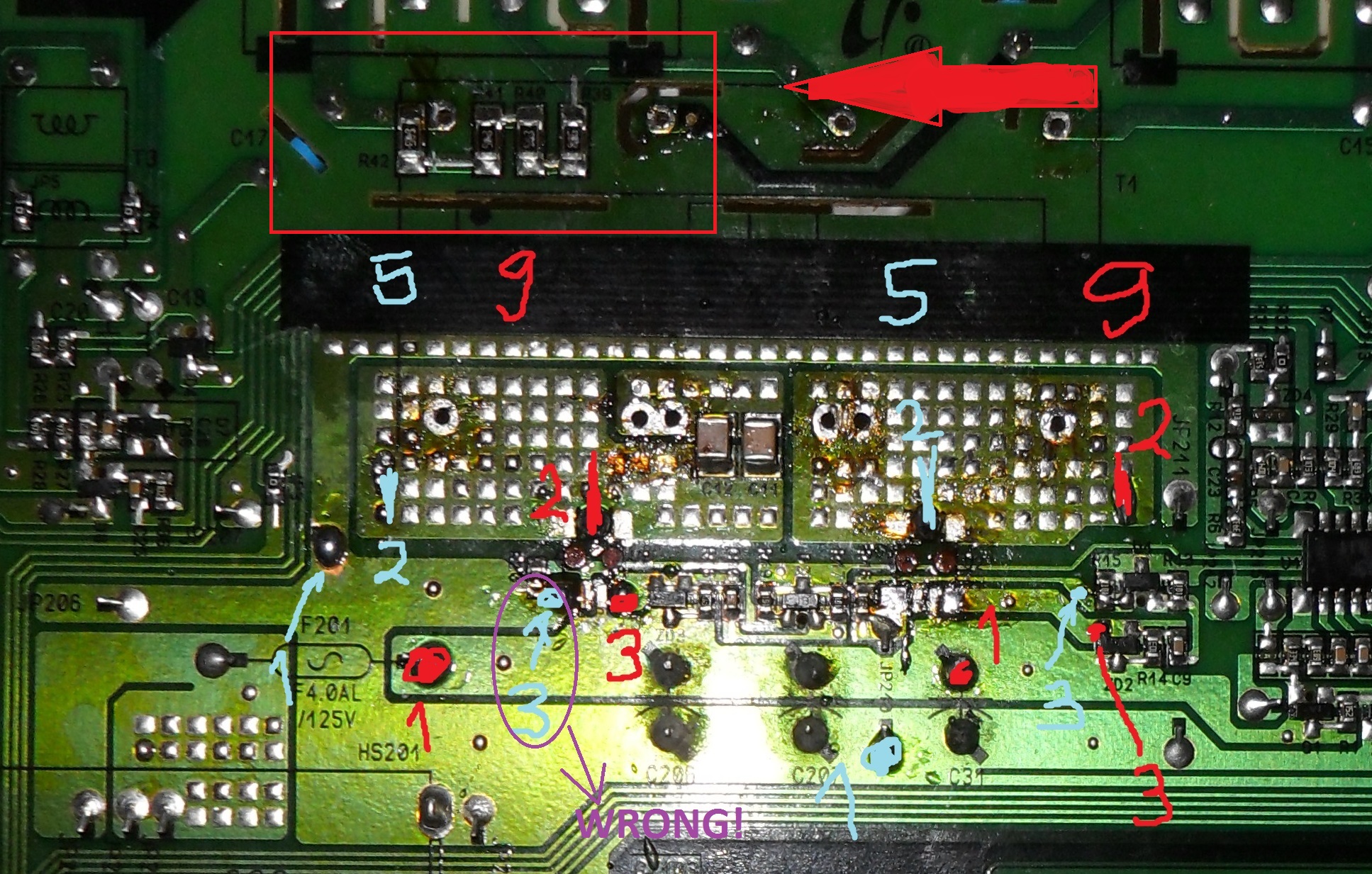

              Another repair of this one.
              I need a better shot of the part marked on the attachment.
              Or if anyone can tell me what are the R39, R40, R41 and R42 since they
              burned out on my board.

                Replaced every cap (as always jut to be sure), replaced the MOSFETs since they were
                severly burned, put everything back together turned ON, everything worked for lets say 5 minutes.
                Now its back to start again, keep getting 2 seconds to black.
                I think its those components that I marked but I dont know what hey are since the whole area burned out.

                  Originally posted by lule.nikolic
                  Or if anyone can tell me what are the R39, R40, R41 and R42 since they burned out on my board.
                  I don't have this monitor. In case you don't get an answer from anyone else, my best suggestion would be to remove those components and clean the area very well with IPA (alcohol). Make sure there is no carbon deposit left, as that can be conductive.
                  Those resistors, R39-R42, look like they are on the high-voltage outputs, so they probably have a very high resistance value (I'd say 0.5 MOhms or more). They also appear to have an identical value. Not sure if that would be of any help, though.
                        Hi guys,
                        I just started working on the same monitor and i can read the 4 parts you are looking for. all 4 are 563
