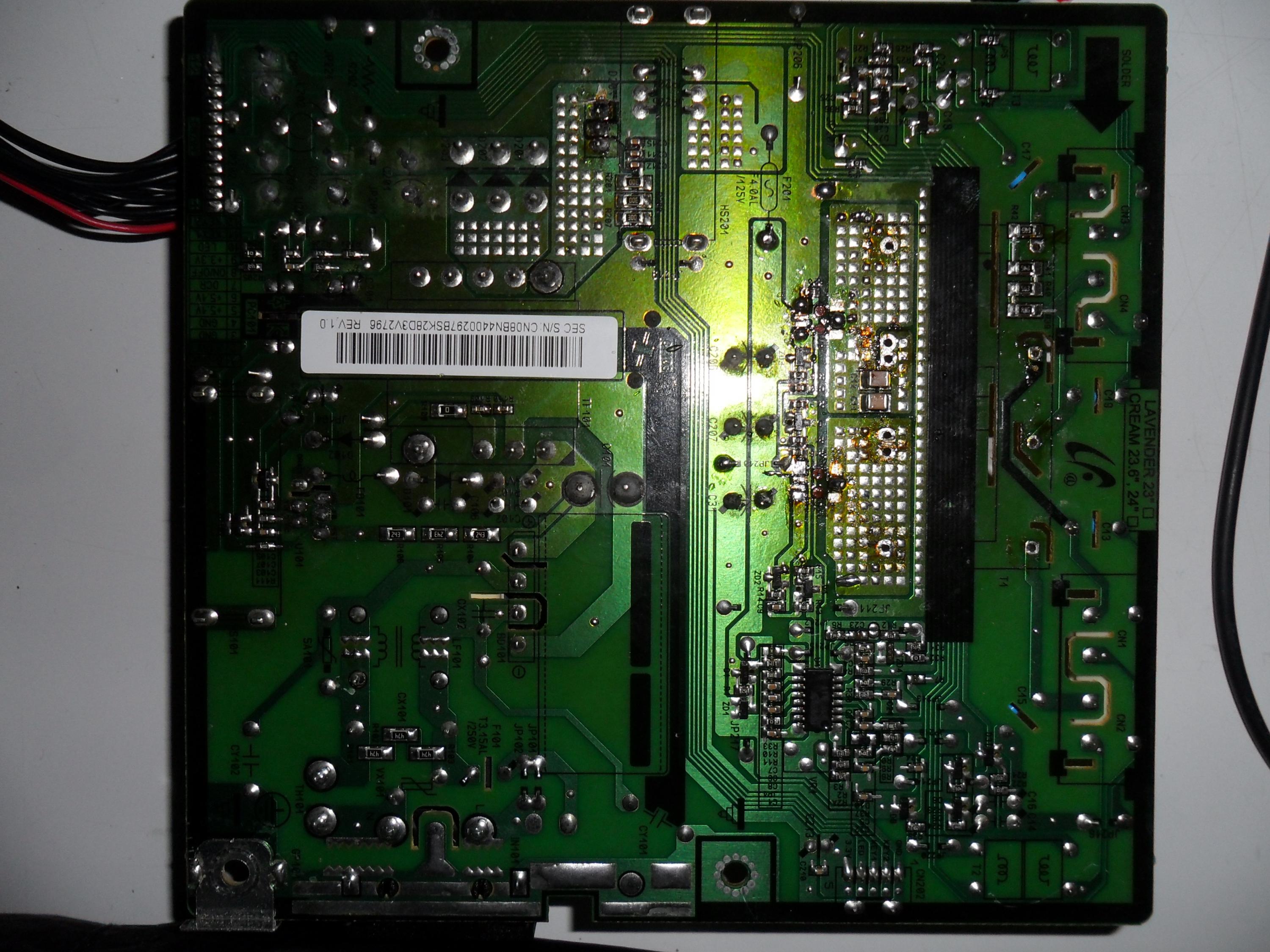

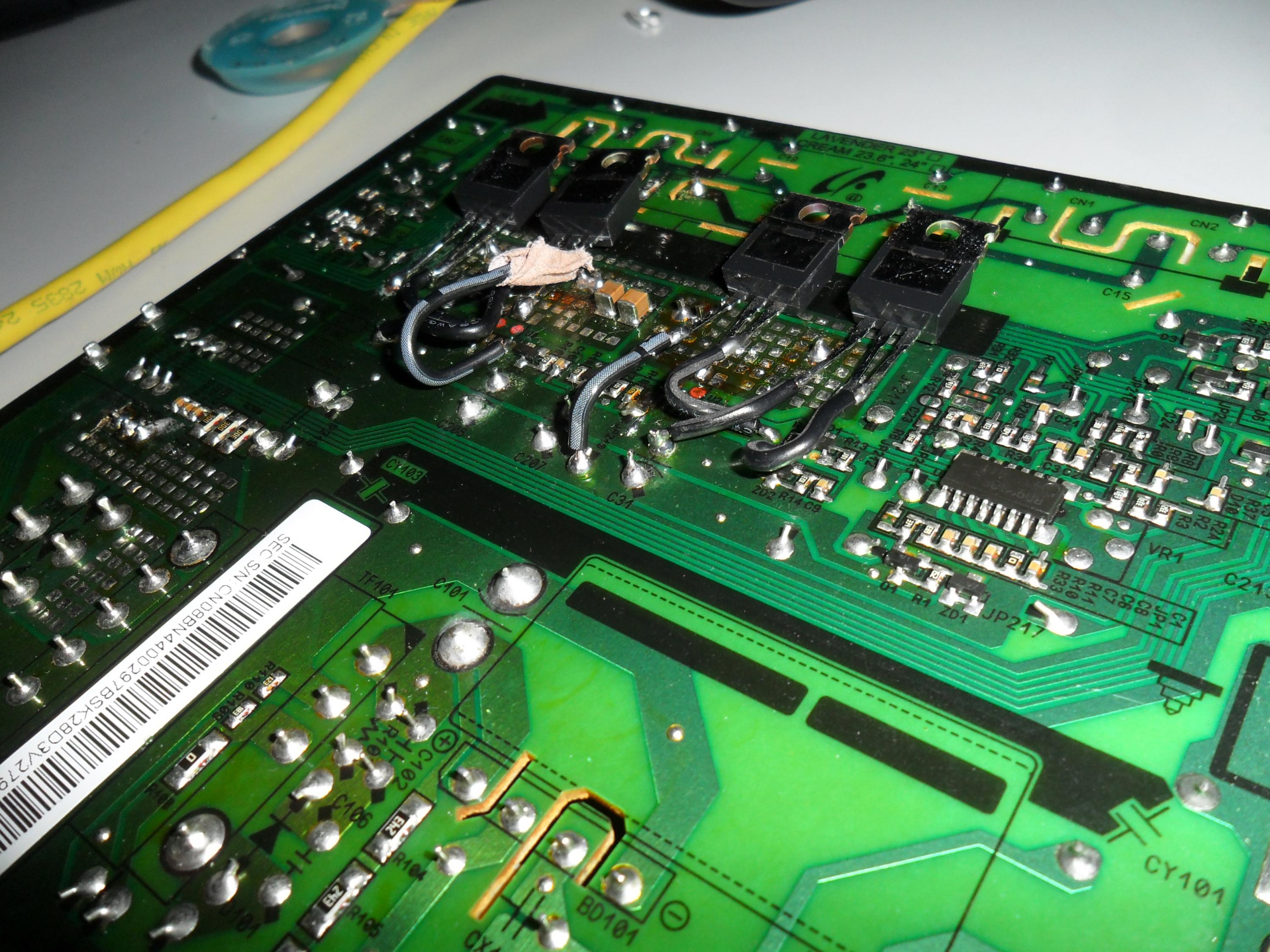

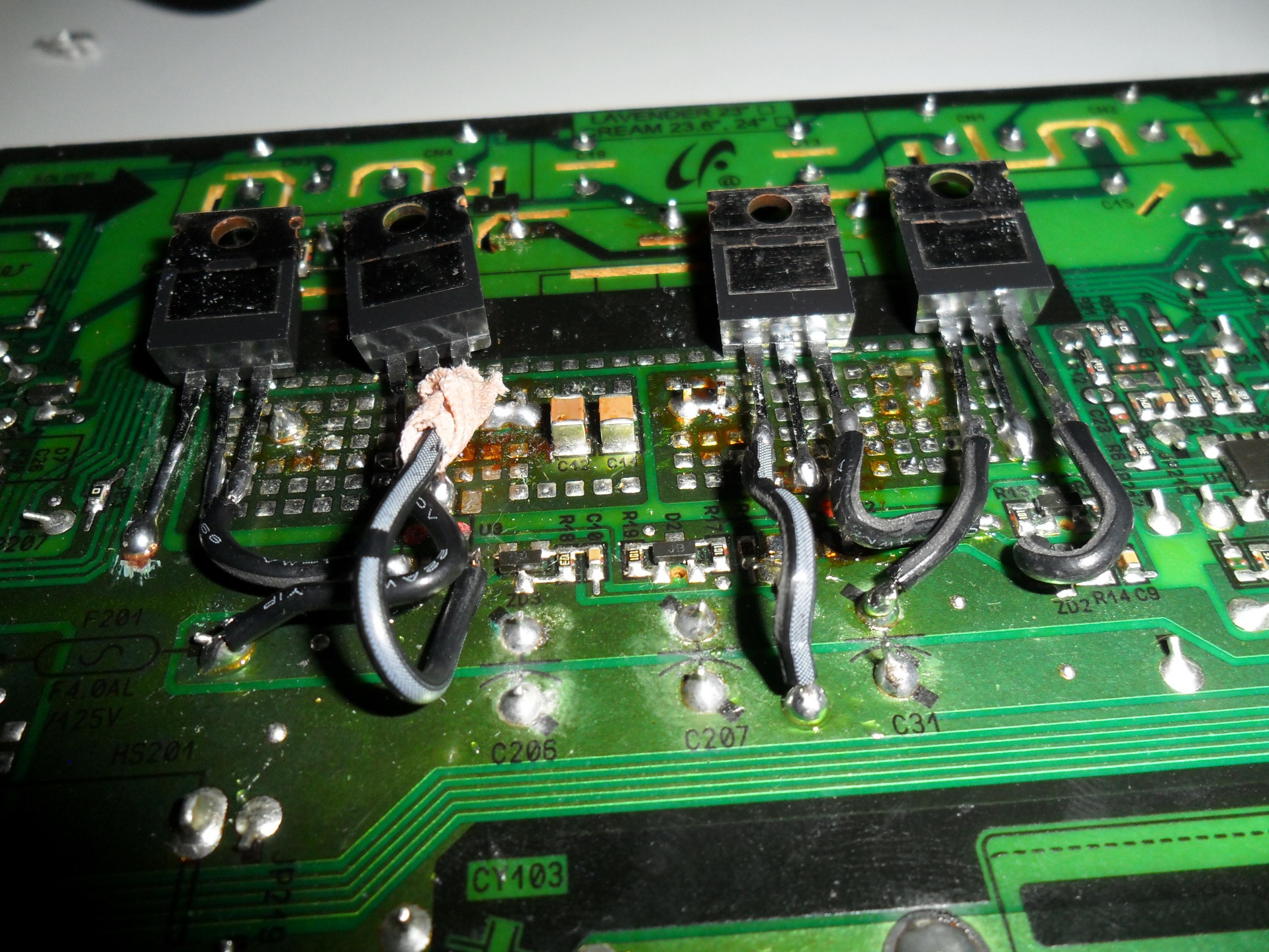

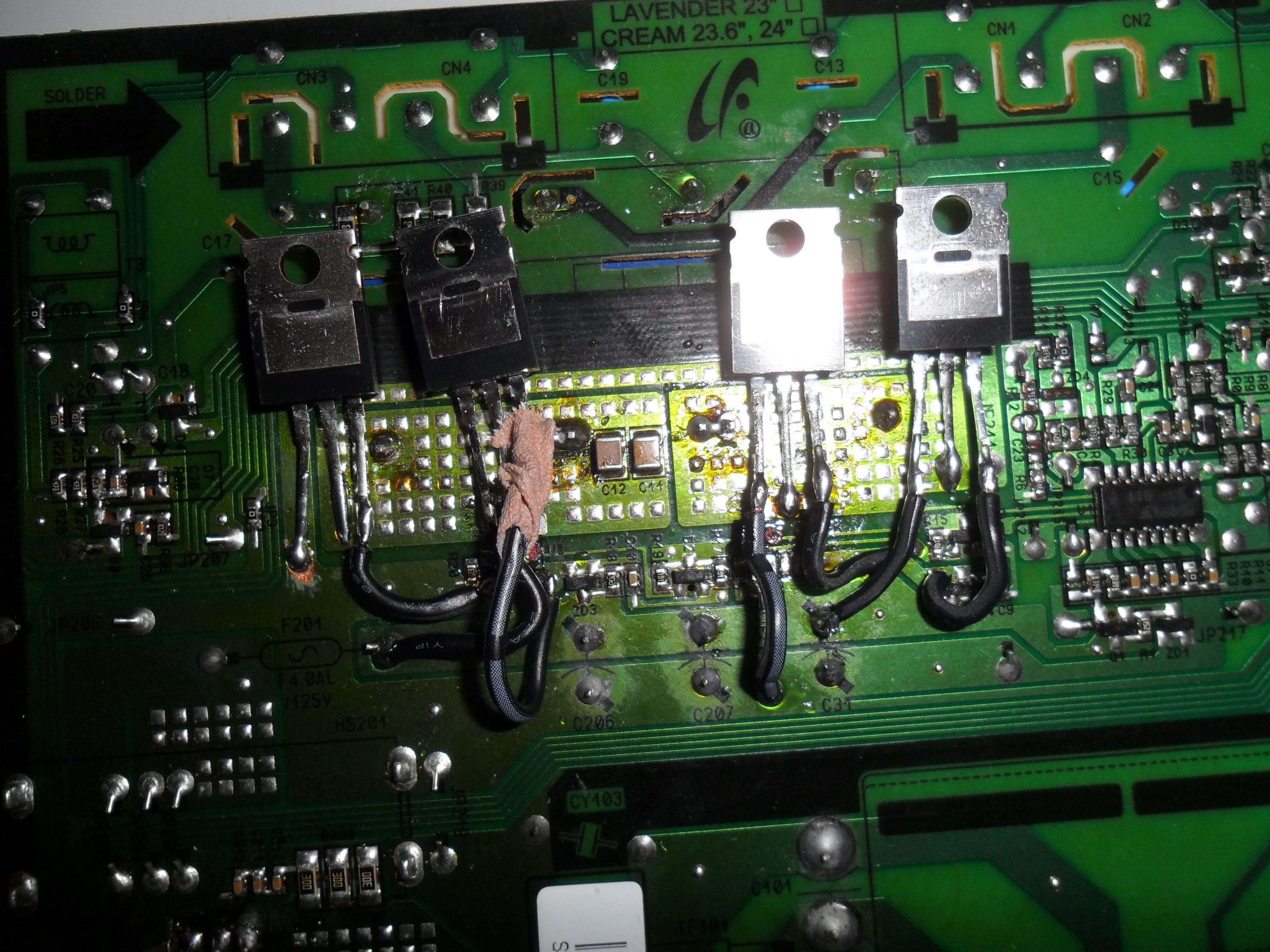

          just some pics if anyone notice anything strange

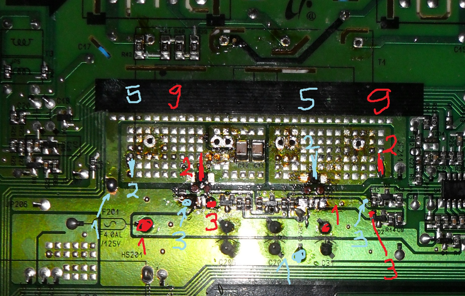

            Did you install the P-Channel and N-Channel MOSFET's correctly as shown in post 1? Since you asked this question "And if I have the same problem could anyone write it on the picture in the first post which mosfets are IRF540N and which IRF9540N"

              the picture was not so clear so I had to change focus and contrast so I can see it clearly, I think I got it right...
              here is how I soldered them on the board, all the FETs are facing heatsink towards the camera, and so the pins are marked like looking on them that way...
              Ithink I soldered them ok...

                The main key is that the P-Channel and the N-channel MOSFET has to be in the right locations.

                  So can you tell just by looking in the picture did I put them right?
                  I didn`t came up with this fix so I am not sure about the solder points
                    #89
                    Re: Samsung 23" LCD P2350 Inverter Repair
                    OK, if you look at the pictures in post 1, he had the MOSFET's labeled with "5" and "9"
                    which I think what his marking means:
                    5 = IRF540 (N-Channel: https://cdn.badcaps-static.com/pdfs/...23be5e315f.pdf)
                    9 = IRF9540 (P-Phannel)

                      yup I´ve put them in that order, I also labeled them 5 for IRF540 and 9 for IRF9540 in my attachment up a post...

                        OK, that is good to verify.
