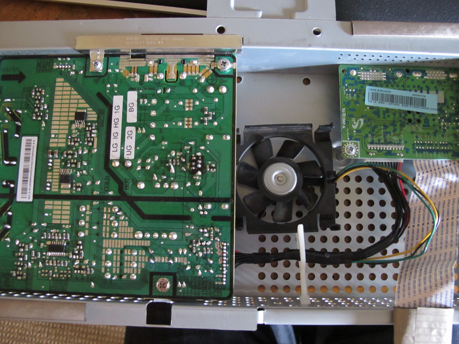

    I believe what I am talking about is the heatsink and voltage regulator.
    You can see what I a calling the regulator attached to the heatsink. I believe it is inscripted with:
    f DK16
    S
    65R
    That's not a voltage regulator; it's a power FET.

      Re: Samsung 23" LCD P2350 Inverter Repair
      This is what it looks like rigged up with a fan.

                        Well, this is a case of the OP was wrong, but I didn't correctly identify the part either; I was going by the location, not the number of legs. It's not a voltage regulator, it's not a power FET. Rtech is almost certainly correct, it's a SMPS controller and power FET rolled into one.
                        Which explains why the power supply is shutting down from overheating. Now all someone has to do is come up with an explanation of WHY it is overheating.
