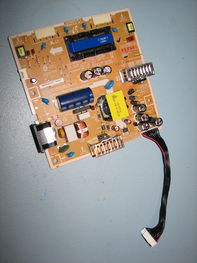

    I bought this dead monitor on spec on Ebay.

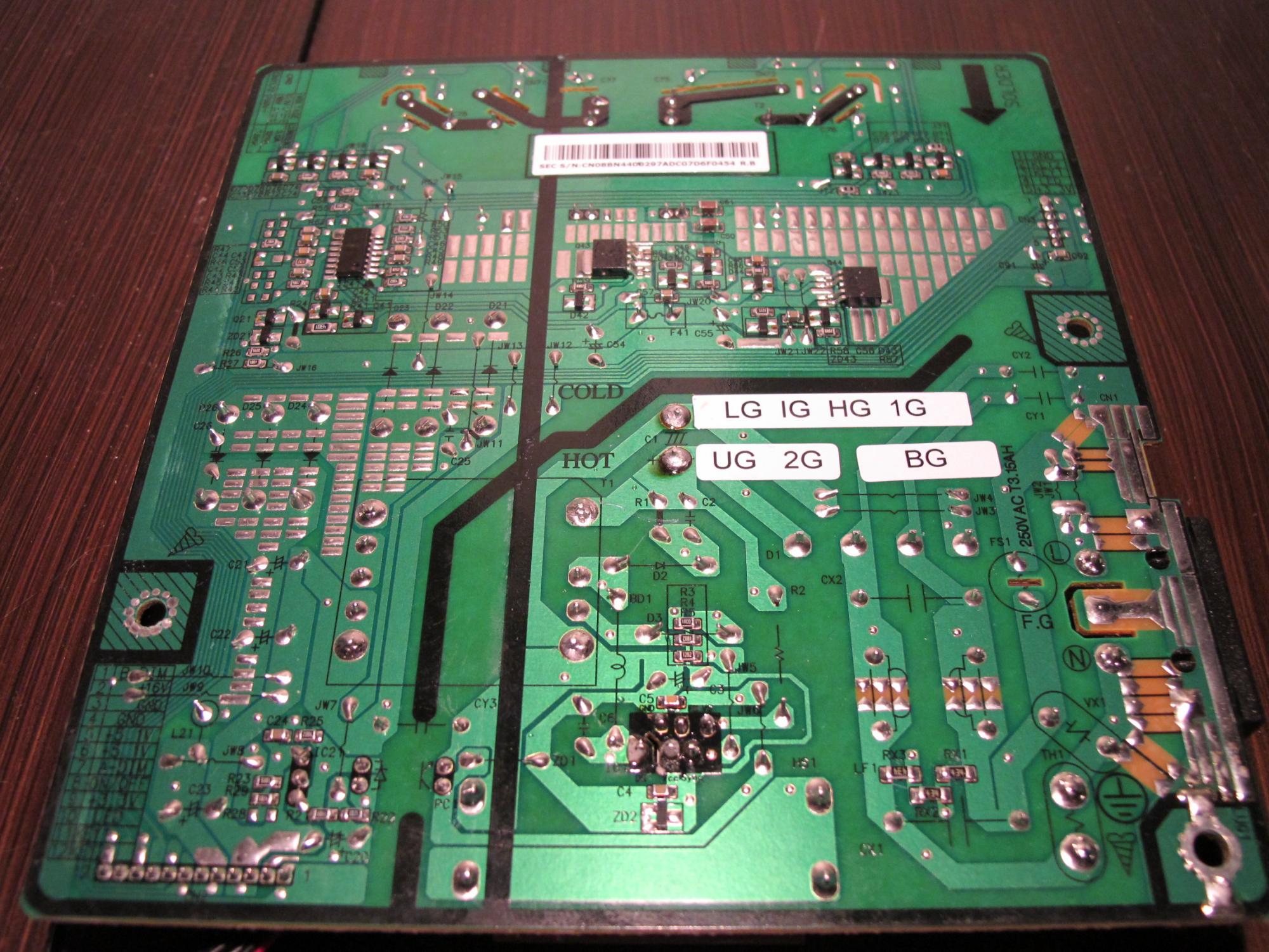

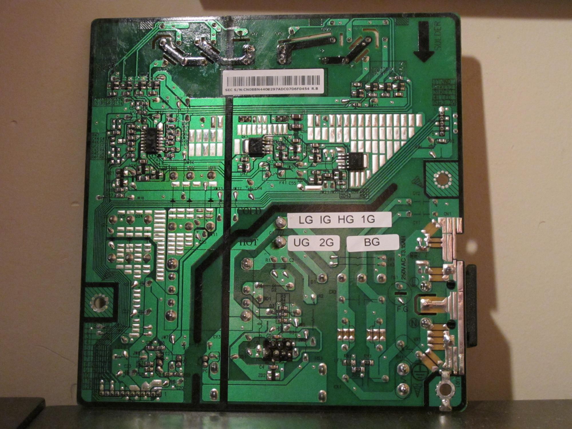

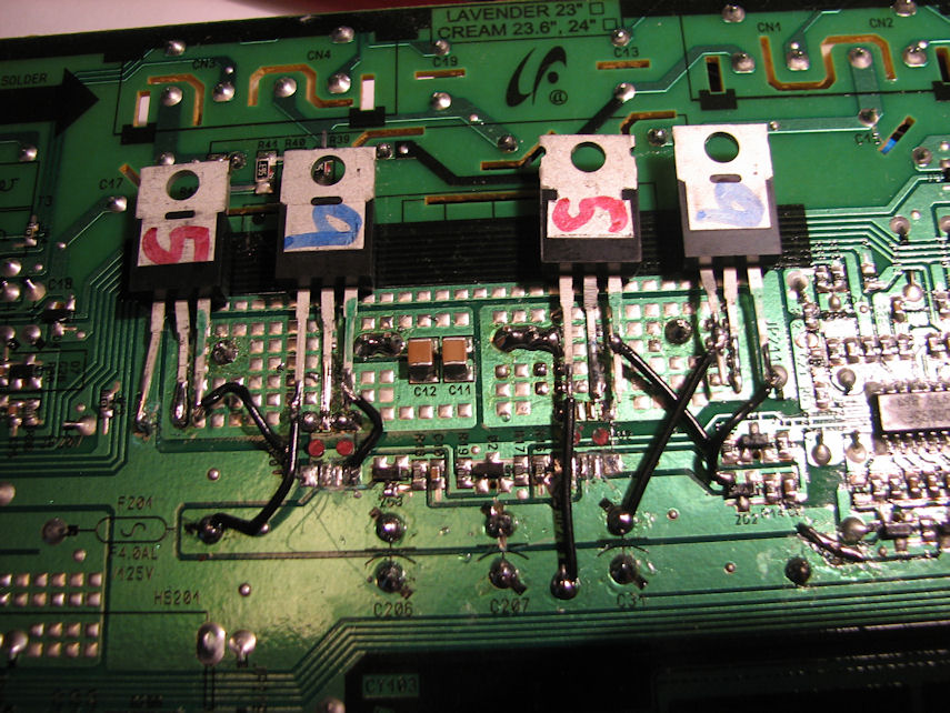

    Found the two tiny 8-pin SMD dual complementary AM4512C backlight inverter driver mosfets shorted all terminals. No other problems visible or measured. Removed the inverter transformer, and it seemed oddly wired to me but I couldn't fault it.
    No replacement mosfets obviously available in Australia, so I bought 2 IRF540N and 2 IRF9540N discrete mosfets from Jaycar, & soldered them in, held only by the drain lead. Luckily there was space for them on the solder side of the board where the originals were.
    The monitor has now been running for 5 days, no problems at all. Pics attached.
    The originals were rated at 1W and 2W per mosfet, the replacements 130W and 140W per mosfet.

    It doesnt have to be pretty, it just has to work. Those mosfet's dont need a heatsink?

        Those replacement MOSFETs are HUGE! That's a good thing, though; you definitely won't be seeing them burn out again. More likely the power supply will melt before these go bad .

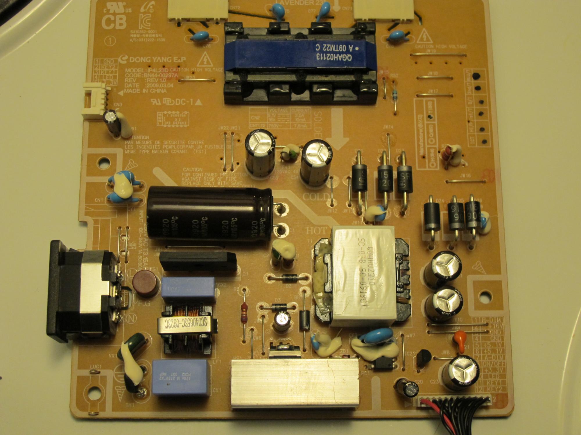

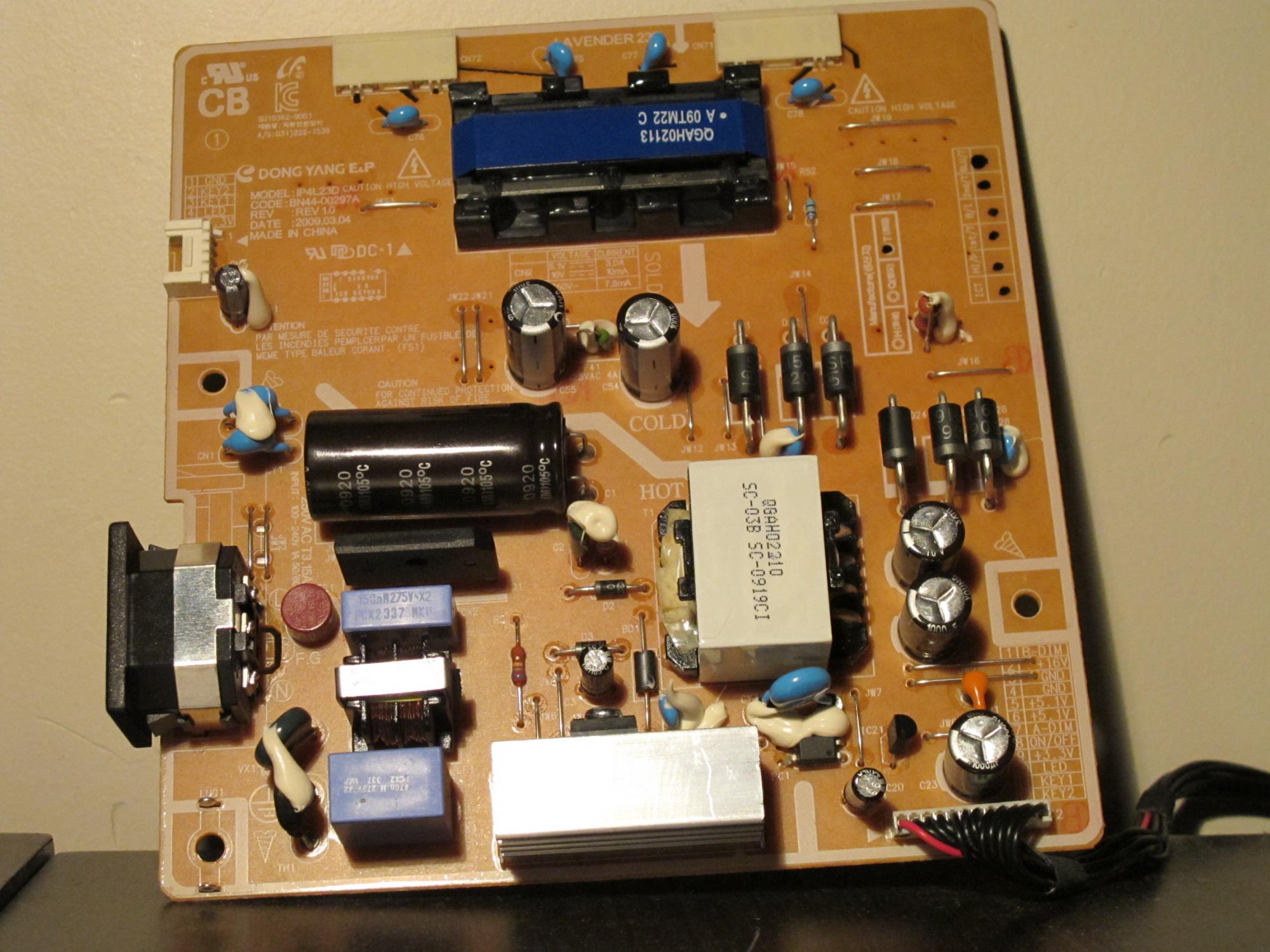

                      ok, so I tried to resolder the board, and it is still turning on and off. I find that it is shutting off sooner and now taking longer to turn back on. I have included some photos for you to view. Do you see anything wrong with any components??
                      This is the Samsung 2350, IP Power Board BN44-00297A

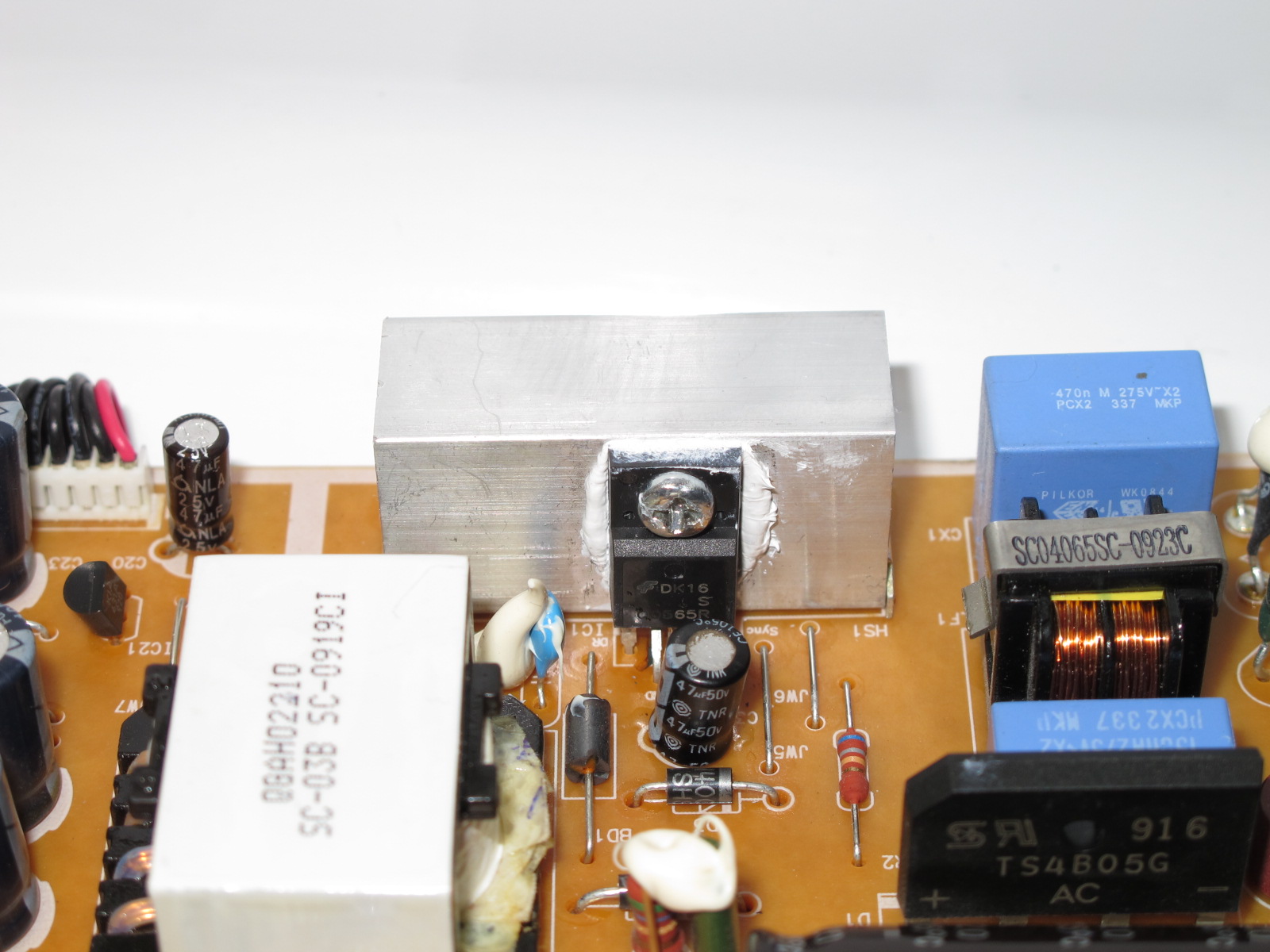

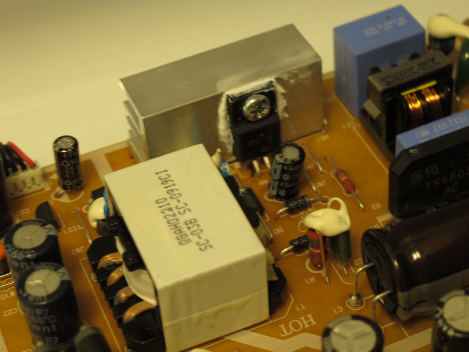

                              Ok. So I hooked up a little 12V CPU fan to cool off the heat sink. It WORKED, the fan has cooled the heat sink and it doesn't turn off the monitor.
                              The only problem is the fan is really loud. Im thinking of putting some new silicone glue or thermal compound stuff behind the voltage regulator to see if this will help.
                              ?Besides new glue, or thermal compound is there something else besides the fan that will disipate the heat better so my monitor will stop shutting down?

                                Did you ever replace the capacitors? If not, this may be the reason the thing is heating up so much. If the regulator is heating up then it's having to release excess energy in the form of heat. You can put a fan on it and keep putting band - aid's on the original problem however, it will pop up again.

                                      On most lcd monitors, there are no voltage regulators on the power/inverter board. The voltage regulators are normally used on the logic board to convert 5V DC down to 3.3V, 2.5V and/or 1.8V DC.
                                      In post #15, you talk about a small fan cooling off the heatsink. What heatsink are you referring to?

                                        I believe what I am talking about is the heatsink and voltage regulator.
                                        You can see what I a calling the regulator attached to the heatsink. I believe it is inscripted with:
                                        f DK16
