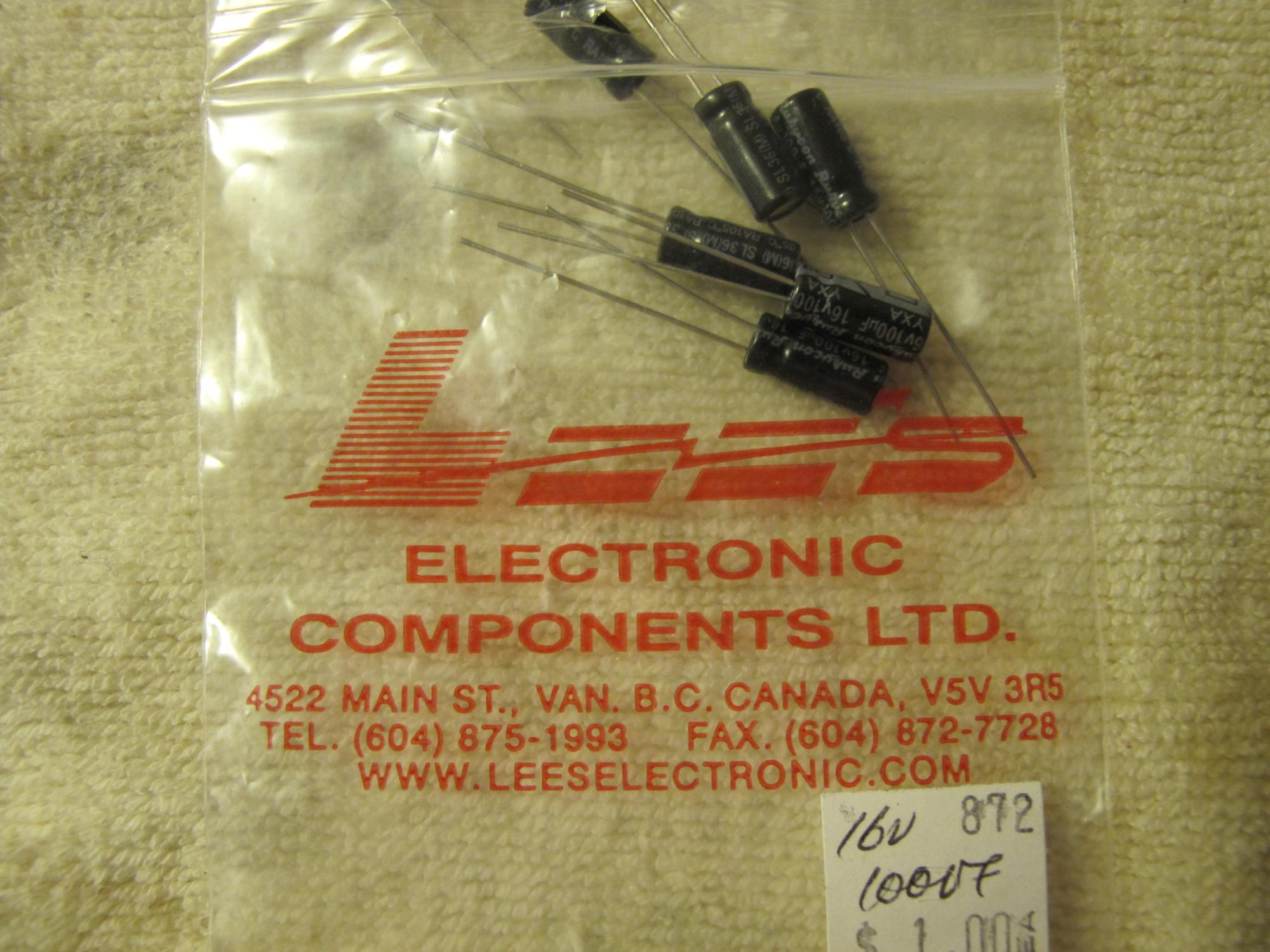

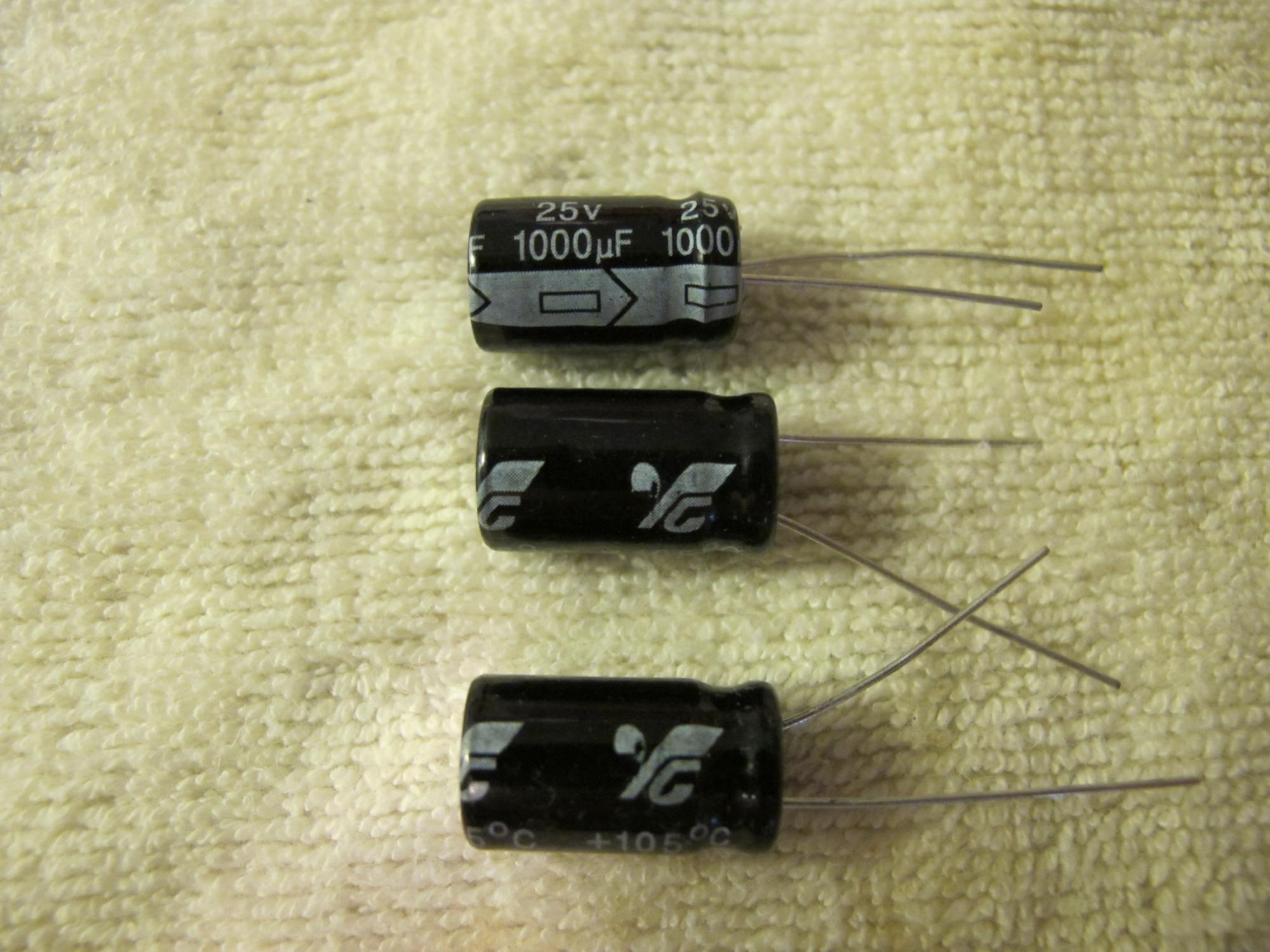

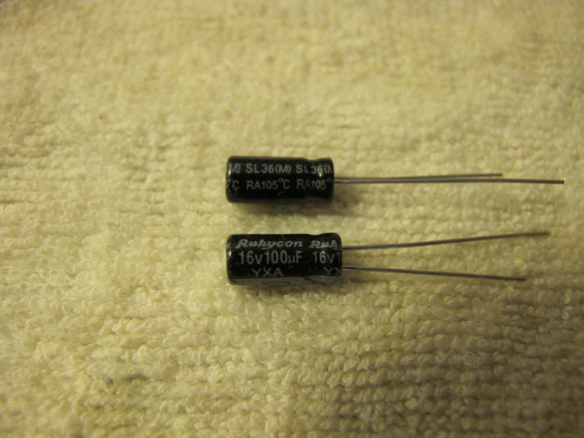

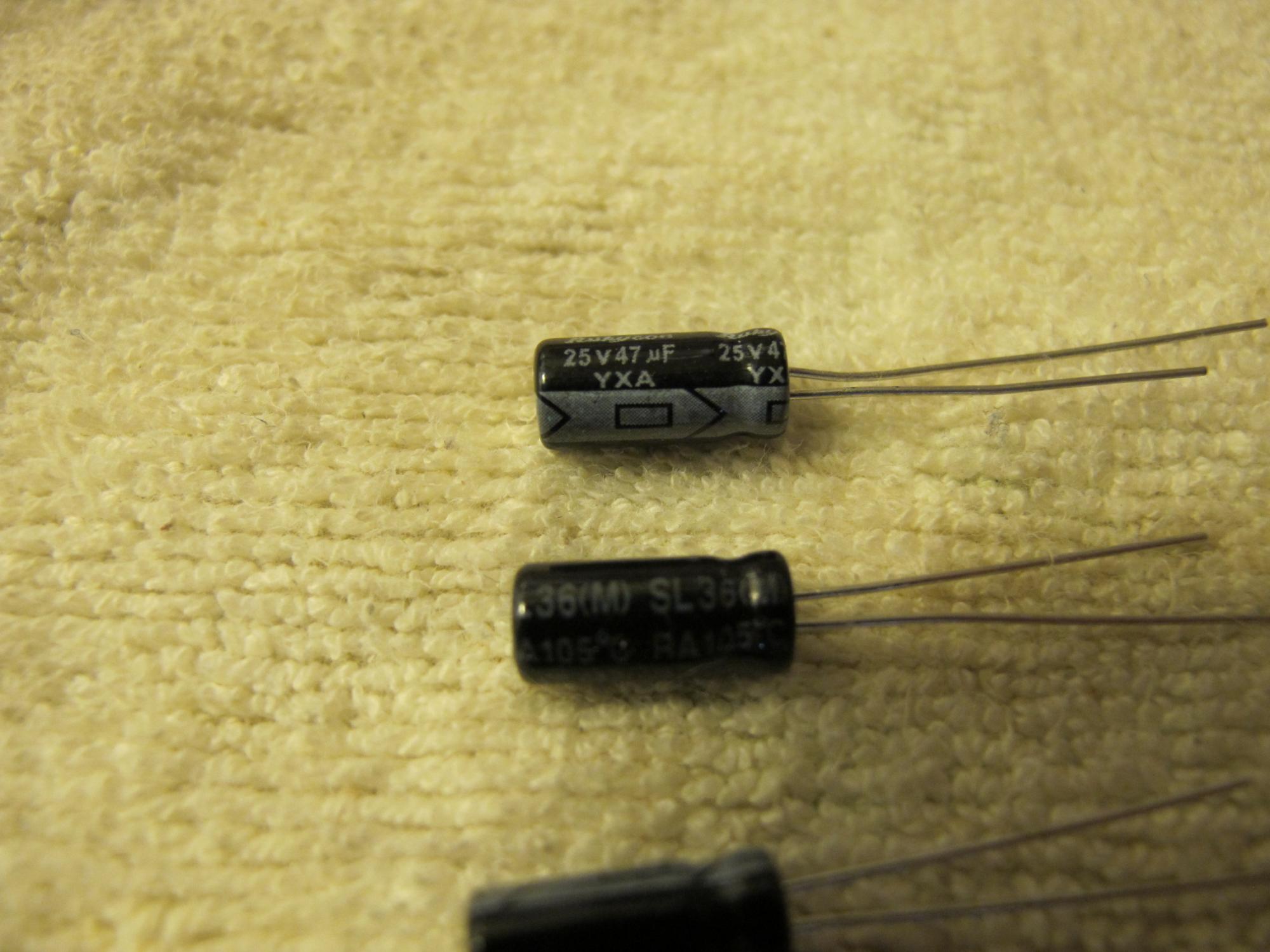

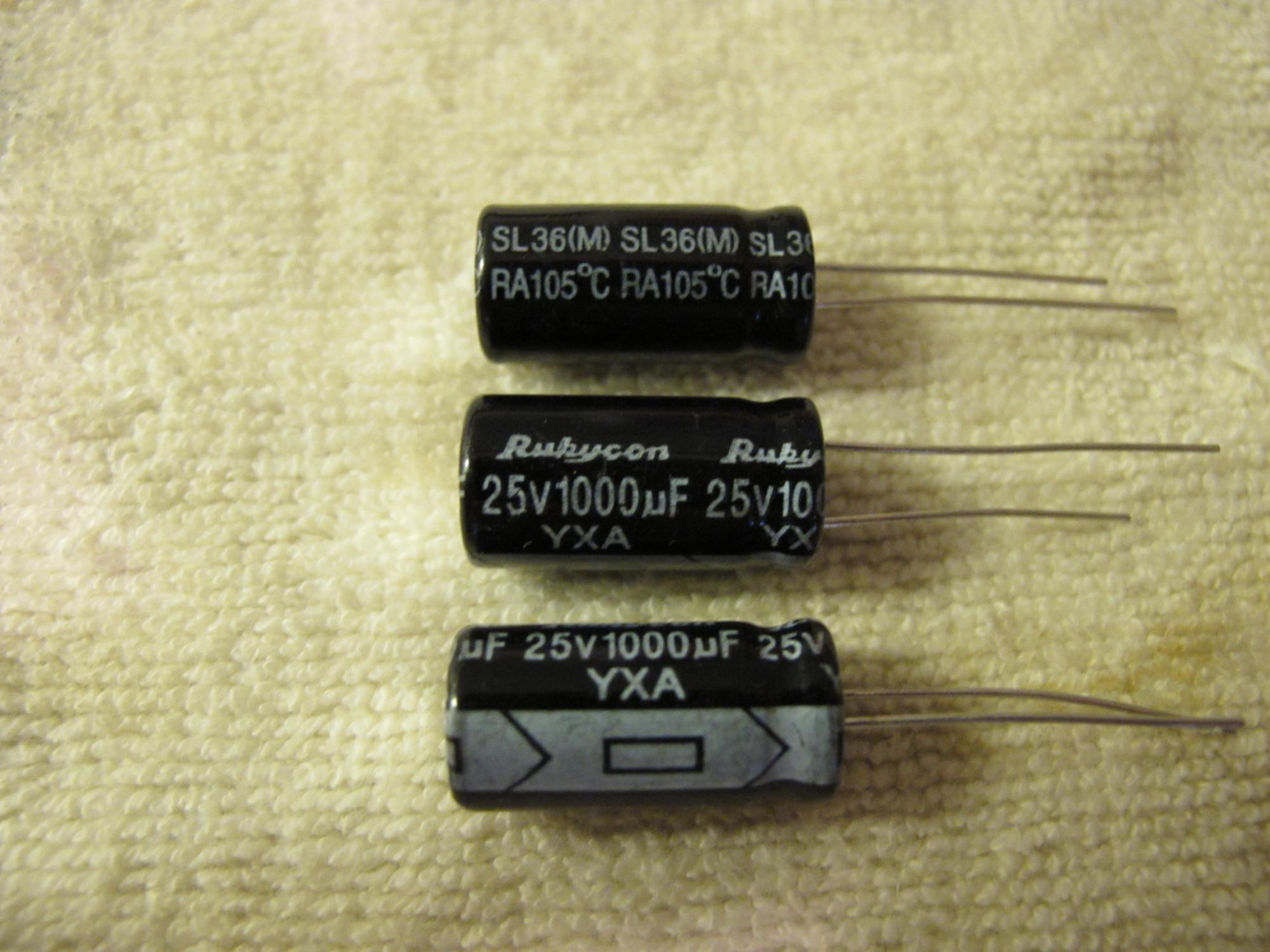

    Ok. So I finally got my caps in the mail. The first picture are the ones I bought on ebay from hong kong. The others I bought at a Japanese electronic store on Main St. in downtown Vancouver.
    I have replaced the caps and so far so good, but I've only had my monitor on now for 8 minutes....see what happens....keeping my fingers crossed.

        Post a picture of the top of the Rubycon cap and the bottom of the cap. The top should have a "K" style bent, if not, they are fake. If the bottom has a "bulleyes" bung, it is fake.
