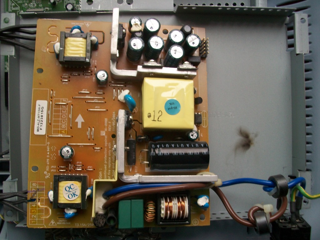

    I'm attempting to repair a Xerox XG-91D monitor that has been malfunctioning. Upon opening the case it was discovered that most caps appeared intact. The tops of three may have swelled slightly and there was a small soot stain on the case above a Samxon 150uf 25v.
    Examining the board it appears to have the following
    (4) Samxon 1000uf 25v
    (2) Samxon 150uf 25v (both slightly swelled and soot above one)
    (2) Samxon 470uf 25v (one slightly swelled)
    (1) Samxon 220uf 25v
    I'm gong to try replacing the caps and seeing if that helps and could use any advice on ordering the correct replacement caps. Should I try and match the same caps or is there a better brand to choose?
    This is my first attempt to replace circuit board parts so any advice would be appreciated.

    Looks like you forgot the small cap next to the large 450V cap. The large cap rarely fails and can be left alone. That leaves a total of 10 caps that need replacing. The Panasonic FM or FC series of caps are recommended by many members here. If you're in the USA, order from digikey.com. Use the procedure below:

      Thank you that is indeed helpful.
      I did miss the small one looks like it is a Samxon 47uf 25v.

          Took a break from this over the holidays. I'm still having trouble finding replacement caps. I found most of them but for these two, one of which I suspect overheated.
          Samxon 150uf 25v approx 8mm high and 8mm across.
          For some reason I can't seem to find a similar cap on Digicom. Any suggested alternatives?

            As long as there is room, you can go bigger in height. This Nichicon is 8mmx11.5mm. If your tallest cap on your entire board is 11.5mm or higher, this Nichicon should work fine.
