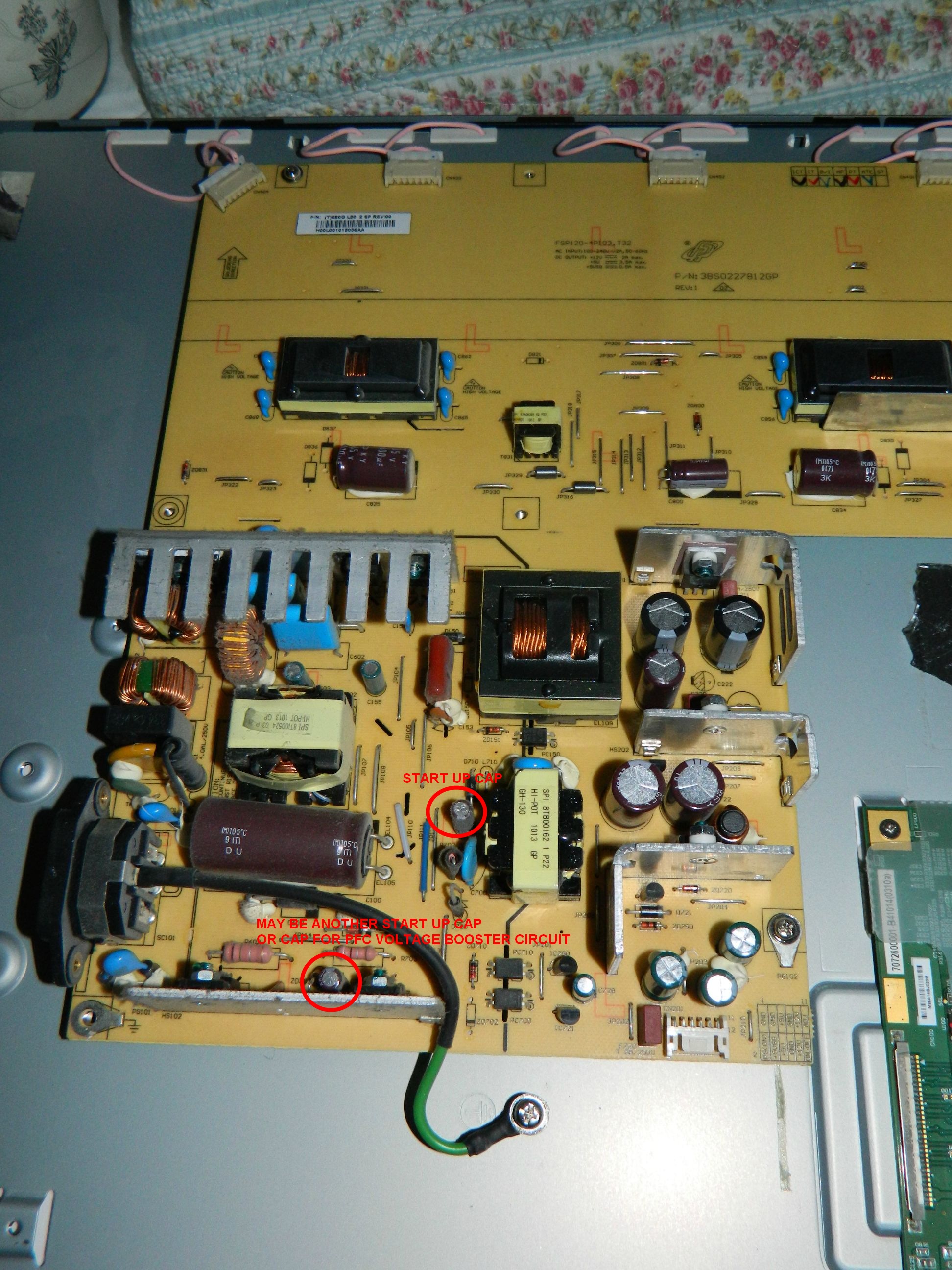

                      Hi, wonder if anyone can help - please?
                      I have a Hanns G HZ281z which suddenly stopped turning on (no sound or anything - just switched itself off one day). I've taken it apart and can't see any problems (like bulging capacitors or anything).
                      I can post photos of the inside if that helps?
                      Is it likely to be one of the internal fuses that has blown?
                      Any ideas, help or advise really appreciated!

                        If the power board looks like the one pictured above. Try replacing the 3 caps that are circled in red. (in my picture) That fixes them most of the time. These caps are not bulged. They get dried up inside.
                          Thanks. the board looks a bit different. Any ideas please?[/URL][/IMG]
                            Re: Hanns-G HG281D 28" TFT - Multiple Problems
                            Please don't post pictures inline, it slows the loading of the page. Use "Go Advanced" and "Manage Attachments" to post pictures.
                            Wow. That's one board? Power supply and inverter? I have never seen one that big before.
                            Looks like we are going to have to track this down the old fashioned way. You need to check the DC voltage on the 2 leads from that big capacitor circled in blue. Should be around 170v I think. ******Be careful. That is high voltage. ***** I usually brace my elbows on the table when checking those.
                            I'm suspecting it's your startup capacitor circled in red.
                            So first we are making sure you are getting voltage to that big capacitor. If so, I'd probably start by replacing that startup capacitor.
                            Others can help you do more diagnostics if you need it.

                              I thought that start up cap looked a little rounded on top.
                              If you want to start testing something a little less exciting there are two fuses I can see - they are red rectangular box ones one is in the bottom right corner
                              and going straight up another one in the corner wher the board expands.
                              There should be another near the mains plug but cant tell which it is
                              possibly the black cyclinder that is on end - check if that has a F*** designation on the board beside it.
                              Or is could be the black rectangular box in the same area - what does it say on top of that?
                              Whole board needs a good dusting - brush and vacuum.

                                  OK, so yes, we need to find out if you do have about 330VDC on the two legs of the main filter cap (around 170VDC for USA, around 330VDC for EURO).
                                  You can also try heating those two caps I marked with hair dryer for 2~3 minutes before plugging the board into the out to see if the standby voltage will come back. We also need good clear straight shot of the bottom side of the board and also in 4 sections (closed up) so we can clearly see the traces.

                                    I see budm. He's from the UK. Not US. His voltage will be much higher at the main filter cap. Thanks for catching that!

                                      Many thanks for all the replies. I've uploaded some more photos to see if they help (including close ups of some of the caps you've mentioned).
                                      yes from the UK so should be 330VDC I guess.
                                      I've checked those 3 fuses and all seem good (zero resistance).
                                      Budm - I assume I'd need to remove the caps from the board before heating them with the hairdryer?
                                      Can't see any bulging - but hopefully it's more clear in the latest photos (if I can get them uploaded).
                                      Selldoor - not certain which "black rectangular box " you're referring to please?
                                      Lumberjack777 - I haven't tried tracing yet - as I've had to disconnect the board to check the fuses.
