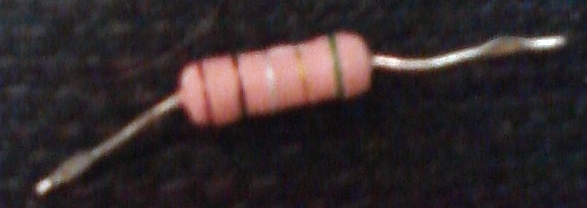

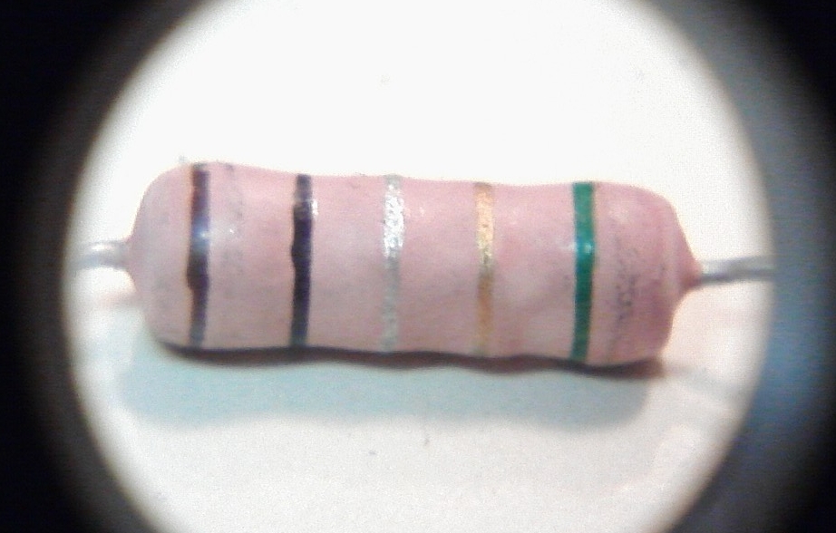

                      I pulled out a resistor from right next to the bridge rectifier, as it was measuring .04 ohms and the meter zeros out at .03 ohms. It was covered in black shrink tubing. Upon removal of said tubing, no visible damage.
                      Color codes are: Brown Black Gray Gold Red.
                      If it's a resistor, it should mean 1 0 8 .1 2% - which is 10.8 ohms at 2%. Not really sure if the first band is brown or red, but if it is red that puts it up to 20.8... which makes a reading of .4 even more of a problem.
                      The gray band looks VERY silver to me, but there is no possibility for that in color coding of either resistors or caps, so I am going with gray.
                      Also, in person the red/brown seems to be reversed. In other words, what appears red in the images appears brown in person and vice versa. But I have a real hard time believing this is a 1%er, and my eyes are bad, so I just don't know.
                      (My phone camera sux, so I used a lense component as a makeshift macro lense, thus the weird circle.)
                      Any help would be much appreciated! Thanks
                      Steve

                        That is likely an inductor.

                          Appreciate the problem removing the Heatsink. You would need a stronger iron to do it.
                          Looking at the MOSFET readings, I would say leave them where they are for the moment. All readings are at least a couple of hundred ohms.
                          I would expect something like a 001 ohm reading on the 200ohm lowest scale if there was a dead short. You could still have open circuit or other failure modes. Some might suggest removing and doing various tests at this point.
                          For the looks like 'Resistor component'
                          Are there markings on the board where this component came from? Is it designated R, L or C in the same way that the MOSFETS have Q meaning transistor printed on the PCB??
                          Look for clues.
                          If you can post some better pictures of front and back of PCB with all shields removed. Indicate where it was taken from?
                          And I make the colours Brown, Black, Grey, Gold and GREEN! Making it a resistor of 10.8 Ohm +/-0.5% if the board confirms an R designation. Is that just me?
                          Right, I'm off!
                          Happy New year!!

                            Re: Hanns-G HG281D 28" TFT - Multiple Problems
                            Look for clues.
                            Aaah yes... the PCB item number markings. DOH!
                            It's a resistor. R106.
                            I have checked it against "standard" green used in resistor marking and it seems way too dark to me. That being said, I am only color blind between certain shades of red, brown and green. lol
                            BTW, earlier I meant to say that it is located next to the filter capacitor, not the bridge rectifier.
                              Third band silver =10^-2 multiplier - so a 0.1 ohm resistor.
                              As posted in another thread, see attached ex http://en.wikipedia.org/wiki/Resistor_color_codes
                                OOOOH! The Samsung comment. ouch! My friend just bought a Samsung monitor. lol
                                Thanks Pedro. Got it.

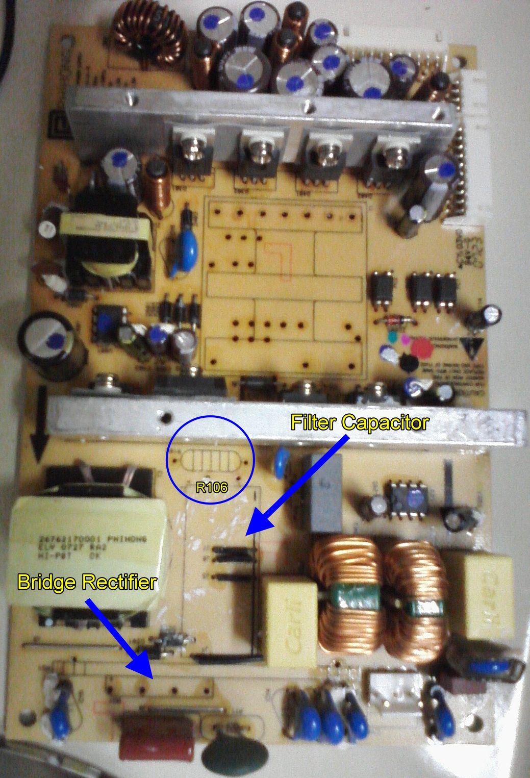

                                So Mikeley - and anyone else willing to help me on this project - I've put the resistor back and now I'm just waiting on my bridge rectifier to arrive. I've also checked all SMDs again, just to be sure I didn't miss anything, and desoldered and checked the optocouplers. No problems there. Is there anything else you suggest I do before installing the rectifier and letting her rip one more time?
                                I decided against changing out the caps until after I get the fuse blowing issue resolved, just to be sure I'm not introducing any new problems into the equasion before I troubleshoot that. Is this a good idea or not?
                                  Will have fingers crossed tha the rectifier is the problem here.
                                  Check for short capacitors/MOV's circled and perhaps ensure the varistor is ok, ie high resistance at room temperature and if you heat gently with a hairdrier, resistance should fall rapidly. This component protects the circuit from high inrush currents when the circuit is energised from the mains.
                                  Also check your filter Cap. Any signs of leakage? They rarely fail, but sometimes do. Measure resistance and capacitance, aside from that without an ESR meter or scope, substitution is the only option.
                                  You almost certainly will need new capacitors else where, and if you have them, intstall before powering up again.
                                  In a workshop situation, I would take precautions to further limit the current into the powersupply after a repair by using a lightbulb in series with the mains. I have a purpose built jig that I can plug into. In your case, be ready to remove power quickly! Take precaustions working on the mains. The fuse will pop again if a short exists. Do not be tempted to short this fuse out.
                                    Checked Caps & MOVs. Don't have a capacitance meter, but cap works - I charged it with a 9v and lit up an LED with it several times/checked voltage/etc. Looks excellent too.
                                    Will have to order caps - none on hand. Fortunately, I ordered 4 fuses and a PCB mount holder for them, so I have 3 left and can plug/unplug them easily. (Glad I thought ahead on that one! ;-)
                                    Will report back when I get her all put back together. Thanks!
                                      I received my bridge rectifier the other day and all my power board caps today. I put it all back together and wallah! I'm looking at a 28" 1920x1200 display as I type this :-).
                                      So I fixed the power board problem. And in the process, I've eliminated the power board as the cause of my screen blanking issues, as it is still doing the same thing it was before. It just turns on now, and doesn't seem to run nearly as hot.
