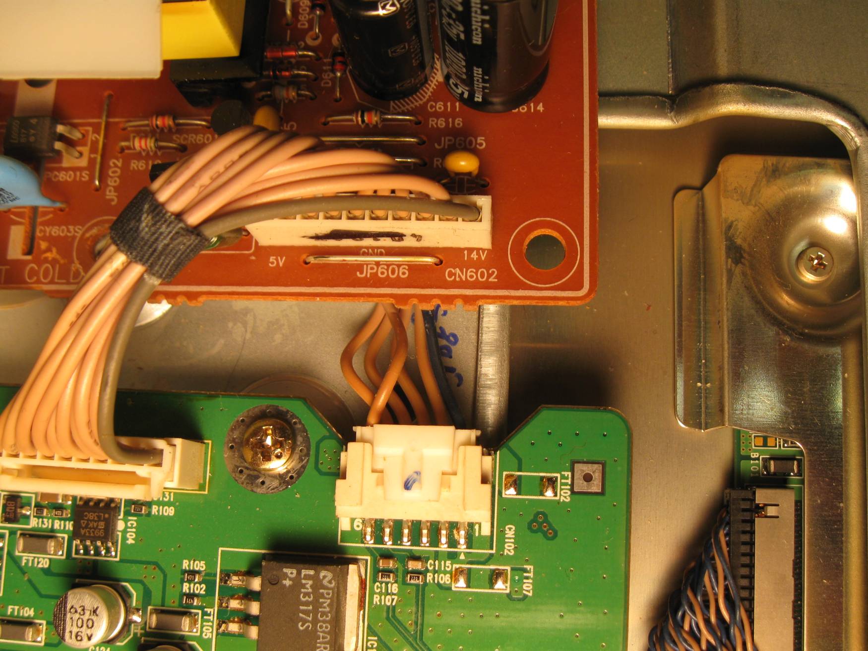

                    #29

                    Can we get a picture of the board where it says 14V DC? I can't see it on your existing photos. It may be covered up by the wiring?

                    • kingofcoins

                      #30
                      Re: macro pic
                      Here you go its marked 14V at CN 602. Also see pin 1 wire at CN101 going to inverter board is carrying that same 18.5V
                      • retiredcaps

                        #31
                        Re: macro pic
                        Does it measure 14V DC at CN 602 if you have all the boards connected?

                        • kingofcoins

                          #32
                          Re: DC voltages
                          Today both CN 602 and CN 102 out voltages read closer to 19VDC with all boards and wires connected...no I do not get 14V.

                            #33
                            Re: DC voltages
                            Weird. Most logic boards don't require anything more than 5V DC. If 19V DC is present on the connector on the logic board, I have seen this rail routed to ground.
                            19V DC is a common voltage used on the inverter side.
                            I can't explain the 14V DC silkscreen.
                            I can't think of anything else other than getting the fuses, replace them and retest.
