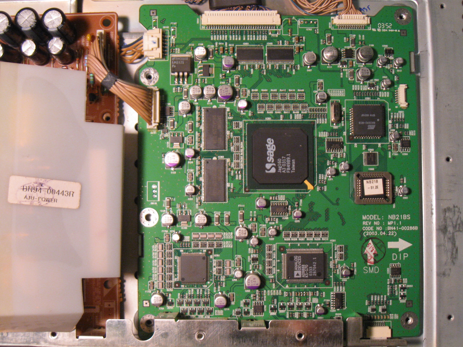

Samsung 231T, recapped, no power, no lights
  • kingofcoins
    SaveOnGreen-Cap
    • Jan 2010
    • 162
    My search shows no successful repairs on this particular Samsung 213T Syncmaster LCD model. So lets try this one....it started as no lights, no power, no noise; and I found all 10 caps on power and inverter boards were bloated, shorted, or had high ESR's; replaced them all mostly with Pan FM's, but after that still no power, no lights, no noise at all.
    I get no voltage at the large cap, both fuses on power board read 0 ohms, and of course no DC voltages out to logic board. There is no visible signs of any burning. The inverter transformers look like they've seen a little heat but then this unit has definitely seen a few hours, was made in Jan 2004. I have d/l'd the repair manual/circuit diagrams. Attached my pics...oh and now that I went over board again, I see a small 22uf x 50v cap NW of the big guy....could this cap give these symptoms ?
    So...what should I check next...?

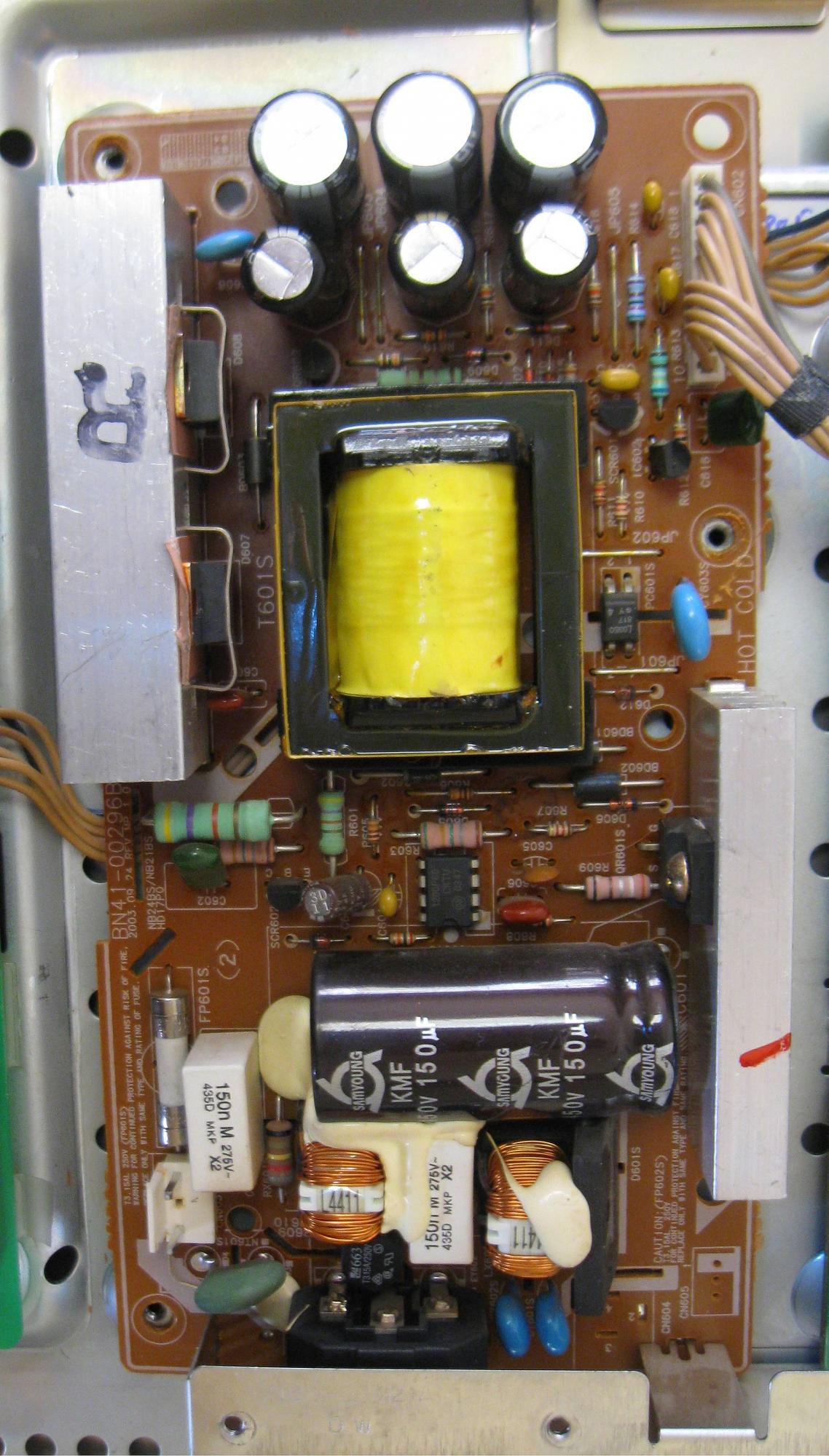

  • retiredcaps
    • Apr 2010
    • 9271
    Re: Samsung 231T, recapped, no power, no lights
    If you are not getting voltage at the big main filter cap, check your bridge rectifier for shorts (black rectangular box just below the main cap). Number the pins 1,2,3,4. With power off and lcd unplugged measure the ohms between 1-2, 1-3, 1-4, 2-3, 2-4, and 3-4. Any reading below 30 ohms suggests it is shorted (bad).
    The 22uF 50V can be bad without bloating and should be replaced due to guilty by association (as PlainBill would say). This cap plays an important part of the SMPS startup process.
    edit: The small cap, however, is not the root cause of why there is 0V DC the main cap. The small cap comes into play AFTER you see (mains x 1.414) DC voltage on the main cap.

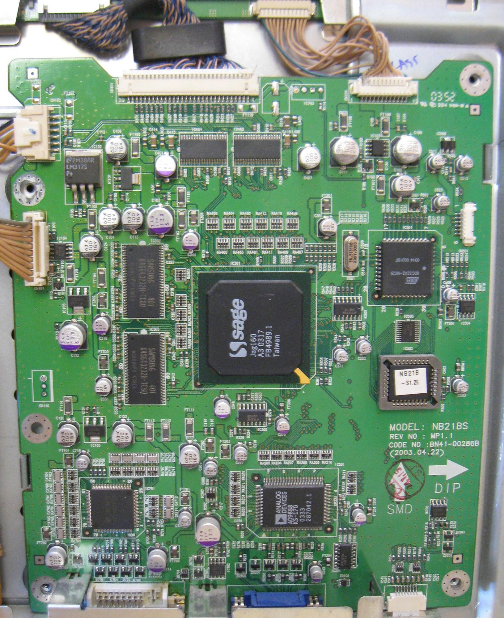

    • retiredcaps
      • Apr 2010
      • 9271
      C111 on the logic board looks funny in the picture? Problem or glare/flash?

      • kingofcoins
        SaveOnGreen-Cap
        • Jan 2010
        • 162
        Retired...., thanks...C111 like its mate C102 to the right, have a domed top to the cap, and very much appear to be the manufacturers style of can.
        The bridge rectifier legs pairs all read very high resistances.
        I'll await some sign of life before I recap the small C603.
        What next ?
        • retiredcaps
          • Apr 2010
          • 9271
          What next ?
          On your fuses, what is the exact ohms reading? For example, on mine, they read 0.3 ohms.
          How are you measuring DC voltage on the main filter cap? Where are you putting your probes?
          edit: I have to ask because a few people in the last couple of weeks were not correctly measuring the main filter cap with their multimeter. Some reported negative readings, some had the probes in the wrong place or jacks in their multimeter.

          • retiredcaps
            • Apr 2010
            • 9271
            I'm heading out soon, but on one monitor with no power that I fixed, the solder on the AC input (backside) had ring cracks. I reflowed the solder and it worked fine afterwards.
            You may want to check the soldering on the backside on all components on the "hot" side of the board.

            • kingofcoins
              SaveOnGreen-Cap
              • Jan 2010
              • 162
              Both fuses read a calibrated 0.0 ohms .
              Measure the large cap with the power plugged in, meter set on 300VDC, probe the cap legs polarity correctly...in my case 0 VDC.
              You may go advanced on this I have some background, and will do my best to keep up.

                • smason
                  • 1652
                  No voltage at the big cap should be easy to track down.
                  Is there AC at the input of the bridge rectifier? It's rare, but it could have an open diode.
                  I'd measure the AC right where it comes in to the board and trace it through 'till you lose it.
                  36 Monitors, 3 TVs, 4 Laptops, 1 motherboard, 1 Printer, 1 iMac, 2 hard drive docks and one IP Phone repaired so far....

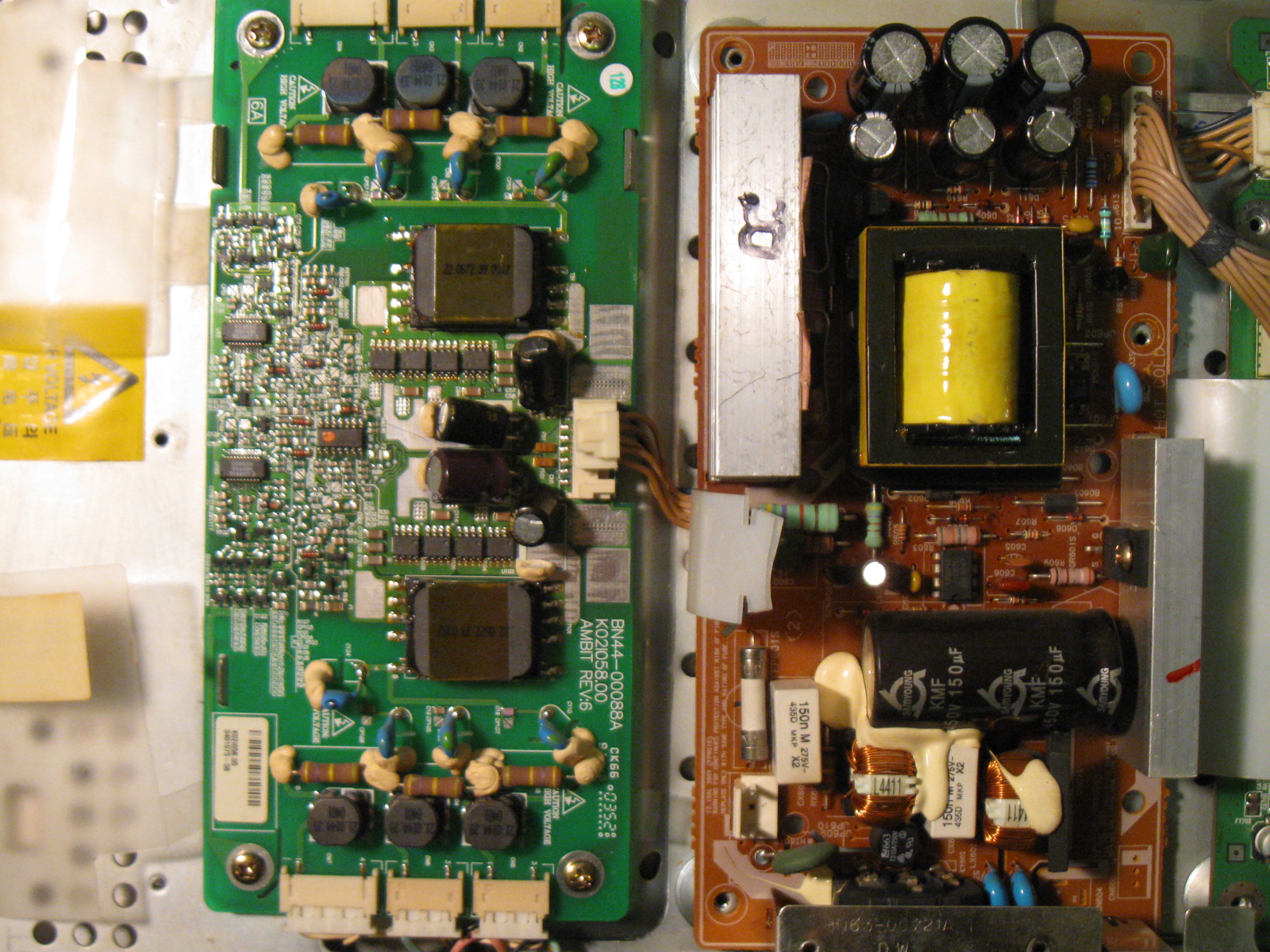

                  • PlainBill
                    • Feb 2009
                    • 7034
                    It's hard to tell because of the poor picture, but there seems to be TWO fuses in the AC input area. One is a black cylinder next to what appears to be the AC input connector, the other is a ceramic pigtail fuse above the two pin connector. As smason suggested, trace the circuit from the input connector to the bridge rectifier.
                    I've repeated this a number of times. When there are multiple boards, it really helps to have an over-all picture showing the boards in relationship to one another. Also, while including a large amount of the surrounding area isn't useful, it would be nice if I could see ALL of the boards.

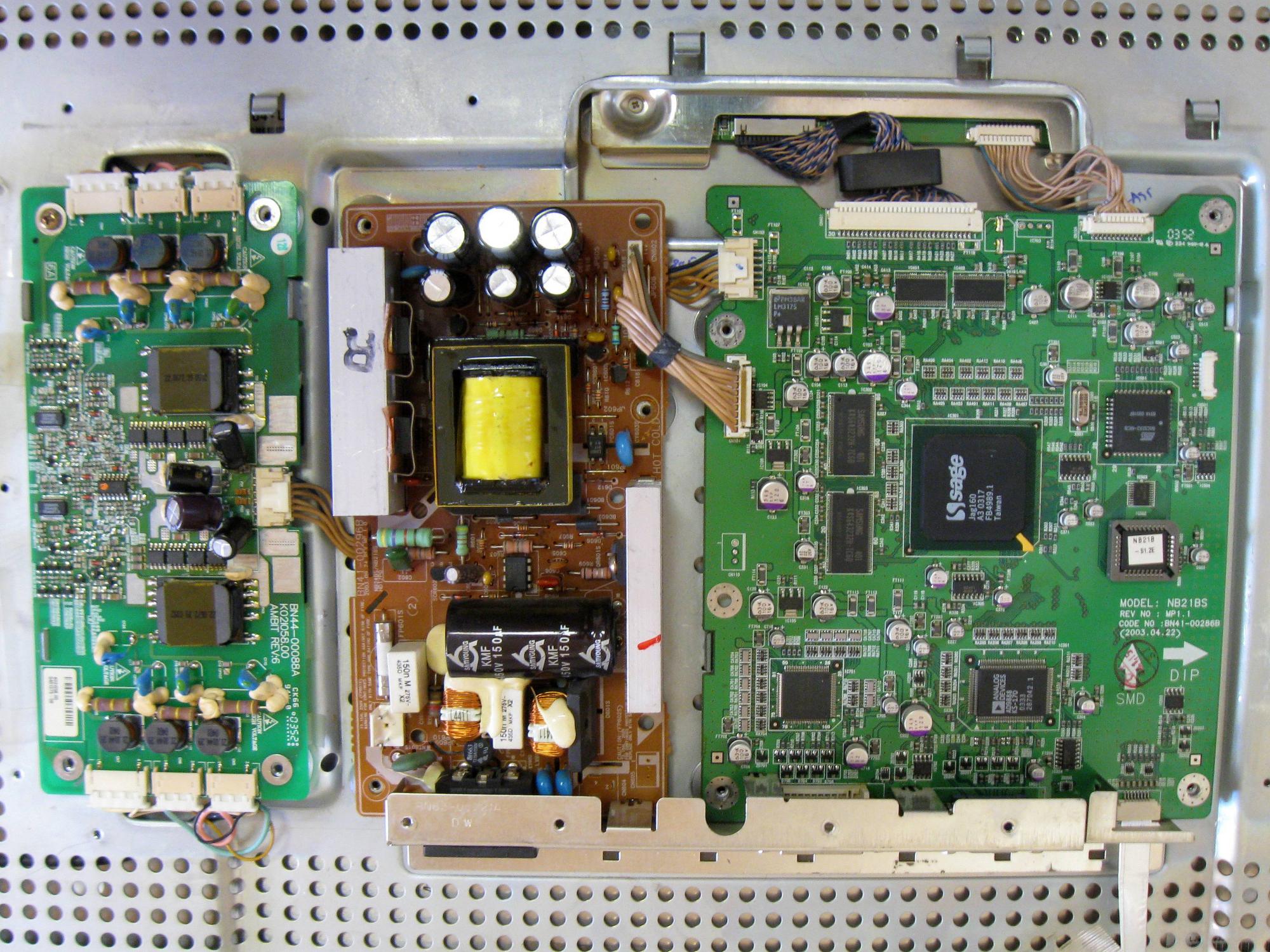

                    • kingofcoins
                      SaveOnGreen-Cap
                      • Jan 2010
                      • 162
                      Re: More new pics
                      I've added some more pics to help clarify the board layout. It is inverter board on left, SMPS middle, and logic board right. Part of the trouble photographing and servicing this unit is because the connector header is soldered to join the SMPS and logic board together, and the ribbon cables are stuck on the logic.
                      I rechecked both fuses and they are about 2 ohms, The bridge rectifier has no shorts, and I get no AC voltage shown at the ceramic fuse.
                      Also the repair manual had no diagram for the Pwr Supply.
                      Thanks for the continued support.
                      • PlainBill
                        • Feb 2009
                        • 7034
                        Re: More new pics
                        I'm curious about the two pin connector at the lower left corner of the SMPS board. This very much reminds me of the spot I'd put a power switch. If there isn't anything that plugs in there, a picture of the bottom of the power supply would be a big help.
                        PlainBill

                          • kingofcoins
                            SaveOnGreen-Cap
                            • Jan 2010
                            • 162
                            Re: power on
                            Bill ...good eyes !.. yes that's for the external power switch on the RF shield, Sorry I had to remove to get the clear pics. It had a loose connection to board, but now its JB Bond tight...SO I get the green power on LED but no lights no sound.
                            I'll picking up a new multimeter this afternoon, so go ahead with any suggestions please.
                            PlainBill

                                • retiredcaps
                                  • Apr 2010
                                  • 9271
                                  Re: green led only
                                  no I see nothing with or without flashlight, and no backlight flash, just green light only.
                                  Check the voltage regulators on the logic board. List the part numbers and measurements for IC101, IC102, IC105, and IC106. IC505 might be a voltage regulator, but I can't tell 100%.
                                  I still think C111 and C102 look weird, but I have zero experience in poly caps.

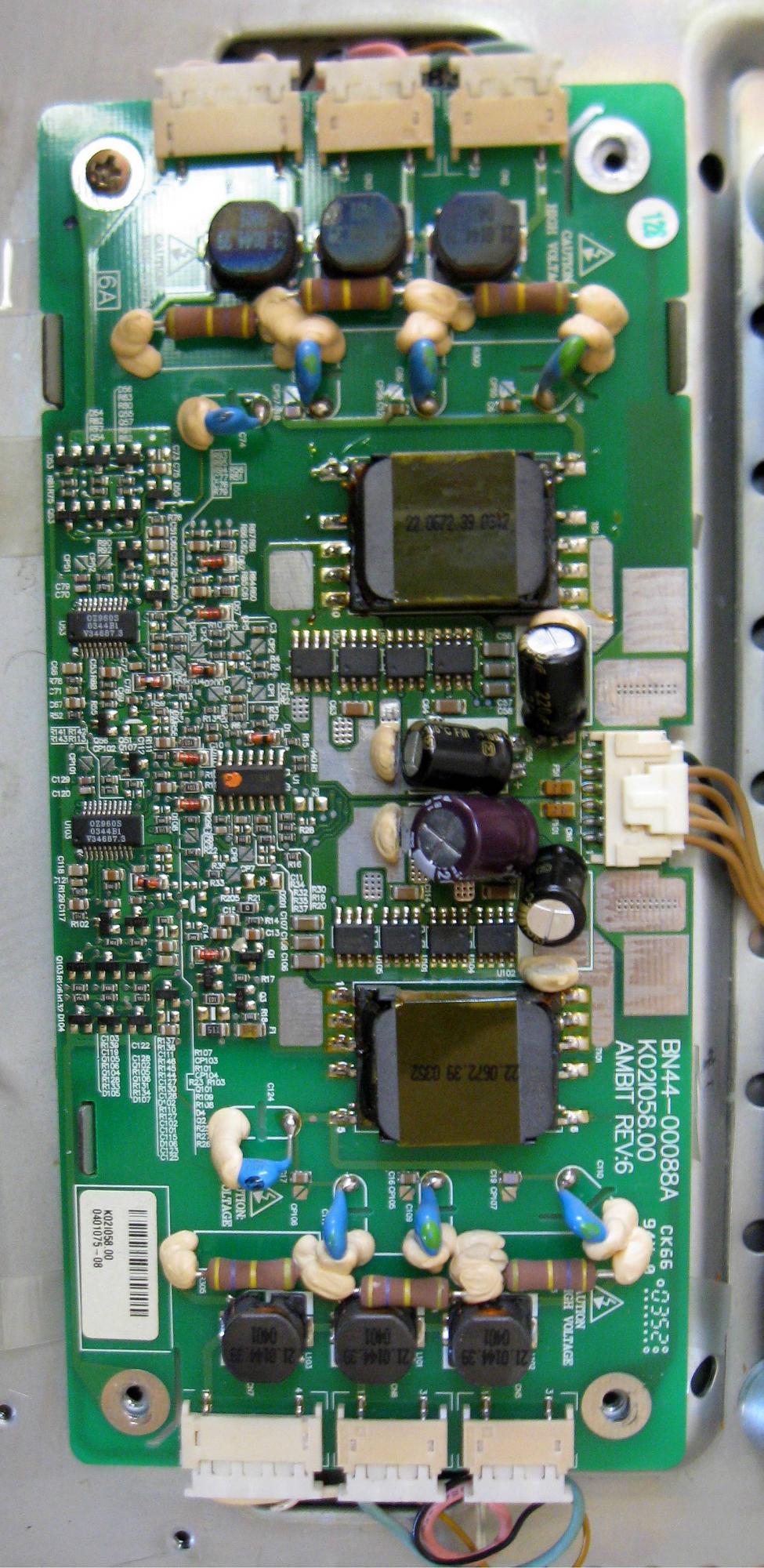

                                  • kingofcoins
                                    SaveOnGreen-Cap
                                    • Jan 2010
                                    • 162
                                    Re: green led only
                                    Update using new multimeter...I have 14 and 5 volts out of P/S to logic board, ....but then 18VDC out of logic to inverter board, of course no voltage at lamps. How did voltage get stepped up?
                                    Question on my re-cap job (see inverter pic)...I couldn't seem to get all the cap legs thru to bottom of board so some of these are more of a surface mount, however each leg hole in the board bottom is nicely closed with solder....is this a problem > Does solder always need to on top and bottom of PCB's ?
                                    IC voltages IC 102... 1.25, 2.50, 5.0 VDC
                                    IC 101, 105, and 106 all.. 0.0, 3.4. 5.0 VDC
                                    IC505 is an Inverter..74F14,INVERTER,SOP,14P,150MIL,
                                    • retiredcaps
                                      • Apr 2010
                                      • 9271
                                      Tough to tell from the photos because they are a bit blurry, but it looks like there are 2 fuses on the inverter board. They are surrounded by the 4 caps.
