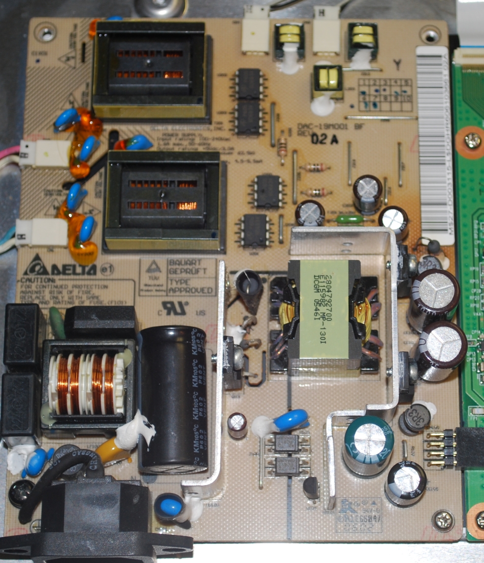

          I have the same monitor with an image but no backlight. I saw two CapXon capacitors at 1000 uF and three at 220 uF with popped tops. I also replaced a third 1000 uF (@ 10V IIRC) which was flat, but also CapXon.
          I didn't get a change in behavior. I still got an image with no backlight.
          I'll look at the board again and proceed to replace any remaining CapXon capacitors.
          I will read the previous articles in more detail, but I'd still love some advice on other parts to examine.
          I have two Nichicon capacitors at 1000 uF and 25V, but they're wider and taller than the original Capxons. When I put them together, they want to form a V shape.
          Any thoughts on going forward with capacitors that are electronically compatible but physically incompatible?
          Thanks for reading!

            • jetadm123
              • 2169
              Re: Lights go out on Westinghouse LCM-19v7
              You'll need to post some good focused photos of the top and bottom of the entire power board, since there were several revisions of this board with each revision being slightly different.
              1) If your board is similar to post #16, then check fuses F200 and F201 for continuity.
              2) Check mosfets U200, U201, U202 and U203 for shorts.

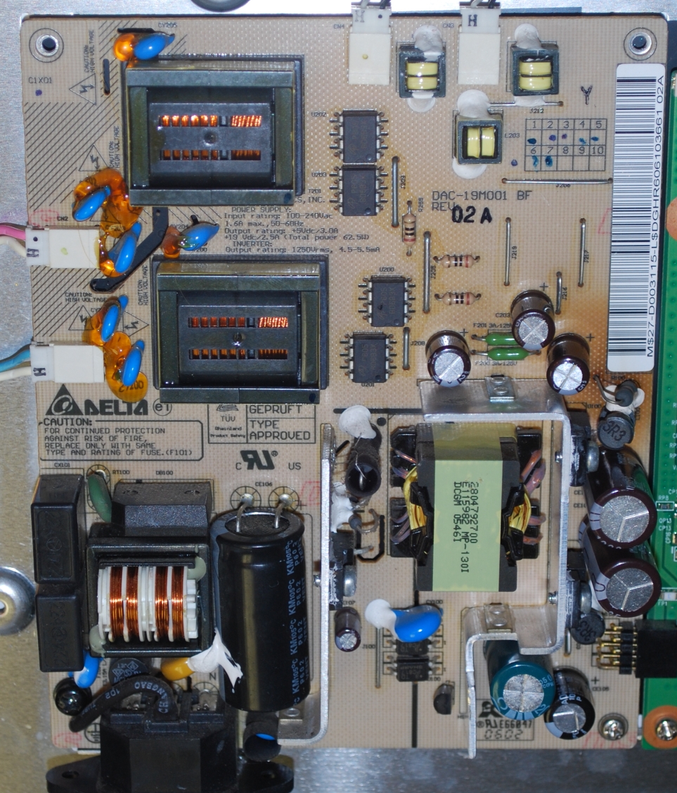

                I hope these pictures are sufficient. Pictured are the replacement capacitors. The board reads:
                DAC-19M001 BF
                REV 02A
                I'm still getting an image, but no backlighting.

                  Check the two green picofuses as suggested by jetadm123. A good fuse should read less than 1.0 ohms.

                    There is a hefty gray resistor on the right center side of the powersupply check it closley.

                      #30
                      DAC-19M001 BF
                      REV 02A
                      If this thread ever come to the point, where it's suggested that known good CCFLs be substituted
                      The CCFL connectors are positioned different on this inverter, The 4 high voltage wires are on one side of the inverter, and the return wires are on another.
