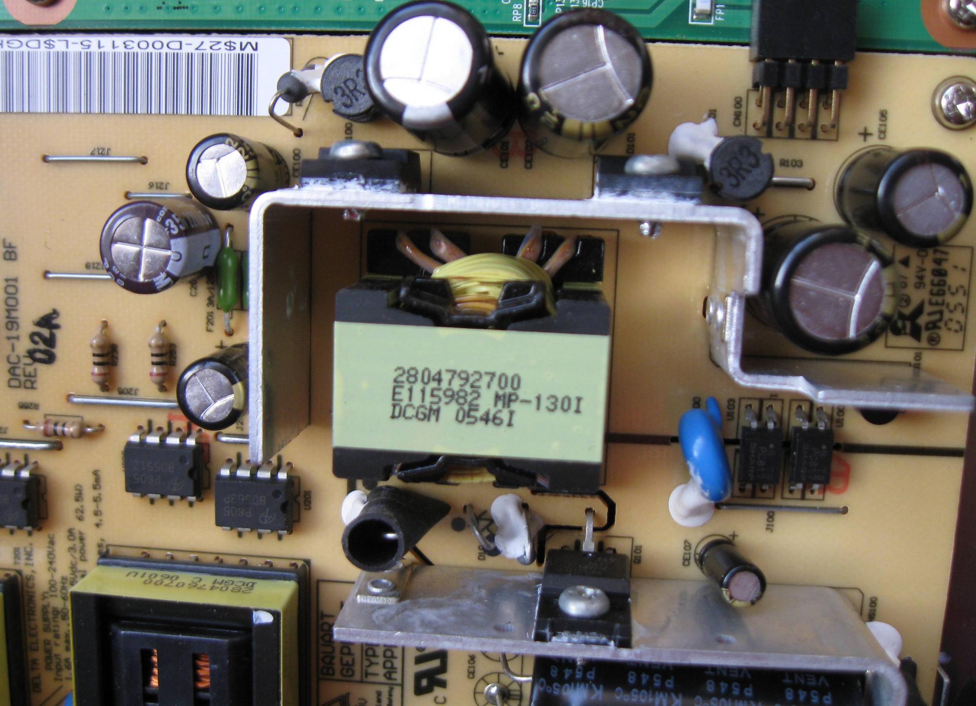

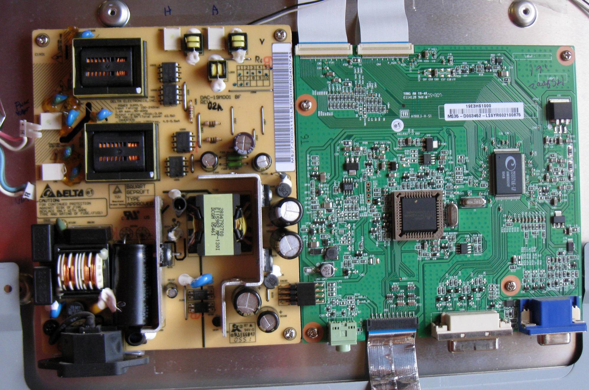

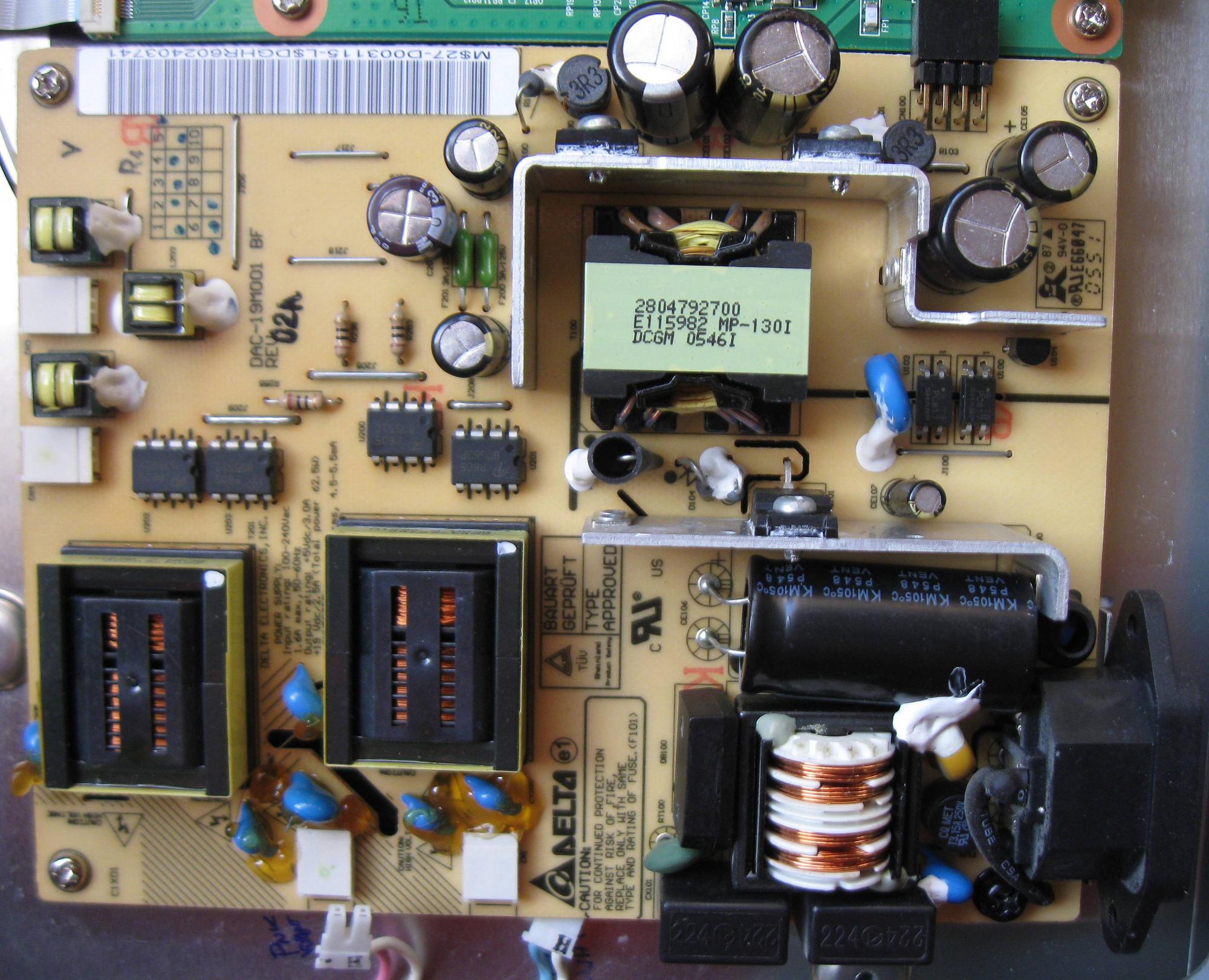

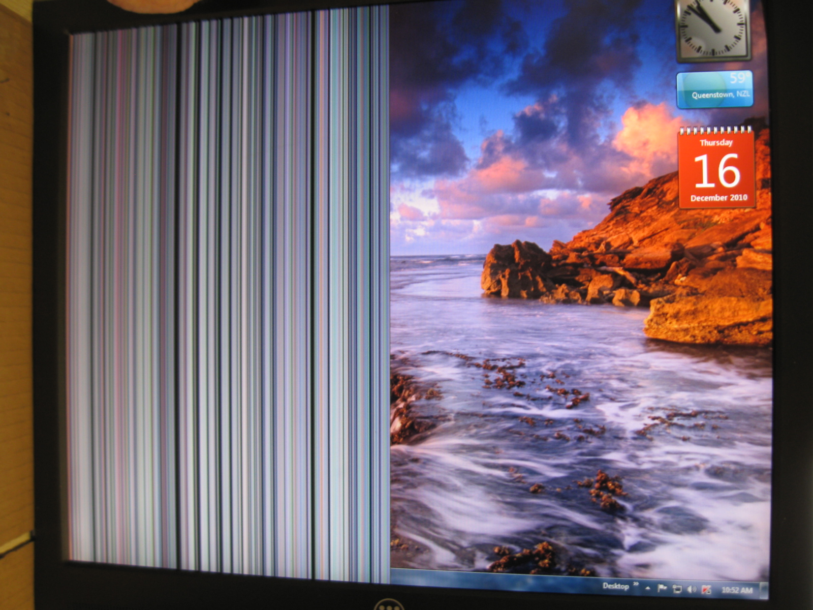

Back at it...This is a like-new 19" LCD Westinghouse LCM-19v7...replaced all 8 of the Capxon caps on the DAC-19M001 P/I board with Panasonic FM's even though they all tested good with low ESR's. Was giving about 10 seconds to powerout and as attached pic shows the left half of screen was vertically srtiped. After repair it all works for maybe 5-10 mins then the backlights start blinking...AND soon its lights out, though green power led stays lit. Turning unit off and right back on restores display but if warm its off in a few secs. If you wait for awhile before cycling power then it stays on longer. Does not seem to come back on itself unless shut down, cooled and rebooted.
So what do you think...where should I test first guys ?
