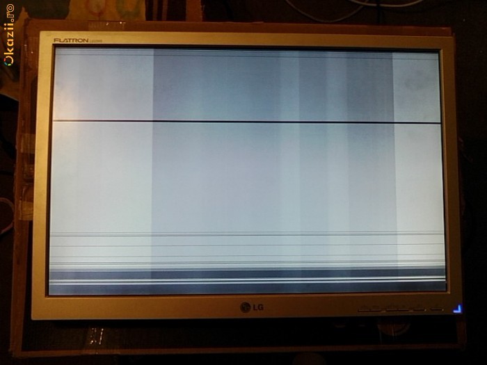

Whatcha think this one has? I think bad cable (not worth it)
  • Th3_uN1Qu3
    Believe in
    • Jul 2010
    • 6031
    • Romania
    See pic here. It either looks like a bad ribbon or worse, damaged panel. But i want a second opinion.

    Re: Whatcha think this one has? I think bad cable (not worth it)
    The only LG I have dealt with is one here with a Lien Chang PCB. This is an older LG design from around 2004 from an L1710S. I recapped it, so it works for a a while and then shuts off. The next step is to change the primary and a few smaller caps. I wouldn't be buying this stuff in auctions, if someone personally sold it to me or I found it I would work on it, so my advice is against buying it.
      Yikes! I can't tell the screen size here, but if its not pretty big (meaning big enough to make the brain damage worthwhile), I would think this would be a bear to fix. Judging by your experience level I've seen in your posts, however, I bet you could do it. I guess it comes down to if it is cost effective to do it.
        Just has a 22" Widescreen, exactly the same.....put the LCD to Logic cable in correctly,and I'm a winner,doest not happen all the time, but makes up for some of the real bad ones I get.
          Wow....how'd you see the # enough to get the screen size?
          If its a 22", then I'd go for it!
            Followed your advice already. I picked up a 19" Sammy in PRISTINE shape for $50. How much work was required? ONE CAP. Will get me by till i fix my beast of a 21" CRT, and then will easily fly for double what i paid for it.
            And yes it was a 22", for the same $50 i paid for this one. I might think of grabbing it if it's still there after i sell this one.
