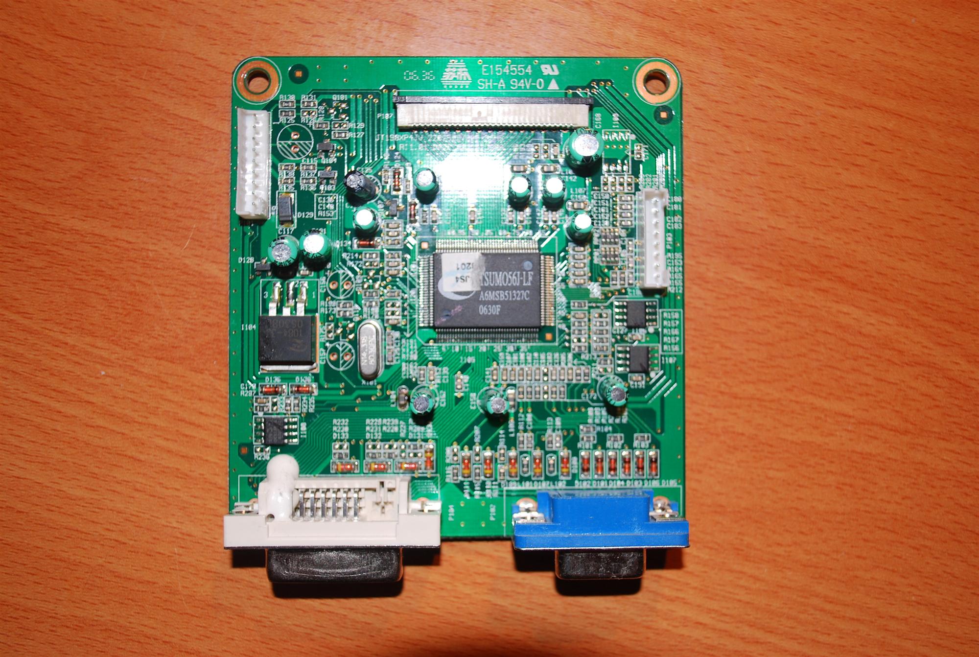

    Hi!
    My LCD turned dead tragically with a burning smell, just like that. Black screen, the on light steady green.Pushing on off buttton does not turn lcd off, nor will it turn the green diode to orange. The screen always stays black.
    I was certain to find some badcaps when I opened it up. At least some burnt electronics, but found nothing. It looks ok. See photos. Caps are Hermei and elite. Checked esr and all seems well on the powerboard.
    I have measured the voltage at VRM on the logic-board, and had 3.3v. Seems alright since the diode on the front is glowing. Caps are lelon and one hermei.
    Checked esr and 3 lelon 47uf is shorted so a replacement might be the cure.
    Could one of these caps have emitted the burnt smell that I felt?
    Any pointer would be appreciated, but I do believe it to be a lost cause. However, it might not.

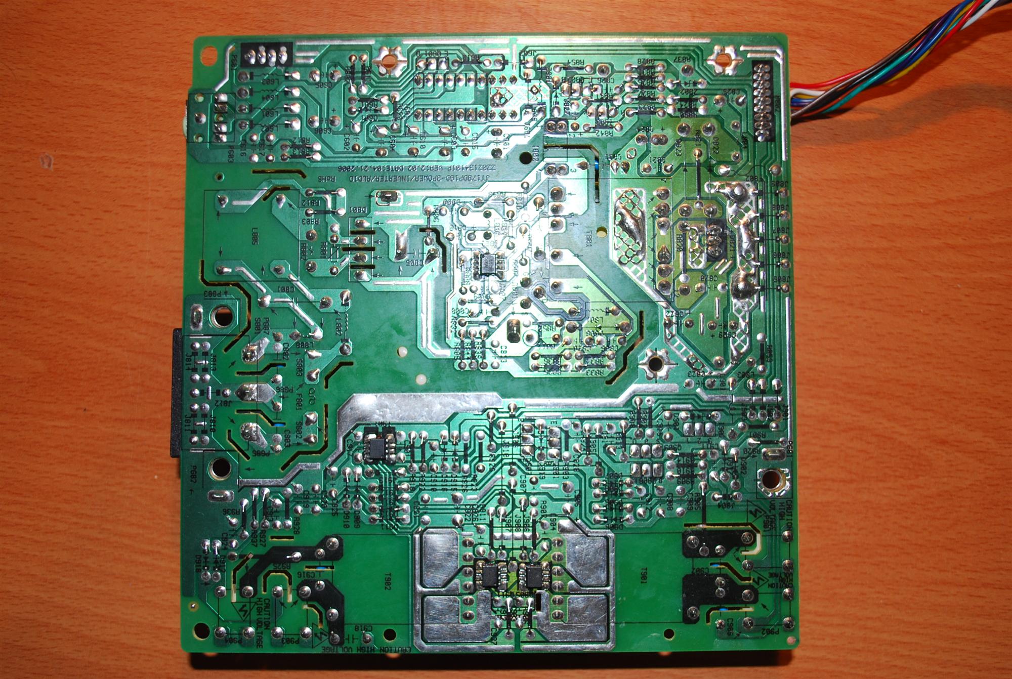

      get a closeup of those 2 soic-8 mosfets under the inverter transformers.

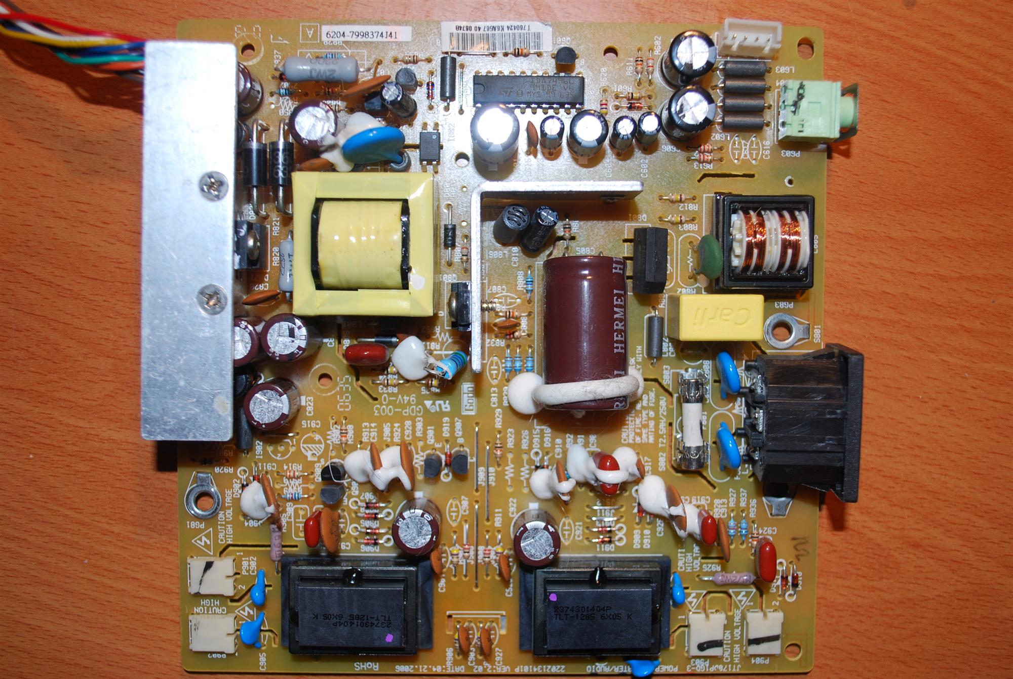

        Is it my imagination or are those brown Hermei caps on the left using a Panasonic style vent indentation? Tsk tsk tsk Hermei.

            @ kc8adu & meanderer
            The mosfets are labeled stm6930a, found the datasheet attached here.
            Now I only have to figure out how to measure them. Any suggestion would be great.
              Put your multimeter on 200 ohms if manual ranging. You can test this "in circuit".
              Test for shorts by measuring D1-S1, S1-G1, D1-G1, D2-S2, S2-G2, and D2-G2.
              Any reading less 30 ohms suggests a short.

                      On the top side of the power supply, there are 4 transistors. I think they are Q901, Q907, Q909, and Q90? (marked B C E).
                      They are loacted all above the left hand inverter transformer.
                      Test all 4 for shorts. B-C, B-E, C-E. Again, any reading less than 30 ohms suggests a shorted transistor.

                          Your photo isn't close to 2000x2000 resolution (the max supported on this board) and it is hard to tell, but look for a picofuse on your board. It is usually marked PFxxx. It might be underneath the shield or on the backside?

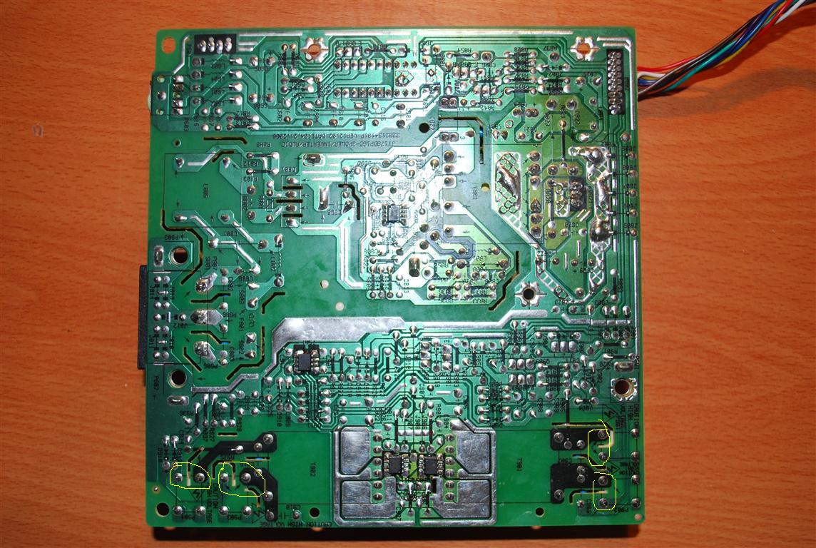

                            Scanned the board for a picofuse, but I cannot find any. Perhaps I have looked at it for too long. I will call it a night. Thanks again for your advise retiredcaps.
                            Edit:
                            I found one that could be the "picofuse". Its located under the shield close to small coil. Its labeled F802 (F801 is the ordinary fuse at ac input), but its an bridged joint and not a fuse at all.

                              Since you're getting 5V and 12V output from the power board , but no image on screen, try checking the output of the voltage regulator (I104?) on the logic board. Looks to be stamped 1084-33?, where the 33 should equal 3.3V. Also, look closely for any surface mount fuses that may be on the logic board.
                              Also consider checking the secondaries of the inverter transformers. With power off and monitor unplugged try taking resistance measurements across the points marked. Note: The points I circled are the best I could do because of the photo quality. Please verify those points before checking.

                              • bluebear
                                • 90
                                Re: Iiyama prolite 1900s dead
                                I attached larger photos, maybe that helps.
                                I measured at the position you suggested jetadm123.
                                From left to right on the left side: 2.964 and 4.64 MOhm
                                Right side going clockwise: 2.969 and 3.92 M Ohm
                                I will check the vrm.

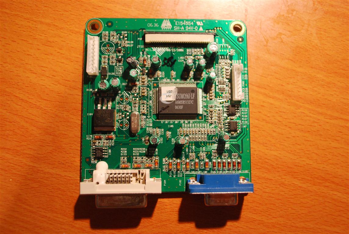

                                      Right, the VRM is ok. Input voltage is 4.7V and output 3.349V.
