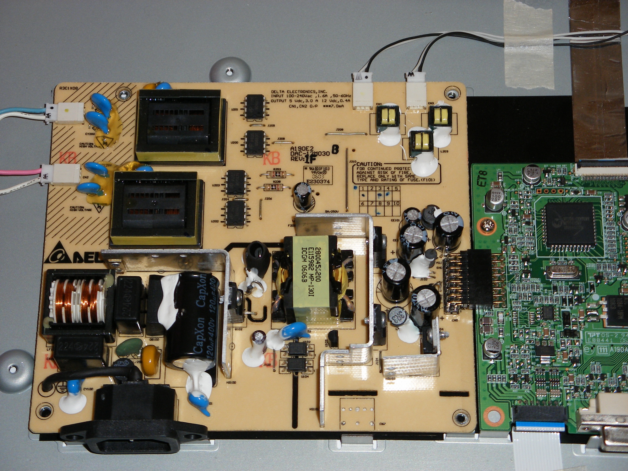

    I have LCD monitor Westinghouse LCM-20v5, inverter/power supply DAC-12M030B Rev1F. If it starts to work from cold condition it waits about 1 sec to show normal image. Then it works fine about half an hour, then it becomes blank. Turn off/turn on – goes to "2 seconds to black" condition. I think that it's a backlight issue because when I use flashlight, there is badly visible image on screen. First of all I resoldered all joints excluding on-surface components. Then I changed 6 capacitors for new ones (I found it by googling “Westinghouse LCM-20v5”). No changes.
    Then I tried to cool DAC by small fan. In this case monitor worked without "2 seconds to black", as long as I needed.
    Does anybody know a link to DAC-12M030B schematic or circuit or wire diagram and any suggestions, please?

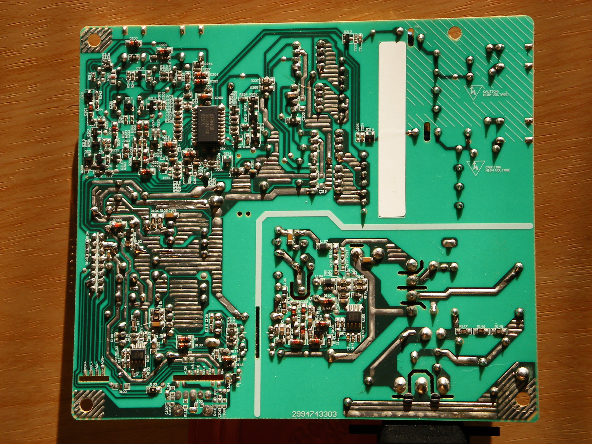

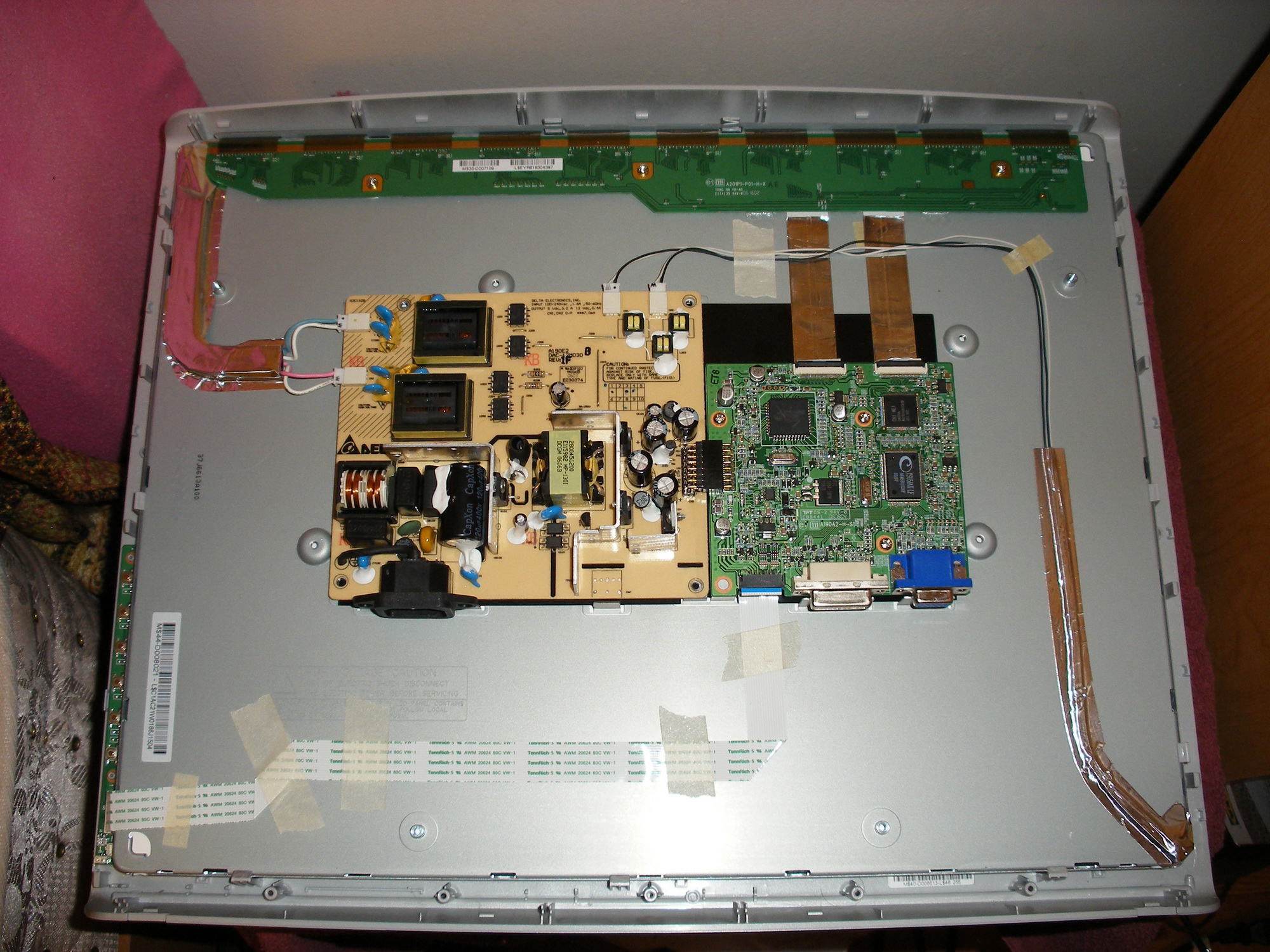

    the compsotion of the pictures is excellent. It shows the relationship of the various boards and connectors, and gives some interesting information. This appears to be a slightly unusual design. Usually we see output and return lines for each CCFL coming to the same connector. This design appears to use two sets of connectors. Not a big deal.
    The size of the pictures leaves a little to be desired. This board can support up to 2000 x 2000 pixel resolution, and we will need every bit of it for the next picture. I need a picture of the back of the power supply / inverter. The hint that this might be temperature related is significant.

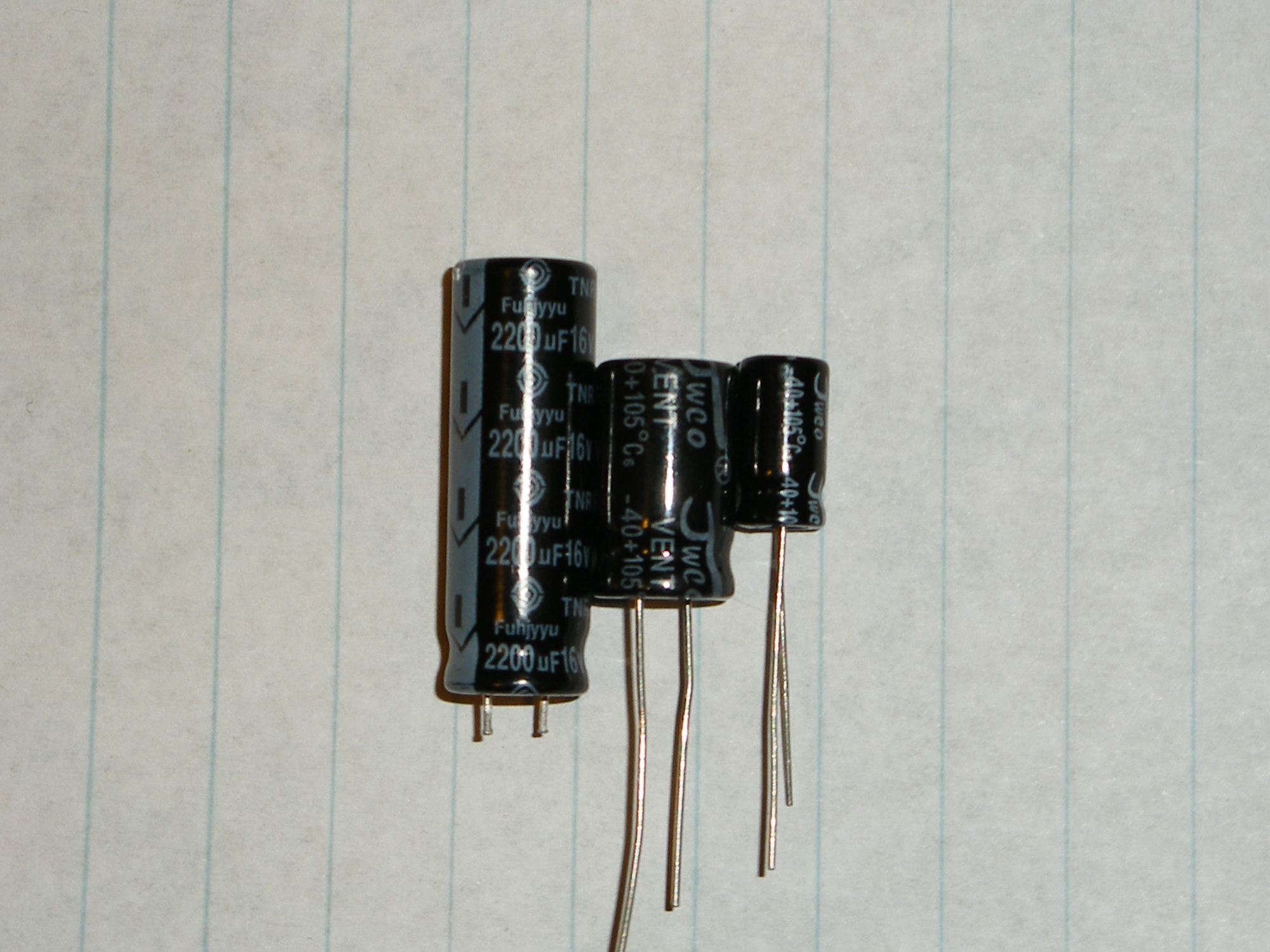

    Also, you have indicated you have replaced the capacitors. What caps (brand and series) did you use?

        Welcome to the forum! My initial reaction is that you have an overheating problem. Good troubleshooting with the fan. If the caps that PlainBill asked about are of good quality, then you may have a component that's starting to fail because of the heat. Or, you may have a bad solder joint. As the the board heats up, thermal expansion may cause the solder to separate from the pad or the device lead. The devices that generate the most heat are the heatsinked devices, bridge rectifier, inverter transformers and the 4 8-pin driver chips next to the inverter transformers. Try resoldering the pins/leads of the devices mentioned. Of course, some of the surrounding devices could also be affected by the heat. And there's always the possible lousy soldering job that was done at the factory and it's just starting to show up now.

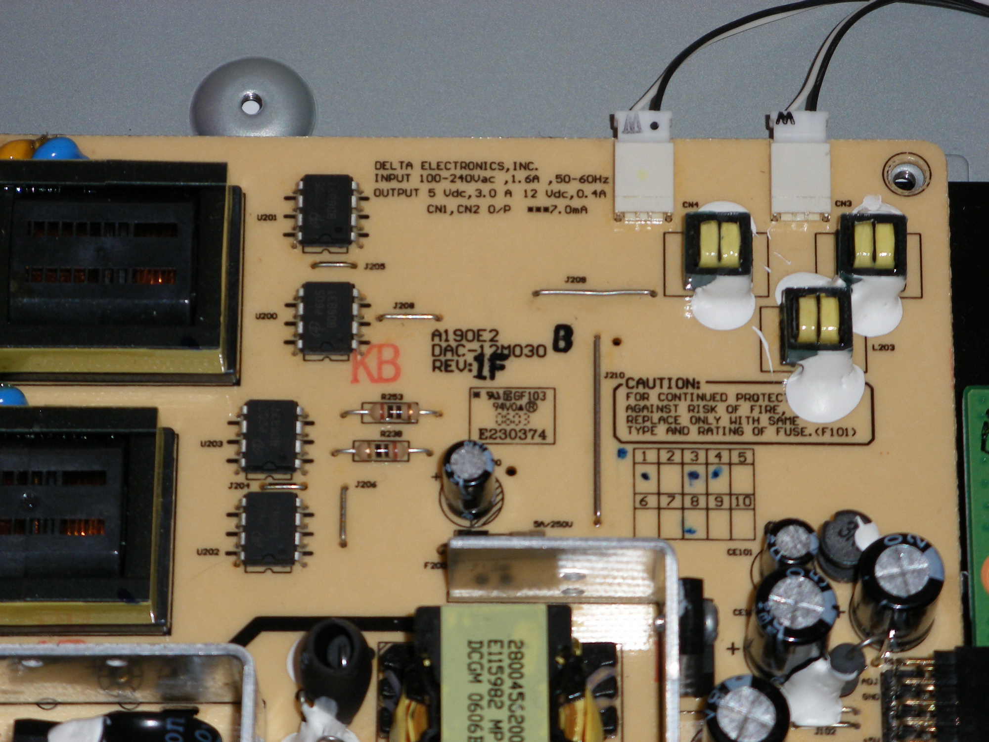

          Yes the power and return connectors are on different sides of the board.
          In the third picture there is a resistor by the ADJ pin on the connector that goes to the logic board, look at it closely for any sign of overheating or poor solder joints.

            Resending picts 2000x1500 plus back side of inverter plus capacitors (similar, not same ). EVERY JOINT EXCLUDING ON-SURFACE COMPONENTS WERE RESOLDERED carefully, I have a small experience in soldering

                Since you're getting up to half an hour of operation before "2 sec to black", try accelerating the shutdown process by using a blowdryer set to the high heat setting and heat the various components to see if you can trigger the shutdown process.
