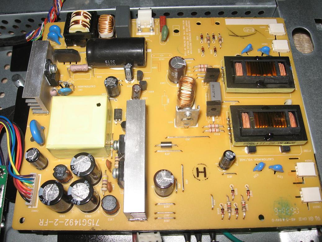

      Definitely a common problem on that model.
      I'd recap the power supply/inverter while it's open.

          Anyway, which caps should I home in on? Haven't found this model mentioned online regarding issues (attached a photo of the board). Also, anyone hazard a guess as to where was the crackling was likely to have come from?
