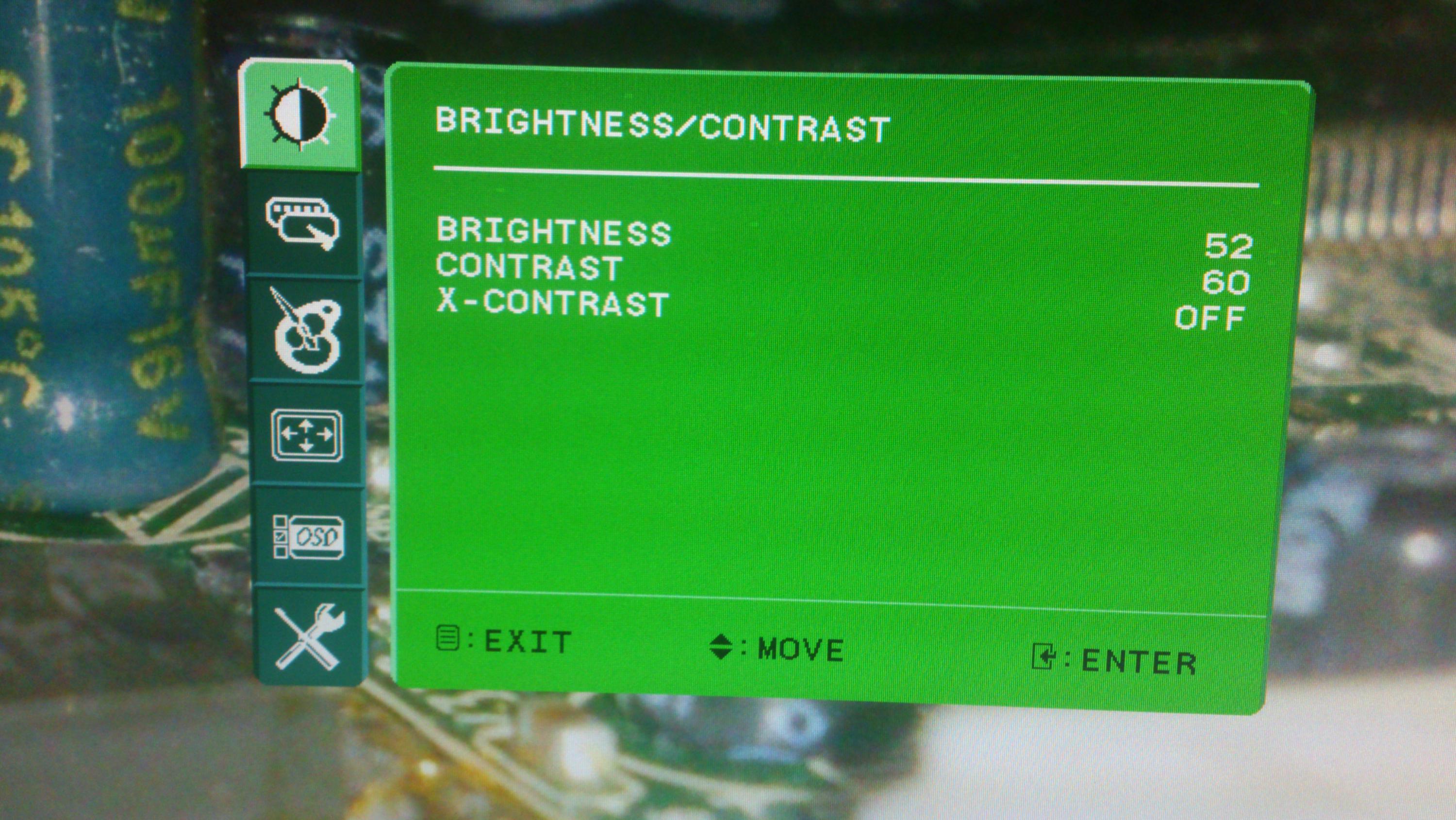

    I am new here. I tried to find something/somebody to fix my HG281D.
    I had the same issue like Inveio had. In summer it was working perfectly, but in winter I had to wait 2-3minutes or did something to warm up my monitor if I wanted to turn it on. I could not tolerat this thing anymore so I called somebody, who has replaced the bad caps (There was a couple of swolled caps on the supply board) . Than it worked ok for 2 months.
    Then I wake up one day and I could not turn it on anymore. I tried to warm up with a hair dryer for a long time (as sometimes did before), but nothing has happened. Only the led indicator was flashing up for a tenths of a second. I could not turn it off anymore (Led indicator did not show the orange color) only the blue color flashed up sometimes.
    I would like to fix it, because I like it very much, but I do not know what is its problem. It looks on the pics somebody tried to replace those 2 caps that Lumberjack777 mentioned above. I am afraid how to fix it, cause if somebody tried to replace those two (not the man I called) and did not help, what could be the solution.
    Thanks for reading my story. 

      Re: Hanns-G HG281D, LCD Monitor no power
      Ok, you fixed the main/logic board. That's good. Your problem with the power on, is on the power board. There are at least 2 different types of power supply board for this monitor. Can you post a picture of your power board, and I think we can help you fix this.
          Lucky you. That's the easier one to repair. Try replacing the 3 caps circled in red. Feel free to change any circled in blue if you want. But the 3 circled in red are usually the problem.
          Make sure to pull straight out on the cap when desoldering. I have seen some botched repairs where the person pushed back in a little on the cap, and lifted the thin copper trace and pad. Those pads lift easily if you push on the cap.
                            If it were me. I'd just buy those 3 caps (circled in red) from my picture. Just get high quality caps like the others mentioned. With 105c rating, because the monitor runs hot. You could also buy the full kit from the place budm mentioned. We are just trying to make sure you get high quality caps for the job. Just make sure the repair person knows how to solder well. Good luck!
