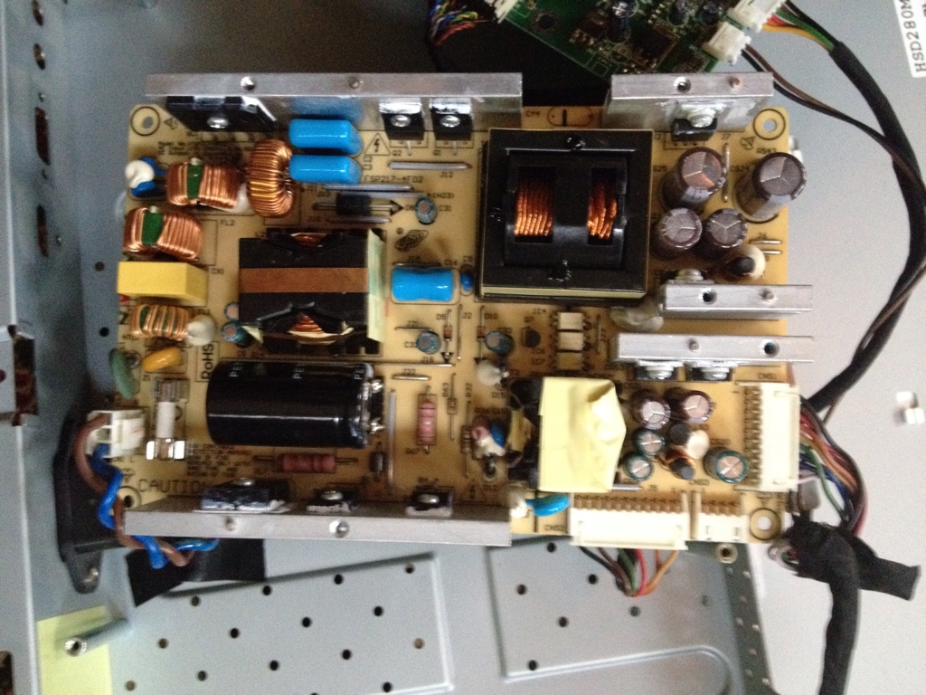

    So I found advises here and I give a try to fix it. A little background - I am into electronic for more than 30 years, few years worked professionally, otherwise mostly as every day hobby, so I have no issues to fix almost anything that does not require heat gun.
    First I was about to replace 2 caps on main board in power supply - they were inflated suggesting they lost the value. I can measure capacitance only so I did - both are around 10 uF instead 470!! And monitor worked 3 days ago. I assume they are similar in value and position as in monitor in subject:
    I had on hand 2 470/35V not low ESR so I put them instead. I put all back together, not working.
    Here is where they are and how they look:
    OK, then I went to change those 3 suggested in this thread, 2x22 uF and 1uF. When I took them off I measured capacitance and found 1/4 of capacitance on all.
    Since I was lazy to order and wait, I took old Akai CD player, it is like 15 years old and found 2 capacitors 22uF. Measured by capacitance, they are OK (I do not have equipment to measure ESR though) and it appears they are not low ESR. Also I took one new 1uF/160V that I had on stock and replaced all 3. Put all back together, its working! It even turn off / on on every power button click.
    Thanks you all! I love the picture this monitor have, actually I hate all those LED litted with cold blue picture (that cannot be set not to be bluish). I am very happy to have this thing working again!
    Finally, here is what I replaced, cost is close to zero. I do not think you must use top quality capacitors although it is best to use them to avoid any future issues, as tolerance is very high. My monitor worked with above values!
    And all back together in place.

              Just finished repairing four (4) HG281D monitors that all failed after approx 5 years of use. Two did not turn on at all, both had fluctuating +5VSB. Replacing the capacitor C603 of the power supply (22 uF / 35 V) fixed both of them.
              The other two did turn on and +5VSB was stable, but did not get the signal (displayed "no signal" message). Replacing capacitors C61 and C69 on the main board (100 uF / 16 V next to a regulator) fixed them. Just a hint for other people looking for a quick fix and not wanting to spend more than a dollar for spare parts :-)
                Re: Hanns-G HG281D, LCD Monitor no power
                Sorry, the numbers of problematic capacitors on the main board are C80 and C83.

                    I've repaired about 10 of these. It's always the same caps. The ones on the power board. And the two on the main/logic board as Budm mentioned. If you replace just those 2 you'll probably be fine. Many, many, of the other caps are still good. And it's a waste of time and money to even replace them. Try replacing these 2.

                                Got the 2 caps for the main board in the mail yesterday and replaced them. Great news, the monitor is working as new. No flickering, no 10 minute warmup,... everything back normal. I wonder now whether there were bad caps on the power board at all. Regardless, thank you for all the help. If I didn't find out about replacing just those two caps on the main board, I probably would not have gone through the trouble of taking it apart again.
                                For those reading this and having similar problems. Replace those two caps on the main board. It only costs about $3 (with s/h) from digikey for those two extra caps.

                                    @jimmy1256 Try measuring the voltage at the power supply. If +5VSB is stable all the time (even when the monitor turns off), this circuit is OK, otherwise use better quality capacitors C601/602/603, possibly C707. If some other voltage fluctuates it might be regulators or one of the U(101, 102, 201...) chips. When replacing caps, I've almost broken a pad next to U201 once (as user Steven_C on this forum also did), so try checking whether there was some damage done when replacing caps. Might be something completely different, but this is something to start with. In any case, voltage measurement on power supply is where you should start.

                                      If you used good quality caps (i.e., not Radio Shack, eBay for the most part, etc.) and they are low-ESR, then the problem likely isn't cap-related.
                                      Something intermitten like this tells me it could be a bad solder joint or faulty regulator possibly. Since you can't see any image with a flash light when the problem occurs, my guess would be the problem is related either to the logic board (where the signal scaling/processing happens) or the t-con board (this is the board that "maps" the scaled signal on the screen - it's a board usually at the top of the LCD monitor under a metal shield and is permanently attached ot it via delicate ribbon cables).
                                      How to narrow it down:
                                      I think the best approach would be to take some voltage measurements before and after the problem occurs. These would be the 5VSB (5V standby comming from the power supply), the input and output voltages of the two regulators on the logic board (should be close to C80 and C83), and the t-con supply voltage (usually 5V or 3.3V for most monitors).
                                      You will need a multimeter for this. All voltages should be referenced to ground (i.e. any metal part on the case of the LCD - attach negative (black) lead of the multimeter to that).
                                      And last but not least, add pictures of your monitor!
