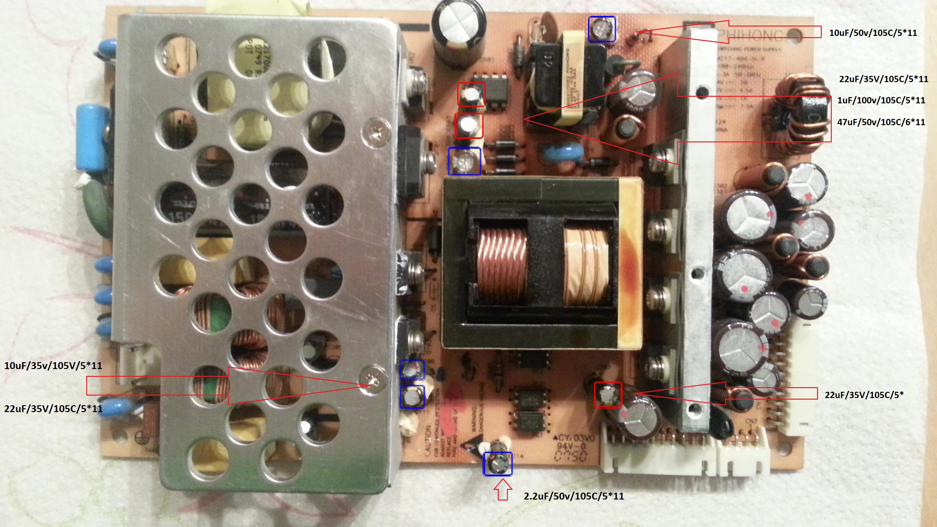

      hey thanks for the help
      the pics posted of the power board are not the same as mine, I managed to snap a few pics but they are not of the best quality. Its the best I could do without buying a camera.
      So I will just recap the entire 2 boards and see how that goes. here is the cap list

      Originally posted by Lumberjack777 View Post
      Lucky you. That's the easier one to repair. Try replacing the 3 caps circled in red. Feel free to change any circled in blue if you want. But the 3 circled in red are usually the problem.
      Make sure to pull straight out on the cap when desoldering. I have seen some botched repairs where the person pushed back in a little on the cap, and lifted the thin copper trace and pad. Those pads lift easily if you push on the cap.

        Hi Hapollo. You know, I have never had one of the alternate power boards like you and BtB have to repair. It's always been the one I will attach here. But since your board was manufactured around the same time that many manufacturers were using the inferior caps; there's a good chance you have some bad ones. You could replace them all (If you are fairly skilled and have the time). I have an ESR meter so I can test them. In my experience on the other board, it was the smaller caps that tended to dry up. Especially in the middle. It's really up to you. If I didn't have an ESR meter, I'd start with the smaller caps that aren't bulging. Or just replace them all. Hope that helps.
        P.S. I did hear of a guy that fixed your board by replacing some caps. But I don't know which ones he replaced. So there is hope
        And you want to replace the 2 caps budm mentions on the logic/main board (photo attached)

          Thanks Lumberjack777, I don't have a ESR meter but have replaced many many caps on defective LCD TVs from the 2008 era, mostly Samsungs and typically those have been the larger 1000uf or 2200uf. Rarely have I had to replace anything less than 100uf.
          These Hanns seem to be the reverse, mostly small <100uf fail and the larger ones seem ok. Having read your earlier post that it's always the same smaller ones and a waste of time and money to replace the larger ones:

              The microfarad value needs to be the same. The voltage can be a little higher. A 100uF 16v cap can be replaced by a 100uF 25v cap. You'll need to replace the 3 I had circled in red for sure. Those 3 always go out. I'd replace all the small ones in the middle of the board just to be safe.
              You need to be careful on that board because the manufacturer bent the cap leads all the way over. So when people melt the solder, and pull on the cap, it can take the copper trace, and/or the pad with it. I like to melt the solder and stick a tiny screwdriver in there, and bend the wire lead up a little at first. Then pull it out.

                    OK found it. Post #727 from Castor8 7th image. Will try to re-post the image here in case anybody needs it.
