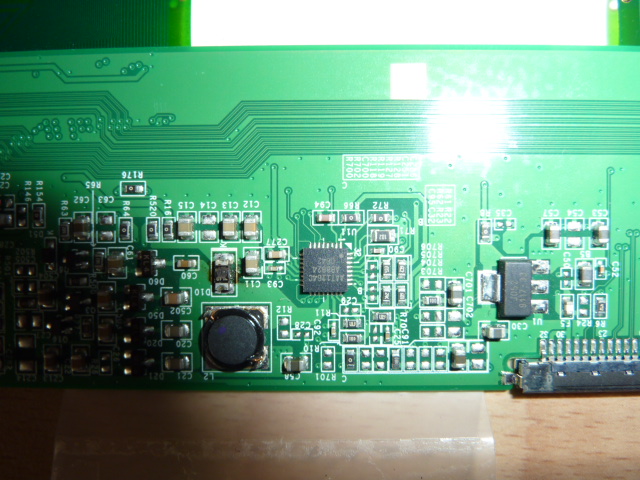

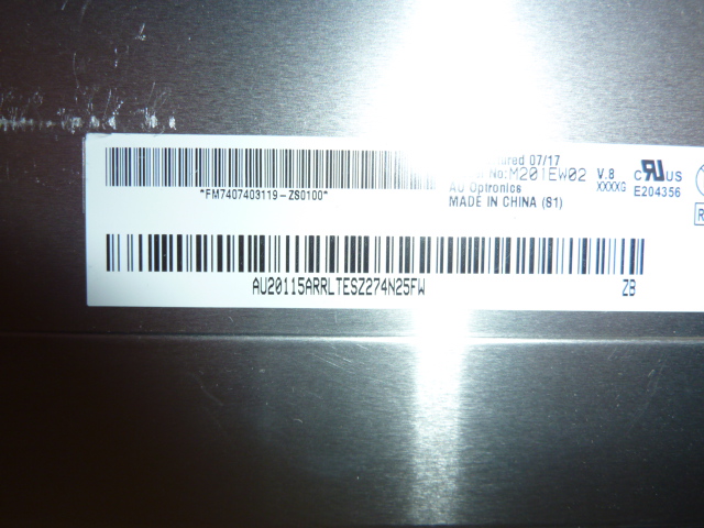

    Hello, I have a a Acer 20" lcd monitor with a screen problem ( no picture white screen). The problem is with the lcd panel AU Optronics M201EW02.

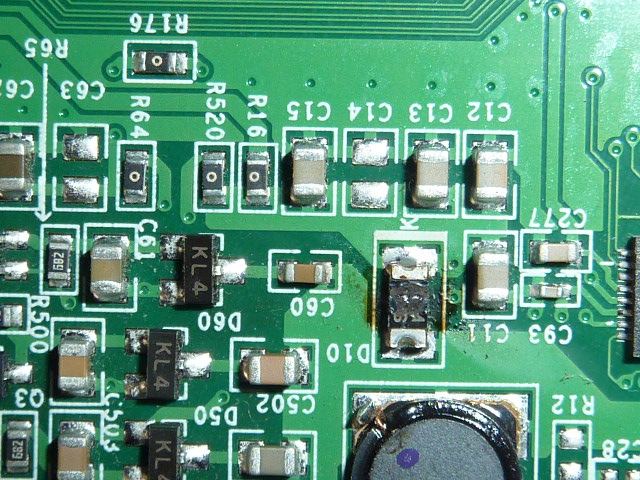

    you can see in the picture that D10 has blown, has any got any info on what it might be?
    Thanks for any help
    Terry

    Re: 20" LCD screen help
    It might help if you put the actual Acer model number.
    One of the reasons we ask for clear focused pictures is for this very occasion. If you do a search for your Acer model, you might get lucky and find a clear focused photograph from another member and be able to determine that diode from their pictures?

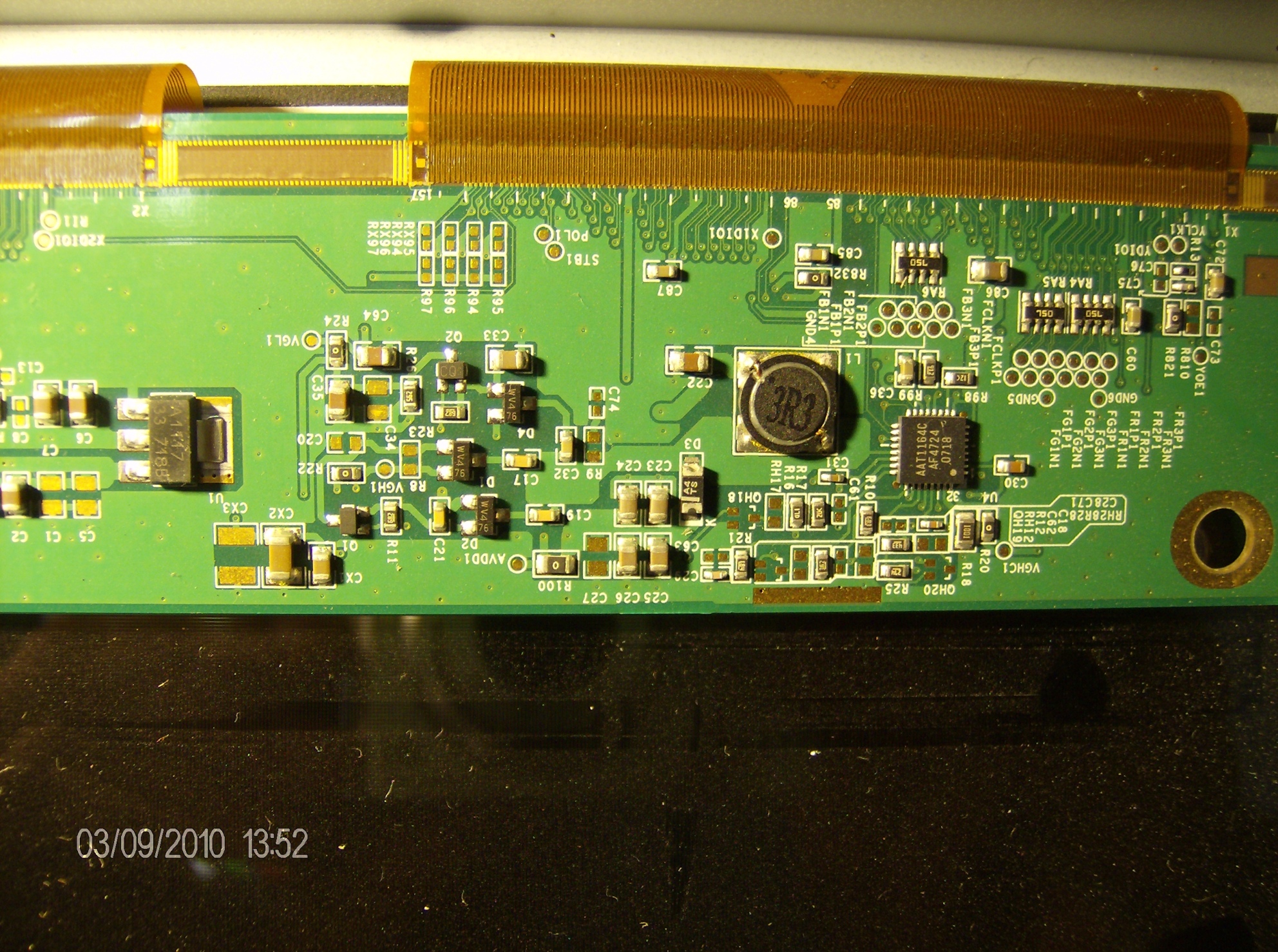

      wel... based on the tag it might be a diode, i dont know much more... do you have the model no. of your display?
      i found an Acer around, hope it helps:
      https://www.badcaps.net/forum/attach...1&d=1283540534
      if you need pics from other area of the noard i'll gladly take em.
      peace.
        The model No. is Acer X201W (ET.L970B.002)
        Regards
        Terry
          It's a SMD Schottky diode. Unable to get a proper cross reference from it's markings A4 TS.
          Cross ref for A4 comes up with a dual-diode that is very tiny. Completely wrong.
          IIWM, probably use one rated 1 amp or less and perhaps ~200-400v. Strictly experimentation. Going to take some poking about on DigiKey or Mouser to come up with a sub. Or, buy a refurb/new board.
          Toast
            What are the dimensions of this diode? As Toasty indicated, it's a Schottky diode. I'd agree, probably less than 1 Amp. The voltage rating would be considerably less than his estimate, I'd suspect 50V max.
            Once the package size is determined, it's a relatively easy task to sort through the rest of the results to find an acceptable part.
            Do NOT order this part without checking the package size!!!!!
            On Digikey, by selecting 'Diode' 'In stock', 'Schottky', '1 Amp', '100V', 'Surface Mount' I came up with around 25 hits, one of which is B1100-FDICT-ND, at $.44. Again, this may not be the correct package size!!!!
              I can't tell you what diode it is apart from the info already supplied by the previous posters.
              As the input to the panel on pins 31 & 29 come from the video board as 5VDC, the diode must be a low voltage one as the IC U11 is providing all the necessary voltages to the panel. If you find a SMD 25V 1A diode, it would probabely work.
              Still, you have another problem as the diode does not get fried without any reason.
              Check for shorted components, like capacitors.
              I am interested to know what transistor you have on your video board as 5V supply for the T-con board. It must be sitting next to the connector where the cable that goes to the t-con board is plugged in.
              In my monitor, this transistor is burned and it was impossible to read what transistor it was.
              By the by, my monitor is a Proview, but than our Chinese friends use all sorts of brands with the same guts.
              Cheers,
              Joseph.
                Sorry monitor fixed and sold, I replaced to screen
