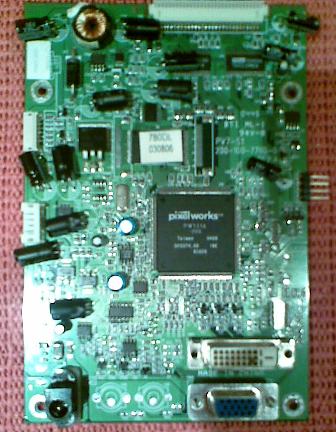

    Hi has anyone come across this problem with these monitors before
    Started asa 2 sec to black so i changed the inverter no joy
    Changed bulbs still no joy
    So tried changing caps on main board
    10 16v 220uf and 5 16v 100uf and still cutting out
    Not sure now which way to go
    any help or ideas would gratefully accepted

      Hi thanks for reply
      The caps have no name that i can see
      220-16PHT 220uF 16V 105'c have NA and
      100-16PHT 100uF 16V 105'c have a large H
      Bought from little diode
      Look again and they dont say low esr but assume they were
      The inverter board is a seperate from the main board and is new
      Will upload picture of board later as its dark here (UK)
      Took this on cam phone not very good but gives some idea of board

        Is your external PSU putting out the correct and stable voltage?
          Re: Xerox XL775D
          HI all well my thanks go to retiredcaps and seanc more for reminding me to check the basics before looking for the less obvious
          Popped the power supply open to find wait for it
          a bad cap
          changed this and now all working fine
