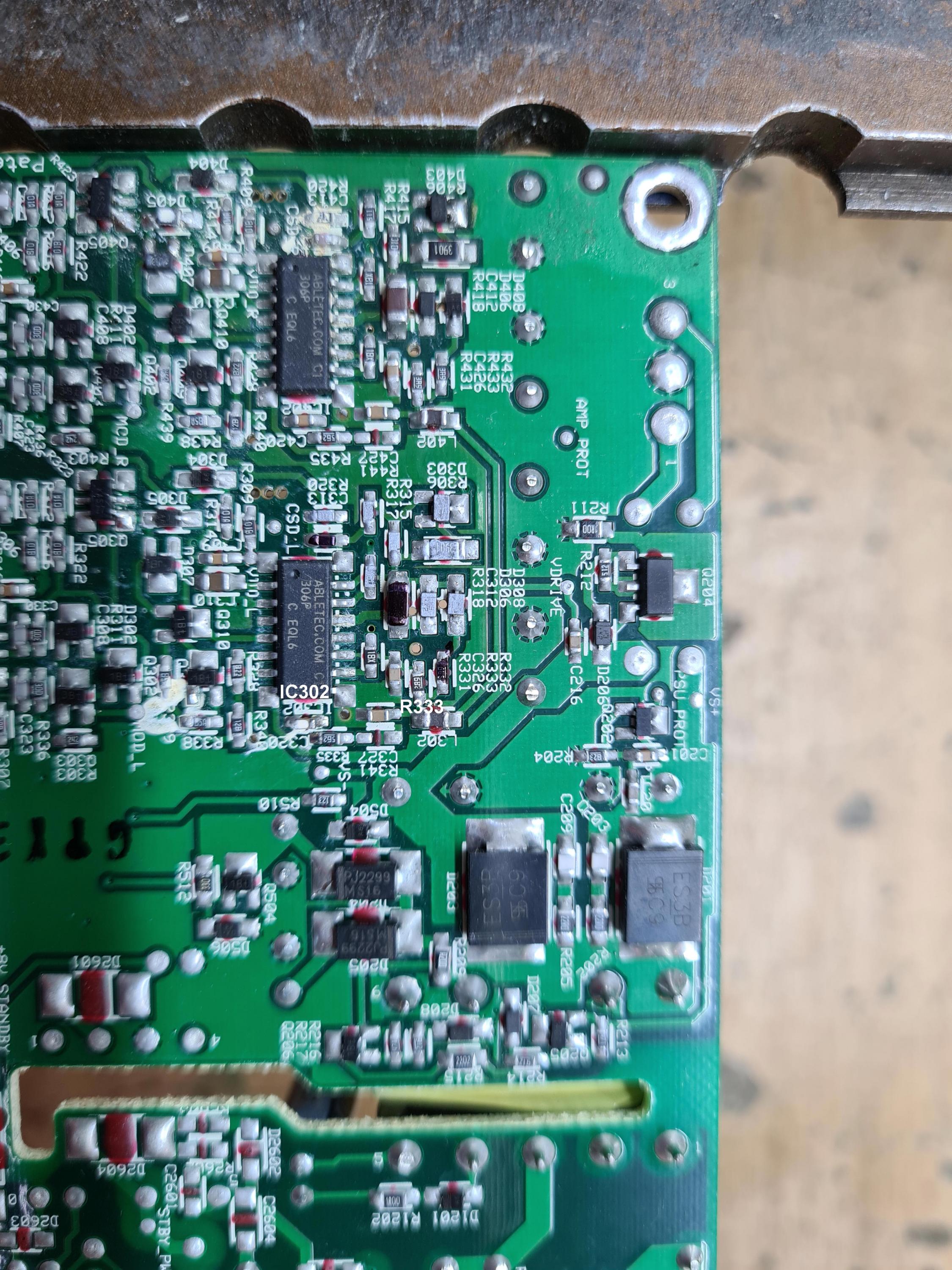

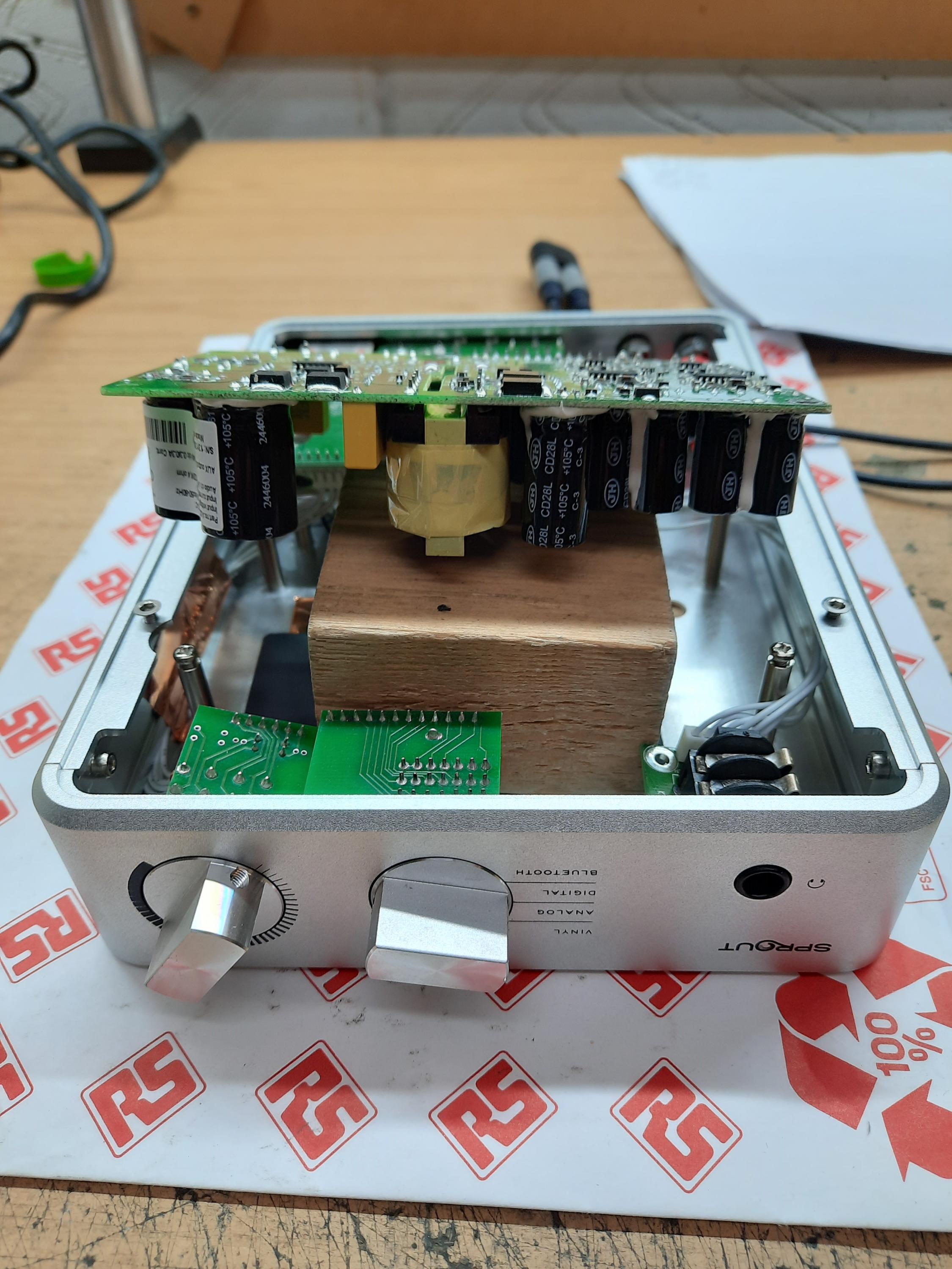

PS Audio SPR-A1 ,No audio from Right channel Can anyone help?
  • zen
    • 511
    Hi all
    Can anyone help?

      Re: Hi all No audio from Right channel Can anyone help?
      Never seen one of these before but it's a Small amp manufactured by PS Audio.
      I believe the model is SPR-A1
      Known as the Sprout.
      Apart from that i literally cannot find any other info on this thing.
        compare signals for each channel and see where it stops .. you will need data sheets for the ic.s first .
          I guess it would help if we could see the boards first place?!

            Re: PS Audio SPR-A1 ,No audio from Right channel Can anyone help?
            R333 (3R9) O/C
            Suspect it has been taken out by IC302 which i need help to identify.
            It's marked Abletec.com C1 & below that is 306P
              Swap the good IC where the bad IC was, fix the resistor and see what happens.
              Edit: plenty of abletec.com C1 on AliExpress.
                Hi,don't want to cause more damage as components around the suspected faulty chip blown.
                Ordered a chip from Ali , but not sure if the 306P marking has any significance , or is some sort of batch code.
