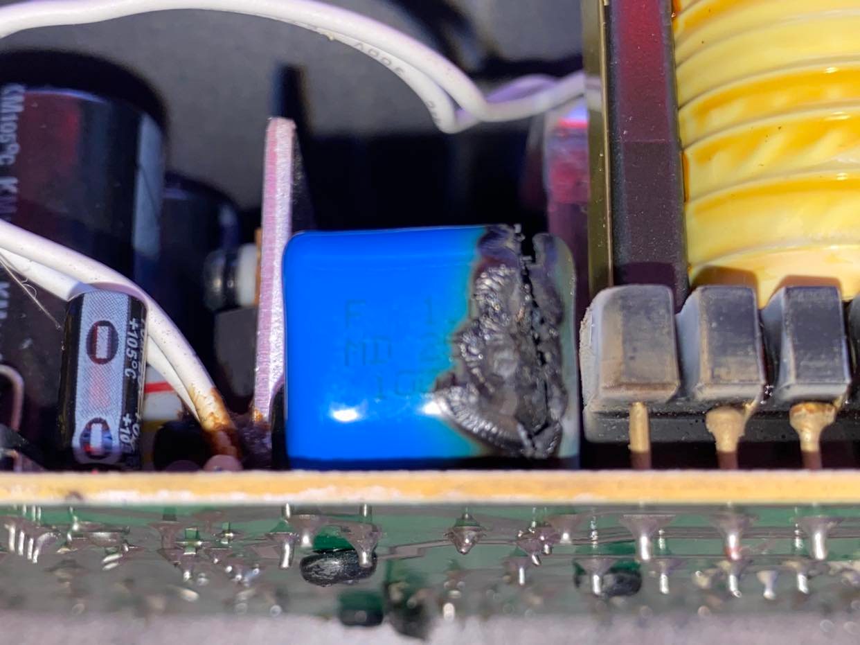

    Hi Everyone and thank you to accept me on this forum.
    I'm repairing my Velodyne Sub, a Fiber capacitor is dead but the burn erase part of the writing, can you help me to identify it ?
    I attached the picture.
    Thank you for your help.

    Re: Identification of a Capacitor for Subwoofer Velodyne
    find a schematic?
      is it carrying mains voltage ?
        A model number might be helpful.
          I can see clearly many digits , even if it's burnt , so you can at least identify them for us ?

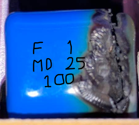

            I'm going to guess (based off the limited info here, both in the post and photo) that the capacitor in question might be a 100nf 250v cap. Though given that the original post is almost 6 months old, and didn't receive any replies until a week ago, it may not be of much use to keep probing for answers, as the user may have moved on by now
            (attached photo includes markings i could just barely make out on the capacitor)
              Pretty close to my estimation .. Millars with blue color are mostly in the range under 200-250 volts . Even some higher values are usually LIGHT blue color , which are sometimes up to 1500 volts , and bigger in size , of course .
              And yes , RukyCon , I don't see any reason why not reviving an old post for a good reason .

                Hi everyone. I have the exact same problem with the same capacitor! The model # of my subwoofer is Velodyne DLS4000R.
                See the attached photo. The blown capacitor is labelled C9. Does anyone have the same sub or maybe a schematic of this sub? I would really like to know the value of this cap so I can change it.
                  • 31255
                  make sure the replacement is class X2 rated so it doesnt burn again.
                  it's polypropylene film 250v - not sure about it being 100n
                  i see "1." - is that 1.0 or 1.8?? who knows

                    Thanks for responding so quickly, I appreciate that. For sure, I will definitely get X2 rated cap. I don't want this happen again. I ended up reaching out to Velodyne, and they confirmed the capacitor is 1.0uF 250V. Thanks again for your help!
