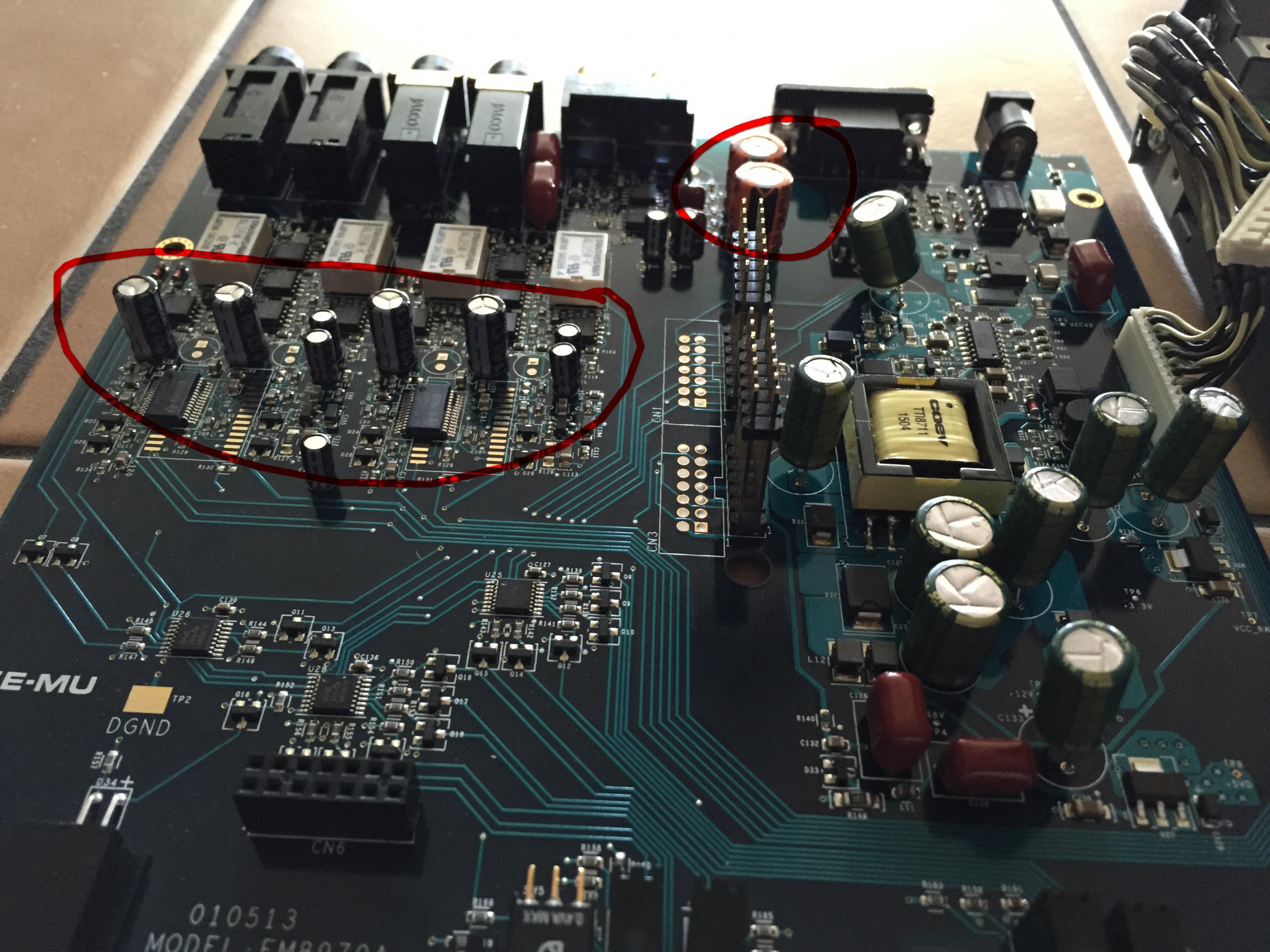

        Thks for your feedback. I was trying to put pics up of my soundcard with new caps but I'm on my iPhone so can't get to upload. I don't have a scope but all but 1 capacitor I managed to get audio quality which I think was fitted in the power supply area. So I need to change power supply to low ESR. Is there anyone in the UK who would repair this for me???
        I have limited knowledge about electrics,bought the capacitors from digikey all are correct values but when choosing selected audio use and just bought the most expensive ones that would fit.
        I have emailed a few audio repair places but no one has replied back. I have 2x external docks and probably wAnt both repaired.

          #64
          Re: EMU 1820M not working properly
          They will work for now, but in a switchmode DC\DC converter or whatever this thing has, audio grade capacitors will not last long. Of course, audio grade capacitors would be great in the actual audio circuitry, you don't need to change those ones.
          But, the wrong capacitors are probably not the cause of one channel being quieter than the others. If you changed any capacitors in the signal path, though, you may have caused a problem if you have a bad solder joint somewhere for example.
          Put up some photos of your soldering, what you changed including what was there and what you changed them to.
          -David VanHorn

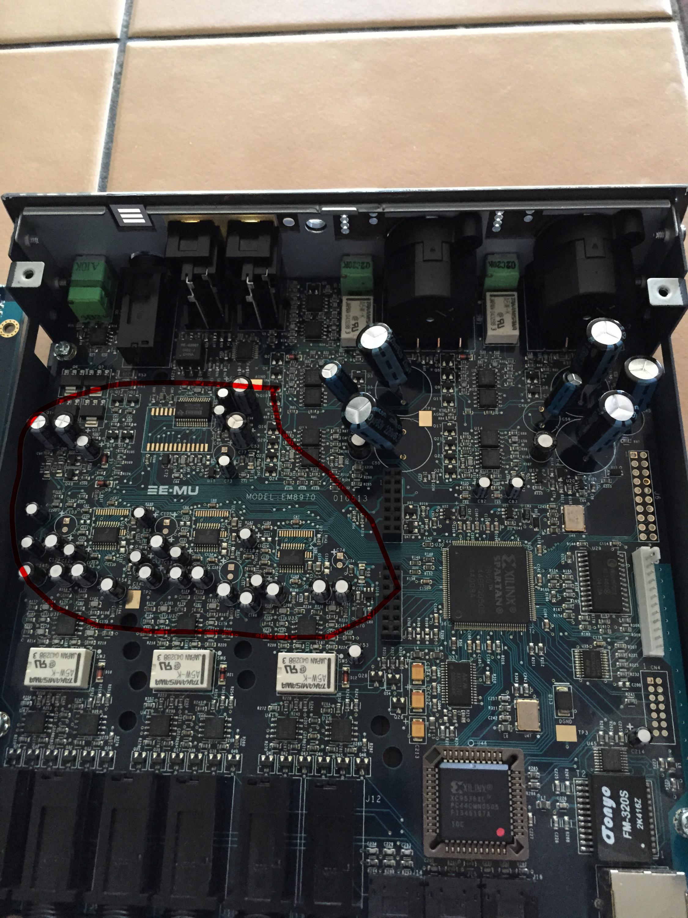

              I have a Card Bus 1616 with the Breakout box and have got this Crack and pops & clicks for a while. Later it became worse but it doesn't show up right away. When it was at its worst I had to shut it down but trying turning it on just lit all the light and never went online again and it had to be off for like 20+ min. Then I could start it again.
              I have replaced all in the power circuit except to yellow ones due I got the wrong voltage for some reason. So I have to order new ones but the question is, Should I even change these many small ones to?
              My error before was like if I had a TRS cable connected on one of the inputs it didn't start, but if I removed it, it would start.
              After changing these caps it now have become better, even if it clicks sometimes I can shut it off and on again. (yay?) either way. Suggestion? I know I have some Jamicon caps but that's what I got from the dealer. They should be okay for a while.

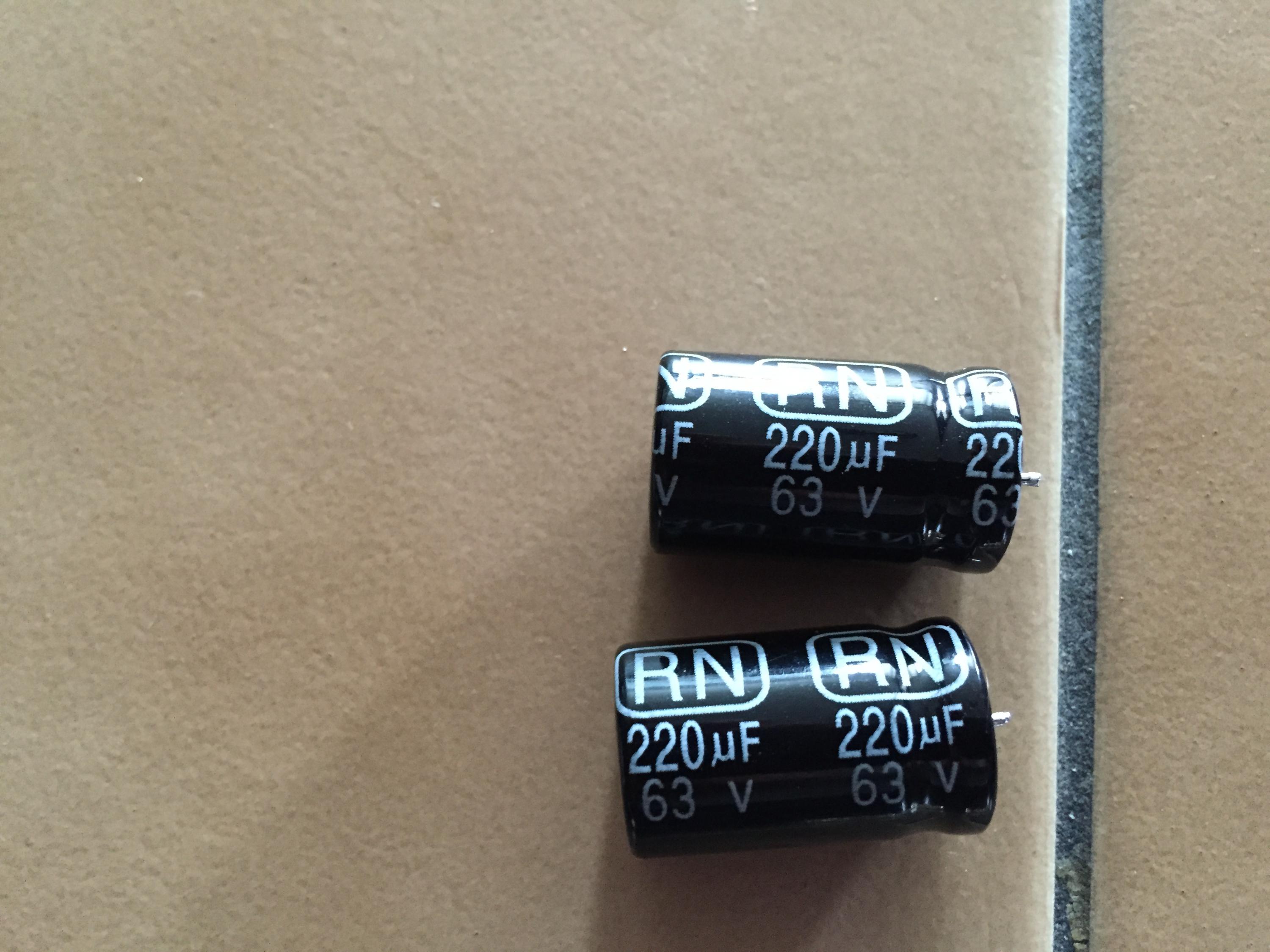

              Funny is those RN Caps on picture three. They didn't have any polarity marking but I put my new ones as the rest. Perhaps I messed up with the parts ? Those I got was considerably smaller than the original but I know that caps get smaller and better? The 4x RN Caps were sitting in picture two top right.
              Best Regards Jonas
              EDIT : I just realize I put Polar caps instead of Bi-polar caps at the Mic Preamp. Need to change that.
