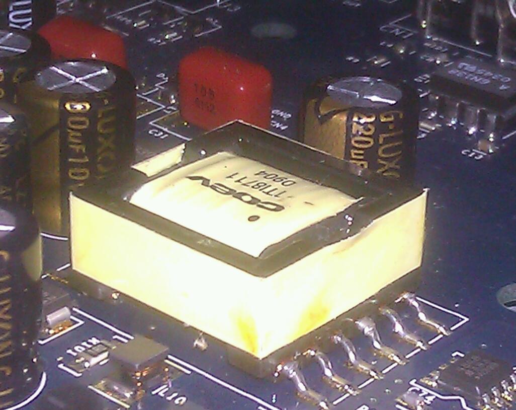

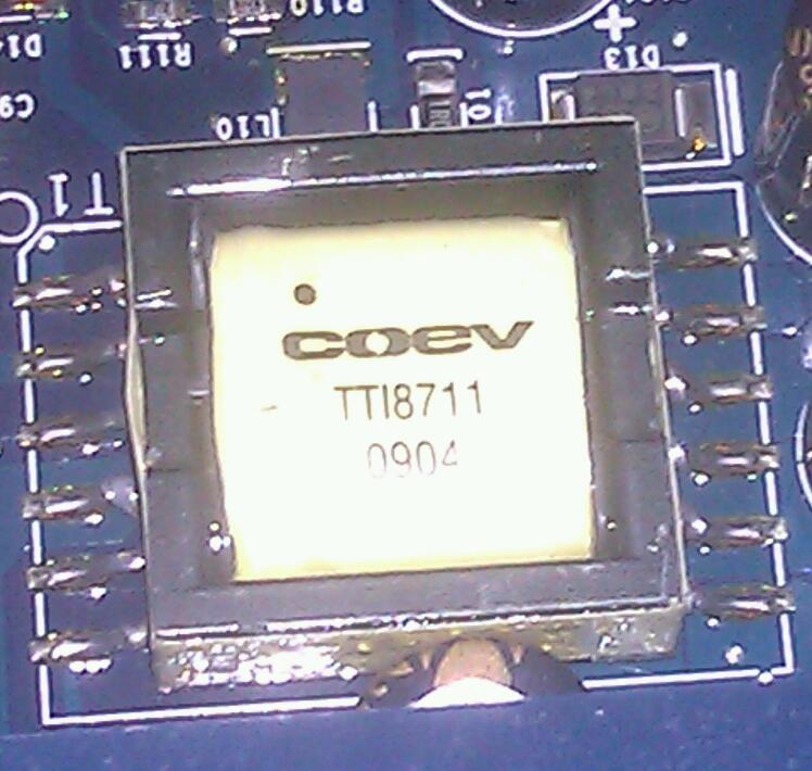

    Here are some cropped pics. I have located a few websites who sell model # TTl8724 but not what I need (TTl8711) They seem really similar as far as model numbers go but I am not sure if it will be ok.
    Any thoughts?
      Re: EMU 1820M not working properly
      That's a transformer, specifically part of a DC/DC converter.
      The discolouring is normal, it is probably varnish or glue that has dried up from heat.
      Given that this thing has a Xilinx Spartan FPGA and a Xilinx CPLD (expensive chips!), it doesn't look cheap, and yet they used cheap crap capacitors... Ugh! I wonder if it is genuine incompetence, or cost cutting?
        Interesting. So perhaps attempting to replace the G Luxon caps should be my first step then...

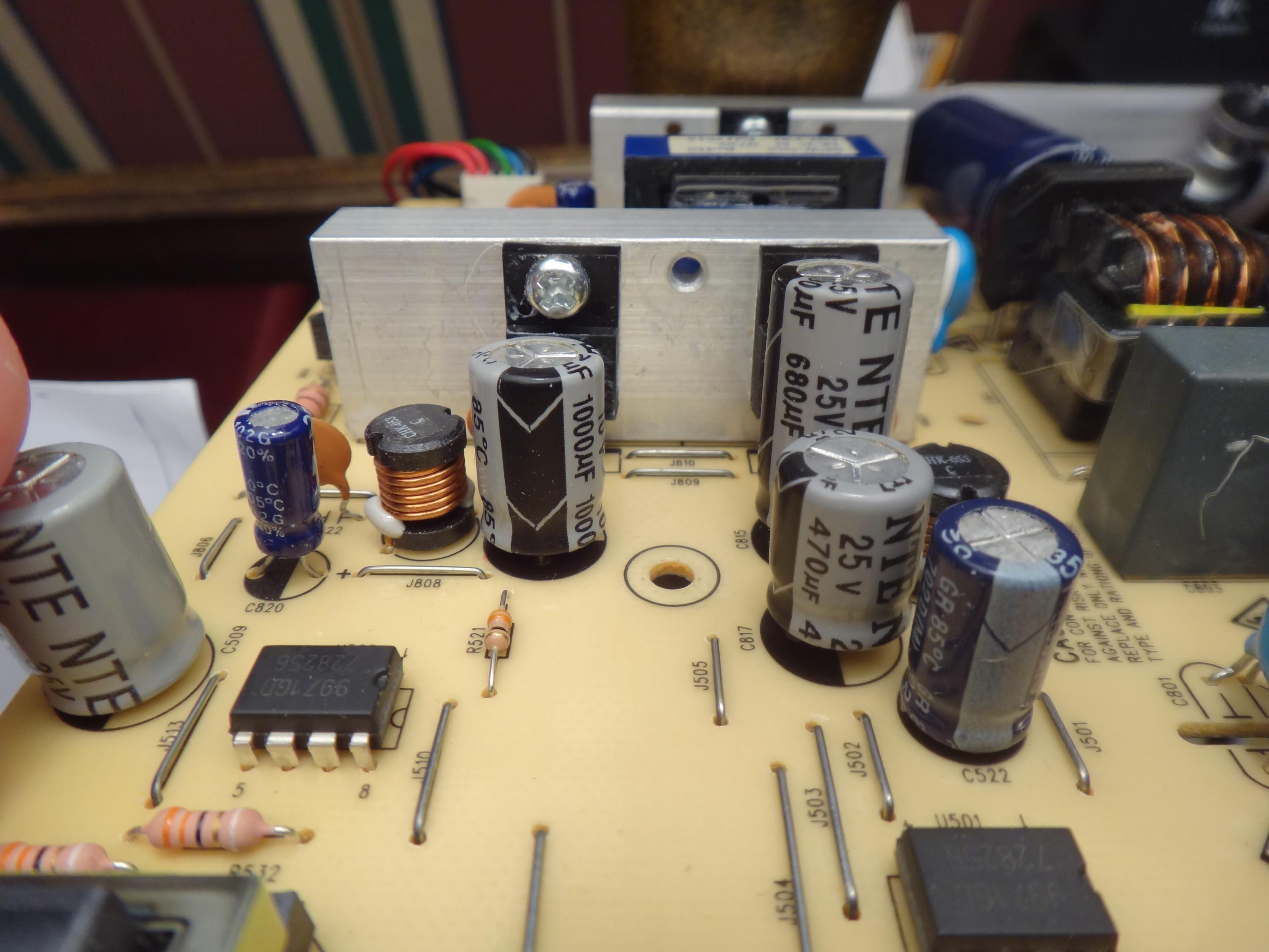

                Anyone heard of NTE caps?
                  I used to use their transistors and diode substitutes from them, they do not actually make parts, they will get the supplies from someone else and put their own numbers on them with the spec that matches the original parts, they spend a lot of time coming up with substitute part lists. I have no idea who actually make the caps for them. I myself use nothing but PANASONIC caps from DIGIKEY, FM/FR series fro switching power supplies or any circuits that need low ESR, EB series for general purpose caps. Digikey also has $2.50 shipping charge for small quantity using USPS.
                    The Component marked as "coev, TTl8711" is a transformer

                        #31
                        Those NTE are rebadged G-Luxon or Teapos, from the vent.
