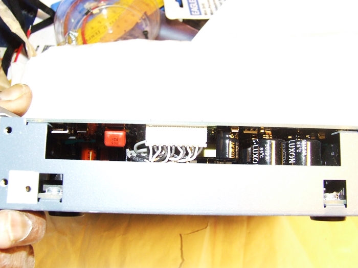

                        #51
                        Re: EMU 1820M not working properly

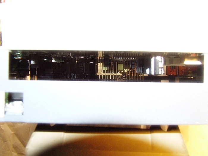

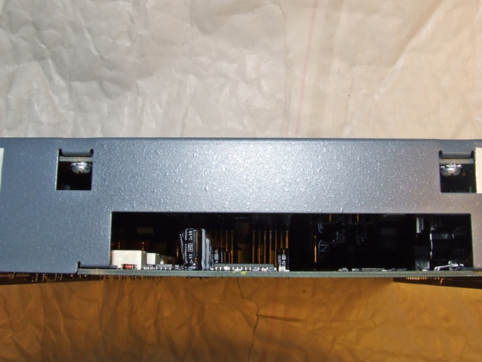

                        Hi All,
                        I just registered myself after finding this forum to my great delight! It was indeed indeed very comforting to know that many haven't given up on there EMUs & still continue using it.
                        I recently bought,unwittingly I must add, a nearly new 1616m cardbus version.The unit looks quite new & unused. Then I decided to change all the caps once & for all before start using it. However, I came upon a rather unusual problem!
                        I am unable to diassemble it for the life of me! The problem is that unlike all the other models, this particular unit has 2 pcbs which are mounted back to back or rather front to front as you may be able to see on the photographs.I removed the top lid easily, but the bottom plate wouldn't budge & I'm unable to remove either of these boards!
                        Have any one of you successfully opened up this unit? If so please help! I am so near yet so far!
                        Thanks.

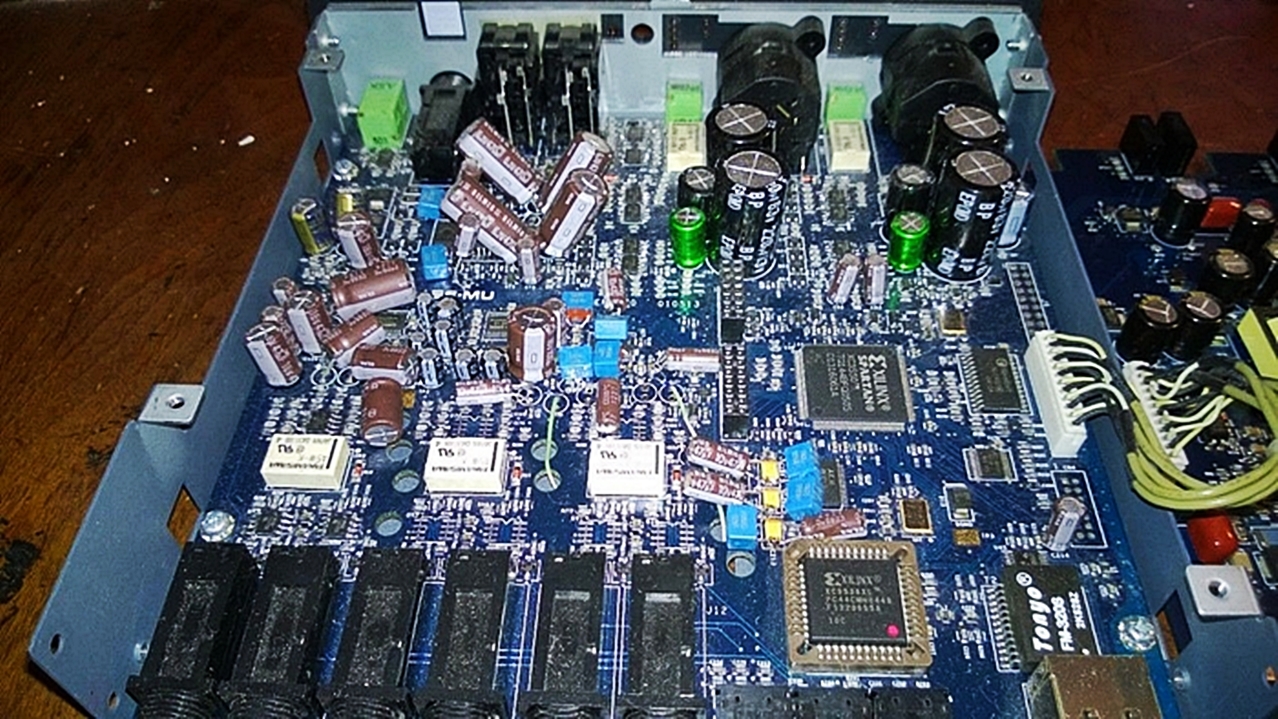

                          #52

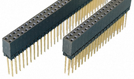

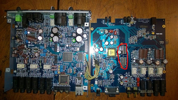

                          Looks like those multi-way connectors in the middle of the board in image 3 may be soldered on both ends, holding the boards together. If that is the case you would have to desolder them first to separate the boards.

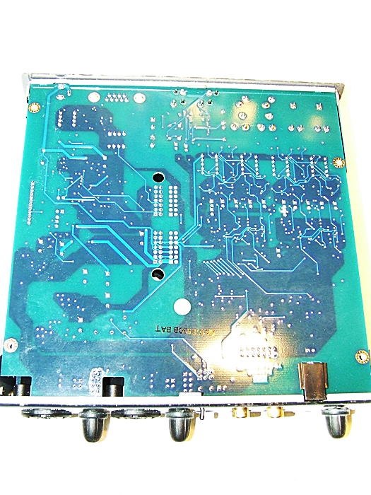

                            #53
                            Thanks! The bottom part of the casing is U shaped with both the front & back panels seem to deattachable, but these have plexi glass in addition! All the sockets & controls are soldered on to the pcbs. However. I tried to pull the 3 volume knobs to no avail! Although these socketed pins are soldered on to their repective boards & connected via the male/female sockets. So I fear that it would be impossible to realign these once/if unsoldered!
                            I searched for the service manual without success! They must have assembled this in a sequence, so I should follow the reverse of this shouldn't I? If only I knew how to lift the top pcb, then I'd have access to the bottom board as well.
                            Perhaps anyone who has done this on a 1616m cardbus can help?

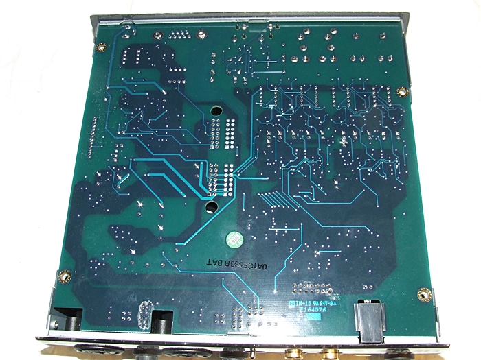

                              #54

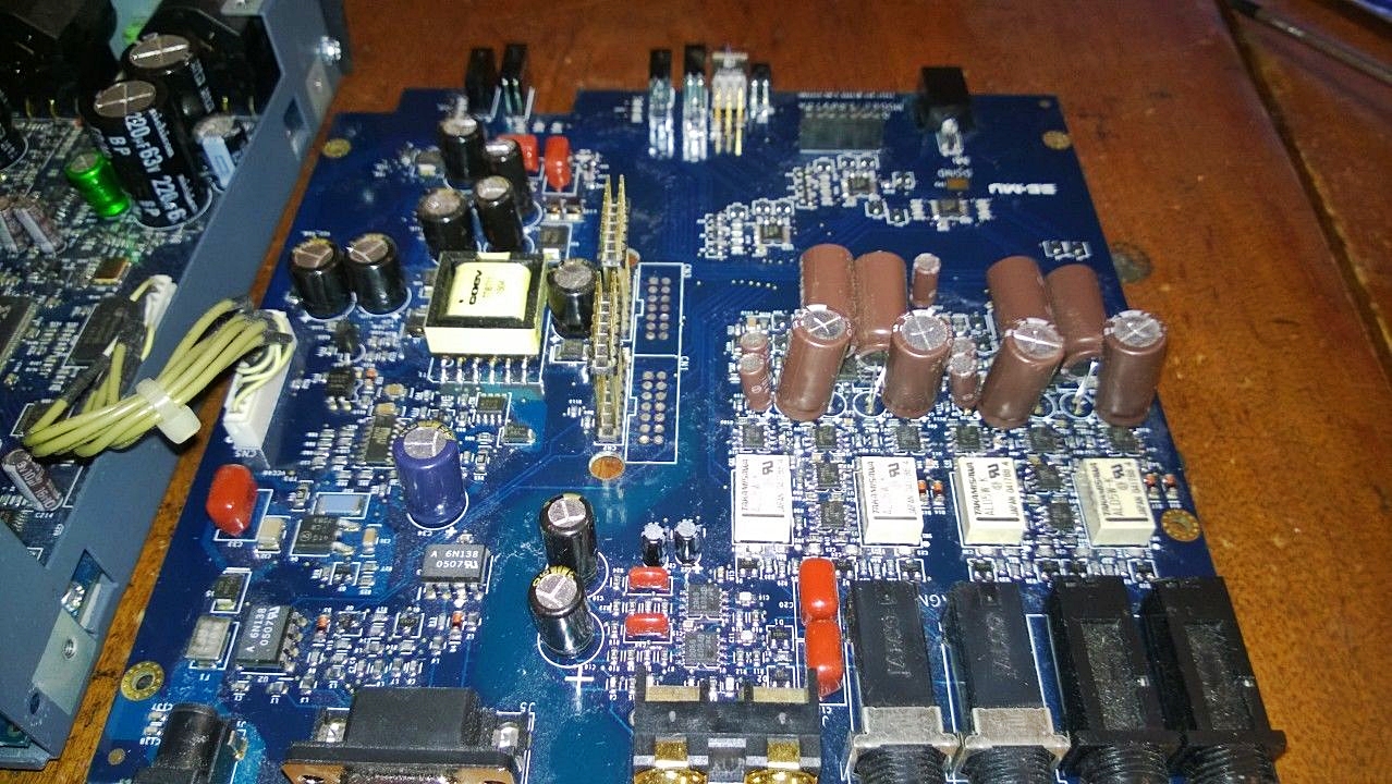

                              I had a closer look at my unit & see these pins are actually going into sockets on both boards! I had only access to to the top back side of the pcb & can see the socket soldered on to it, & not the pins!
                              I just found these photos taken by another modder & it looks like he had actually desoldered or cut/bent these pins! Rather confusing!

                                #55
                                It looks to me like there is a socket on the bottom and very long pins on the top. I can't see sockets on both. But that is good news, as long as there is a socket somewhere, you should be fine.
                                What I do see though is that from his photos there is one of the panels removed. It looks like you have to unscrew the two screws from the MIDI connector and the GND screw next to it, before you can remove the top PCB.

                                  Thanks,I will do that as you've suggested. I could be wrong w.r,t sockets on both boards. It's quite difficult to get a good view of the lower board!
