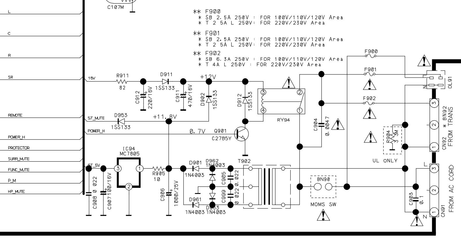

          I have attached a small snapshot of the schematic from the service manual that what I thnk is the revelant part. It is RY94. It is the only relay listed on the part list of the service manual.

              Okay, I realize now maybe I should have described the problem in detail and then ask if the relay is at fault. Sorry, my bad for jumping ahead.
              So let me start over.
              I purchased a non working Harman Kardon AVR 125 receiver to learn more about electronics.
              When I hit the power button, it should make the standby LED go amber. Then if it I hit the standby button or hit remote power on button, the relay should click and the AVR should be operational (the standby LED should be green).
              What actually happens is this. I hit the power button and the standby LED is green and the entire front panel is list, but not operational (no sound if I hookup speakers - none of the buttons work to change settings). When I hit the standby button or hit the remote power on, there is no relay click.
              There are 5 fuses and all check okay (0.3 ohm or less). I have verified there is main power going to the main PCB by plugging something into the back of the AVR 120V outlet.
              I see there is a standby transformer (T902) on the main PCB. I believe this is for the remote control and standby power.

                If I'm reading the schematic correctly the only thing that relay does is switch the rear switched AC outlet on. So the fact that it's not clicking is the symptom of a bigger problem.

                      Re: SDT-S-112DMR relay - where to buy in qty = 1
                      that relay turns on the primary of the main power transformer and the accy outlet.
                      and it may be bad.see if q901 is switching.

                        • arrudi
                          • Jun 2010
                          • 8
                          Hallo,
                          according to the turn on Procedure, You should check, that the relay contacts are defenitly open.
                          Turn on MOMS switch only, measure that there is no AC Voltage at F901 and F902.
                          If there is any, then You have a problem with the relay contacts (sticked together).
                          Reason: acc. page 22 only the ST +5V (Standby 5V) should be present.
                          The system should be in Standby with amber light on.
                          Now press the "System Power Control" switch. Normally this will actuate the relay and applies power to the main transformer.
                          Q901 operates the relay. The controlling signal is named Power_H.
                          See page 77 and page 79 to trace the signal. It comes via BN80 and CN80 from the IC72(96).
                          The System Power Control switch S701 connects to IC72(38), Signal named Key_1. It connects via BN88 and CN88 to S701.
                          Good luck!

                          • retiredcaps
                            • Apr 2010
                            • 9271
                            Thank you for the suggestions and your english is better than most who are born in North America.
                            The AVR has very tight spacing and getting DMM probes to F901 and F902 is nowhere near as nice as shown on page 22. The chances of probes slipping with live AC is very high and I would rather not take that chance.
                            My plan is to take apart everything later on and test the relay and Q901 out of circuit (if possible).

                            • arrudi
                              • Jun 2010
                              • 8
                              Hallo,
                              sorry, I overlooked something.
                              Just measure the AC voltage in the switched rear outlet.
                              Have a nice sunday.
                              • retiredcaps
                                • Apr 2010
                                • 9271
                                I don't have to measure anything there. I already plugged a 120V device into the back of the rear switch outlet and there is definitely power when I press the MOMS switch.
                                    Is it just me or are there two Q901s in this weird amp?!? There's a regulator Q901 (2SA1271Y, page 73, -30V for the display) and the relay transistor Q901 (2SC2785Y, page 76) that switches RY94 (main power) on. Kinda split personality or something.
                                    • kc8adu
                                      • Nov 2003
                                      • 8832
                                      • U.S.A!
                                      2 different boards with reuse of designations.
                                        I think, You got a bad relay. There should not be any AC at the rear switched outlet, when only the MOMS switch is on.
                                        Turn power off, tap the relay a couple of times, may be the sticked contacts opens.
