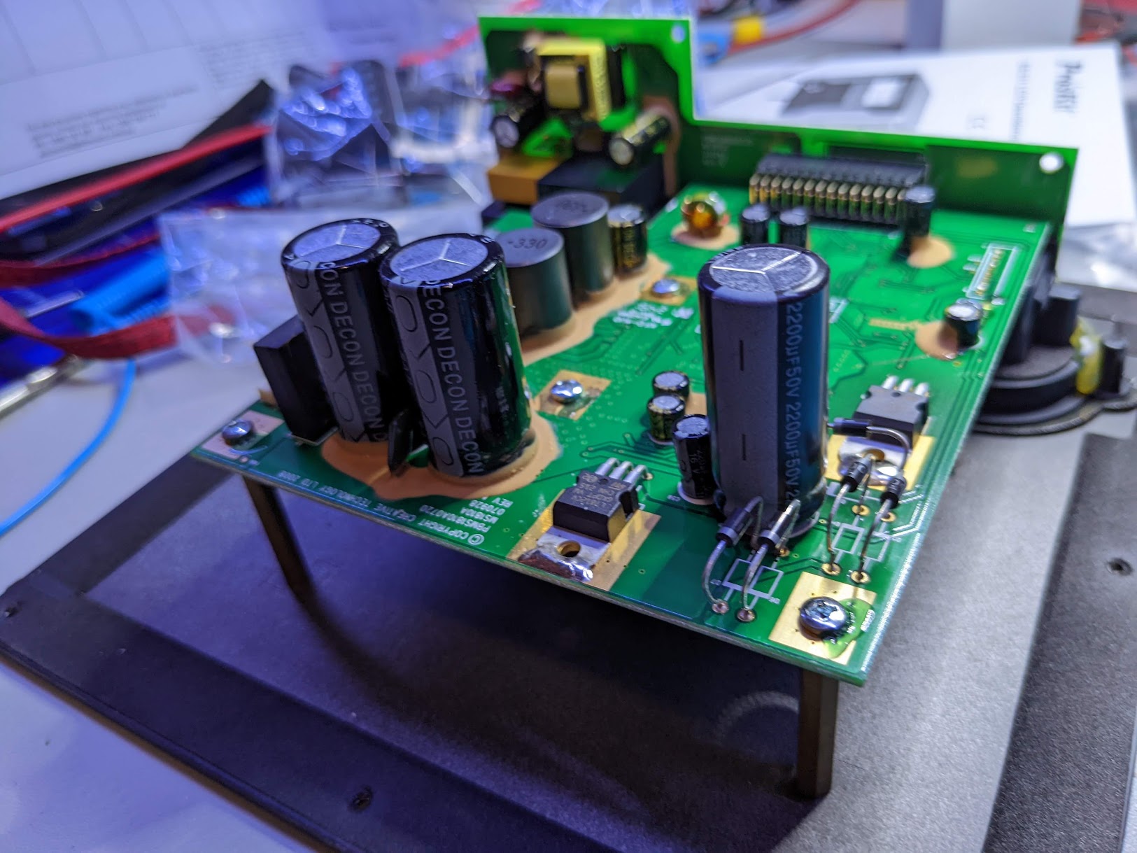

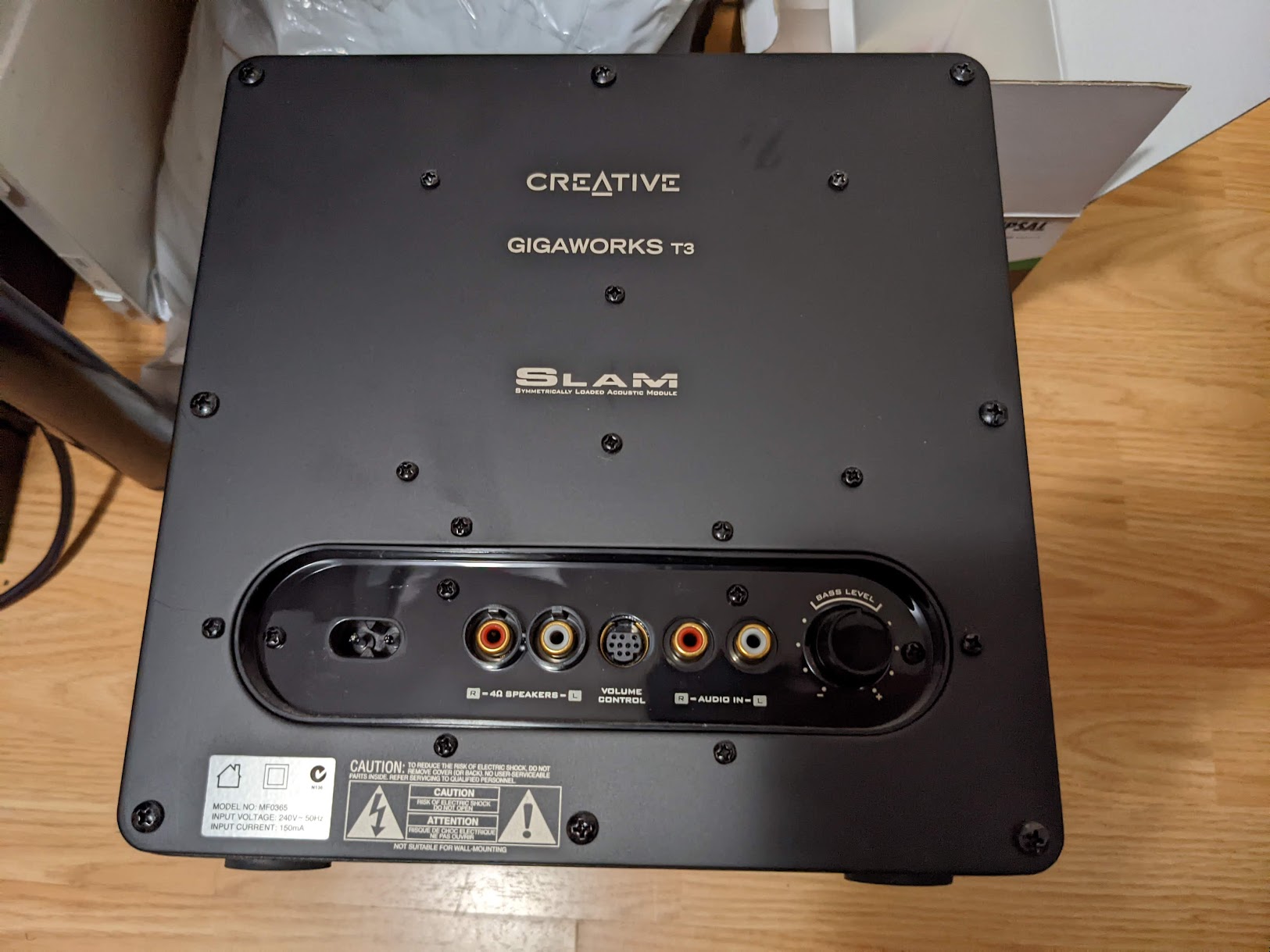

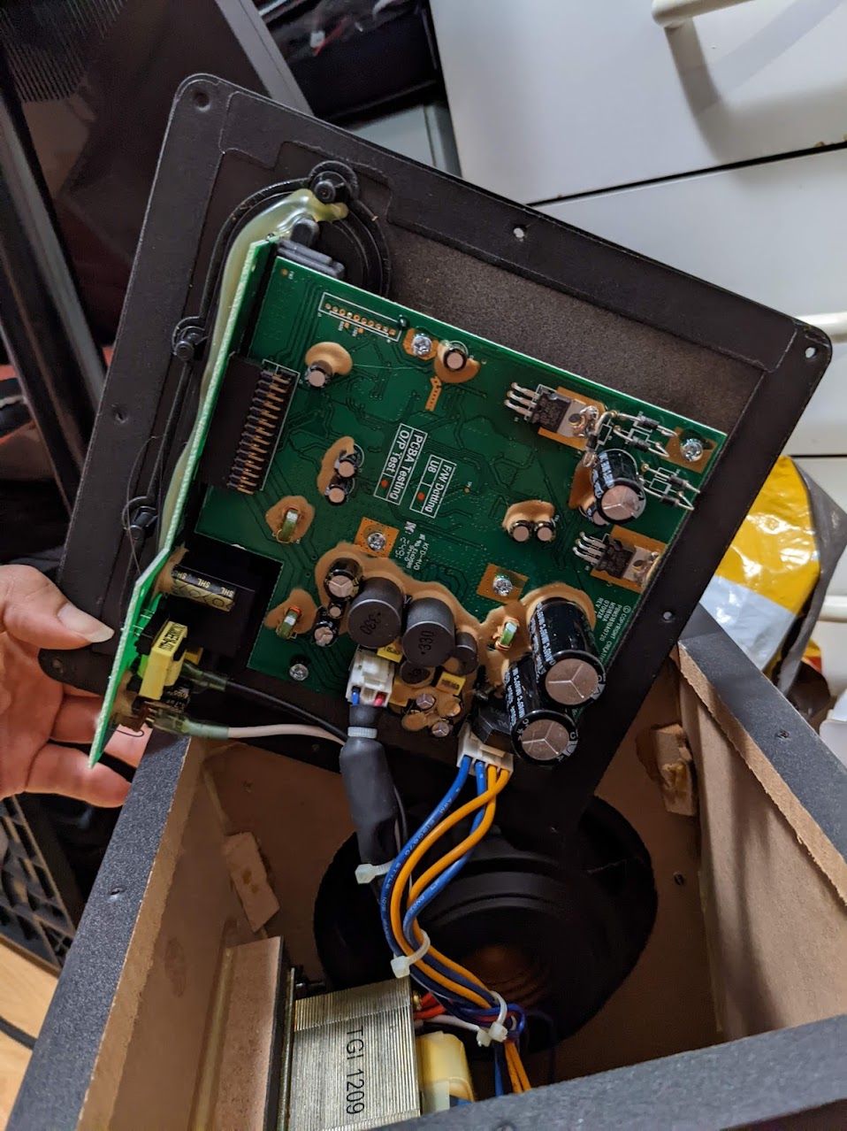

    The Creative GigaWorks T3 2.1-Channel Speakers keeps turning on and off in a loop.
    open it up, and there was a swollen Decon SAII 2200uF 25V 85°C Capacitor in it. (the one on top right, next to the diodes)
    replaced it with a 2200uF 50V 105°C Cap (just because this is what i had on hand, and there was space for it) , and it is back up and running.
