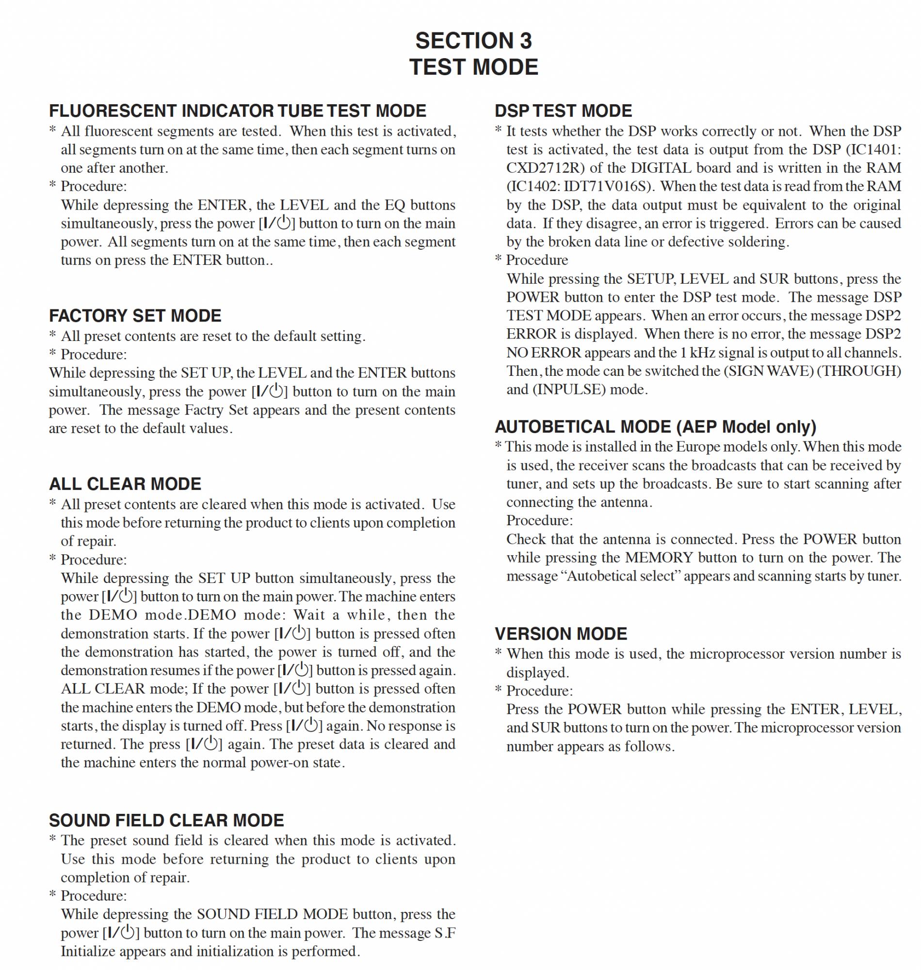

    Sony STR-DE635 EQ mutes everything
    I got this thing for free, it has a problem with the Equalitzer-function: it mutes the sound. The previous owner's kid pushed the buttons in random order and the problem appeared. I have done the factory reset, but it did not help.
  • Jolly62
    • Nov 2021
    • 13
    • Italy
    Re: Sony STR-DE635 EQ mutes everything
    If the Factory reset didn't solve the issue it may be a DSP issue.
    Try the DSP TEST MODE.
