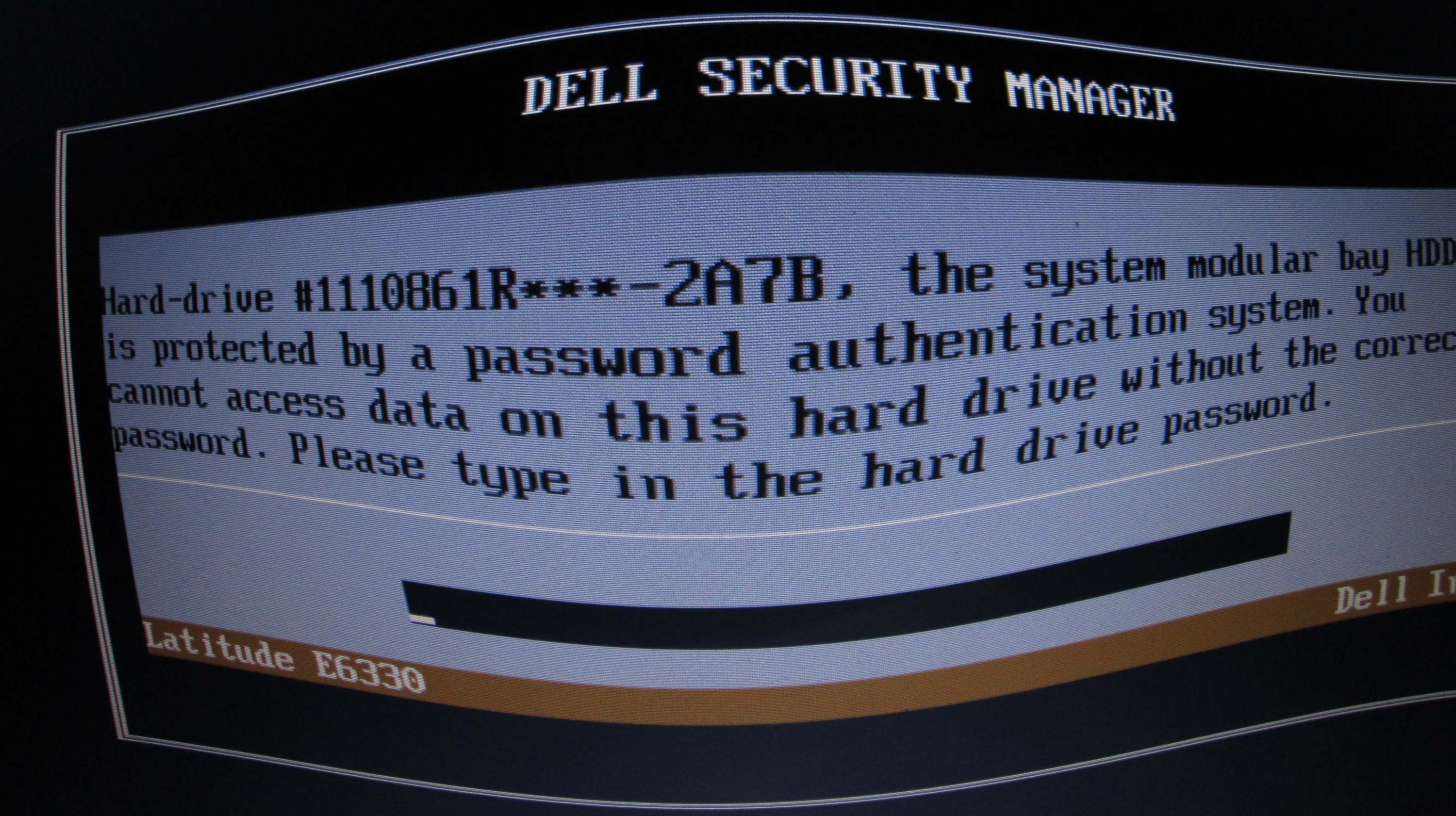

    Some Googling made this seem straightforward, but it ain't necessarily so:

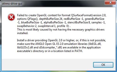

    First try was Hynix Drive Manager, supposed to be able to do PSID reset
    In Win7 x86 context, what shoddy software – this greeted me first time I clicked it from Start menu:
    After wild goose chase triggered by the OpenGL bit, I tried swapping graphics cards until penny dropped when it still objected to a Radeon HD3450
    How I got it work:
    1. Command prompt
    2. Change to install directory \Program Files\SK Hynix Drive Manager
    3. Copy d3dcompiler_47.dll taken from \Program Files\Mozilla Firefox of a Win10 x86 machine
    4. Run skhms-drive-gui.exe
    To be fair, in Win10 environment, the POS does run without issue

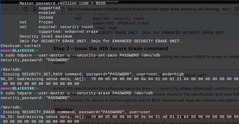

    Then I started chasing down various HDPARM rabbit holes on the Internet

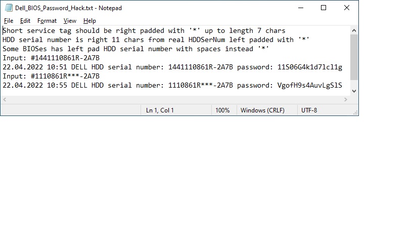

    It soon became apparent that Dell's password algorithm is much more sophisticated than leaving a default value for master password
    Next try was a couple of Dell password generators, both originating from hpgl, Russia
    Unfortunately they didn't work either:
    So now I'm SOL unless I can get a Dell password that works for the SC210

    Re: Wasting life trying to reset/erase Hynix SC210 to factory default
    Use hdparm to send the drive an ATA_SECURE_ERASE command. This not only wipes the drive, destroying all data on it, but also clears the password on the drive.
      If only it was that simple ...

          Sata connector usually used by DVD drive
          Dell BIOS seems to accommodate that alright - note in 2nd last pic, message says "system modular bay HDD is protected by a password"
