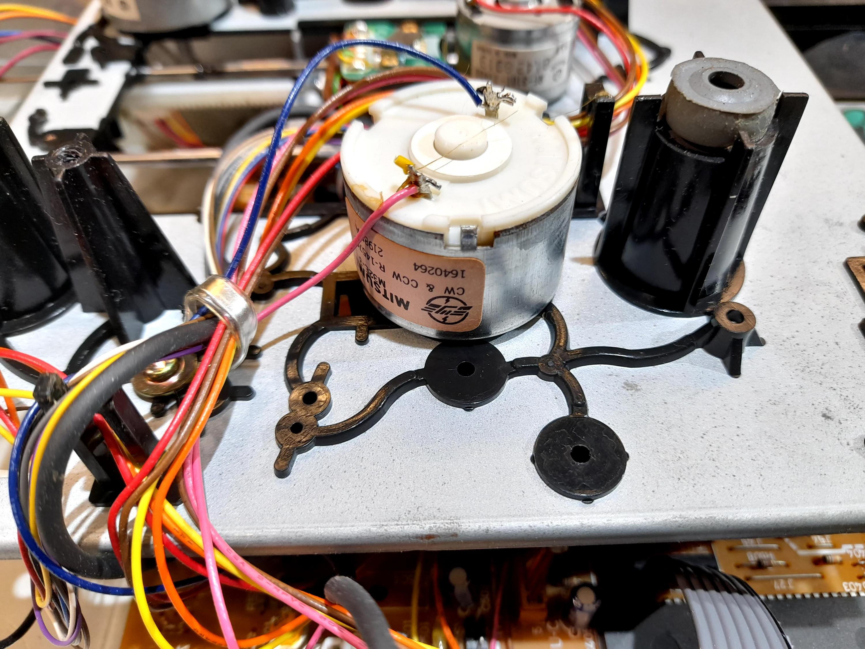

          Re: Mitsumi M32E-3 CD tray motor
          The full number is laid out like this:
          Mitsumi M32E-3
          CW + CCW R-145767
          1640264 2198DA

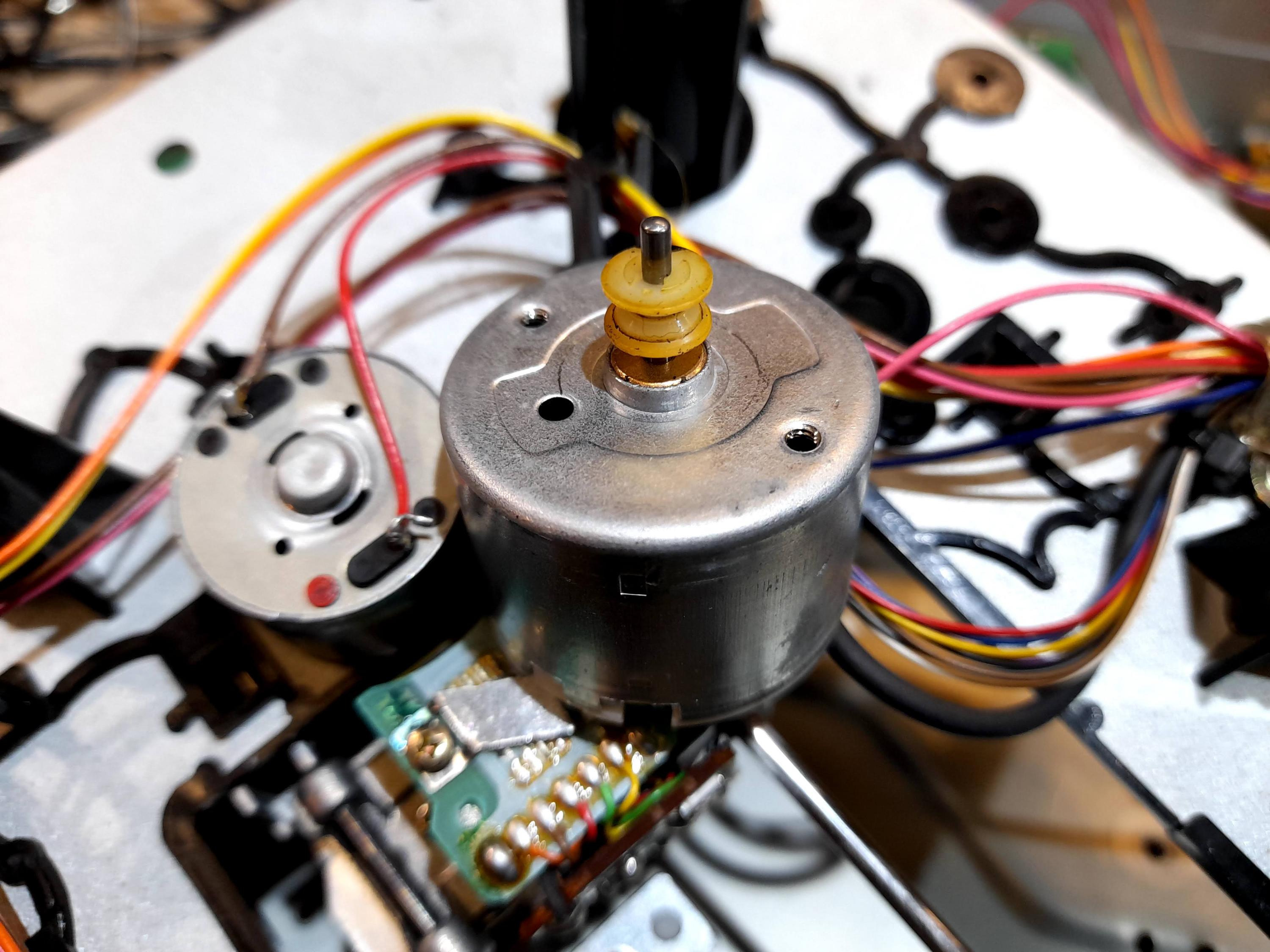

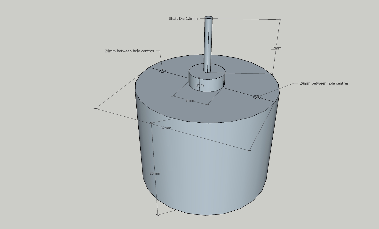

                  Sorry for the delay. Here are some pictures of the motor.
                  Without measuring them, I'd guess the threaded screw holes are M3
                    looks like a pretty standard motor . you want want that can go both ways . i cant imagine your one is actually worn out .might just need cleaning inside .. take it you have tested it ?
                      It does seem odd that it's bad as it is just for the tray, hook a 9v battery to it and give it a spin, if it runs, run it for a while to clean the brushes. The screws will likely be M2.6 x 0.45
                              On this type of motor you need to assemble the brush end to the armature then slide it into the motor housing. its a pain but should work.
                              On some motors (like the other one in the picture) there are holes in the plate to insert pins to hold the brushes away from the commutator as you reassemble it, then you remove the pins and the brushes snap into place.
