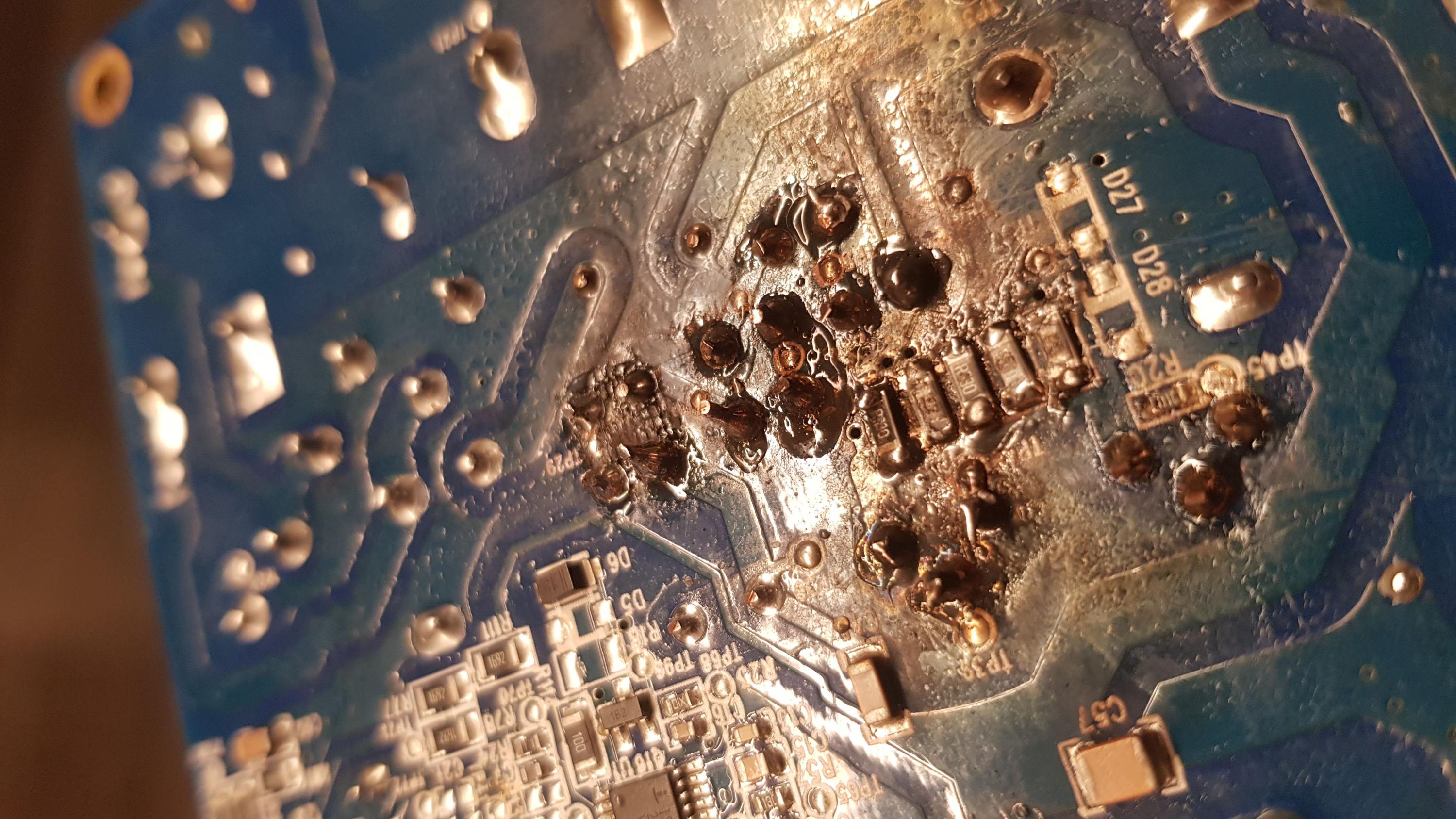

    Hello dear Badcaps users.

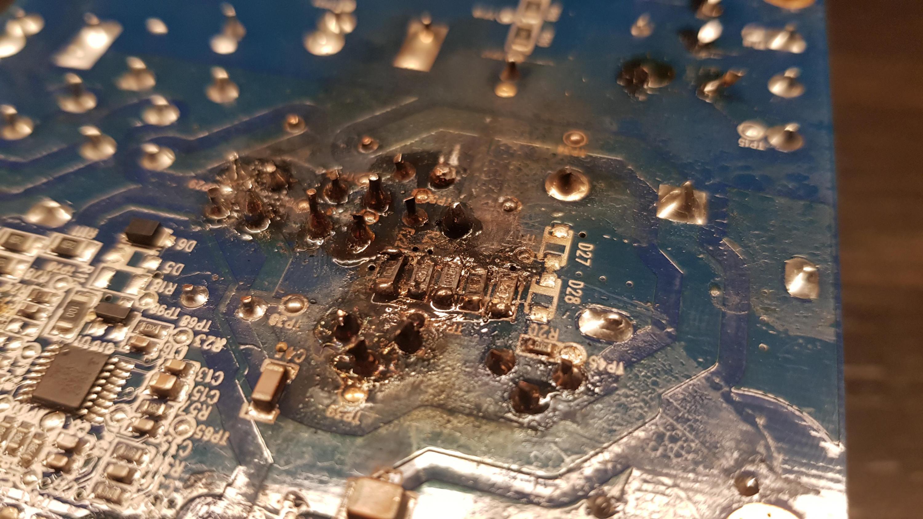

    I recently bought a broken Sub. After opening i saw those burnt ?resistors?
    One small SMD on the back got lost...
    Do you guys thinks its possible to repair the Sub?
    Unfortunately i dont have any clue what parts i have to order :/
    Hope someone can help me out.
    Greetings, Alex

    the board is o.k. so if you can find out what the parts where you could fix it.
    that and maybe find out why it happened.
    if this is common then some "upgrading" will be wise.

      Does anyone have a schematic or something like that... the parts where totally burnt... so cant read what they have been. Dont think it's a common problem, because I couldn't find any thread about this issue.
      Maybe somebody can have a look at a complete board?

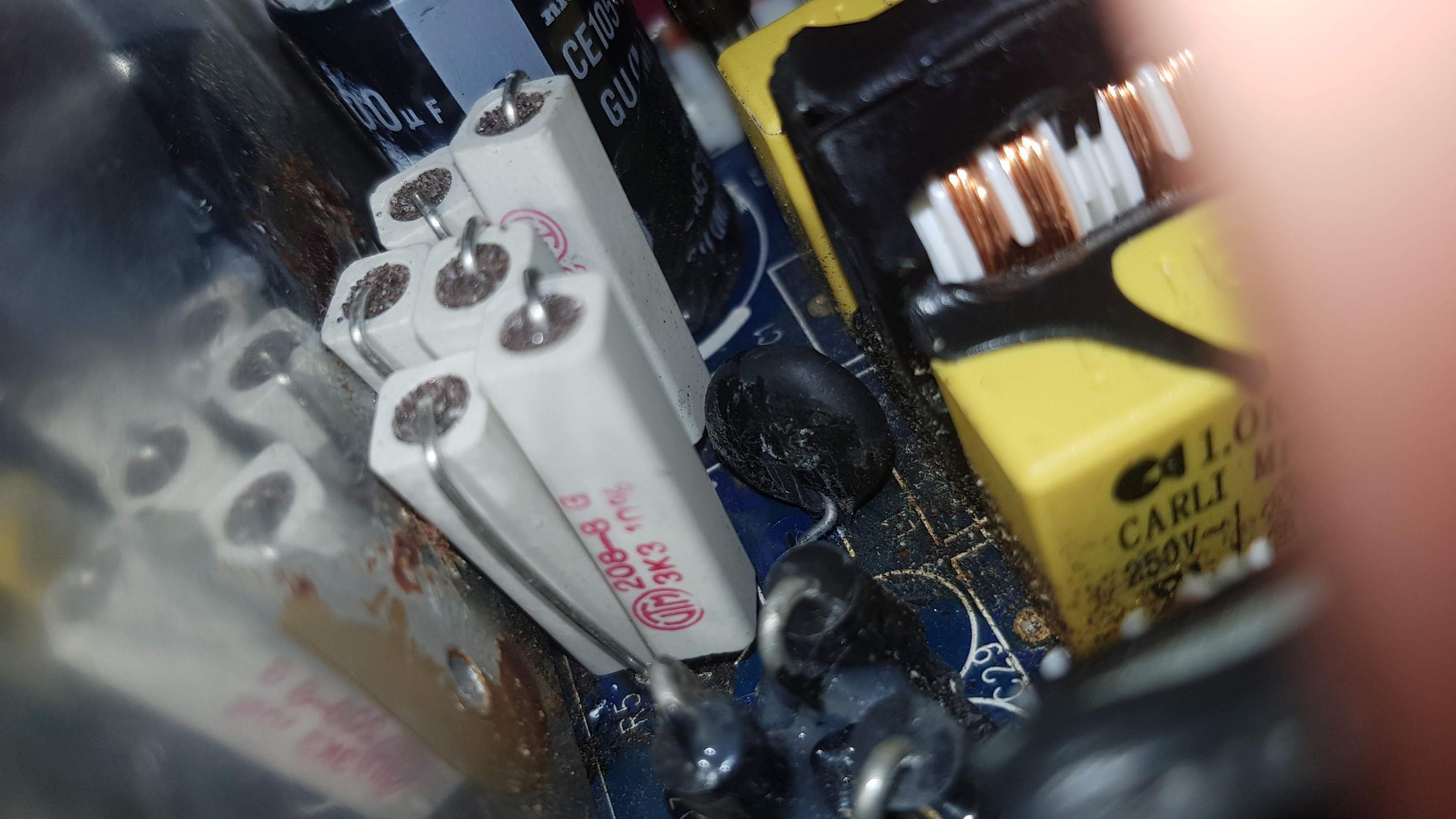

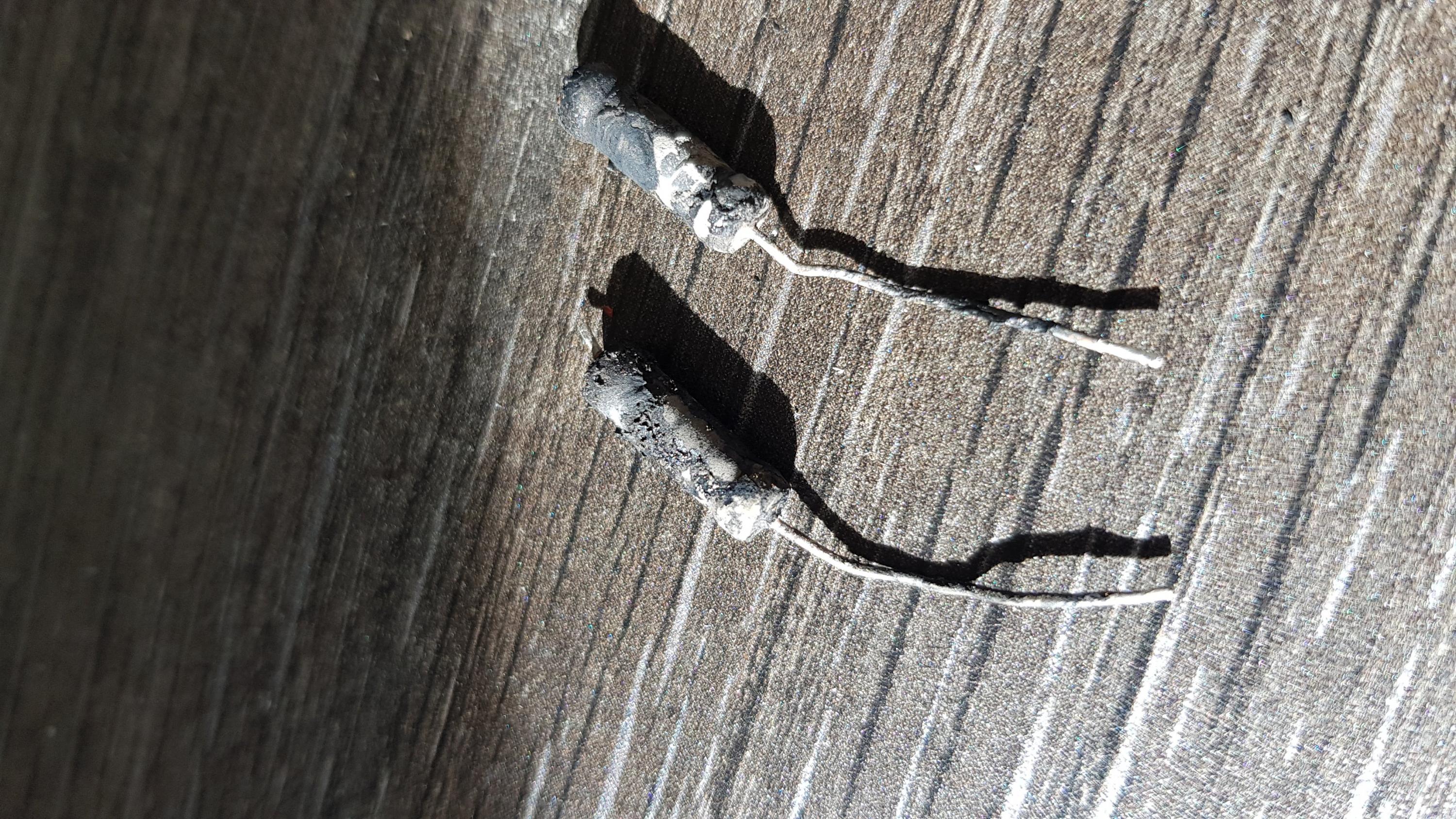

          Re: Logitech Z906 Power Supply
          The smd resistors have a bigger value than 0.33 ohm... more than 1M Ohm.. do I need to change them all? And is there a chance that It will work after changing after all those resistors... no idea what caused the shortcut...
            • 31017
            R030 isnt it?
            30milliohms
            so 5 in parallel = 6milliohms or 0.006ohms!
            maybe thats the problem, not able to handle the current.
            maybe fitting a physically bigger current-shunt inplace of those will help

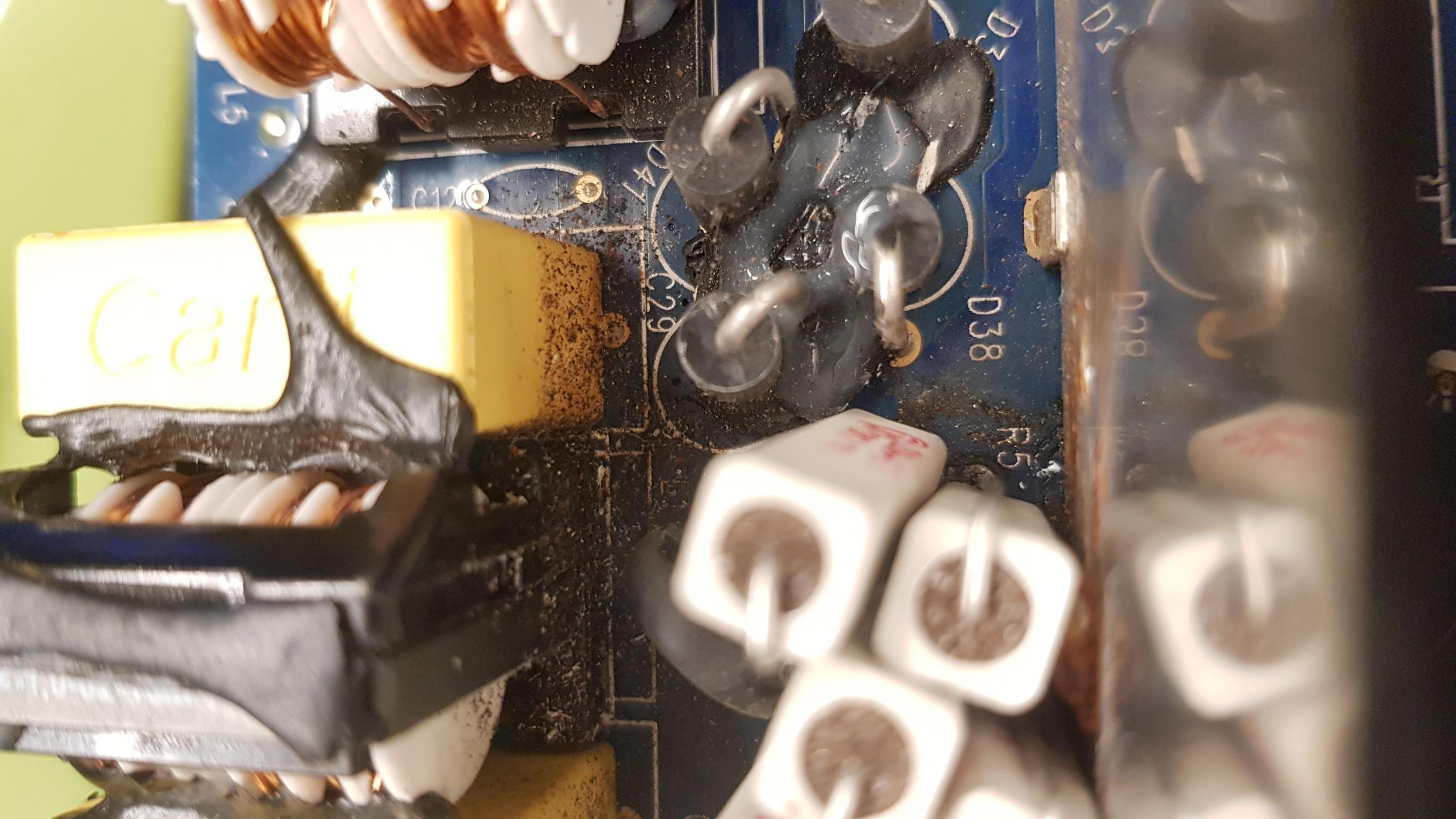

              Good pictures of the burnt resistor here - https://imgur.com/a/xPmqG
              R22 is the same as R21.
                • 31017
                ok.
                so .33ohms x5
                0.066ohms

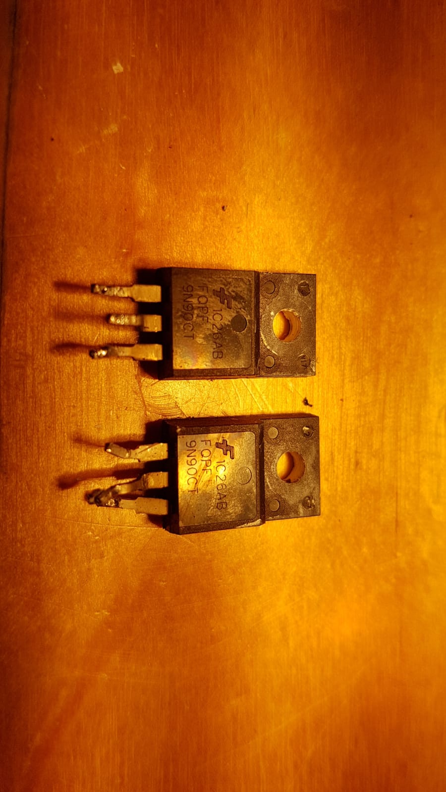

                  Those two guys also seem to be dead... i couldn't find the exactly same value to order (googled it) does anybody know what I should order?
                    • 31017
                    https://www.onsemi.com/products/disc...fets/fqpf9n90c
                    • storexxm
                      • Oct 2012
                      • 107
                      • Vienna
                      Thank you stj. I will try those
                        • 31017
                        those are what you have in the foto

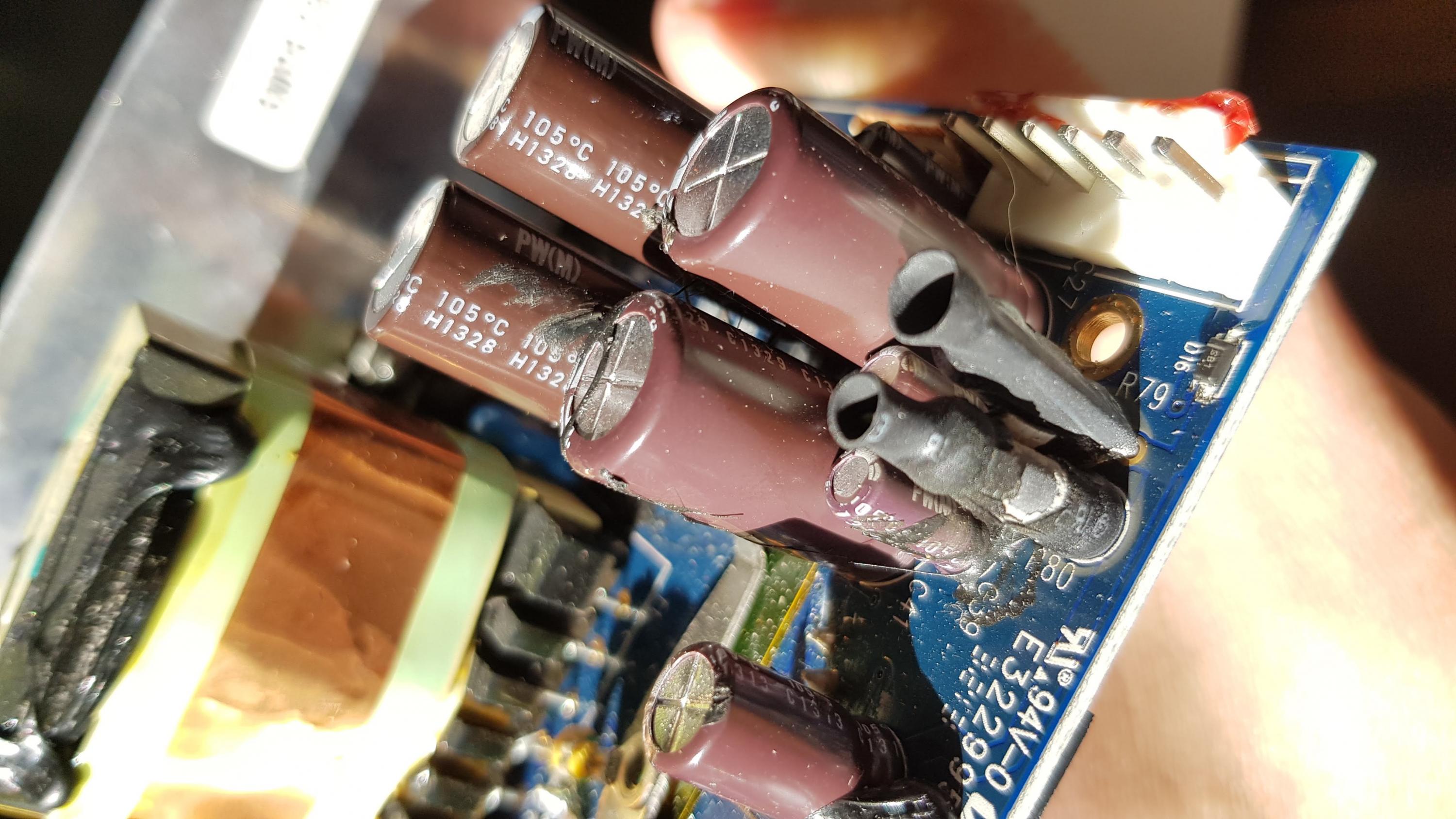

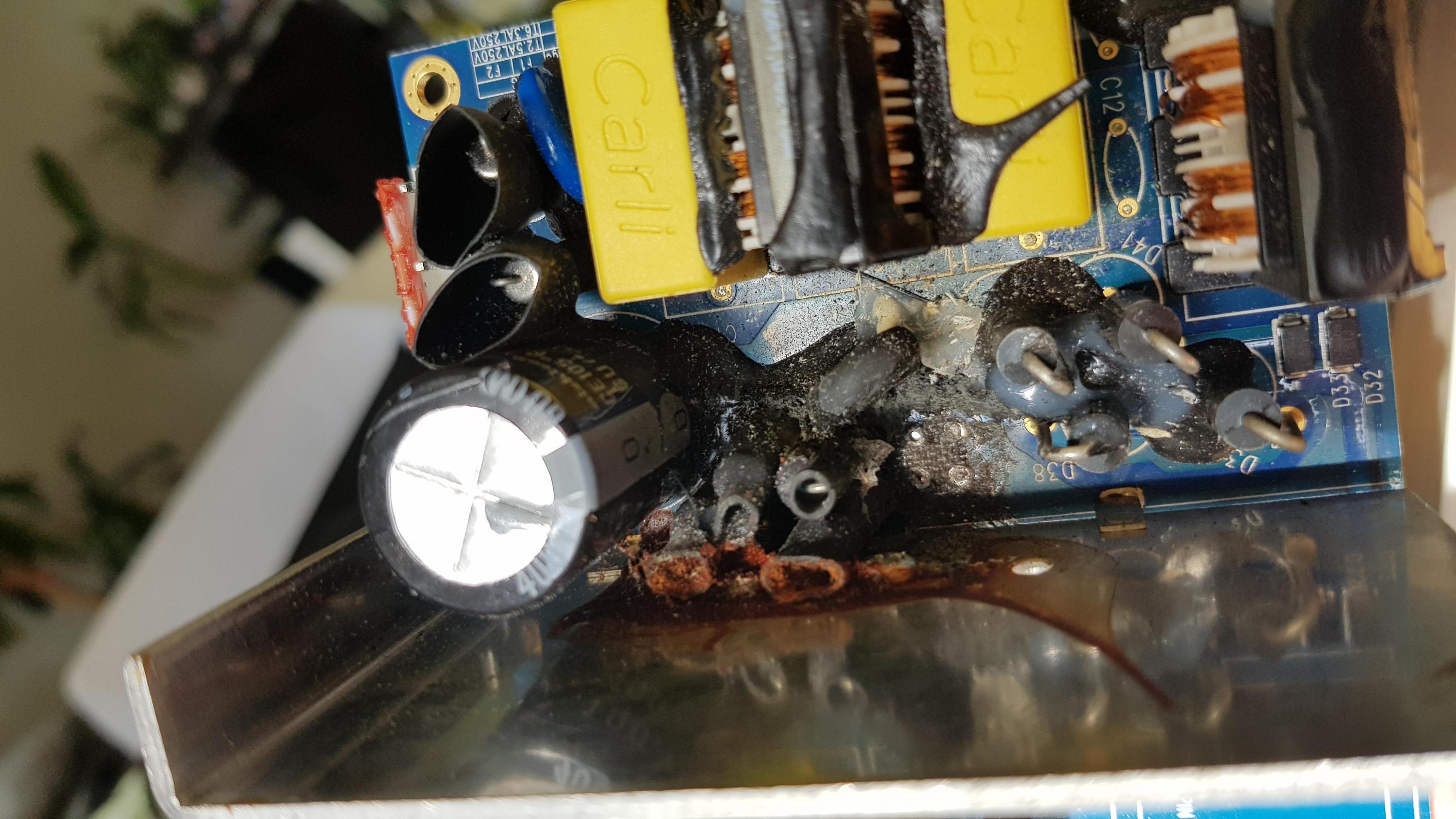

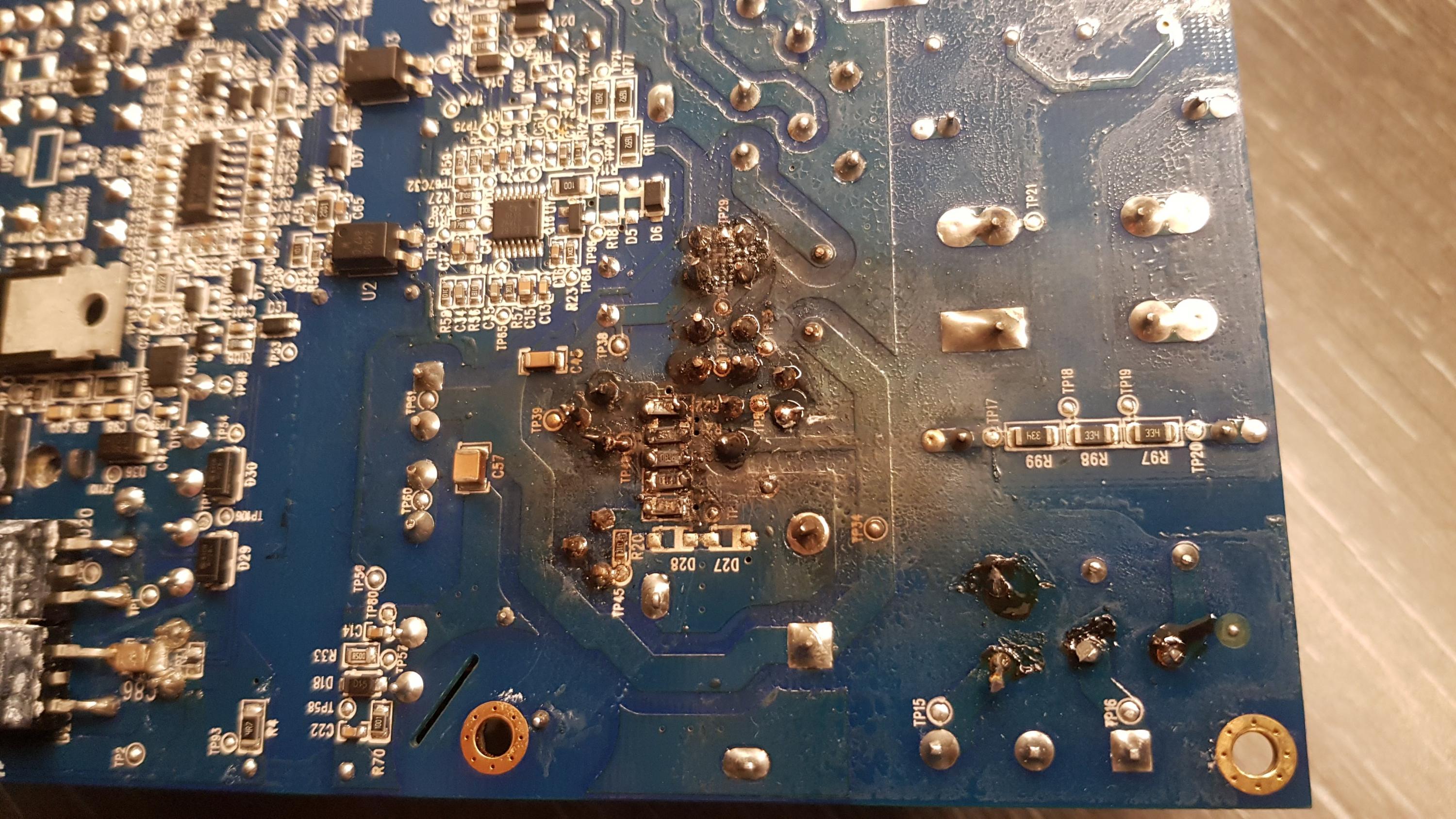

                                  resoldered everything back... plugged in and the area on the picture looked burnt... both 2 fuses died also... cant see what exactly burnt... any ideas what happend here... and what i can do to repair this thing....
                                  please
                                  • storexxm
                                    • Oct 2012
                                    • 107
                                    • Vienna
                                    could the part R51 (SL12 10006 Inrush Current Limiters) the problem... for a shortcut?

                                      https://www.elektroda.pl/rtvforum/topic3195173.html
                                      I found this post... I did not change the D22...
                                      ISL6721 is a little bit complicated to swap... so do u think it's worth just to replace d22?
