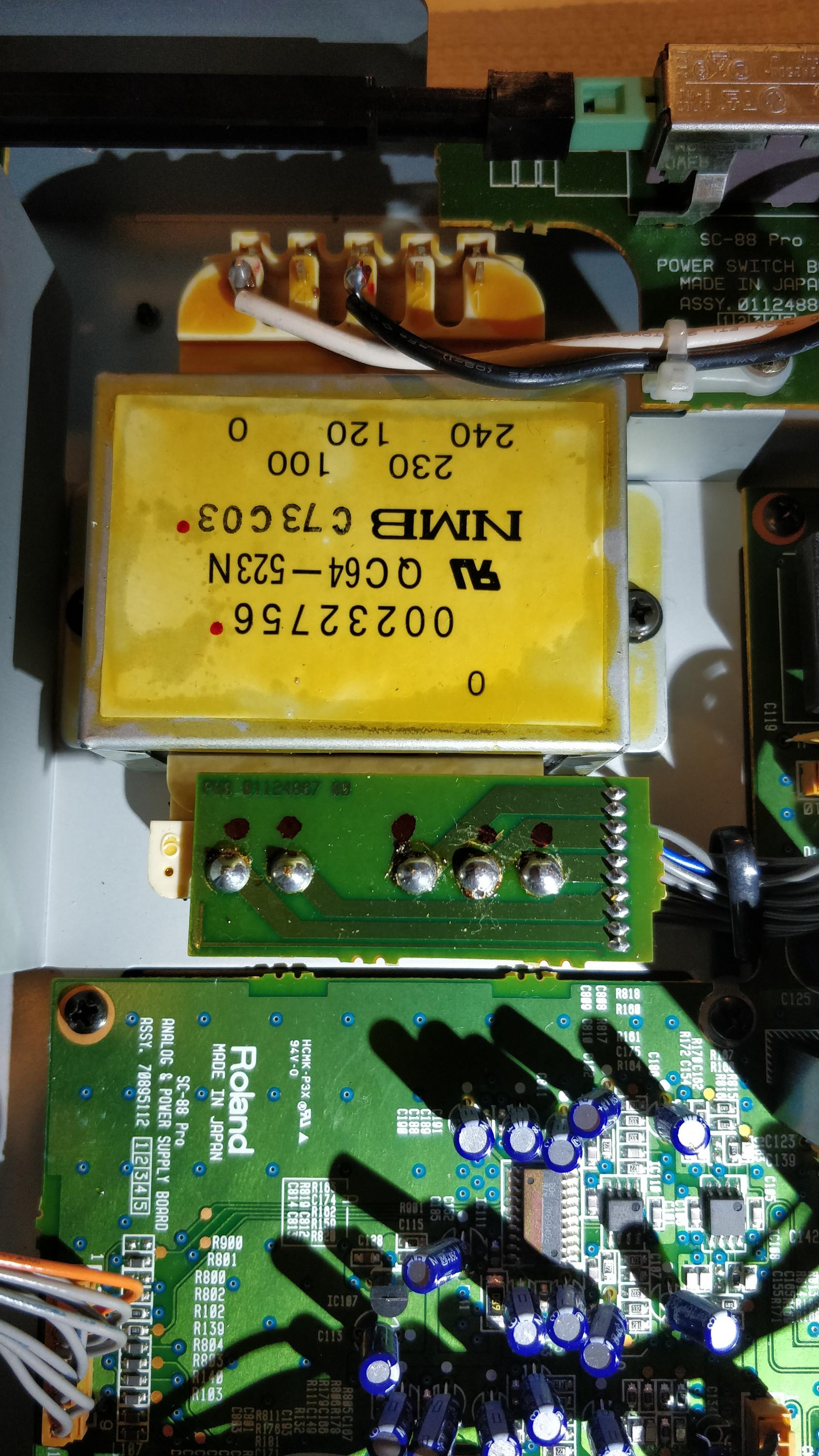

    I know what I'm asking here is not easy to answer but, here I go anyway. A couple of years ago I got a Roland (Sound Canvas) SC-88 Pro, 120v version, it was like new, manual, original box, everything was great, not a scratch. Played with it for a couple of months and it worked as expected. A few days ago I wanted to use it again and now the sound it's completely distorted, it's like a big crackly sound (I'm attaching a sample using the sound preview button: one short press, one long and another short at the end) .

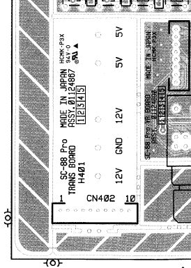

    So, I opened it up and noticed that in the main board, some of the Alum/Poly (smd) caps leaked, not a lot but they did. I replaced them (8) with spare ones I got from Digikey, nicely done, no traces lifted whatsoever and used the same values of course but, that didn't fix the problem. I got the Service Manual and compared the voltages from the transformer, there are 5 output pins as you can see in the picture. I did two tests, one with the transformer on it's own, cable disconnected from the Main board, and the second with the cable connected.
    My readings with a Fluke multimeter: (AC)
    with the cable disconnected from the main board:
    on the 12v ones I get 16.77v each
    one 5v gives me 6.22 and the other 2.17
    with the cable connected to the main board:
    on the 12v ones I get 16v each
    the 5v are aprox. 3.98v each
    Either way, theses numbers are all wrong, correct? am I missing something? I don't see any signs of heat damage or leakage (except the caps I mentioned from the Main board), everything looks good, no funny smells, etc. If the voltages are all wrong, that probably damaged some chips, right? I guess replacing the transformer would be too late... (not to mention finding a replacement).

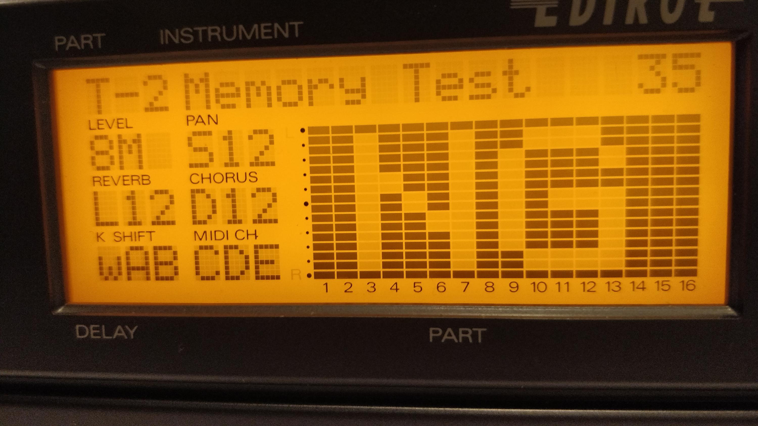

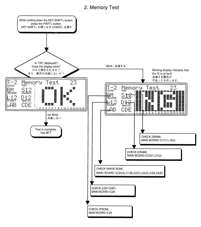

    I did some of the tests from the Service Manual and got several errors with the "Memory Test", I'm attaching a screenshot of what the manual says it's wrong, it matches exactly with what is reported on the screen. The thing is, sometimes a bad component can trigger a chain of errors which is what I think is happening here but, I'm no expert.
    I looked at all those chips but I can't find broken traces or burn marks.

    A little clarification, one of the ribbon cables that goes to the Main Board, attached near the transformer on the secondary board, reads 4.95v (DC) at two points, this may be a correct voltage. Another ribbon cable that is coming from the other end of the secondary board (passing thru the analog section, I guess), is where I get the other voltage readings (3.6v, 2.48v, 0.9v), this probably makes more sense... ? I'm starting to think that maybe the voltage is not the problem.
