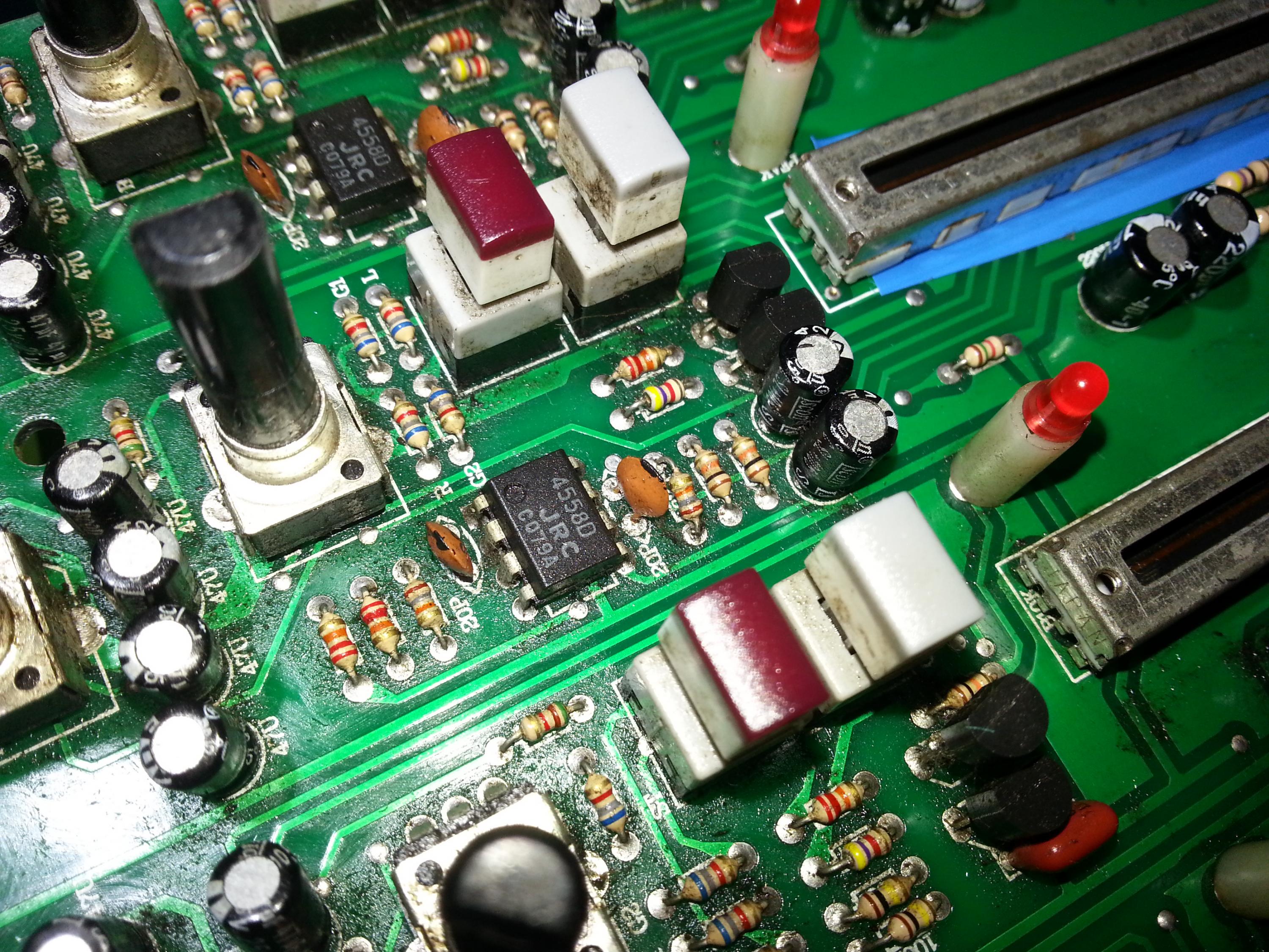

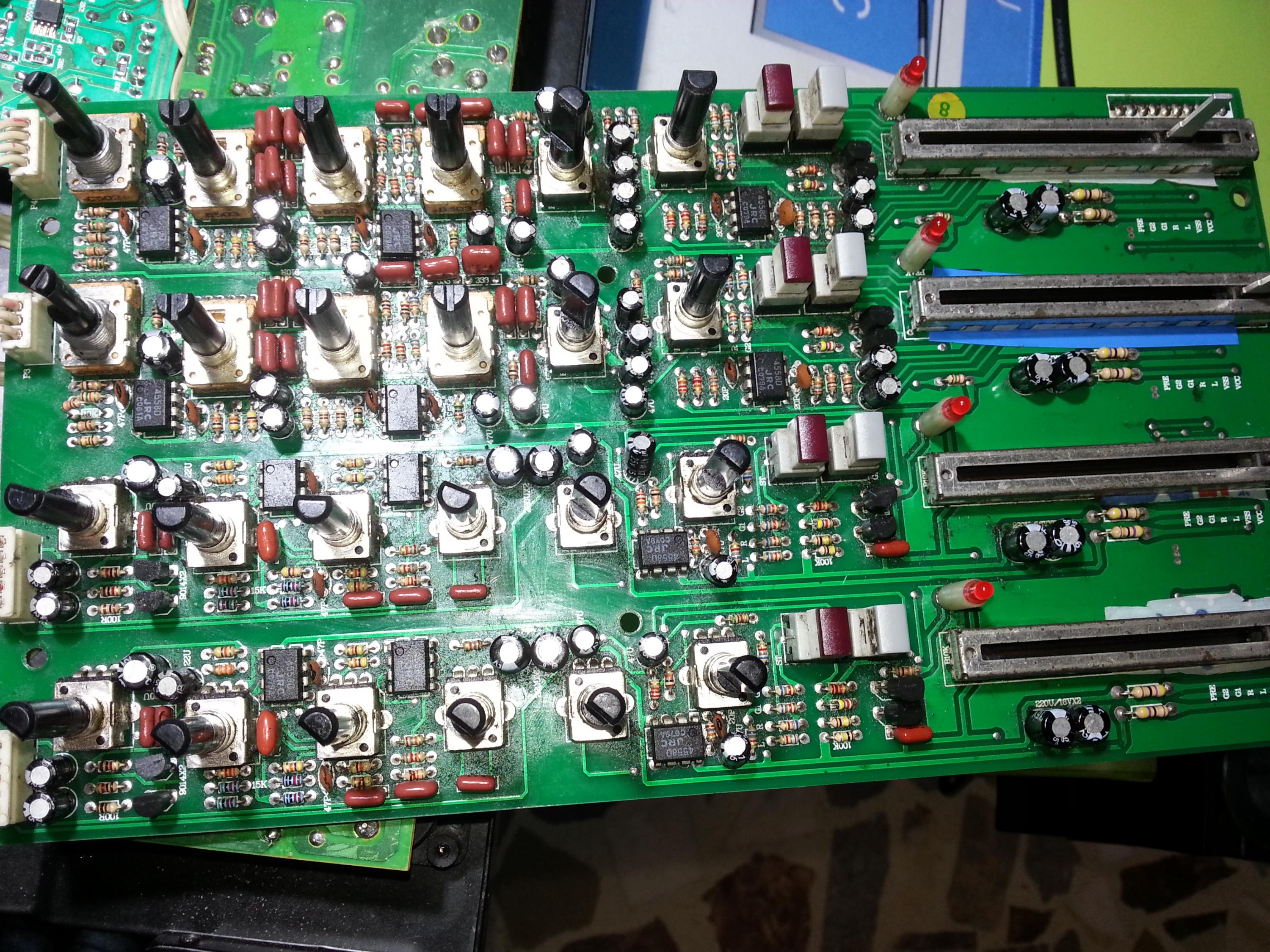

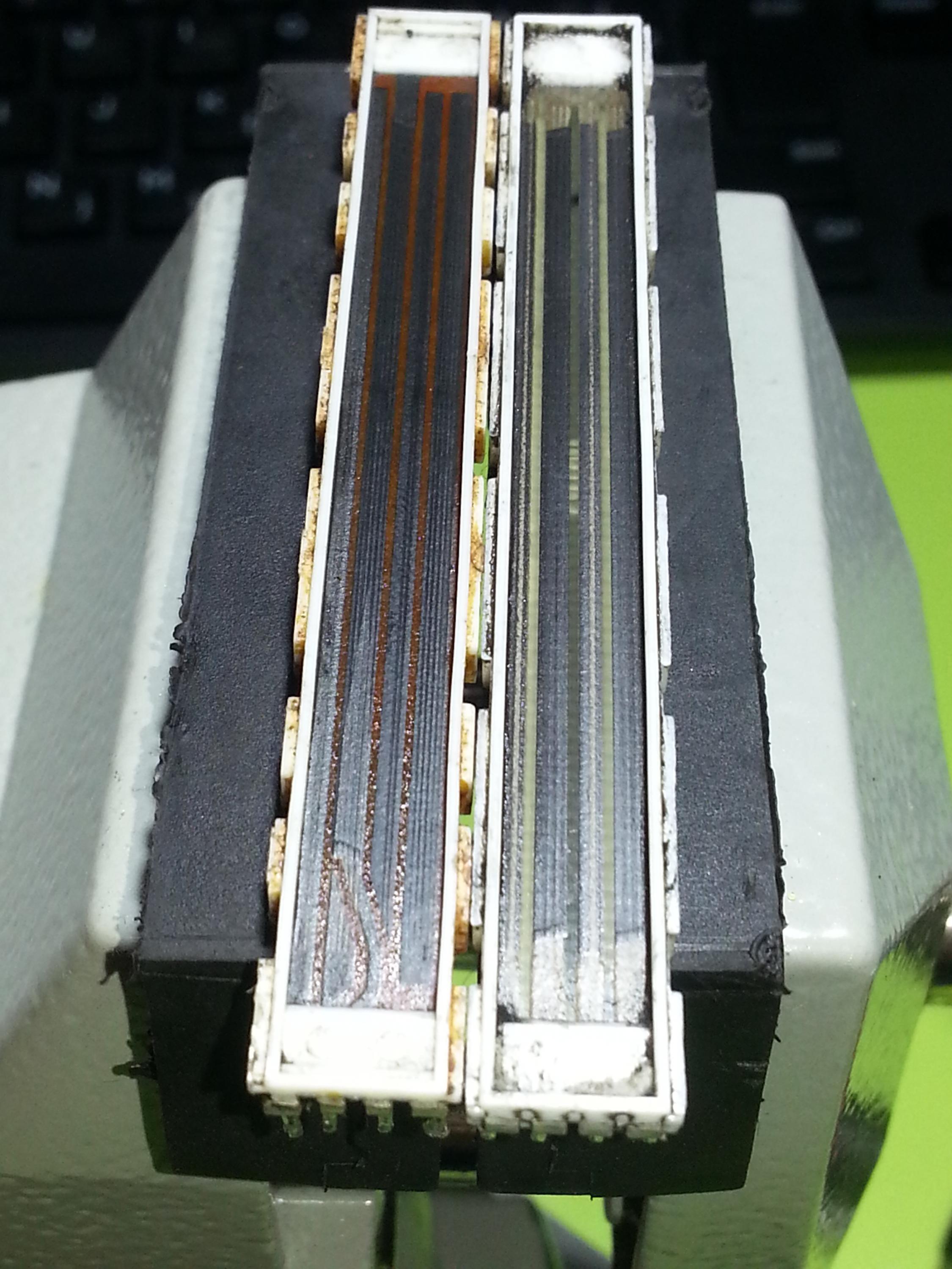

    Good day folks. A pretty difficult task was lain on me today and I think I'm getting close to solving it, but not quite and I'd like some help from those more skilled with pro audio gear. It's an Omnitronic LS-622A powered output mixer which works perfectly except for one important part: the channel faders are bypassed all the time. The only way to adjust the channel volume is with the gain control. Moving the slider up and down has no effect at all, at least on the "stereo" channels - I haven't tried the two mono channels yet to see if they behave the same. Even if the fader is all the way down, the music is still going through assuming the gain control is moved up, which is not how it should work - at least not on this model, since I'm aware there are some mixers which may have a "bypass" or "defeat" switch for the faders.
    I attached both the manual and the schematic for your convenience, maybe there's something I'm missing, but from what my colleague told me, it started doing this after someone else messed around inside and, supposedly, reversed some connectors around. While it is true that there are many connectors with the same number of pins which can easily be swapped around, you'd have to be a complete idiot to do so because not only they're marked on either end on the boards, but they also had the idea to mark some of them, so there was nothing wrong there. Also, I can't imagine reversing the connectors would still allow the thing to work, even with bypassed faders !
    So what could go wrong for the fader to be bypassed entirely ? I even removed one of them and checked its terminals and the traces for shorts, but couldn't find anything - no shorts, yet the signal is still going through when the slider's down....
    The schematic looks homemade rather than official, but it's the best we'll get for such a niche product. The area in question seems to be on page 2 under the "LEVEL" label - R15 most likely represents our slider, though the pinout doesn't quite match. On my sliders, only one pair of contacts actually works when I move the slider, so assuming the wiper is connected to GND like in the schematic, one end of the pot goes from high to low impedance like you'd expect from a pot, but the other one is always the same value or "ramps up" to some inconsistent value as a cap charges or something (can't remember what it did out of circuit, but was still inconclusive). Either way, for the signal to pass through full-blast through that op-amp, resistor R50 would have to be pulled to GND via the pot to form what appears to be a negative feedback amp. As that GND wiper moves "DOWN" (towards the bottom of the page), the volume goes louder...is this correct ?
    I though maybe the 4558 op-amp screws up, but both of them ? It would've been more plausible if only one channel did this, but both of them ? That's a rare situation ! What do you guys think ? What could be wrong here ? I read that manual front and back hoping I'm missing something about disabling the channel fader, but couldn't find anything....any ideas ? Cheers and thanks.

                It seems to me that the level slider you are refering to is on page 5 (10k)
                Page 2 is for the stereo input control
                Does changing the bus select switch have any effect?
                Where are you feeding your signal in?

                      It does seem a bit confusing, I guess the stereo input IS on page 2, R15/20 could be the gain and R17/21 the slider?
                      it is a dual pot so it would be for the st_l/r and G1 bus output
                      I suspect if the slider was replaced it was with one with the wrong configuration.
                      with the L/R switch in the down position you should have audio, with it up it should be muted.
                      Too bad its not a complete schematic.

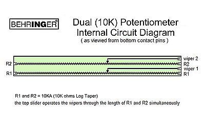

                        • R_J
                          • Jun 2012
                          • 9568
                          Re: Channel fader not working on mixer (Omnitronix LS-622A).
                          This is a behringer pot, If it is the same as your's, the wiper would be going to ground according to your picture, making it likely R15/r20 in the schematic
                          After a closer look, R46/R47 must be the gain controls

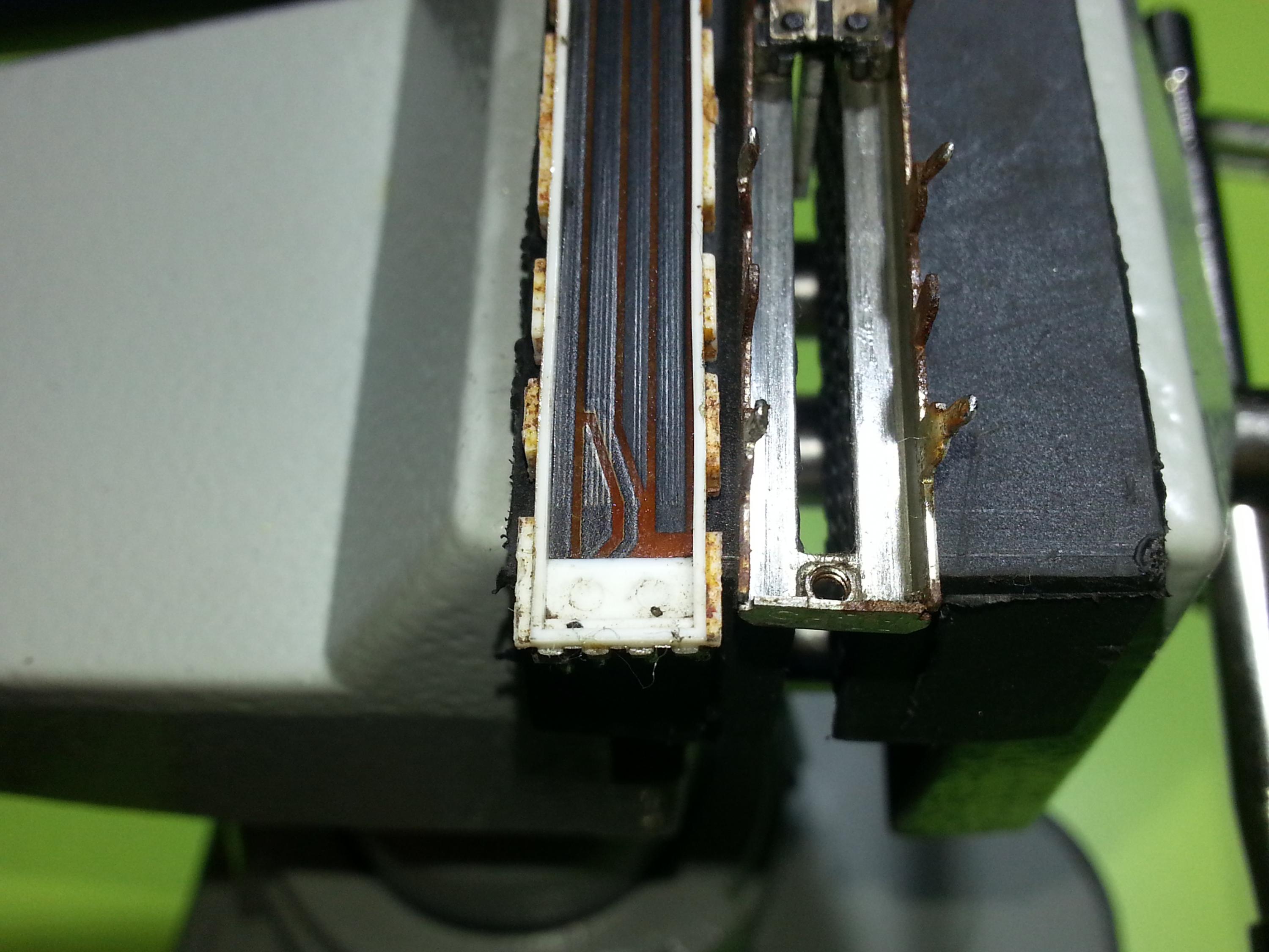

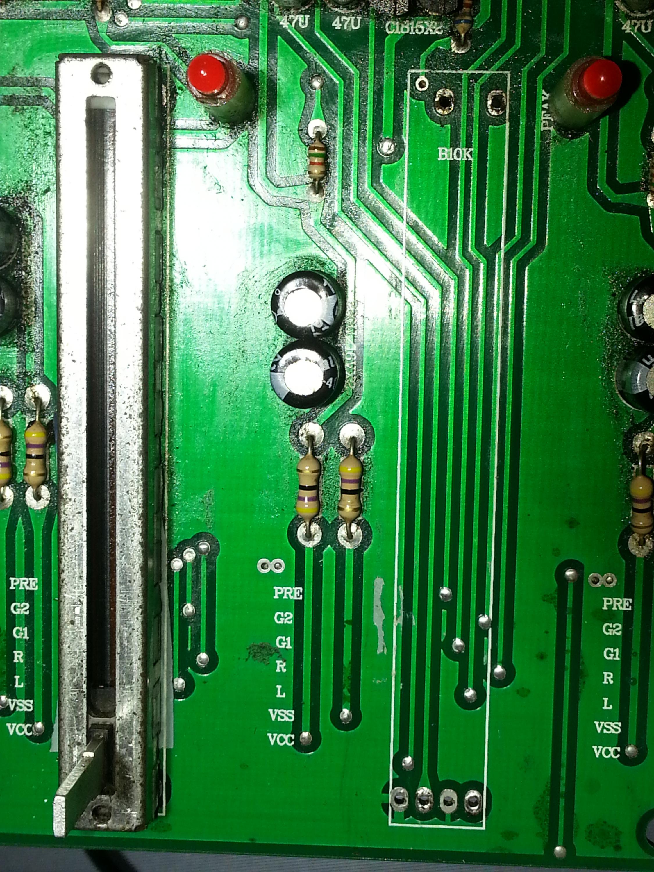

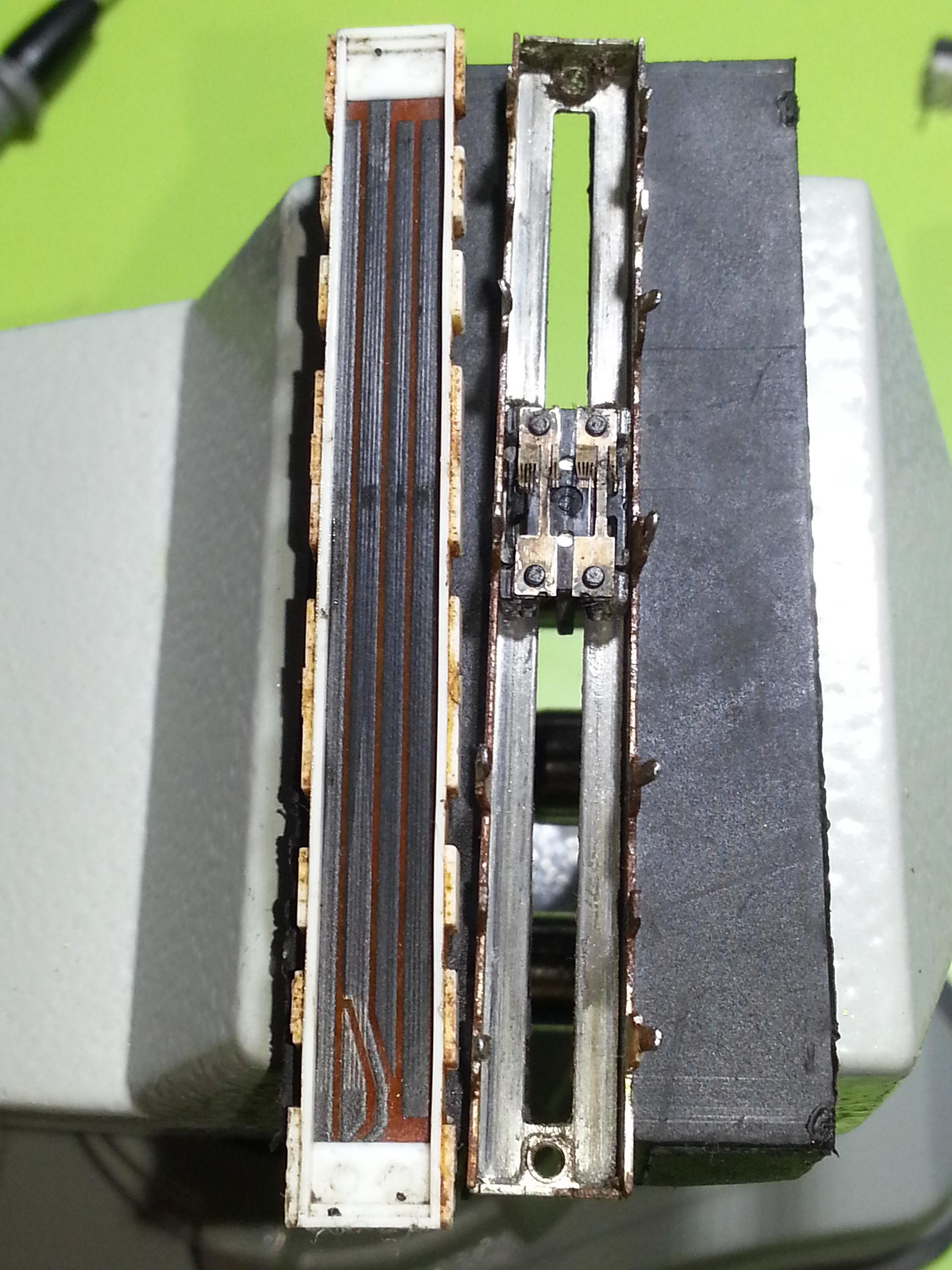

                            Ok, here's the situation: I have it all figured out now and solved the issue. I took some more measurements today and I was dealing with two bad sliders indeed, though I have no idea how they "got there" since I remember the thing worked....anyway.
                            Page 2 most likely depicts just ONE stereo channel, so R15 is one gang of the slider and R20 the other gang of the slider - the notation is a bit confusing, since I would've marked them as R20/A and R/20B to signify they're the same slider just different gangs. Anyhow, thanks to the diagram of the slider R_J provided which was VERY handy (hats off to you sir !), I took some measurements and got pretty wild results: the sliders for channels 1/2 (mono) read perfectly fine and exactly as expected from a potentiometer: 20k across the ends of the "resistors" (since they're 20k sliders in my particular case - says 20KA on the sides) and 1-4ohms when the wiper was at either end. It will never be a dead short between the wiper and the end AFAIK, so it's acceptable. On channels 1-2, even though the sliders are stereo, only one gang is wired - the other is floating and soldered only for support.
                            Now for channels 3 and 4, both gangs are wired but they both gave incorrect readings: I get the correct value on just one gang and this is because someone, before me, replaced these with mono sliders. To confirm this, I pulled out one of them and cracked it open to have a look at the tracks, along with another one my colleague gave me to try out. The brown one is the slider that was in there and the white one next to it is a stereo one which I actually put in its place. Notice on the brown one the rightmost track is not wired to the pins and I confirmed this with my meter. The problem is now solved and the mixer cranks once again
                            The L/R signal wires going to the amp were also swapped around so L was R, so it's a good thing I went in there to clean up this mess...cheers guys. Thanks again
