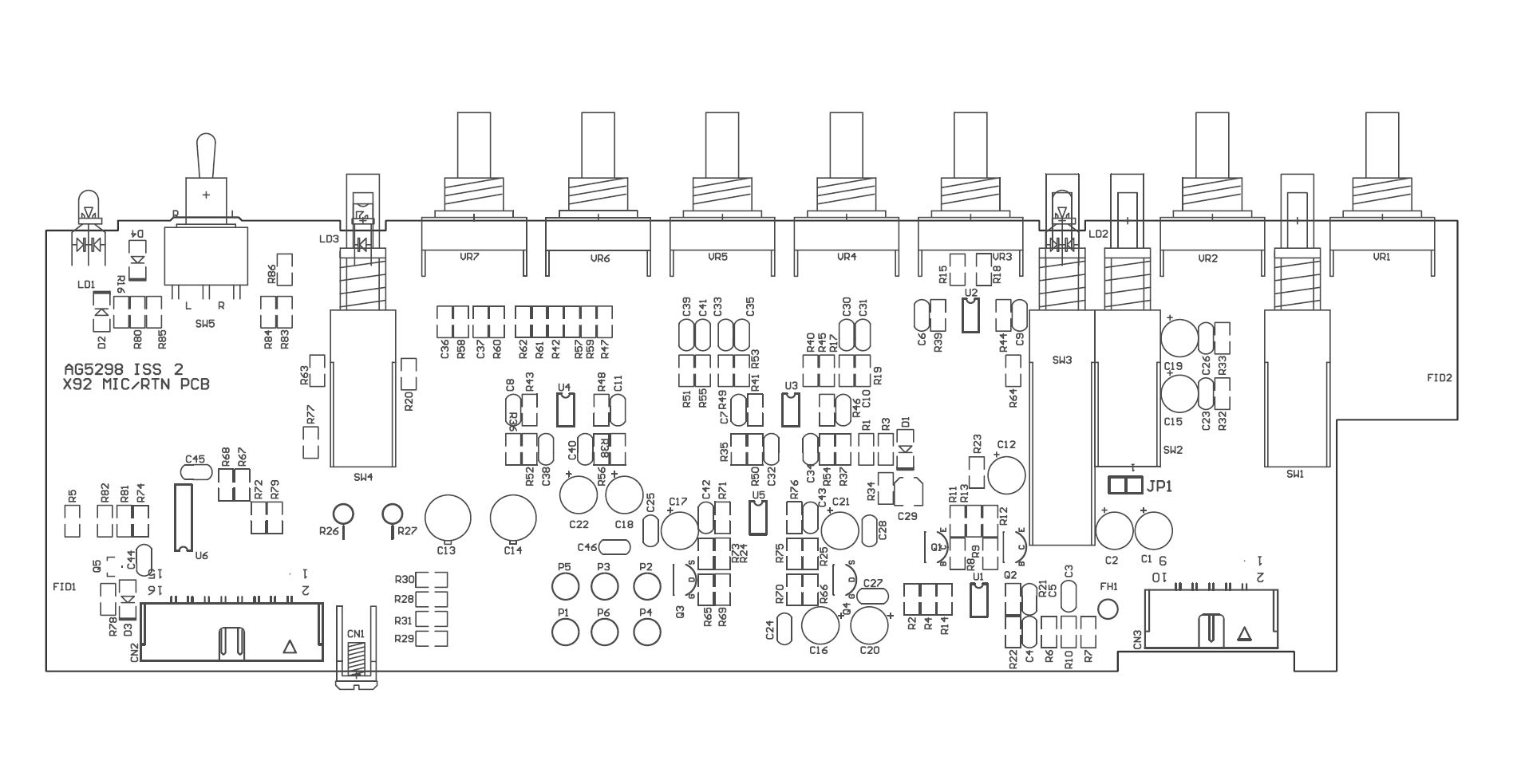

              • analogicalmind
                • Feb 2022
                • 11
                • United Kingdom
                Re: Allen & Heath Xone:92 mixer problem - faulty phono channel outputs on one side on
                A bit of an update - I've tried cleaning the ribbon cable connections with no success. I've also swapped around the channel 2 (the faulty channel) PCB board with the channel 3 PCB board - channel 2 is still faulty after swapping the boards so I guess the rules out a fault with the channel PCB board.
                I'm guessing (naively!) this points to a problem on the slave or master boards, or the ribbon cable. I'm assuming that the other boards wouldn't produce such a channel-specific fault.
                • analogicalmind
                  • Feb 2022
                  • 11
                  • United Kingdom
                  Actually... I made an error earlier - when the channel 2 (the faulty channel) PCB board is swapped with the channel 3 PCB board, the problem moves to channel 3. I guess the fault is somewhere on the channel board
                  • budwich
                    • Jul 2015
                    • 3097
                    that should make it easier. pull two boards ... one good and the bad one. get a meter and use the resistance check to compare readings against the two boards at "well chosen points". Hopefully, you will be able to quickly isolate where the "break" is and go from the result.

                      • budwich
                        • Jul 2015
                        • 3097
                        hopefully I understood your post and "correction".... restated, you moved the bad chan 2 board to chan 3 and now that channel has the same issue (ie. one chan of phono in is dead). IF so, then the problem likely lies with the "bad" channel 2 board. Hopefully, you are labelling them to keep them identified properly. You should be able to do some relatively simple resistance checking at "strategic points" to identify the issue. Hopefully, it will be a simple fix there after.

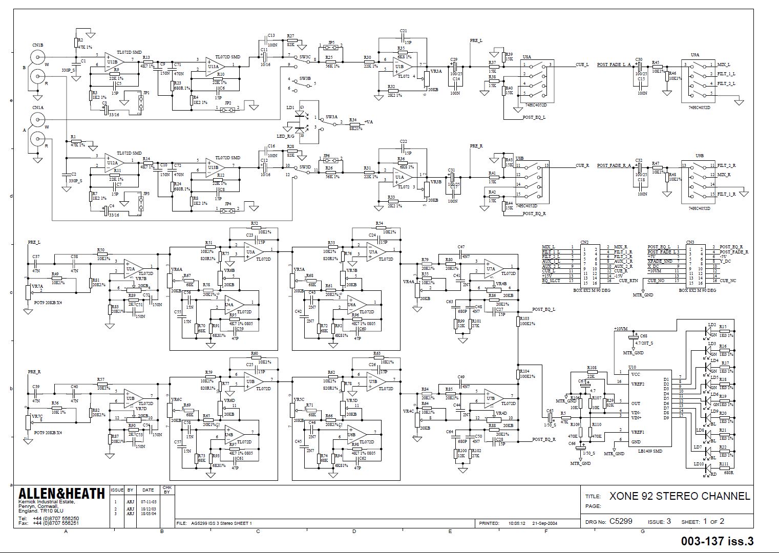

                        • redwire
                          • Dec 2010
                          • 3912
                          The phono/line switch SW3 pg. 14 switches in the preamp or not.
                          IC TL072D U12, U13 are the preamp, right at the end of the board by the RCA jacks.
                          There's some jumper link options JP1-JP4 cut to set it as flat pre-amp input or left in for phono RIAA curve.
                          I usually go for the RCA jacks or switches and broken solder joints there.
                          I notice this mixer doesn't have any ESD protection for the mic and phono preamps. Which can mean blown IC's.
