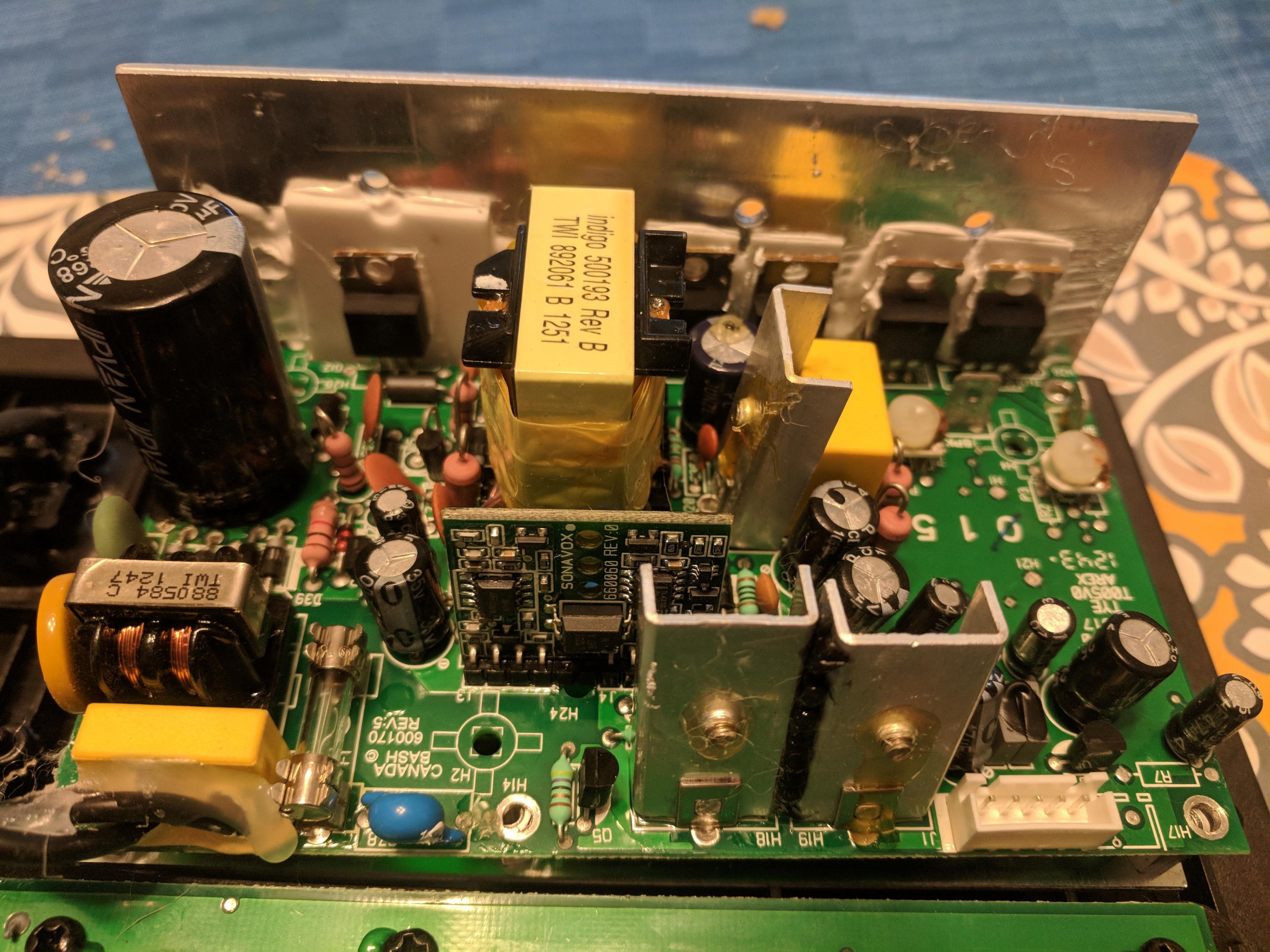

    My brother in law got a sub-woofer out of the trash for me. It's a Polk Audio PSW110. It works but seems to go in to a kind of protect mode at higher volumes and lowers the output considerably for a period of time and then starts playing again. To me that feels like a capacitor in the power supply may be giving out. The attached pictures, to my eye, do not look visibly failed.
    Does anyone have a schematic? Short of that I am inclined to recap it (at least the polarized capacitors).
    Re: Polk Audio PSW 110 subwoofer
    https://www.badcaps.net/forum/attach...2&d=1529196489

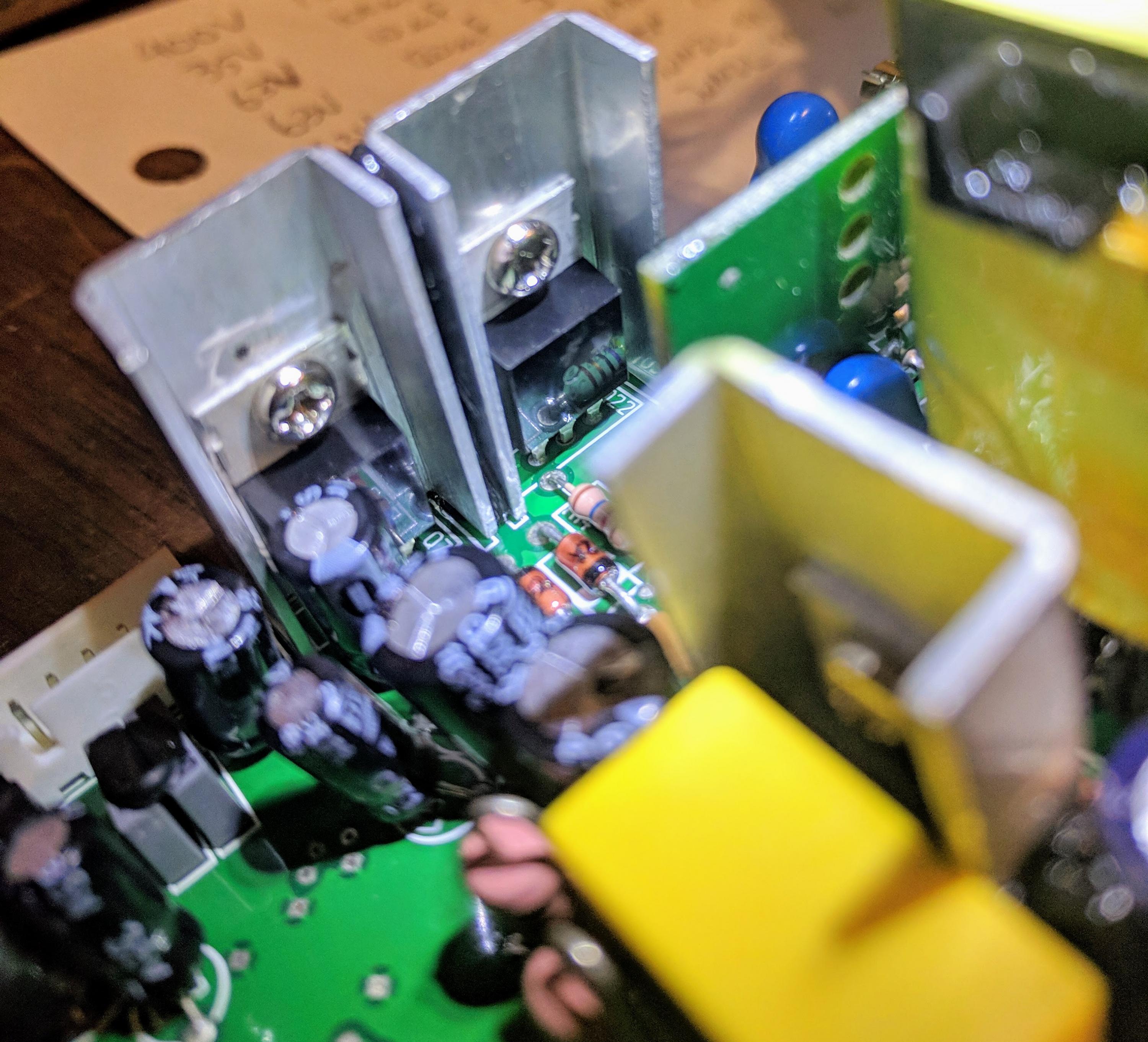

    Did you remove the clamping bar that holds those TO-220 device tightly against the heatsink?
    • frankusb
      • Apr 2015
      • 111

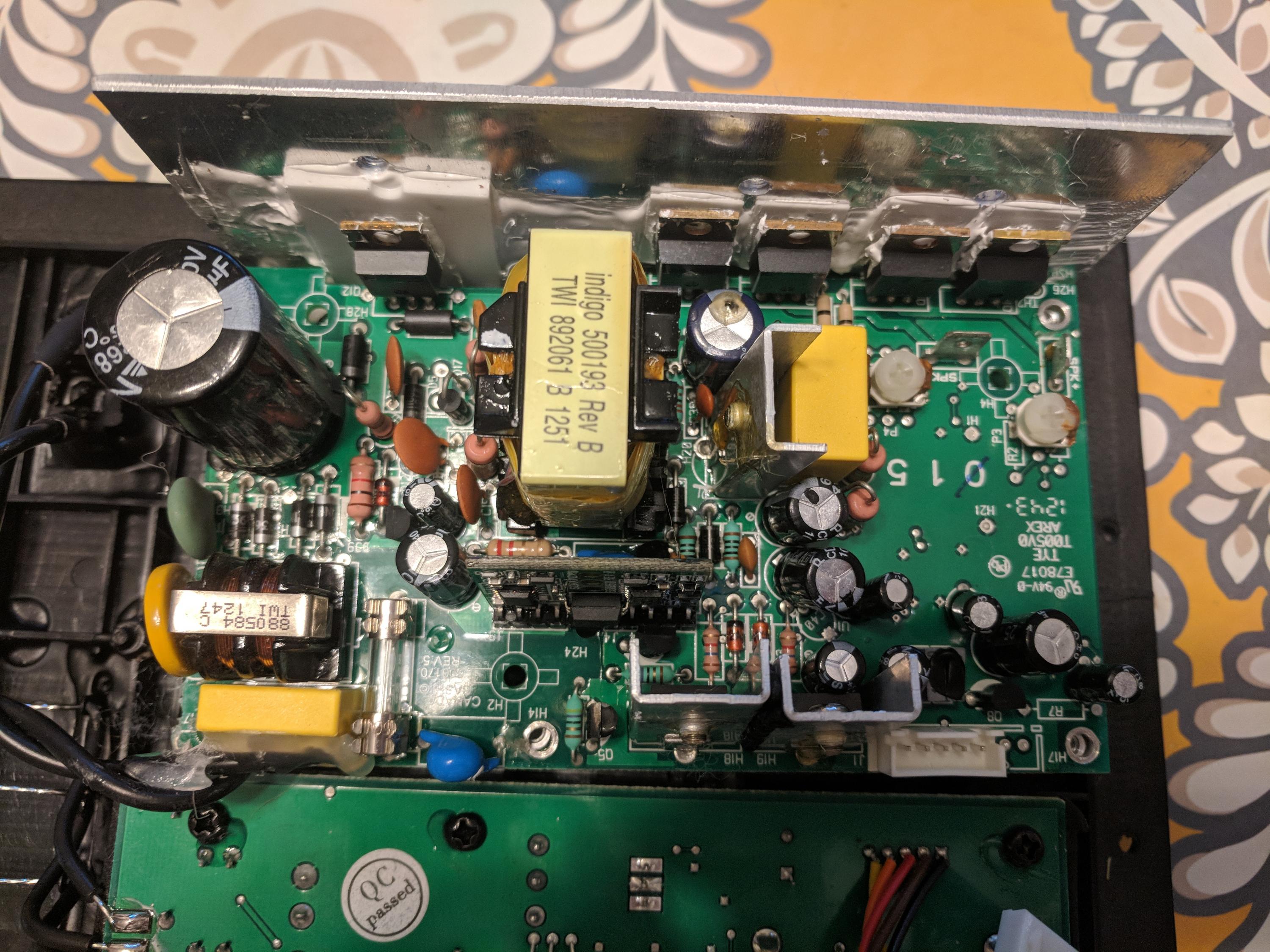

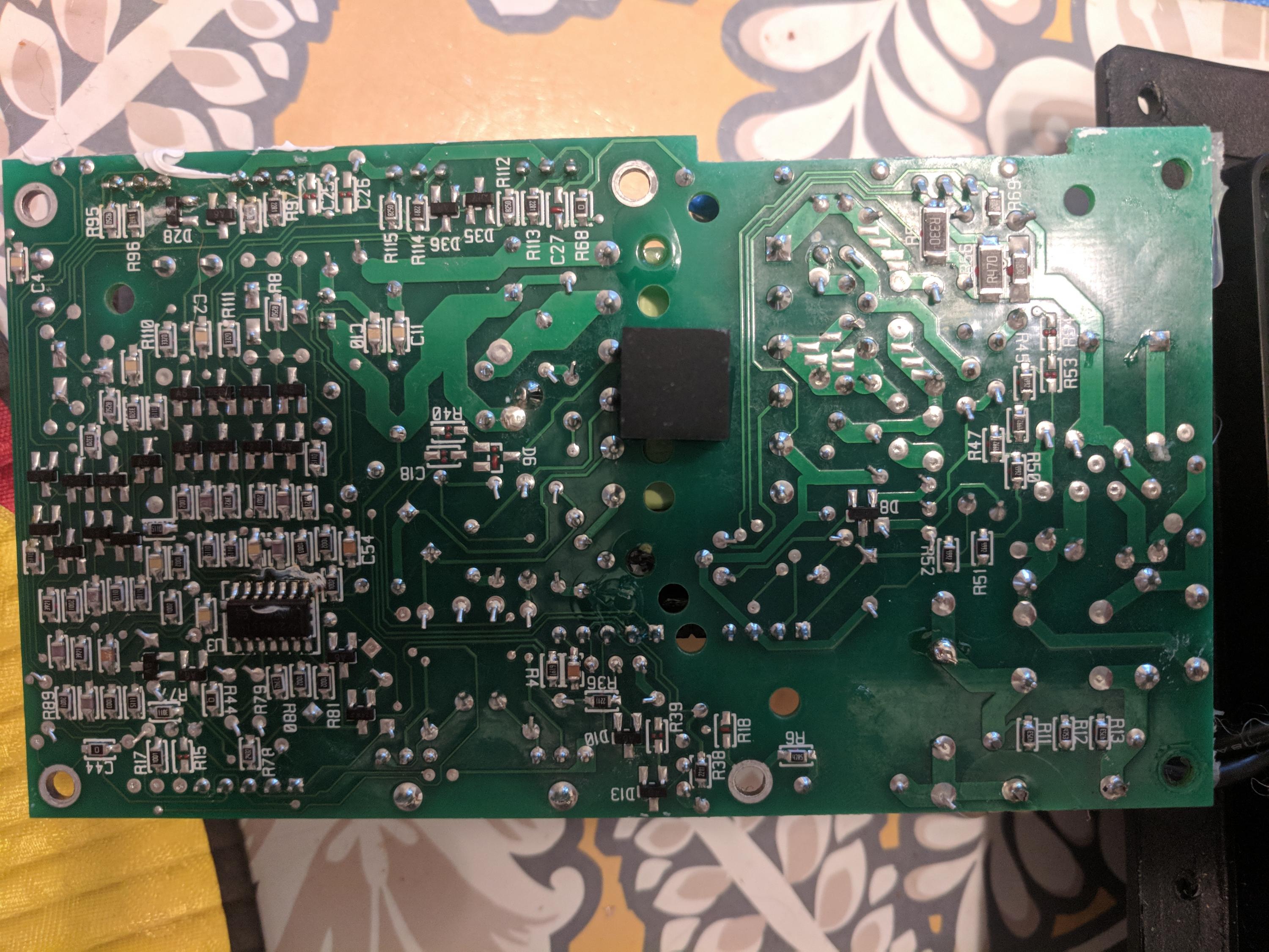

      I removed 3 clamping bars so that I could take a picture of the bottom of the board.

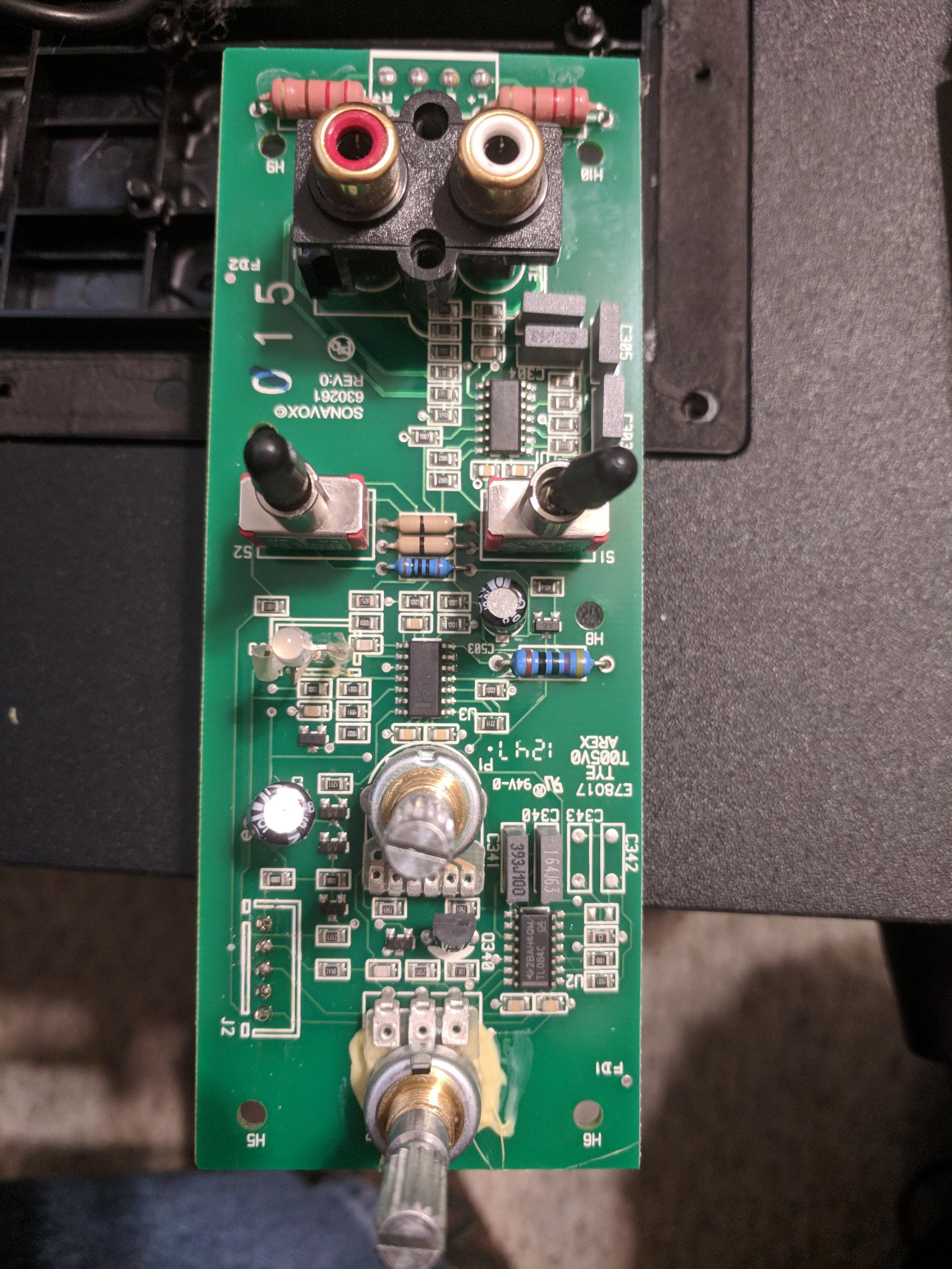

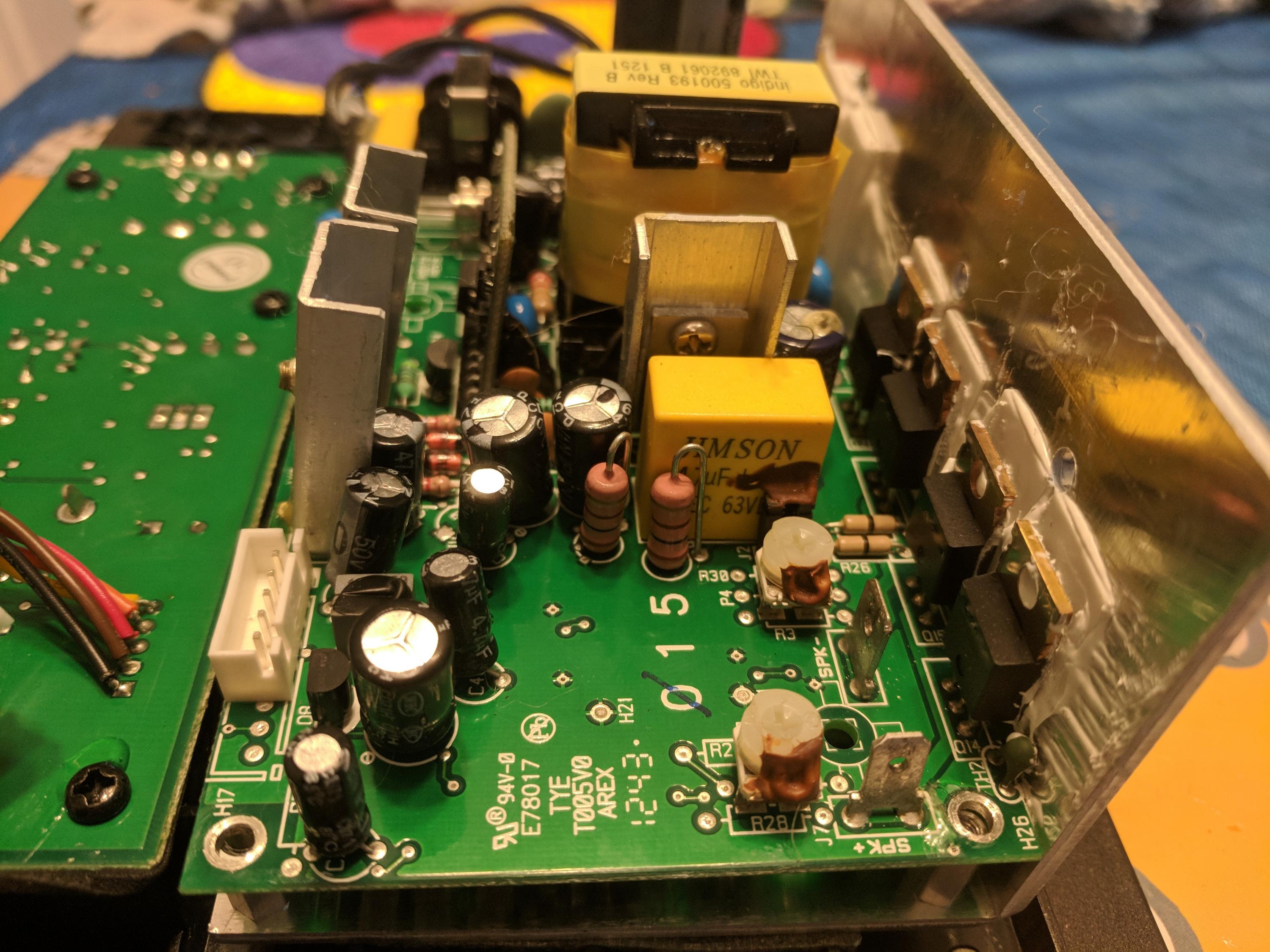

        So it has power supply/power amplifier combo board, the other board is the preamp/input board. There are 5-pin connector that goes to the preamp board, you can test and record the Voltage of all 5 pins before and after it acts up.
        There are lots of threads about this 110 sub. You may try recapping it at this point.

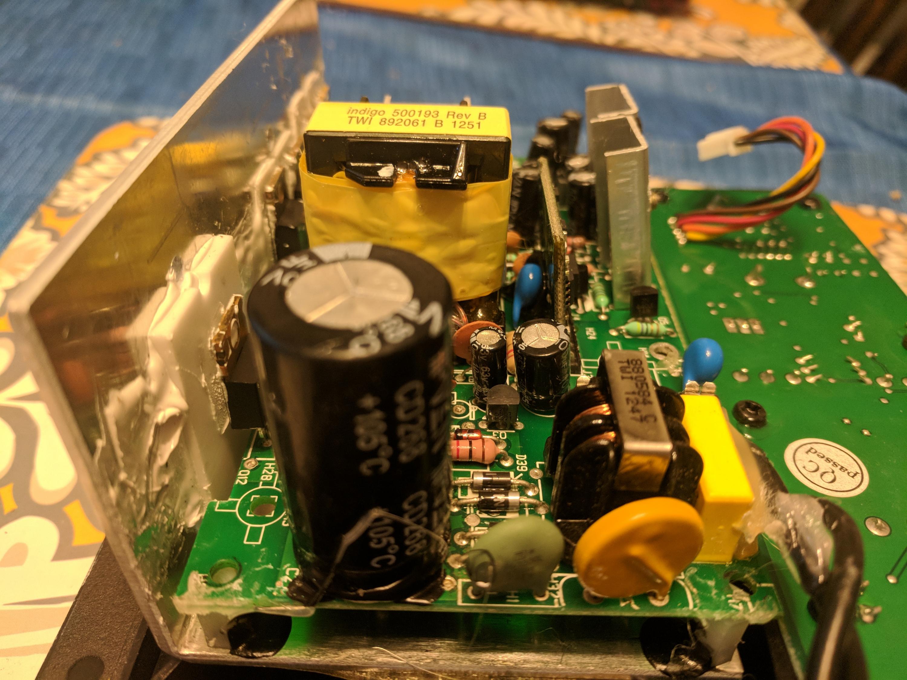

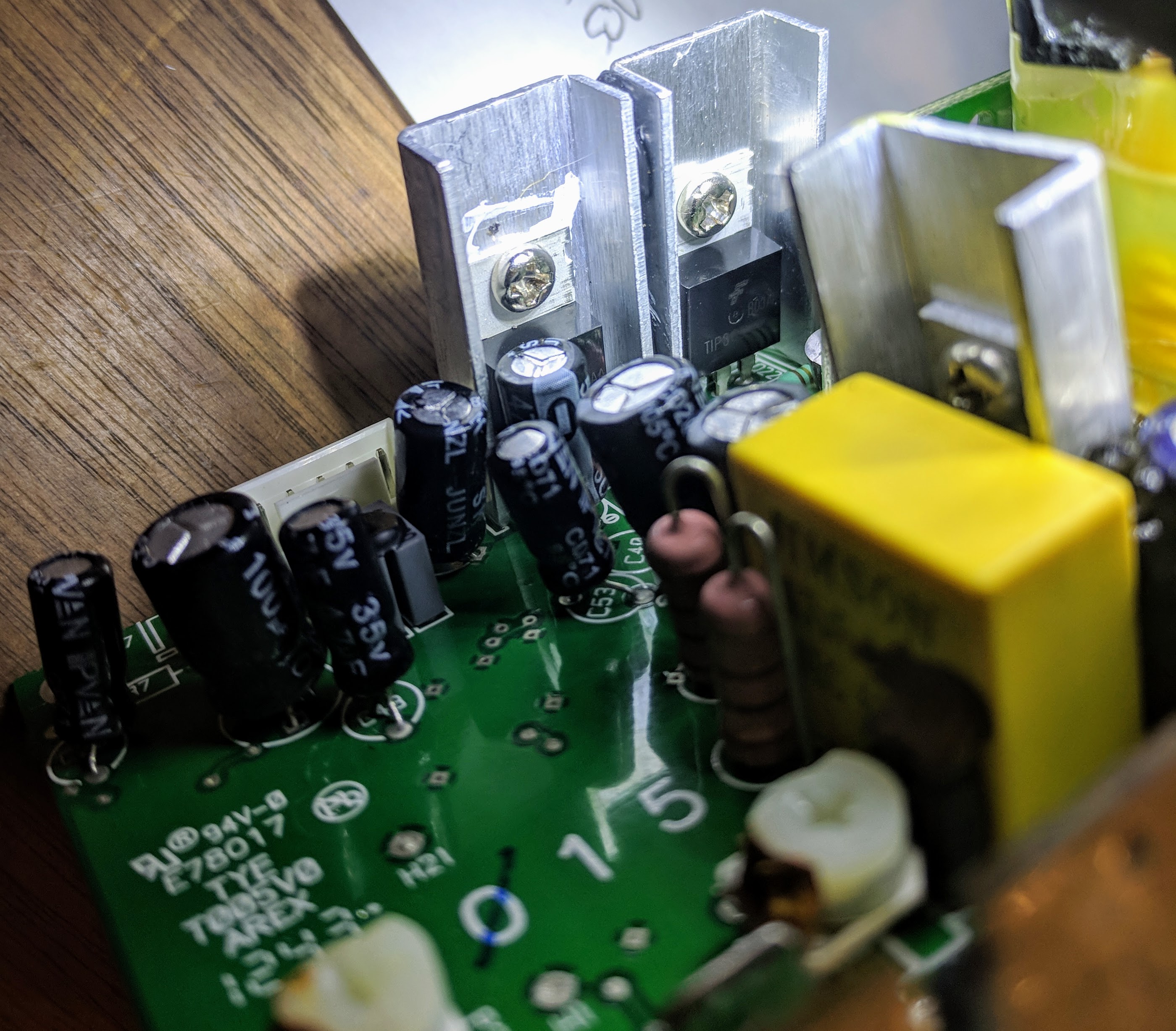

          Anyone have any datasheets on PVAN or MHC capacitors? I found the JUNZL PL series datasheet and the SK series datasheet.
          There are 8 polarized capacitors.
          PVAN CD268 400V 150uF
          JUNZL SK 35V 100uF
          MHC CD263 63V 10uF
          JUNZL PL 63V 120uF
          PVAN CD268 63V 47uF
          PVAN CD268 63V 47uF
          JUNZL SK 50V 47uF
          JUNZL SK 50V 47uF

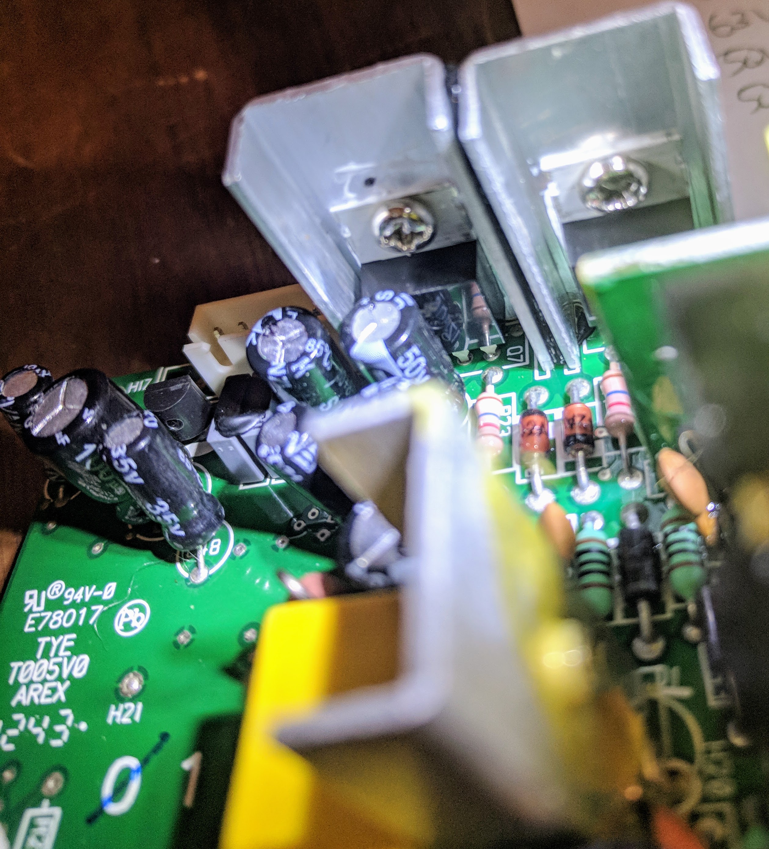

                                    The output of Q22 (HI8) is connected to Red and has a 47uF 50V capacitor in parallel. In circuit measurement of the capacitor is 73uF. The output of Q7 (HI9) is connected to Black and has a 47uF 50V capacitor in parallel. In circuit measurement of the capacitor is 66uF. Measurements done with a Fluke 12.
                                    It's hard to read the numbers without removing the components but I've got a partial number in the attached pictures, TIP3??? BJTs?

                                      Check the DCV between each heatsink of the TIP3x transistor against GND to see what you get. Do the same on the Emitter pin of each TIP3x against GND.
                                      • frankusb
                                        • Apr 2015
                                        • 111
                                        Q22 heatsink measures -8.6, Q7 heatsink measures 13.2.
                                        Based on https://cdn.badcaps-static.com/pdfs/...4a008e39e0.pdf, the emitters were what I measured on the 5 pin connector, no?
