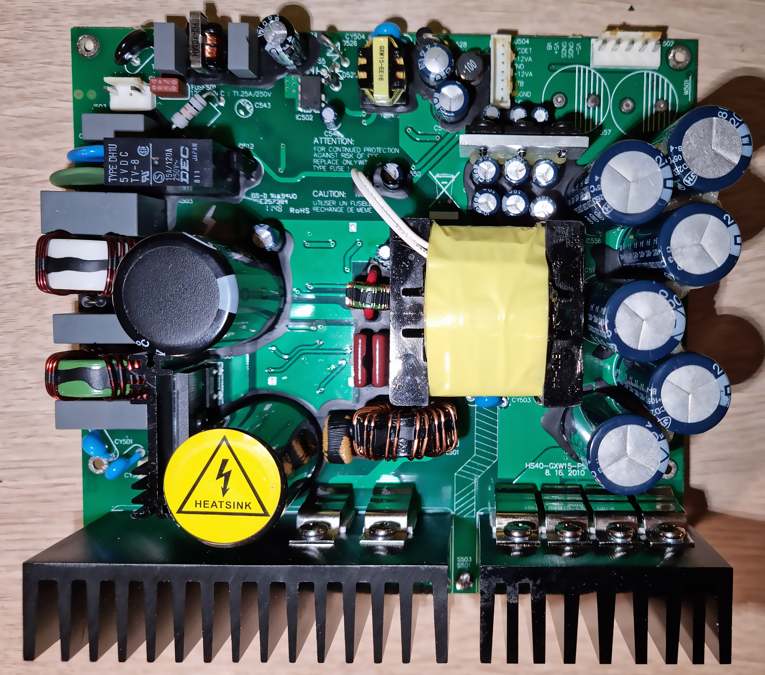

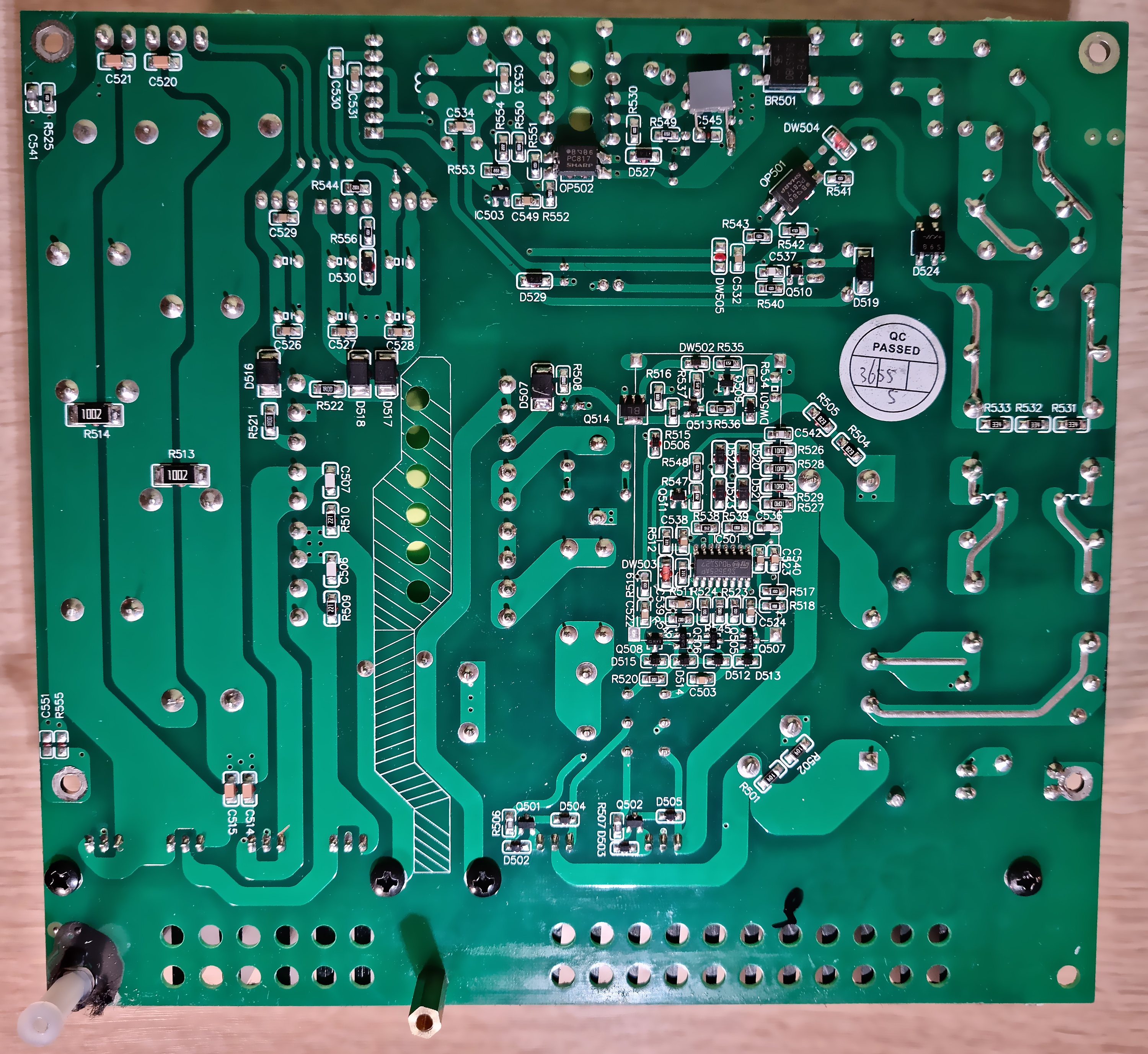

    Help monitor audio gxw-15 subwoofer
    Have a problem with one of my gxw-15 subwoofers. When pluging in power socket it shows power is ok (red LED), but when trying to turn it on it turns iff immediately (can hear relay clicking sound). Cause i have working second subwoofer i tried replacing several boards. So for now i can say power board is causing this problem. There are no visible damaged element on it. I wrote to Monitor audio and they sent me all schematics. What i have found is defective capacitor C535(short circuit), but after changing it ...same behavior.
    Measured output FETs, diodes. Seems everything is fine...

    Re: Help monitor audio gxw-15 subwoofer
    If C535 was shorted, you may have an open R508 that supplies the AUX supply. Check your AUX voltage and also the VCC voltage
      R508 is ok.D507 too. Checked them. Will check aux voltage and VCC.
        What about that swollen cap next to D528? Think it's on the +5V rail which is also used by that black relay.
          Thanks guys! I really missed that capacitor near D528. It was damaged too. Changed it and everything started to work!
