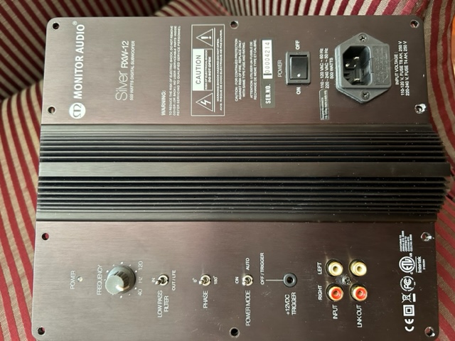

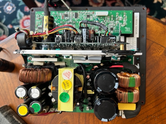

    I have a monitor audio subwoofer rxw12 that is clicking. Avsforms has a thread on this and I saw someone posted schematics here for it. Since I’m a newbie and no one here in salt lake will work on it, I guess I’m elected.
    Supposedly the issue is “ smd type and located on the soldering side of the amplifier board”. Can you experts help me identify which one it might be? And what to order? How difficult to put these in? I’ve replaced caps before but just eyeballing what these resisters might be on the board, they look pretty small.
    I saw some utube videos on these resisters so hopefully that will be helpful.
    I have 4 of these subs and this is a common issue in them. So I better learn how to fix if I have 4.

        Pics

          Re: Help monitor audio rxw-12 subwoofer
          Post the PCB picture in much higher resolution please.

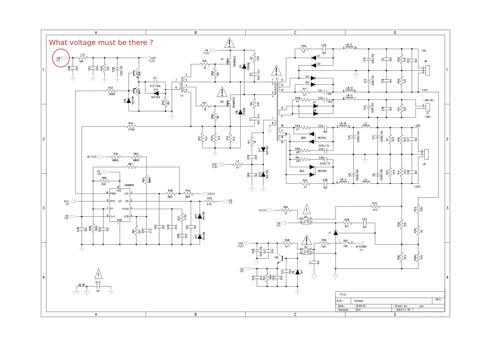

              Hi, from Greece can anyone to help me
              I want to know what is the voltage in the circle up left.
                Don't remember exact value, but VCP is around 16-17V, so VIB should be a bit less than that.
                  thank you very much

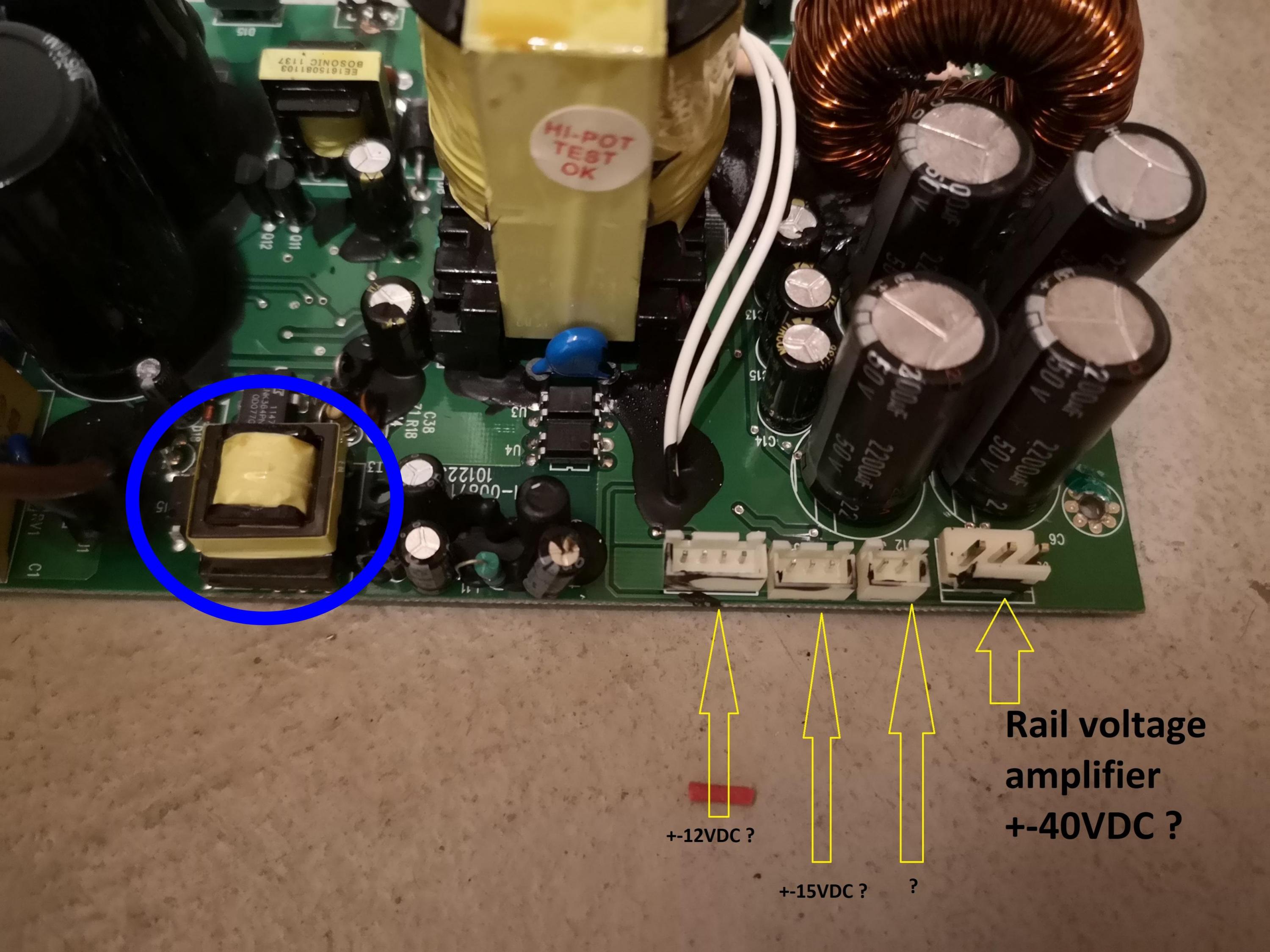

                    Can you tell me which transformer is in the blue circle?
                    thank you.
                    • dobrykamil
                      • Jun 2013
                      • 63
                      thank you.
                      That's the standby psu transformer.

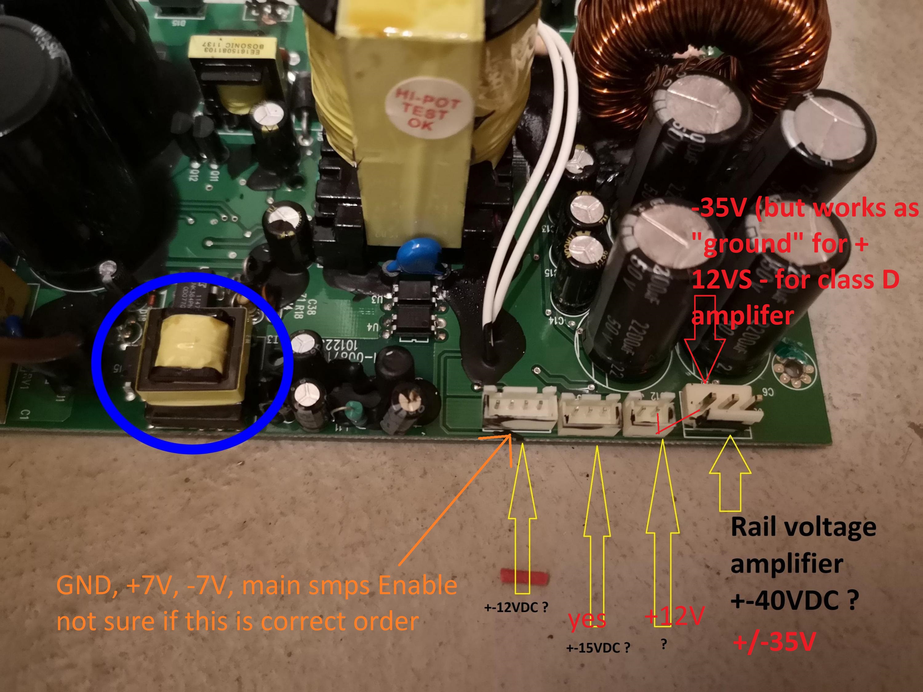

                        I installed 2 transformers +12v and -12v, but the previous transformer also gave a voltage of 16-17 to get voltage to the vcp.
                        Do you know of a way to get voltage to the vcp or find the previous transformer as a spare part.
                        thank you very much
                        • dobrykamil
                          • Jun 2013
                          • 63
                          thank you very much
                          That small transformer is only there to provide positive and negative, standby power rails. All other ones are generated by large-main transformer.
