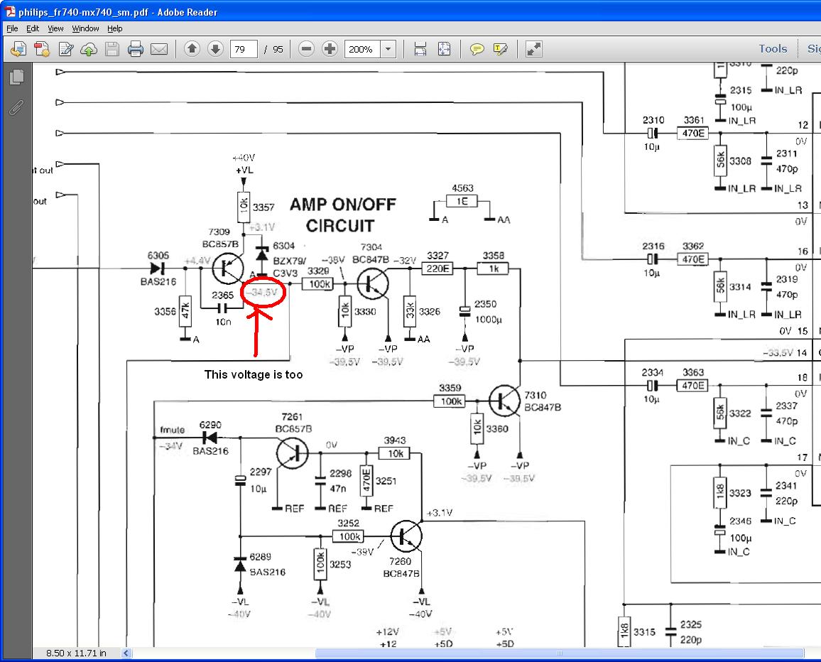

Philips FR-740 working but no audio output

    Re: Philips FR-740 working but no audio output
    Originally posted by R_J
    On plug 1410 pin 11 amp prot (page 34) do you have 4.4 volts? Its hard to follow where things connect in this old type pdf (can't search)
    Yes, 4.5V present
        I think +4.4 for the amp protect line is for normal operation, I suspect a low would tell the amp to be in protect?
        If the amp lr line is not high (+5 volts) then the amp on circuit will not be told to turn on, I can't see what conditions need to be met for the micro to say turn on the [amp lr] line?
        It looks like the voltages marked on the schematic are for normal operation (bottom right of page 80)
        Do you have the remote? can you turn the Mute on and off?
        It sure looks like something in the menu somewhere has turned the amp off
            On page 78, MFD looks like it should be 0 volts on base of 7253 (power down circuit) and the collector should be +5 volts (amp pd)
            A lot of the voltages are marked so make sure they are all ok, the only one I can see that is not right is that {amp lr} line, it should be +5 and its 0 so the main amp ic's are not turned on.
            That amp lr line is controlled by one of the output lines of ic7412 (page 34) and that ic takes data in to control the output lines, so something (microprocessor) must not be telling it to turn on pin 6,
                        That does'nt seem like it works right, so TEST EEPROM = PASS
                        and EEPROM FORMAT = NEW
                        Well the reason the amp is not turned on is the missing +4.9V on diode 6306 (page79) amp lr on.
                        I guess you could lift the anode of diode 6305 and feed it +5 volts to see if the amp turns on and is ok. You could have a bad 7412 (hef4094bt)
                            did you check the voltages on 7309, there should be 3.1 volts on the emitter, if not that 6304 zener could be shorted, did you check any of those transistors like 7309, 7304, 7902
                              these are the voltages measured:
                              7309: E= 3.4V, B= 3.05V, C= -1.4V
                              7304: E= -40.3V, B= -39.6V, C= -40.3V
                              7902: E= -40.3V, B= -39.6V, C= -40.3V
                                I wonder if 7309 is'nt bad, there should be -34.5 volts on the collector. I guess you could check the 2 100k's 3329 & 3936
                                -------from other post-------
                                ok, page 79:
                                A of 6305: 0V
                                K of 6305: 3.2V
                                C of 7309: 0.04V <------------the schematic indicates there should be -34.5 volts here
                                C of 7304: -41.5V
                                C of 7310: -41.5V
                                I see from before
                                STK496-270
                                11 = 39,5V
                                14 = -33,5V
                                10 = -39,5V
                                3,4,19 = -40V
                                7,8,9,12,13,15,16,17,18,20 = 0V <------------pin 12 listed as 0 volts
                                7902: E= -40.3V, B= -39.6V, C= -40.3V <-------7902 (C) listed as -32V
                                check the voltage on resistor 3918 and then 3935
                                I checked a data sheet for a STK486-430 and the CCC pin only changes BY 2 volts between amp on and amp off (it uses -50v amp ON -52v amp OFF)
                                    That voltage on the collector of 7309 is way too low, the schematic says it should be -34.5 volts,
                                    Whats on the base of 7902, it should be -35 volts
                                    7309 could be leaky e-c killing that voltage
                                    Like said about the other stk486-430, it seems to only take a 2 volt difference on the ccc line to turn it on or off.
                                    You have -40v on ccc line, the schematic says it should be -33.5v
                                        7309 could be bad cap 2365 could be bad, something is killing that voltage. all the other voltages seem to be close except this one. and it is the "AMP ON/OFF CIRCUIT"
                                        I checked the schematic for a FR975, which is similar (more power) and that same circuit shows a negative voltage on transistor 7309 that is more than the 1.44 volts you measure there. so I assume the schematic is correct
                                          i know that the voltage on C of 7309 is wrong, but i don't know how to fix it.
                                          I'm trying to desolder and test.
                                          Desoldered cap 2365, nothing changed. Cap tested with ESR meter, is good.
                                          Resoldered the cap back and desoldered 7309.
                                          So as you said, 7309 was E-C shorted, because now on C of 7309 i got -36.6V (without the 7309).
                                          So i need to order a replacement for sure. But probably there is another fault in the main board or in the front board
