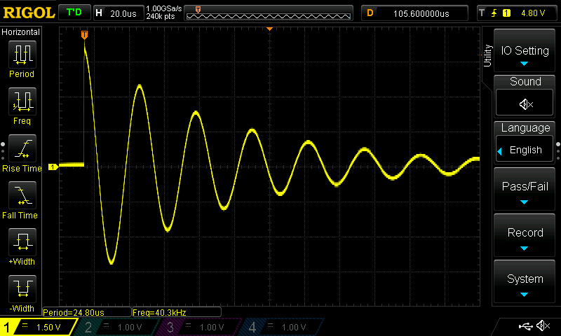

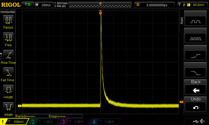

                      My meter would not measure the inductance of the primary either. Initially I assumed it was just below the range of my inexpensive tester or that my tester had a problem. I later measured several different transformer primaries with it and it worked fine. I also tested on known inductors and it worked as well. It may well be that that was my first indication that the transformer was bad.
                      As for testing, I did not complete all the ring testing that rievax_60 recommended earlier in the thread. The only function generator I had access to was either soundcard based, or using the little AVR transistor tester. The tester has some built in pre-selectable waveform frequencies, but is not arbitrary, so I could only do the test at one frequency, and not what I believe would have been the resonant frequency (if I understood his instructions correctly). That said, it was pretty easy really, I put a 10nf capacitor in series with one side of the primary coil. The other side of the primary went back to the function generator. Then, I connected the scope across the primary, basically right at the transformer. Once you get a good waveform triggered, you are basically looking for several decaying oscillations. From what I understand, more oscillations are indicative of a high Q and a good transformer. Any shorted winding in the transformer will highly dampen the oscillations. You can test this (and I did) by putting a known good transformer under test, and short any winding in the transformer and watch the ringing basically die off immediately.
                      If you have a problem in the primary windings, I suspect it is unlikely that you will be able to induce any current in the secondary.

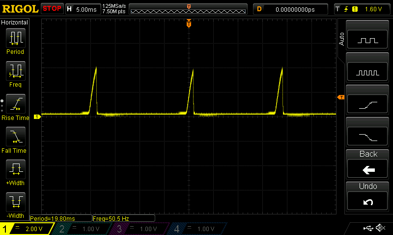

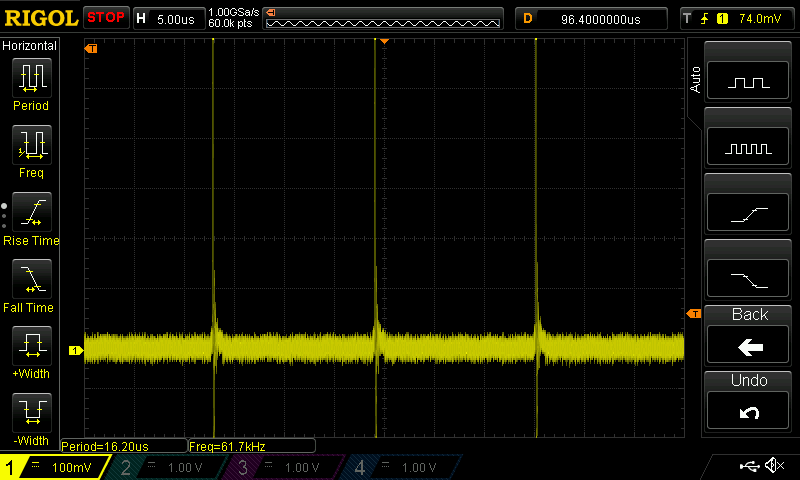

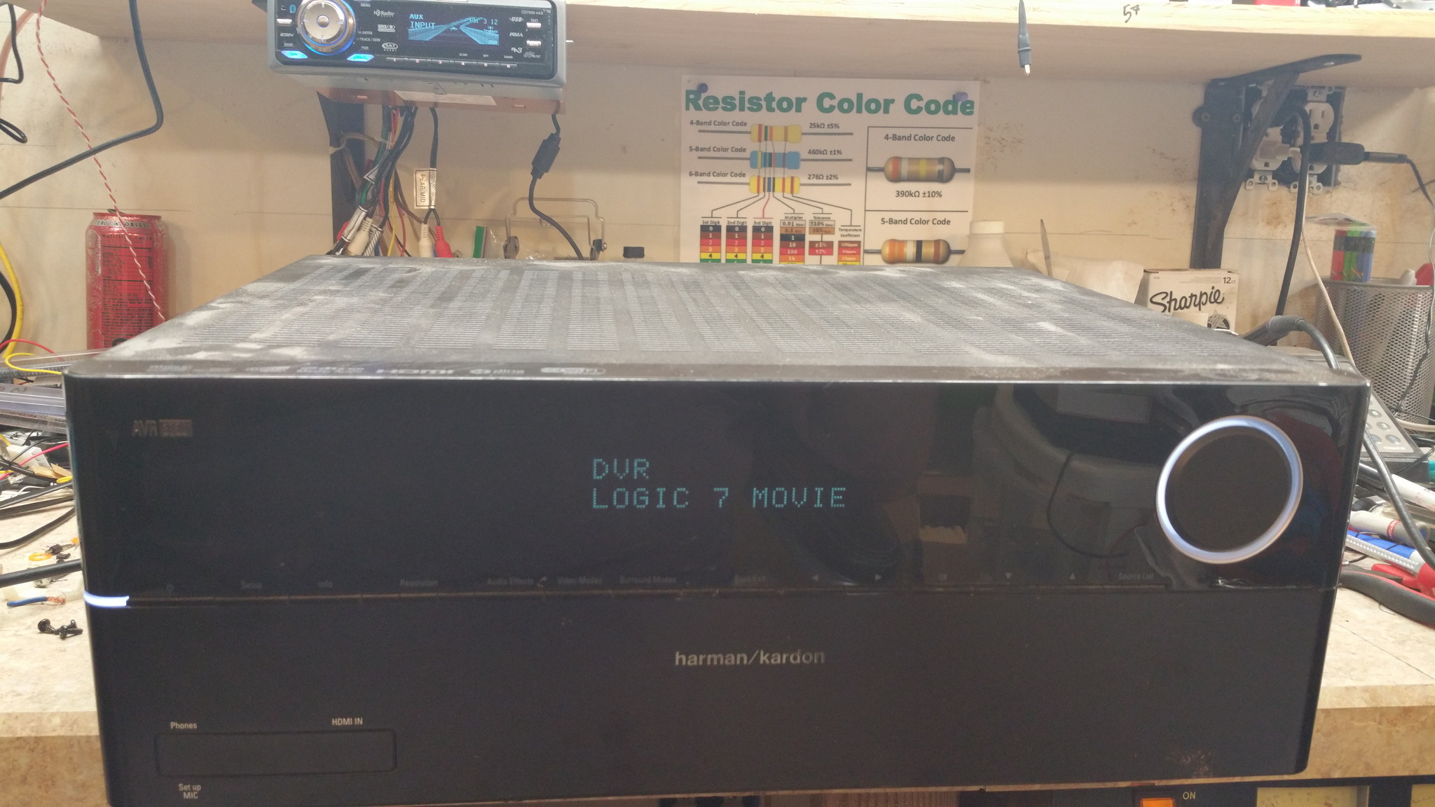

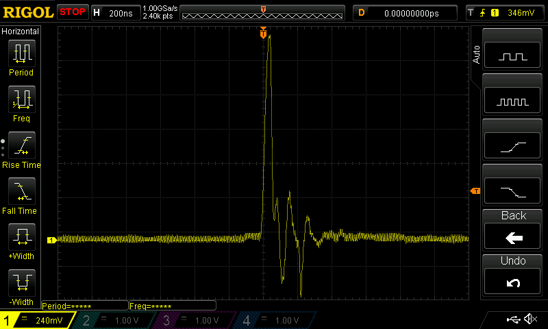

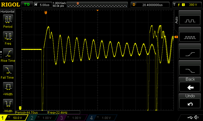

                        I'm pleased to say that I have the receiver back up and running. I bought a proper function generator and it arrived yesterday. I re-ran the same test I did on the old transformer with new function generator and on both the new and old transformer and have attached the waveforms below. It was definitely a bad standby transformer.
                        I also have the waveforms of the functioning power supply in case it will help someone else.
                        Thank you all so much for your help. It was a bit of a long road, but I am glad it is up and running again.

                          Good news, you should post the pictures of your transformer test setup so people can see how it is being done.

                            Great idea! I'll try to take some pics with the bad transformer when I'm out in the shop tomorrow. Thanks!
                            **edit** I forgot to mention, I just finished up rewiring this think in the home theater cabinet. It is indeed working again. Seems to be 100% functional.

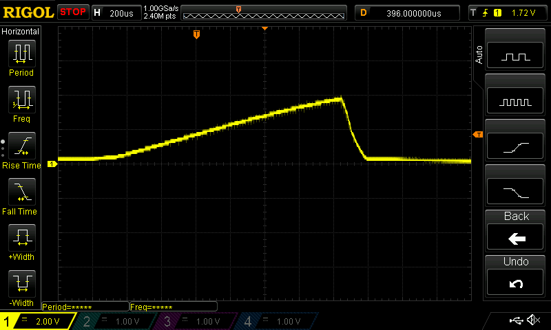

                                  The CS waveform is now the expected ramp shape. The measured amplitude is high, possibly a measurement error. Do you use a switchable probe?

                                    Yes, it's a 10:1 switchable probe, set on 10x. I'm not sure what you are seeing, that it is peaking at nearly 4v? I don't have enough experience to know what to expect.
                                    I don't know if it makes a difference, but the power supply was not in the receiver when I took those measurements. I believe I also had the 22R that powers the op-amp supply feed still as well. It's a 1.5hr job to get this thing out of the cabinet. Should I be concerned and pull it again?

                                      I dont think there is anything actually wrong with the repair.
                                      Is it possible that the probe was set to X1 for the CS measurement? The 4V reading seems way too high.

                                        I kept an eye on it as I went because I have inadvertently flipped it before. I can say that I took the readings on CS immediately after the ring test, and then I went on to do the FB and Drain waveforms. I know for certain I didn't switch it back, so if I fumbled it to 1x, I fumbled back to 10x. Not at all outside the realm of possibility, but I don't think I did.
