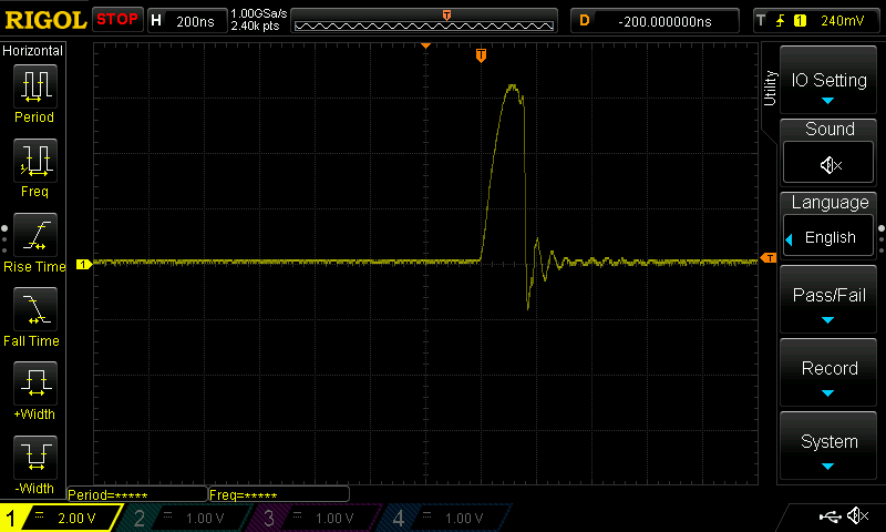

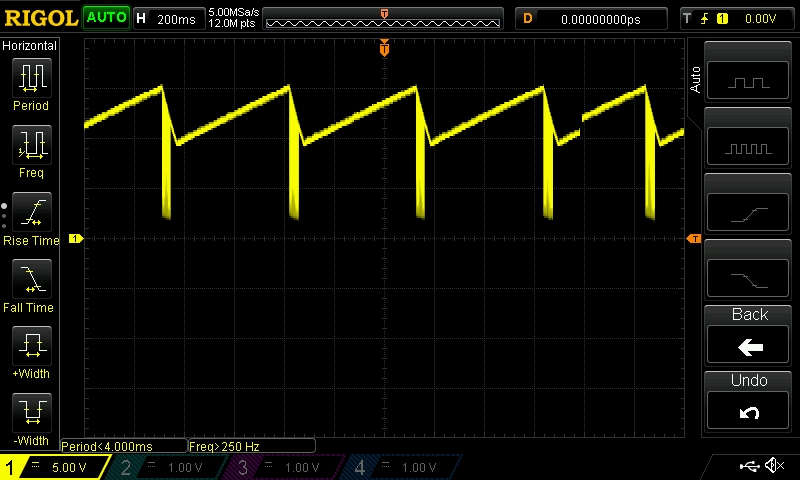

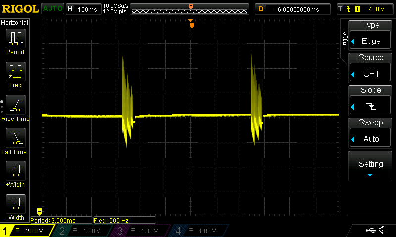

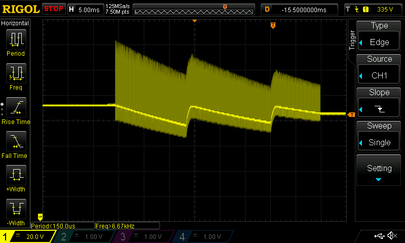

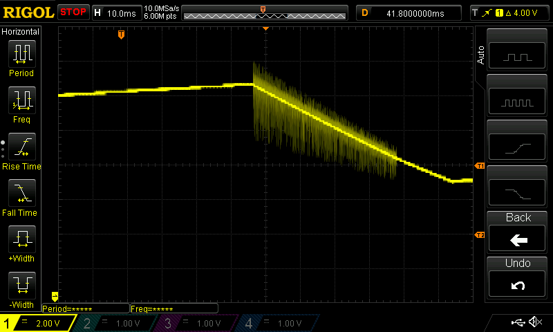

      Hi, thanks for your reply! I'm attaching some screen shots of the waveforms on each of the OB2358's pins. The name of each SS is the location they were taken. All were referenced to PG.
      I have a similar thread to this one going on DIYaudio.com, and Eva is trying to help me out, she has been more than excellent, but it is a struggle for me. Every little bit I know is self taught and she quickly gets over my head... I am hoping that I might find a source here that might have some other insight, or just be able to dumb things down a tiny bit for me
      Anyhow, she told me that my waveforms are indicative of this type of switcher trying and failing to start. I am supposed to capture the waveforms w/ a faster timebase on her request, but I have not had time to get them yet.

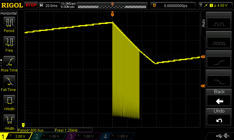

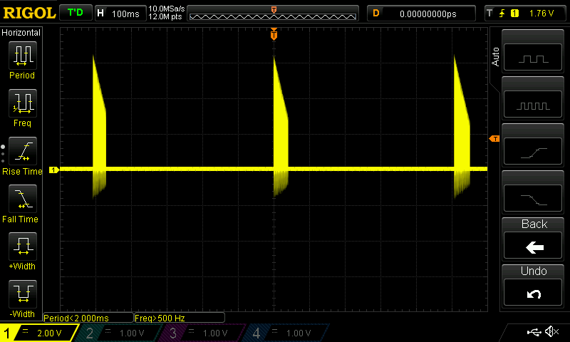

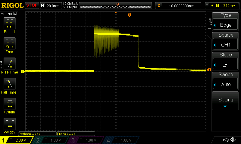

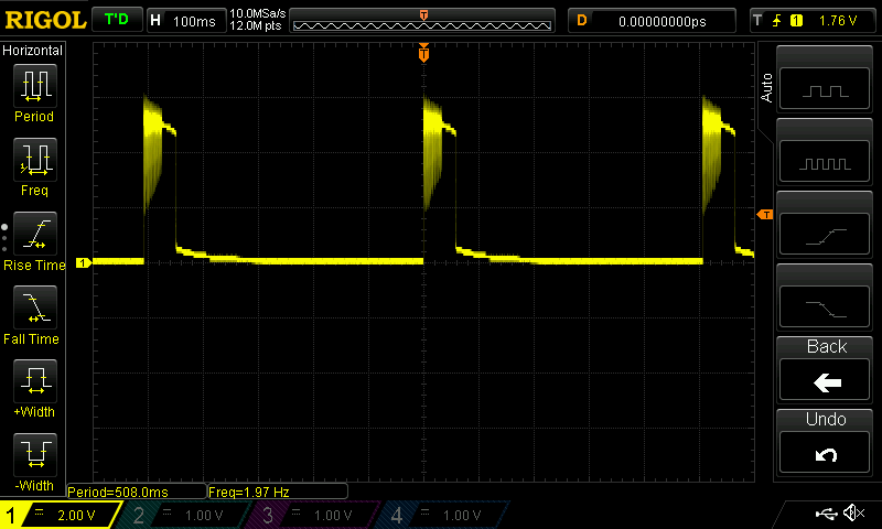

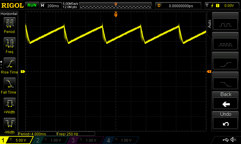

                                      Hi, I did not get as much time as I had hoped today. My wife took my girls school shopping, so my son stayed with me and wanted to build lego robots...
                                      Anyhow, I talked him in to hanging out in the shop for a little while. I tested both R932 and R935, they are ok. I lifted R935, and it is still no go. I reinstalled the transformer and I tried to get more detailed waveforms. I can try again if I still did not get enough detail. They are all still referenced to PG, but I adjusted the zero level to get as much detail as possible in the screen shot. I assume that the waveform detail is more important at this point than knowing the exact voltage of the peaks. The waveforms on Vdd-g and Vdd both had zero set at approximately -9V. The waveforms captured on the drain terminals was with the zero at -330V.
                                      Current Sense
                                      Feedback
                                      Drain
                                      Drain 5ms
                                      Hopefully this will give the information needed. If not I should have the day off sunday and with any luck will be able to get some time alone to do a little better job getting the new traces.
                                      Thanks,
                                      Jason
                                      • rievax_60
                                        • May 2012
                                        • 897
                                        • australia
                                        Re: Harman Kardon AVR 3700 blown standby power supply
                                        The CS and Drain waveforms show that the primary winding looks like a short circuit. Time to ring test the transformer.
