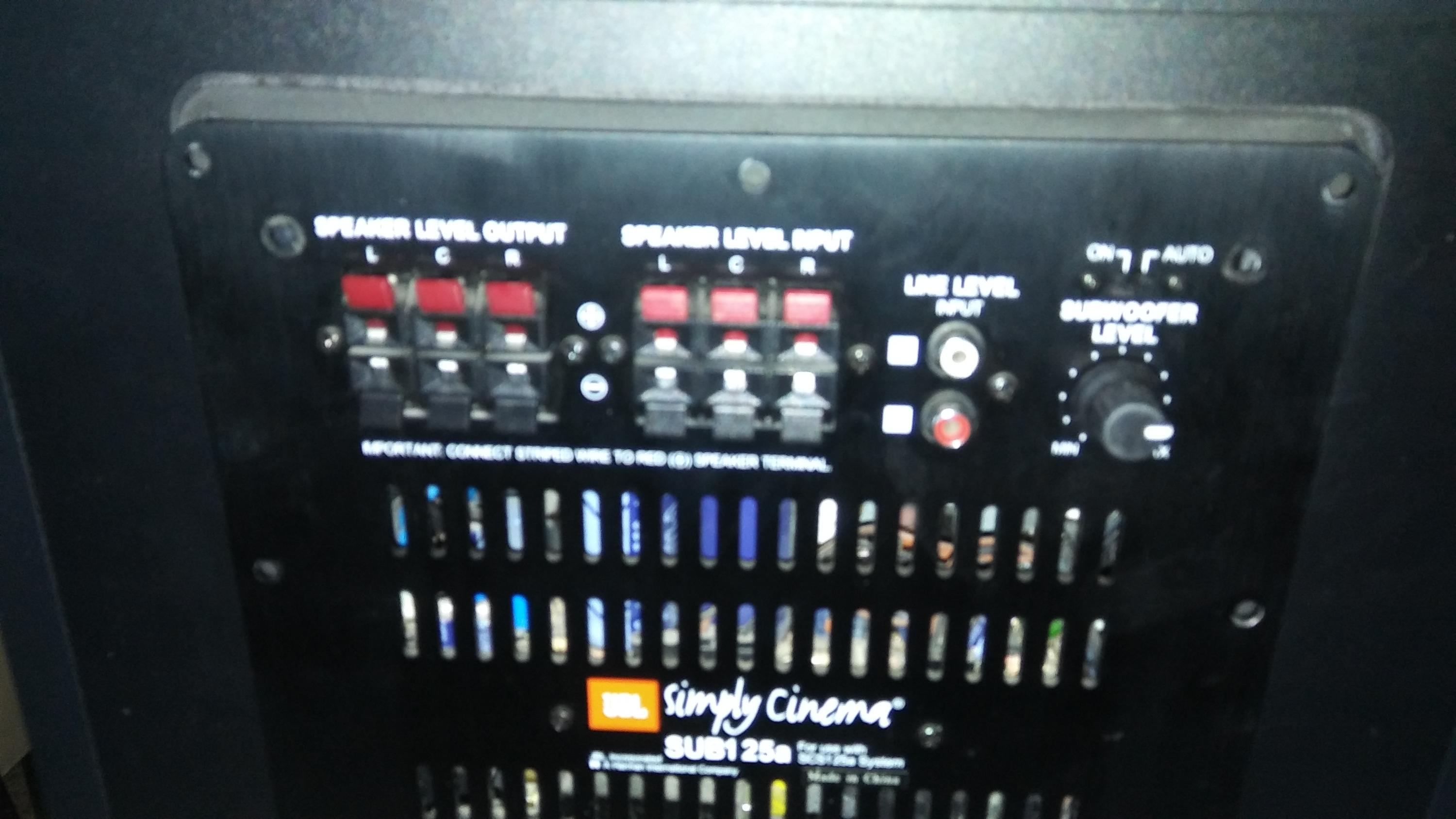

    JBL SCS125 6-Piece Complete Home Theater Speaker System repair.

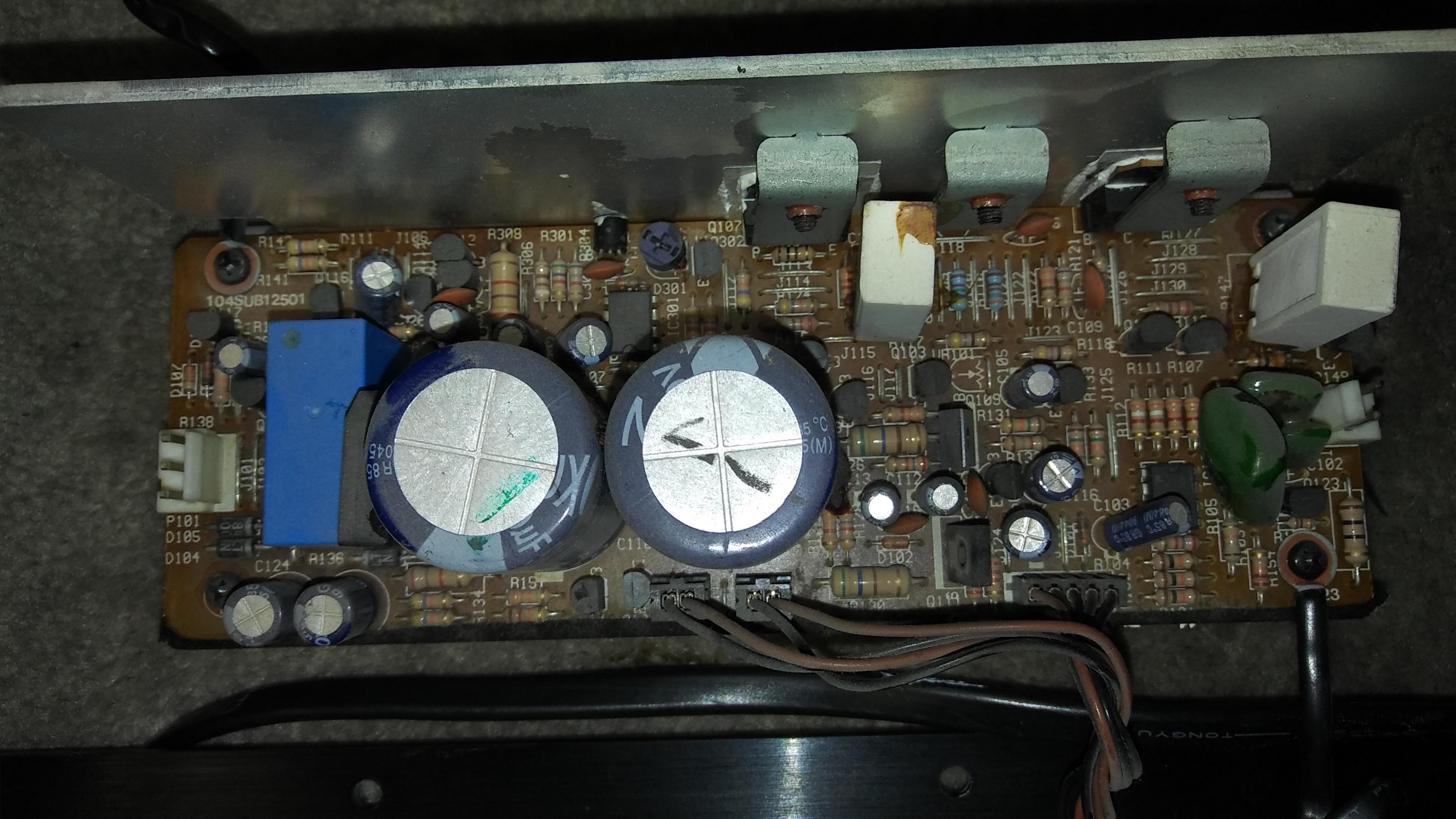

    JBL SCS125 6-Piece Complete Home Theater Speaker System, subwoofer SUB125a turns on then cuts off repeatedly.

    Re: JBL SCS125 6-Piece Complete Home Theater Speaker System repair.
    Could be a mismatch in the I/O signals.....output level to high for the inputs.......the output transistors overloading and breaking down due to poor solder connections.....improper cooling for the output transistors.....weak capacitor...de-coupling and/or power supply.
    • capwizard
      • Jun 2016
      • 1991

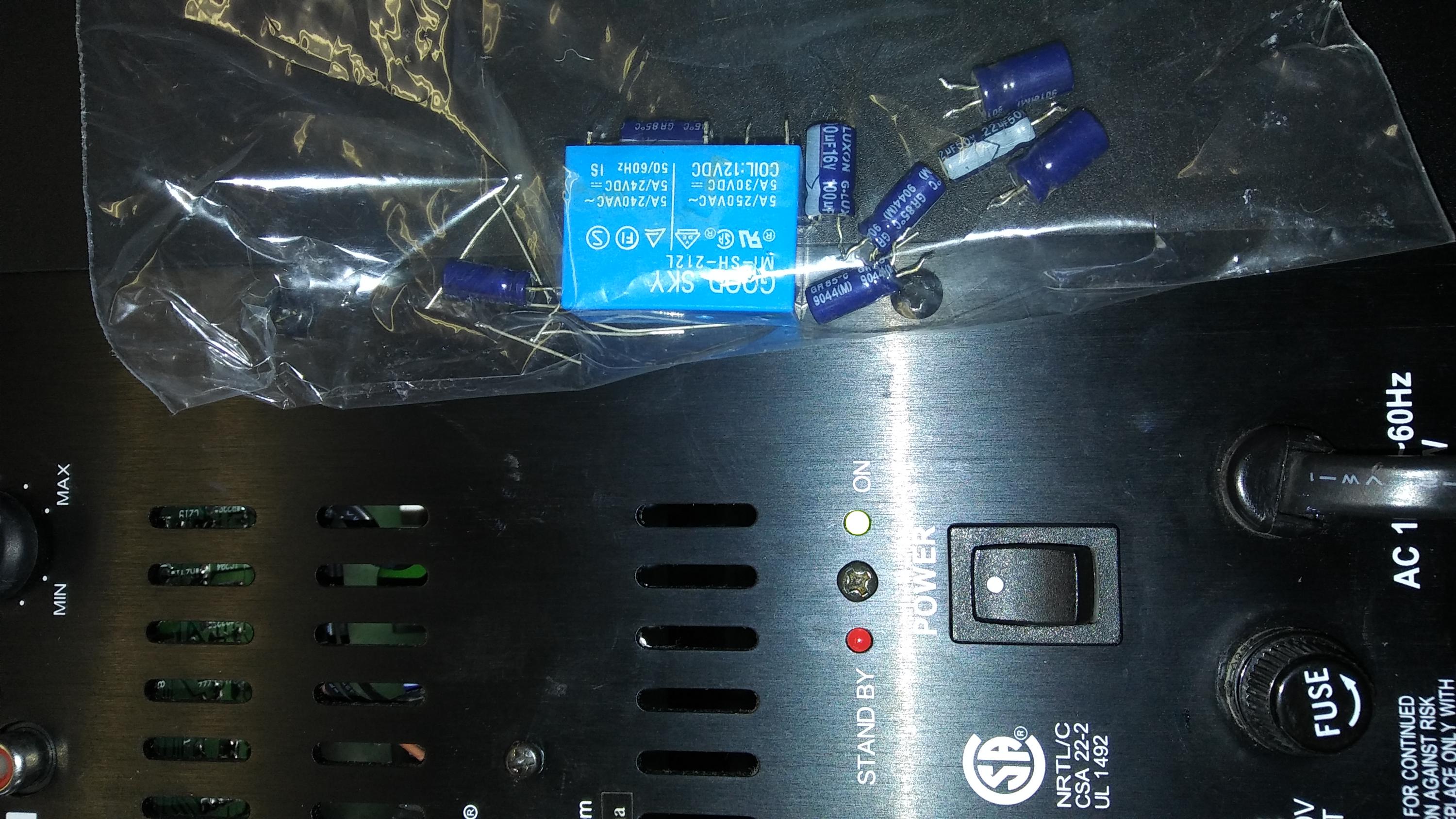

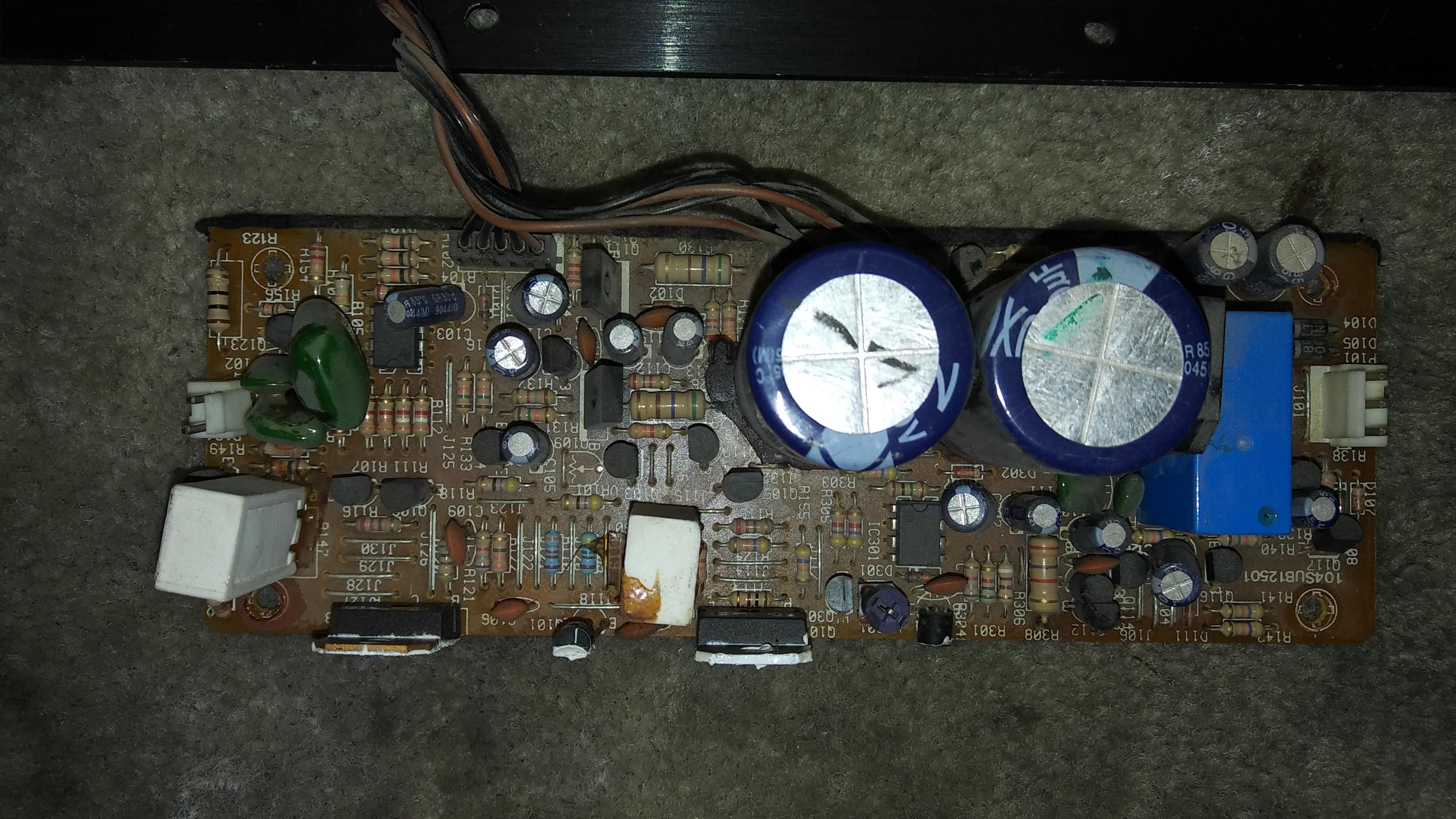

      "weak capacitor...de-coupling and/or power supply."
      After I changed all the capacitors and check all the Transistors. It is still doing the same thing relay clicks on and off???

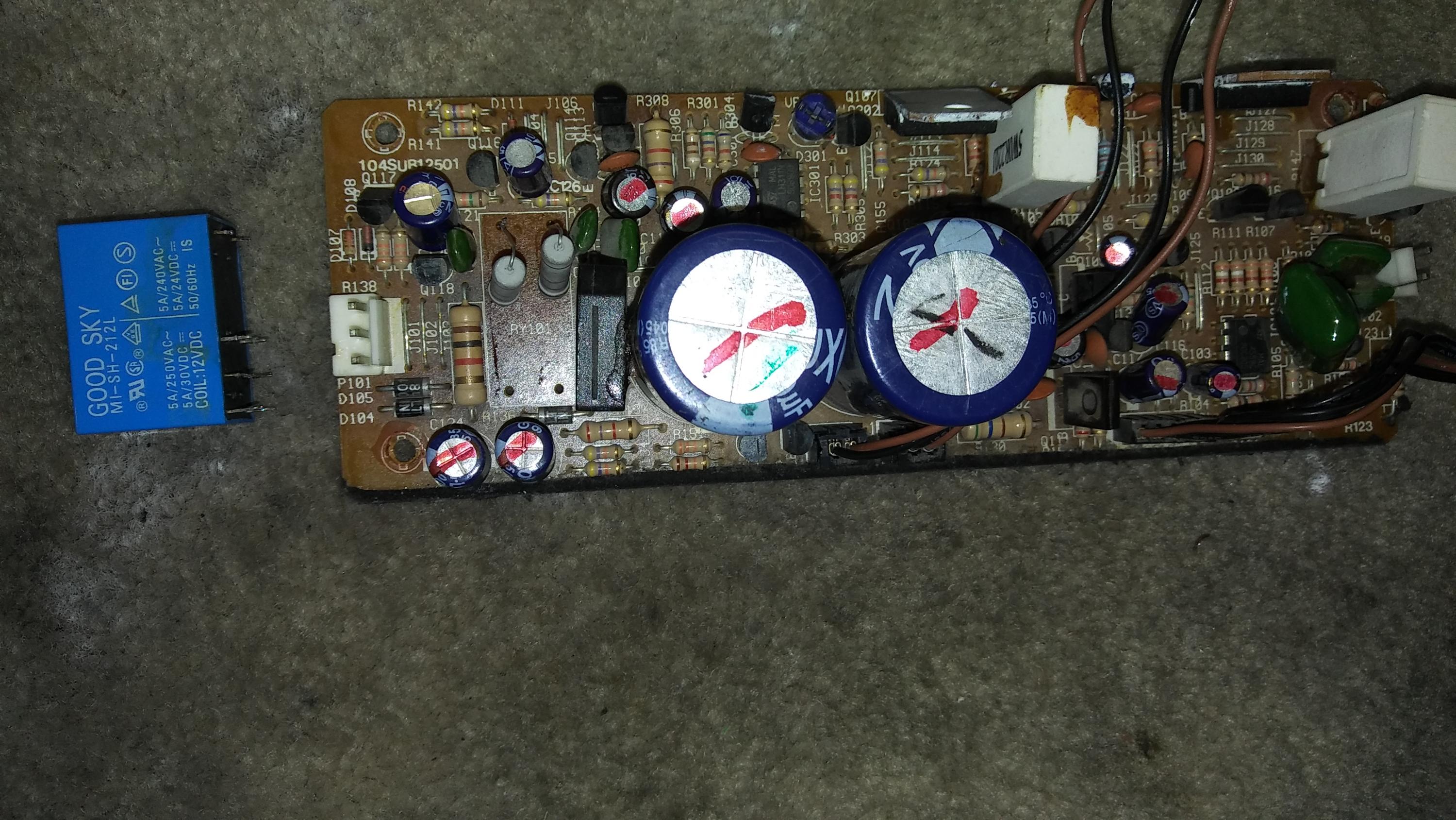

      I spend too much time on this Amp, before I give it up, I jump the relay with 0.1 ohm resistors, Now, it works OK!

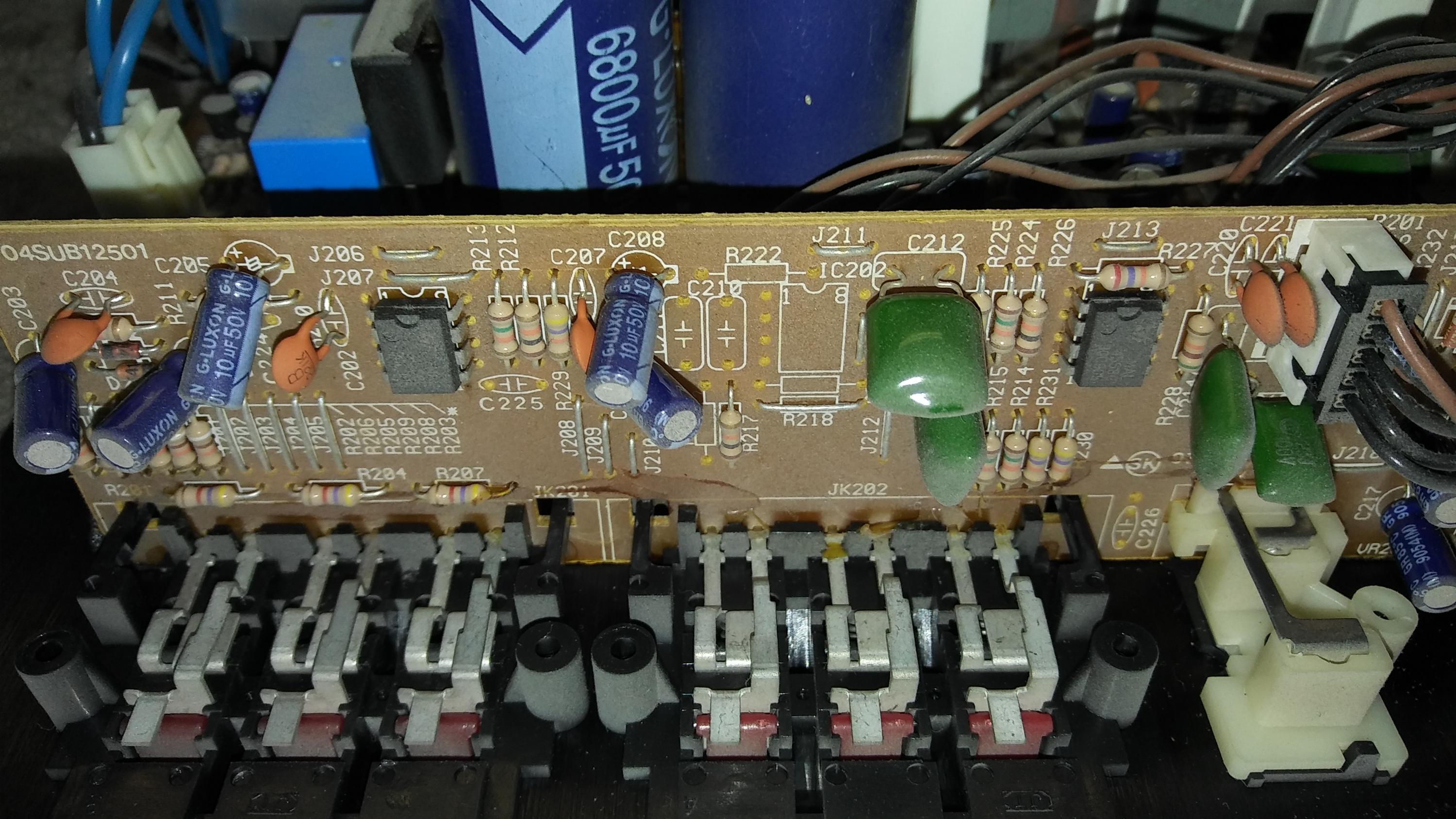

          Yes, The problems must be in the polyester film capacitors because I neglected them all. You should've told me. First!..................
            How did you come to that conclusion? That cap in the Youtube is for the Capacitive power supply, your JBL uses power transformer.
            That relay is for timer circuit that will put unit in standby after about 15 minutes if it does not detect audio input signal.
            So if you are going to by pass the relay contact, you should use jumpers.
